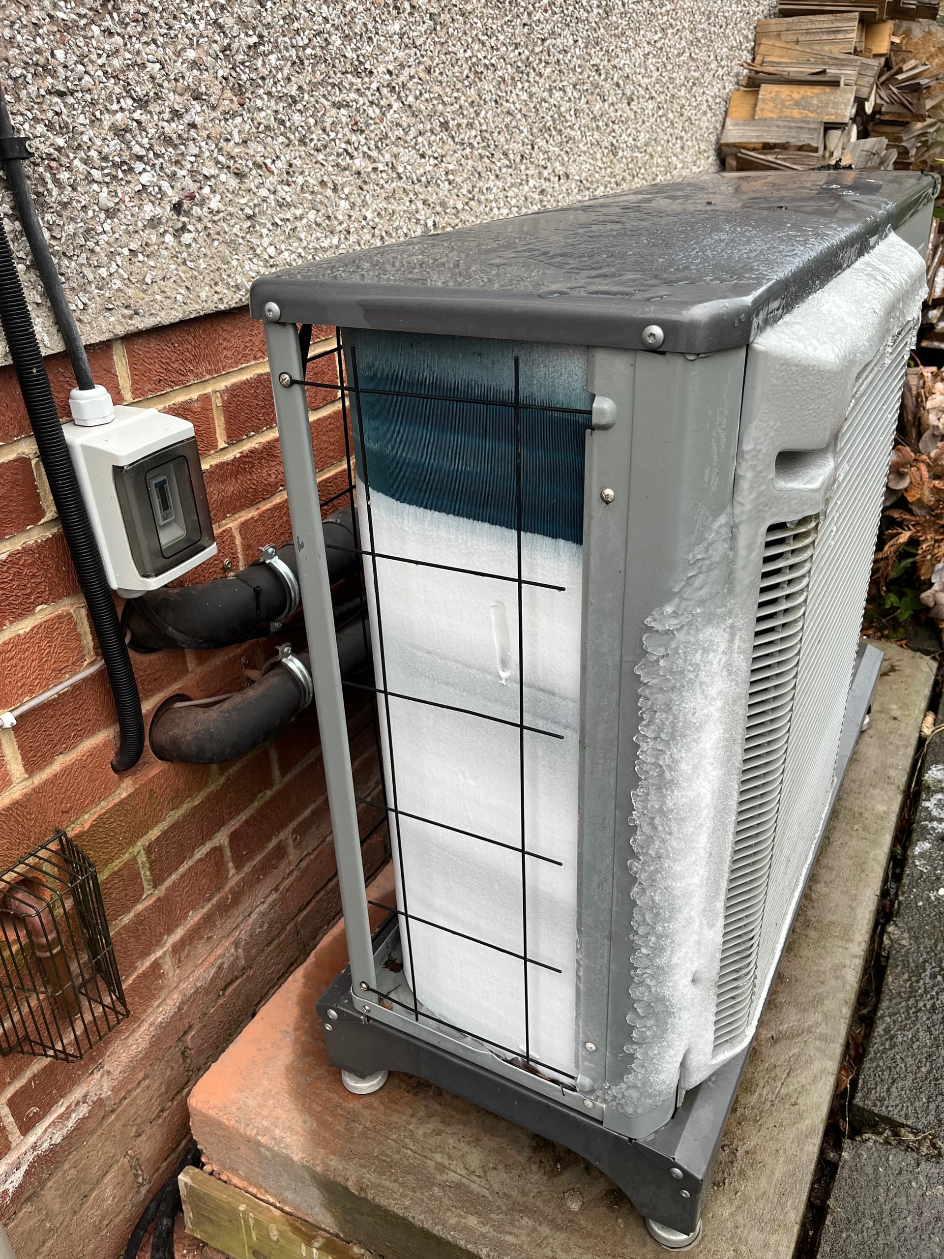

I am wondering if it is due to defrosts as this behaviour does co-incidence with the recent cold weather here (or consist temps around or below 1).

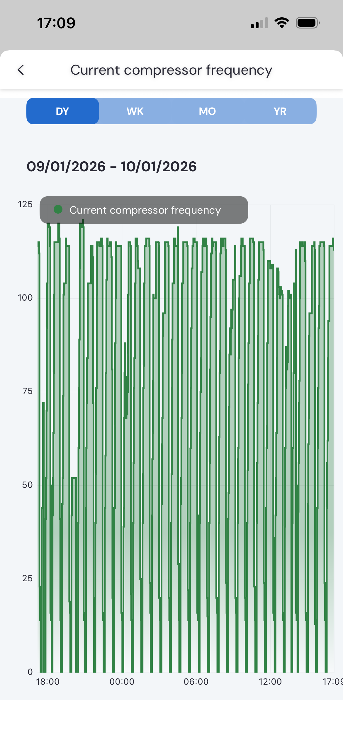

Here is the graph of the compressor frequency:
Also, here is a pic of the back of the heat pump:

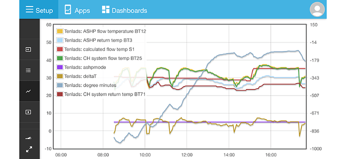

The graph above is from a day of running. I’ve not looked in detail but some observations and things to look at going forward:
  • the system started the day with significant negative degree minutes, likely due to a high S1 target temperature over recent days and the cold weather with lots of defrosts
  • Since you adjusted the curve to a lower target, the system has begun to recover as the degree minutes have steadily climbed through the day
  • The system has not yet managed to get the degree minutes to 0 so the heat pump has run all day (shown by ashpmode = 5)
  • The system defrosts regularly and when this happens the flow temperature at BT25 takes a big dive. This is likely because you have no buffer tank to act as a “thermal battery” so the only source of heat to help the heat pump defrost is directly from your hot water in the CH loops which is then rapidly cooled and seen by BT25. This further decreases your already negative degree minutes value.
  • At 1500, your S1 target temperature suddenly steps up, I guess you have a schedule with an offset programmed in to around +4 or +5? We should look to remove this for now.
  • Your BT71 return temperature suddenly changes at 1030 and is consistently below the return temperature as seen by the heatpump, this suggests it might not be installed correctly so is reading low or is now in a location that reads something differently - this is definitely something to explore further
  • From around 1500 the flow temperature and BT25 track your target S1 temperature well, this causes the degree minutes to flat line. This is behaviour I’ve not seen before, normally the NIBE will overshoot S1 until degree minutes reach 0. Maybe this is a change in the F2050 logic or something you have configured in settings, I’ve seen other F2050 systems on heat pump monitor run like this and it is something to keep an eye on.
  • You’re still running your charge pump at 100% - we should probably put this back to auto now the system is stabilising
  • Your delta T (as seen at the heat pump) is looking much more normal at around 6-7 degrees, compared to the large dT we saw earlier in the thread - it is much more as expected. The delta T as seen by the controller (difference between CH BT25 flow and CH BT71 return will still be large and might warrant investigation as to the impact of this)
Sorry nothing overly helpful at this point but I wanted to post the graph and also let David take a look.
I think next steps could be:
  • Monitor for another 24 hours and feedback how the house is feeling - Nibe uplink doesn’t have internal temp data so we can only see this from your OEM plots, maybe you can post one for today so we can see how the internal temperature has reacted. you said it has felt warmer and that’s expected based on how the heat pump has run today.
  • Later on tomorrow, reset the charge pump control to auto and
  • Remove any schedule offsets you have configured (I think you can just disable them)
David might have other suggestions too.

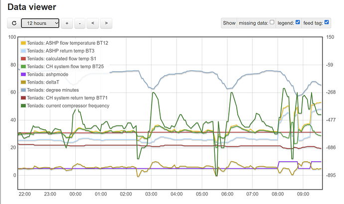

Would it be possible to include Compressor Frequency in the graph? My hunch is that the ‘flatlining’ is the controller modulating the compressor speed and so avoiding the on-off cycling which would happen when the DMs reach or exceed 0.
The defrosts can be inferred from the Flow temperatures but could we add the Defrost status to the graph too, for extra clarity? (It looks like the ‘ashpmode’ isn’t changing to reflect defrosting.)

The last 12 hours with compressor frequency added (dark green line). I omitted it on the first post to make it easier to read.

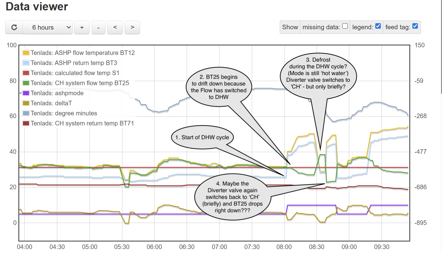

There is some odd behavior being seen during a hot water cycle, I will post a new picture in a new reply slightly zoomed in for the end of this graph
it does look that way, this is different to my behavior (and what I have seen on other Nibe). This F2050 modulates around the target very well, mine just overshoots it and stays like this until degree minutes go to 0 then it shuts off until -60.
I cannot find a way to do this, the aspmode signal is derived from the operating priority in NibeUplink, the manual suggests defrosting is effectively putting the ASHP into “cooling” priority but this never changes on MyUplink in the received data. I will try and log the data for a while to see if there is anything during a defrost cycle - inferred from the flow temperature.
No problems, it wasnt a big job and seeing this data for more Nibe systems will really help those that own Nibe units to understand how they work and how they are best set up - even if the graphs can be a little complicated to read at times…

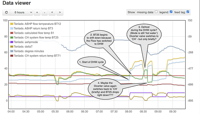

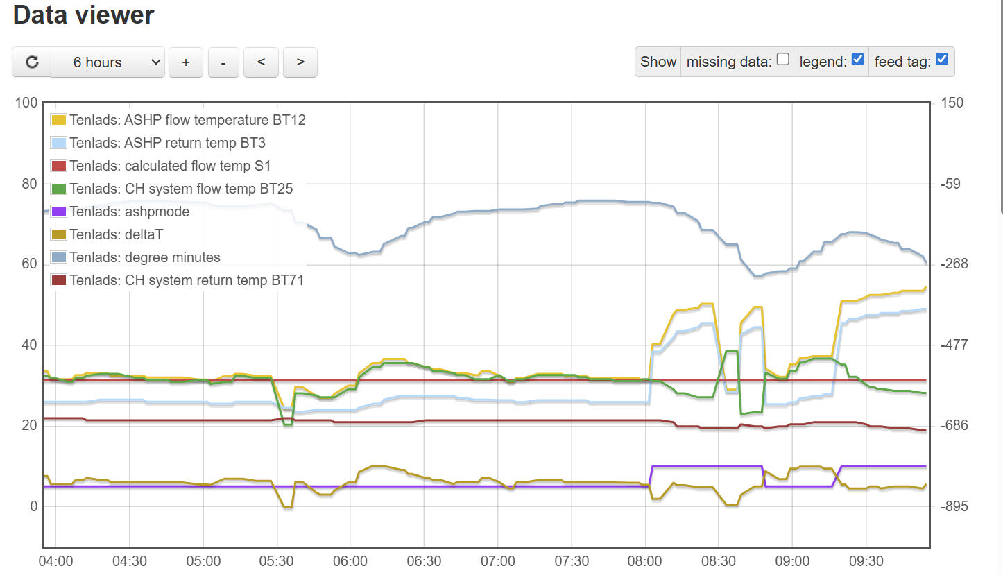

This is the first time we have seen a hot water cycle since capturing data - I cannot understand this one:
  • at 0800 the hot water cycle commences (seen by ashpmode = 10)
  • The BT25 temperature immediately drops which I would not expect as this should sense the flow on the CH pipes (if it was seeing DHW flow it should increase)
  • The BT25 temperature does a sudden jump up and back down around 0830 and stabalizes when the ASHP goes back to heating mode
  • At 0915, another hot water cycle starts and BT25 begins to decrease again,
  • The result of a decreasing BT25 during DHW is to push the system further into negative degree minutes
I think we could benefit from a plumbing schematic if at all possible and specifically some more information about where BT25 is located. Is there anything showing the plumbing layout that the installer provided? Sometimes they leave a schematic with the homeowner but in most cases the homeowner has to trace pipes and draw it up.

Here’s my attempt at interpreting your latest graph, showing the DHW cycles:
It’s become clear from this other NIBE thread that the controller is making a decision about whether to defrost using heat from the CH circuit or using heat from the DHW tank (what is sometimes called a ‘tank defrost’). It seems to do that by checking the temperature of the ‘heating’ water - and it does a ‘tank defrost’ if the heating water is considered ‘too cold’.
So my thinking is that - when needing to do a defrost during a DHW cycle - the controller is ‘testing’ the temperature of the heating water by briefly moving the diverter valve. Those valve movements could explain the sudden changes in the value for BT25 (which Dave has moved to the Heating pipework).
I’m sure that’s very much intentional and it’s what tells the controller how much of a ‘Degree Minutes Deficit’ has built up while in DHW mode (or while Defrosting), so it knows what deficit it needs to ‘recover’ on the next heating cycle.

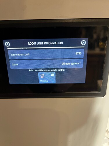

I have installed the BT50 sensor in our snug for the time being. This room is insulated and pretty much finished (but it will take a dip whenever we open the door or leave it open). In the long term I will probably move this to the main living area but that shouldn’t make too much difference. Can I ask, in the room sensor settings (1.3.3) I have selected the option below:
Is this correct? Are there any other settings i need to take a look at / update? It’s this automatically adjust the curve etc as required?

Excellent. I’m pretty sure that’s all you need to do with the BT50. It won’t completely get you off the hook from choosing a suitable Curve but effectively it will auto-adjust the Offset based on the indoor temperature.
On my older SMO 20 controller there are some configurable ‘factor’ settings related to this but those aren’t available with your SMO S40 and you basically only get to tick the box (or not).
We’ll need to keep a watch on how S1 (the Calculated Target Flow temperature) reacts based on the BT50 input. NIBE warn that using BT50 to control the heating can be problematic with UFH (especially slow-reacting UFH) and NIBE F2040 12kW with SMO S40 controls not following WC? describes some unexpected behaviour that could happen. (You can always un-tick that box in 1.3.3 and myUplink will continue to report the BT50 value but it will stop using it to control S1.)

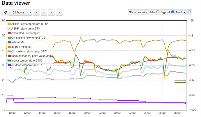

It does look like the room sensor is having some effect on the S1 target temperature - it has shifted it around since around 2100 last night. Although it is hard to determine if the increase this morning is actually due to lower outdoor temperature or BT50 room sensor influence.
I have added two new signals to the logging, one for indoor temperature (BT50) and one signal that appeared in the data called room sensor set point - this is 20 degrees. It looks like this might be configured in the controller and set at 20. The BT50 room temperature since I started recording the signal has sat steady at 18.5 degrees.
