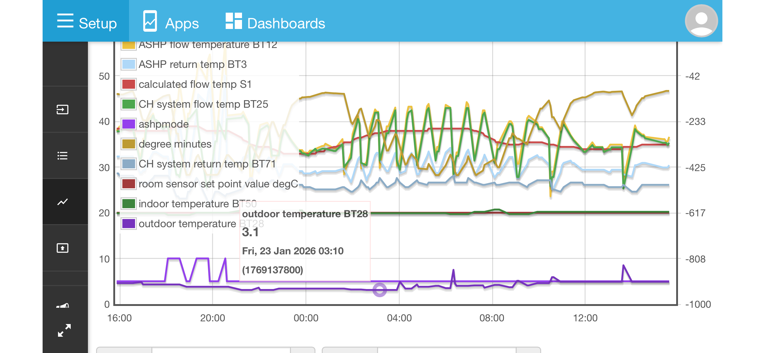

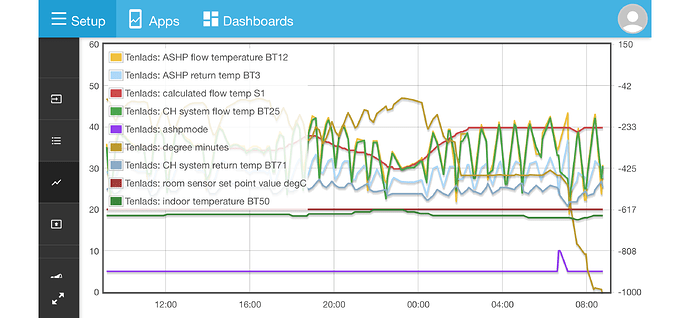

Just for a quick update : The room temperature is showing a slow increase and is getting close to target of 20 (assuming that is what the set value means)
Thanks Sam. The ‘20’ will indeed be the indoor temperature thermostat set-point (i.e. the target for the indoor temperature, adjustable on the controller in 0.5C increments). It’s good to see BT50 converging on that.
The last-but-one graph was looking very good, with BT25 closely following S1 as that moved up and down (with the occasional dip for a defrost, followed by a peak as the DMs recovered).
There’s clearly a lot more defrosting happening towards the end of the latest graph, as the Outdoor temperature dropped closer to 0 - although the DMs are still just trending upwards (following the ‘blip’ in S1). It will be interesting to see how it performed overnight, with (presumably) even lower outdoor temperatures but with BT50 close to the set-point.

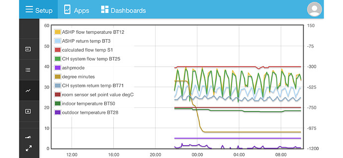

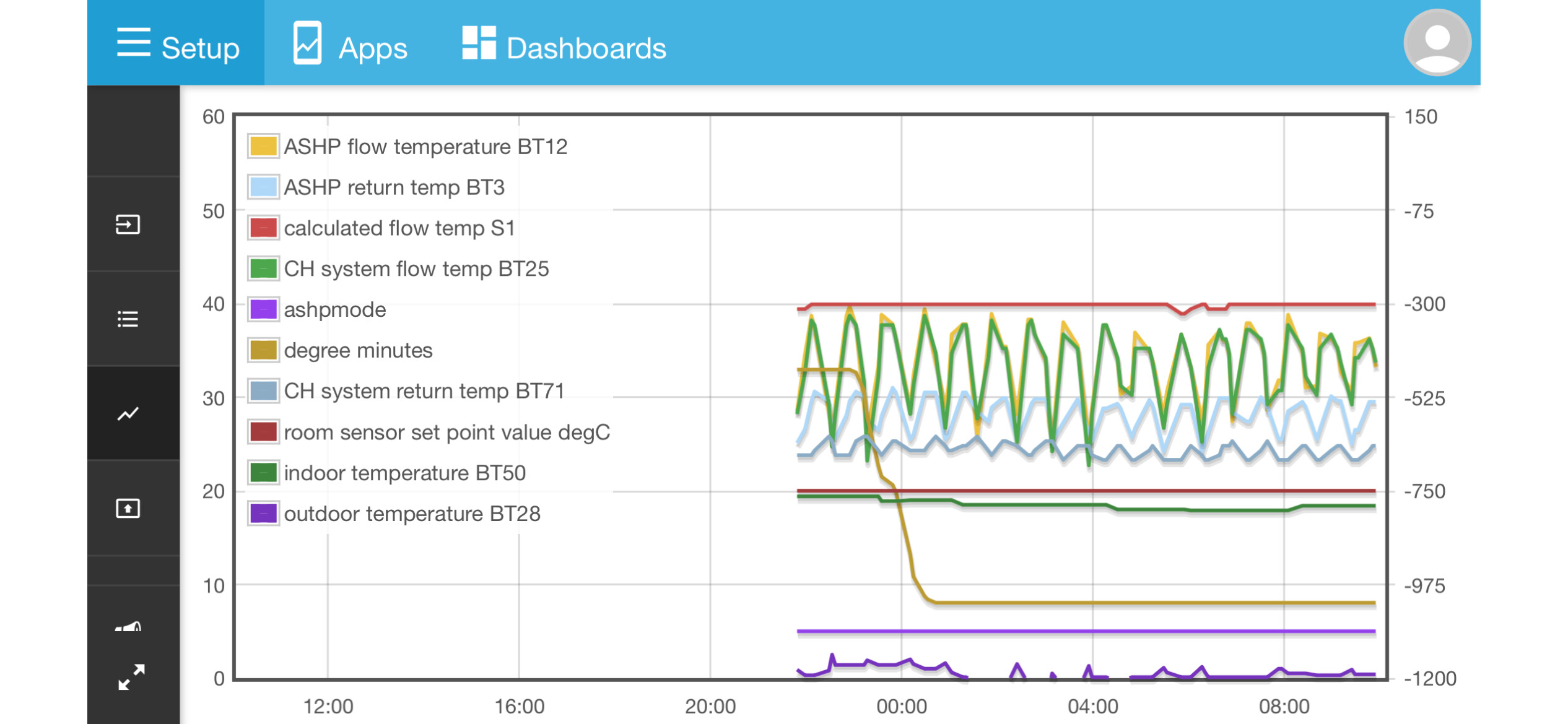

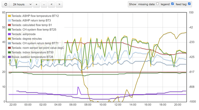

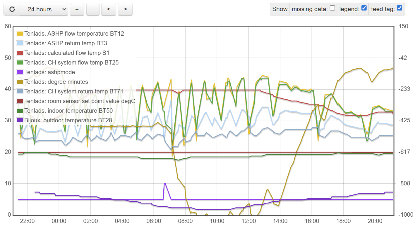

I think the graph supports the theory.
it doesn’t look like the ASHP is able to defrost effectively in colder weather. The flow temperature rarely gets up to the S1 target before a defrost (I assume) takes it right back down again.
The degree minutes have taken a big dive and the room temperature has reduced.
I suspect this is now the same situation as what occurred when Dave started this topic.

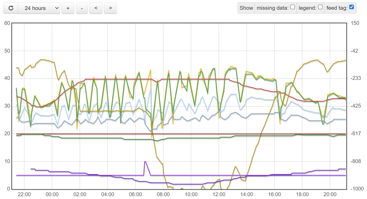

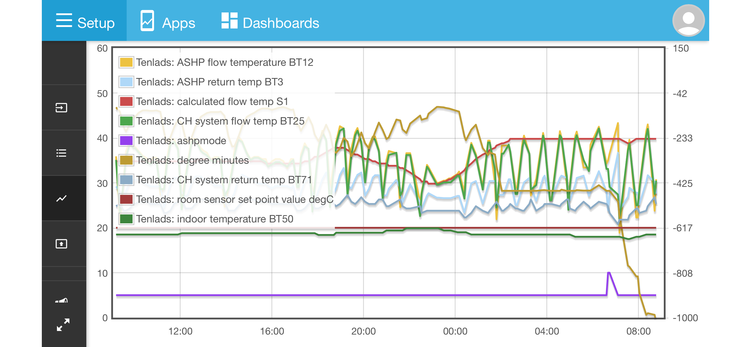

Thanks Sam. I agree with that assessment and it’s great that your latest graph catches it changing from ‘doing fine’ at about 23:00 to ‘definitely not coping’ at 08:00.
Interesting that it managed to hold steady at about -450 DMs from around 01:30 until around 07:00 when a DHW cycle (and the resulting defrost) pushed it ‘over the edge’.
@tenlads: This would be a good graph to review with your Installer. If things don’t improve with slightly warmer weather during the daytime you might want to temporarily reduce the indoor target temperature a degree or so, to stop it trying quite so hard and attempting 40C flow. You could also consider using the immersion heater on the DHW tank so the heatpump can focus on the central heating instead.

Your system did indeed recover once the outside temperature begin to rise around 1300. It is back to what we think is “normal” for your current set up - we can of course, and should you wish, help you keep eyes on how your ASHP performs as you add more volume.

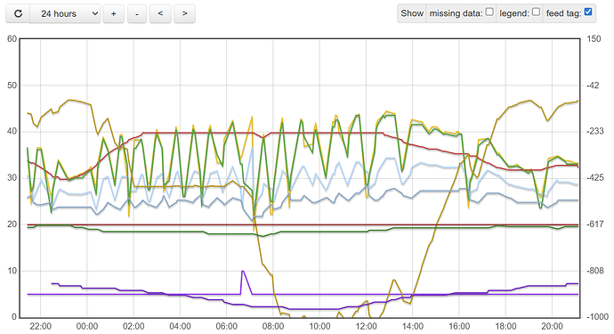

and same view but with the legend (omitted for clarity above as it covered up the end to end view)

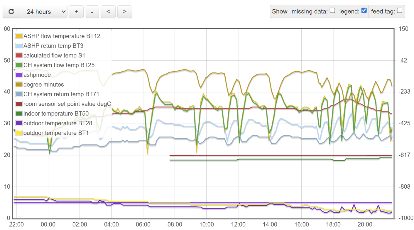

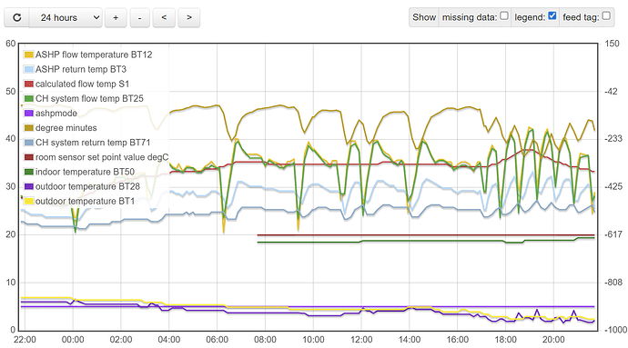

Hi Dave - Just a quick update for you. The temperature has dropped and the heat pump is struggling to defrost. The flow temperature is never getting to the target before a defrost is required. The temperature of your CH water is slowly declining which will further exacerbate the defrost problem if the outdoor temperature remains around 0 degrees.
This is another example of the defrost problem to talk through with your installer
Hi Sam,
Thanks for the update. Yes indeed the DM’s are stuck at -1020 and the house is beginning to cool down.

I’m not sure when you changed the setting but if it was before today it didn’t make much difference. Your heat pump seemed stuck in a defrost cycle most of the night, just a little less severe than seen before
I’ll keep an eye going forward on any changes to performance or defrost
