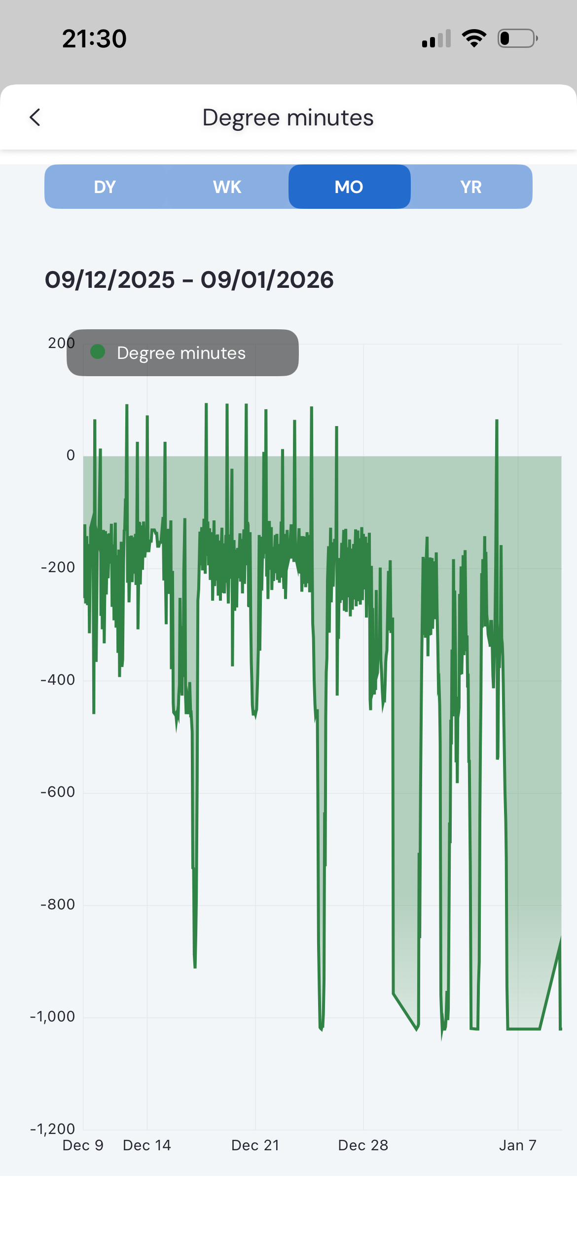

  1. The flow temp rarely gets above 40 degrees despite the max temp being set at 50 degrees
  2. The heat pump looks like it is short cycling
  3. Degree minutes are currently at -1020
I’ve tried altering the curve (currently at 12) but this made no difference.

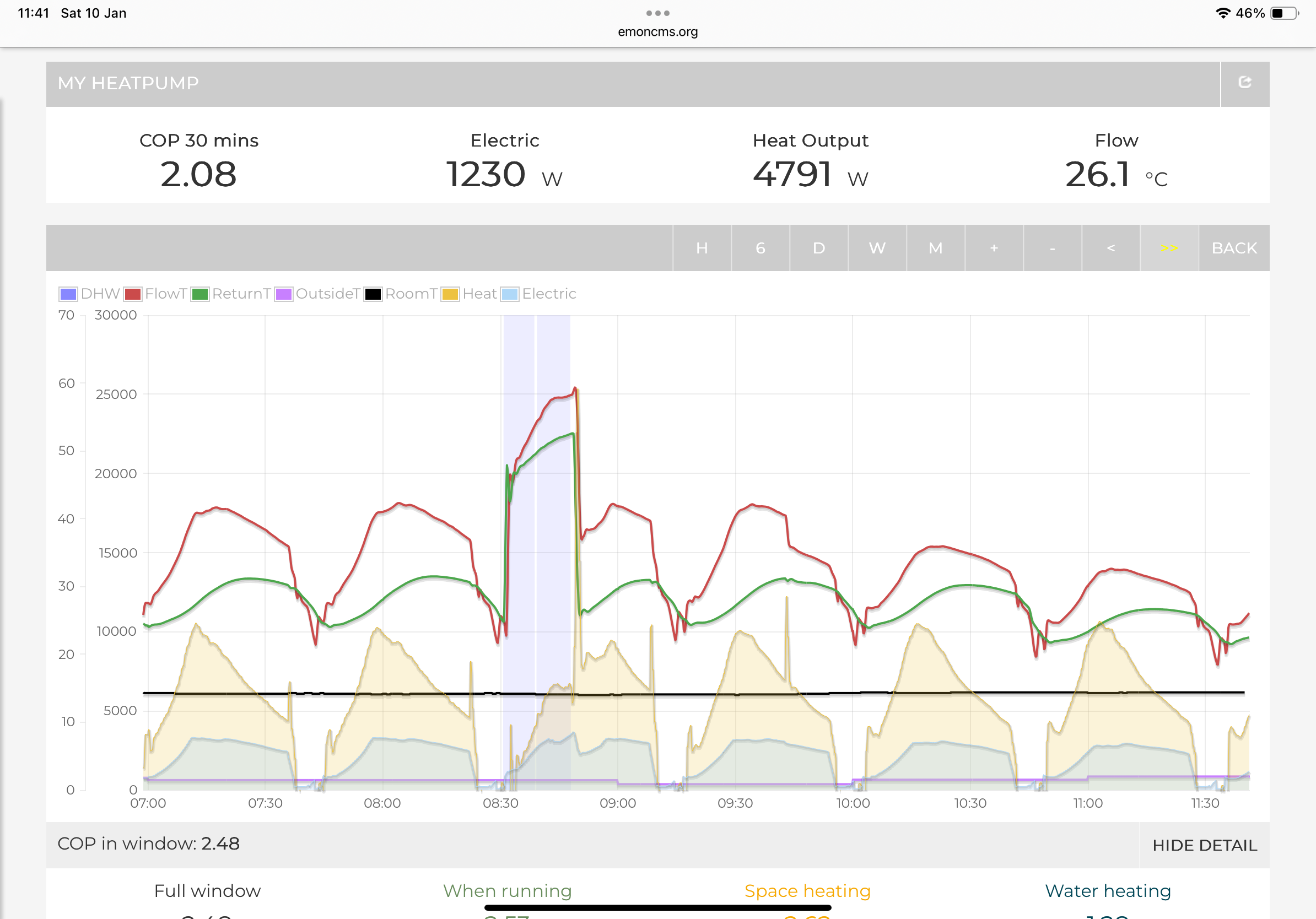

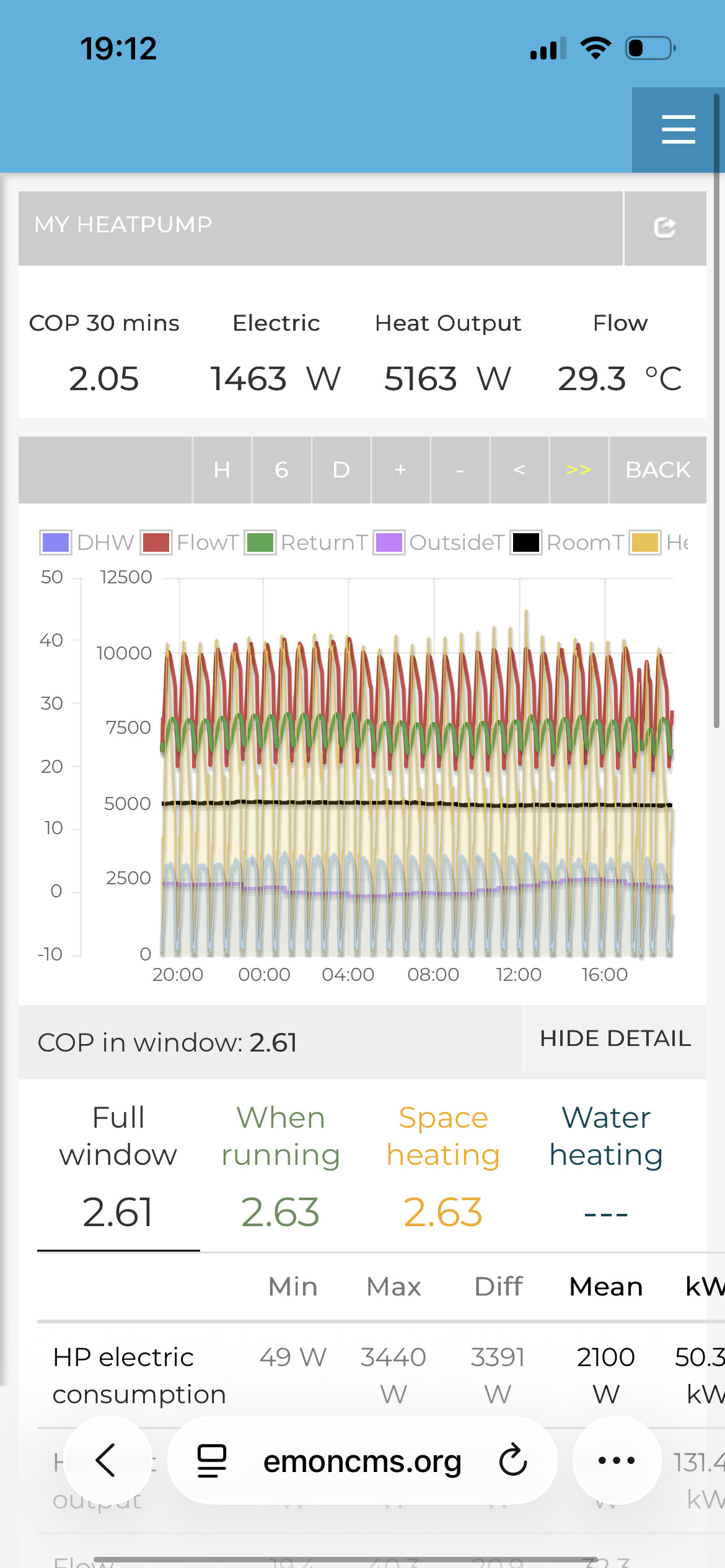

Here is a snapshot of what today’s OEM graph looks like:
Is this as expected or am I missing something obvious here? It seems to me strange that the supply temp will never go above 40 - could this be because the supply temp is rising too quickly (I’ve not balanced the radiators but the UFH heating had the ‘auto-balancing’ actuators).

While that doesn’t look like crazy short-cycling (slightly more than one cycle per hour, by the look of things) and it’s similar to this other F2050 it’s definitely worth investigating.
The first thing that stands out to me is that -1020 Degree Minutes is much more highly-negative than I’d expect to ever see. That’s in the sort of territory when the controller would try to bring in the auxiliary resistive heating (though I’m not sure if the F2050 has that) and it’s an indication that the heat pump controller knows it’s failing to meet the heat demand.
As you may already know, the DMs typically range from about -60 (or a different, configured negative value which triggers the compressor to start), to 0 (when the compressor stops) - with a bit of ‘overshoot’ above zero being common (and the reported DM value being capped at +100).
  • Are your DMs going up above zero every cycle or remaining around -1000?

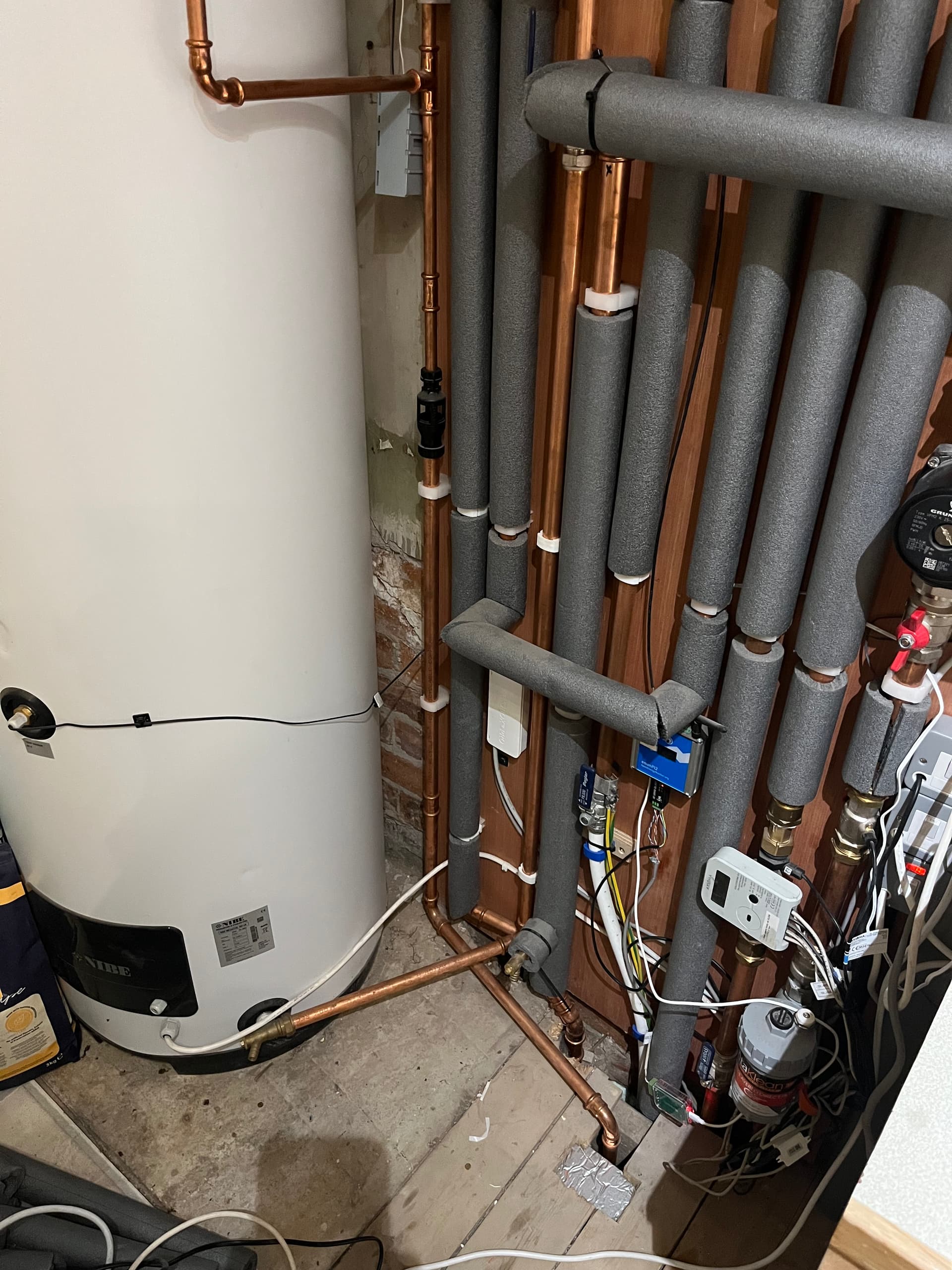

A litte more info on your plumbing setup would also be helpful:
  • Separate pump on the UFH manifold(s), presumably?
  • Any sort of ‘Volumiser’ tank (might be a NIBE UKV)? If so, what capacity?
    • If you have one, and there’s a thin black wire going into to top, that’s probably your BT25 sensor
  • Any sort of Buffer tank or Low-Loss Header?
A photo of the indoor pipework would be ideal, if you have one.

DM - Yes, this seems extreme to me also (I’ve found some helpful explanations about DM’s and it shouldn’t be getting to -1000). I’ve attached a pic of DMs over the last month.

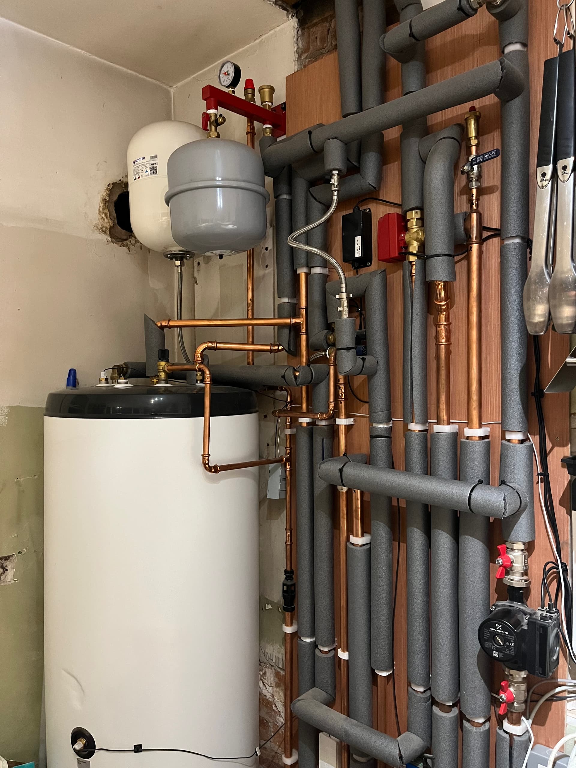

Plumbing setup - There is not a separate pump for the UFH manifold (the installer explained that it shouldn’t be required and they would prefer the one pump to control everything) flow around all of the loops is 1l/min which I think is acceptable. I’m not 100% sure if I have a volumiser tank / buffer tank / low loss header… I have two small tanks hanging above the setup. I don’t think either is a volumiser tank, both seem to be expansion vessels of some description (one the HW and one for CH).
Here is a pic of the set-up:
Many thanks again,
Dave

This is odd. They rarely go above zero, I would expect you to have positive degree minutes (which is what cycles the heat pump off) - and your OEM graph shows it cycling off so something is turning your heat pump off and it doesn’t doesn’t look like it’s degree minutes
you say S1 sits at 50 and you have tried upping it. S1 is usually dynamically calculated based on the weather curve and not set by user. Are you definitely running weather compensation? do you have a historical graph of S1? This should be variable based on outside temperature.

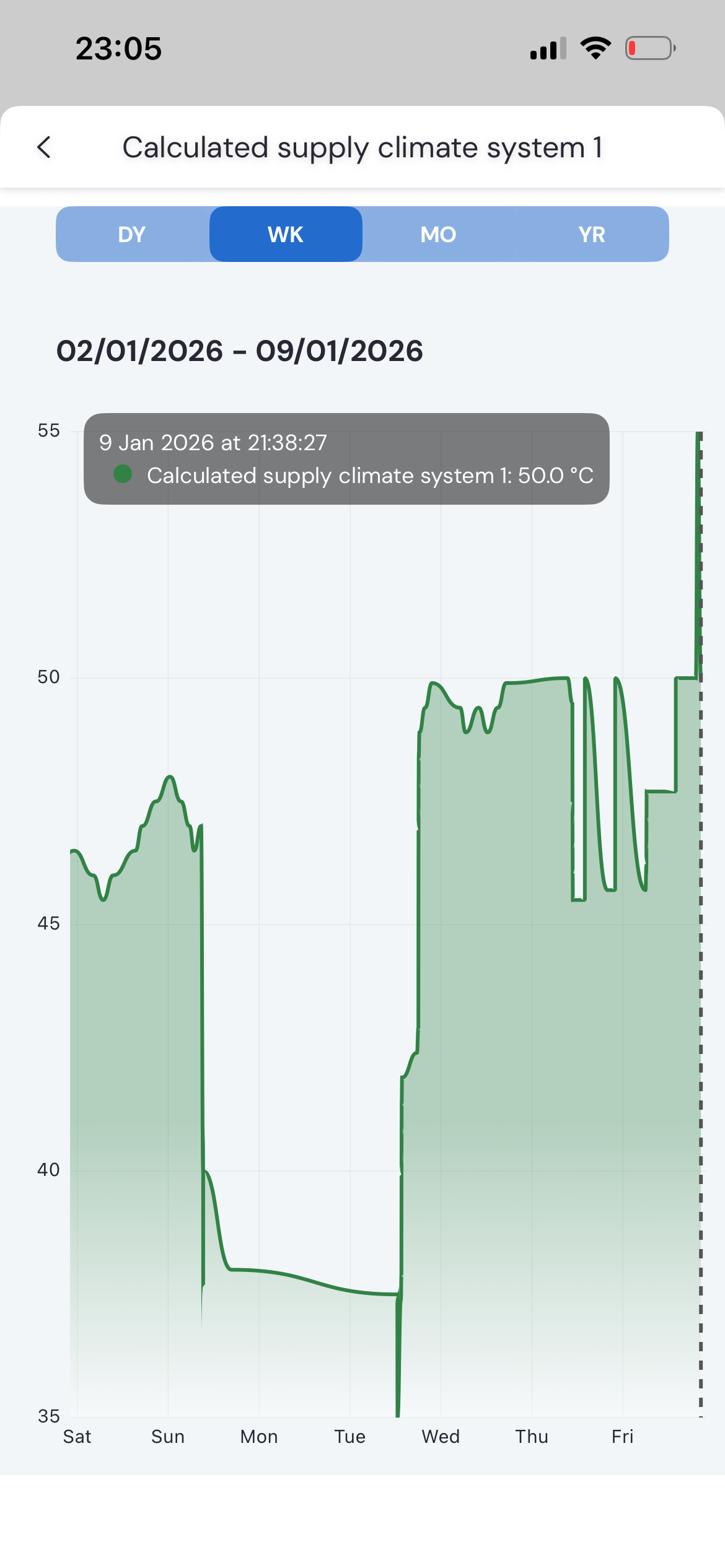

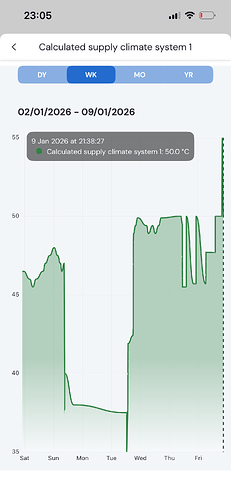

Yes, sorry S1 is dynamic but it is capped at 50. However, due to the weather curve and the outside temp this has been at the ‘cap’ pretty consistently over the last few days with actual supply temp never reaching it (ignore the blip to 55, this is where I was checking that the highest supply heat setting did limit this). I also have to confess with altering the heating curve earlier in the week to try and see if this kept the heat pump on more consistently (at a lower temp) to supply more heat to the house (I did warn you I was a newbie)…

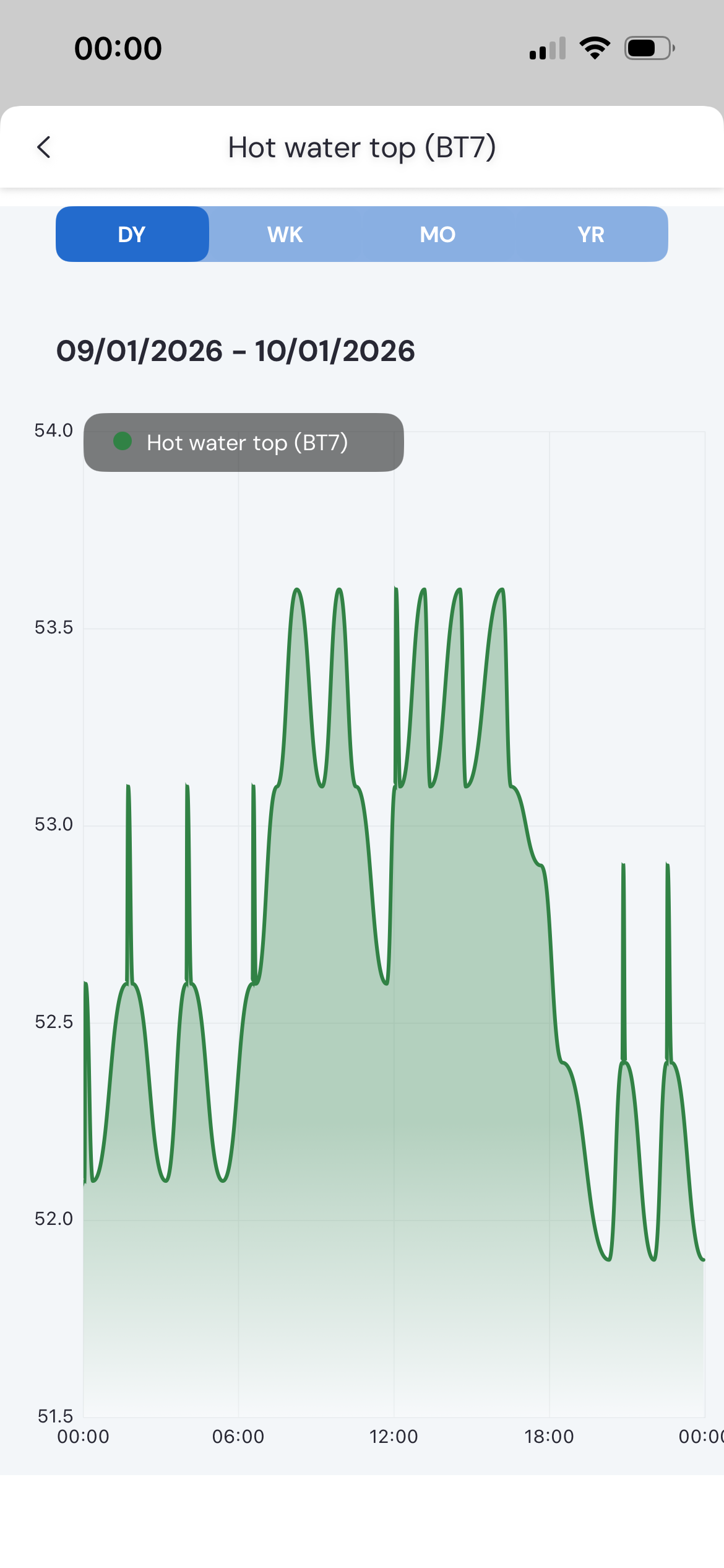

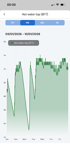

I think I might have found something that looks suspicious…
there hasn’t been a hot water heating period today (according to oem) yet the bt7 hot water temperature looks like this:
And the week:
I wouldn’t expect the hot water temp to fluctuate like that - am I correct?
Could it be an issue with the valve where the hw is being heated at the same time as the heating? Still not sure why this explains why the supply temp isn’t getting above 35-40 but I’ll check the valve in the morning.
Thank you, it’s starting to become clearer how you’re set up.
with your target at 50 but your flow never getting there, this explains why you spend a lot of time in significant negative degree minutes. If your flow (which is the same as BT25 for you) is below S1 degree minutes keep counting down more negatively.
It seems your curve isnt helping you because something else is going on which prevents you meeting the flow temperature specified by the curve - I think your curve is too high but we likely need to look elsewhere before fine tuning the curve

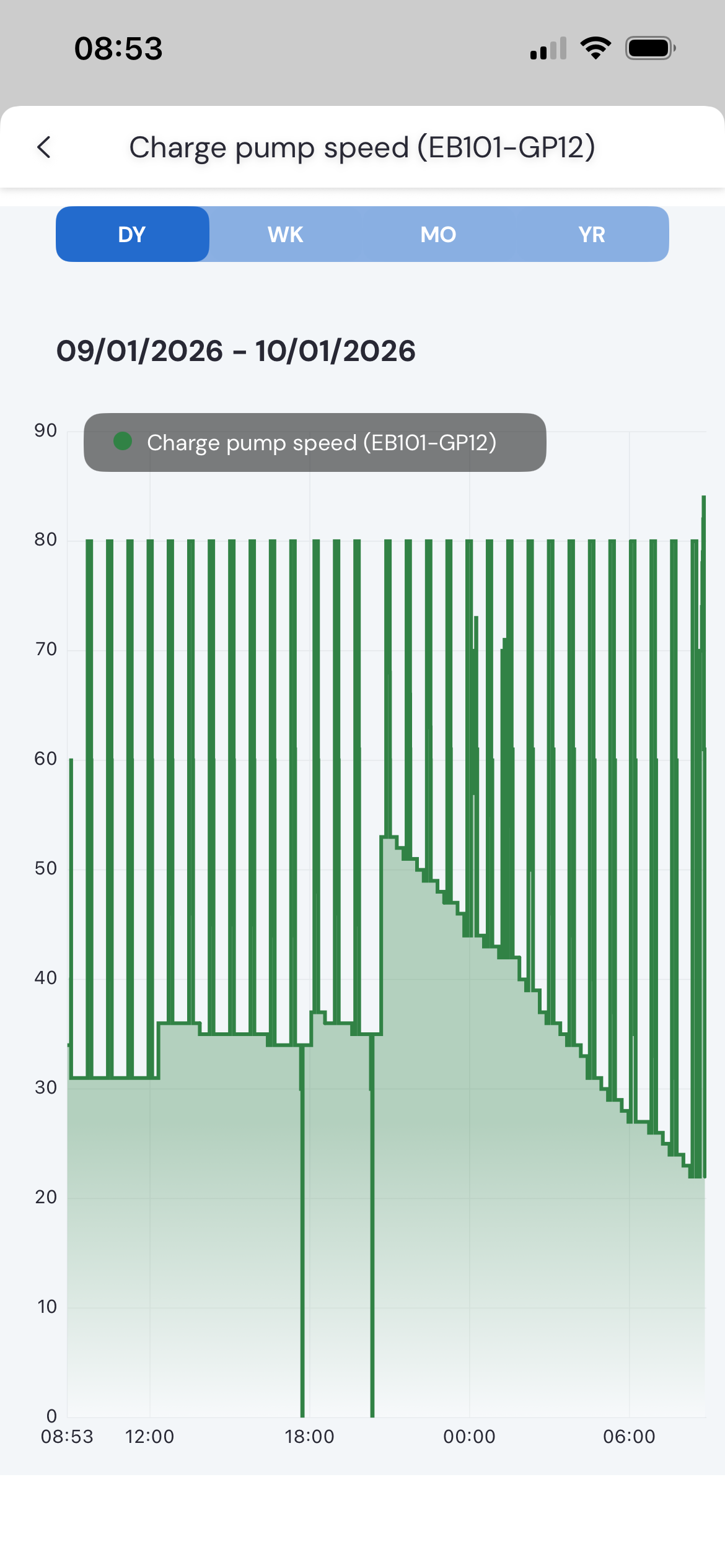

can you drop in some graphs of your charge pump speed (this seems to be the only circulating pump you have on your system) and also your flow and return as seen by the NIBE heat pump (BT3 and BT12) - I can see it from the OEM kit but it’s useful to see what the NIBE thinks.

  • S1 is high but seems eminently sensible for the Curve and Offset you’ve got configured
  • The highly-negative DMs are a natural consequence of BT25 being consistently lower than S1 for hours on end (rather than alternately above and below S1 on each cycle)
As Sam noted already, it’s odd that the Compressor stops before the DMs rise to 0, so ‘something else’ must be making it do that.
The Hot Water temperature changes reported by BT7 do seem odd and an issue with the diverter valve is a possibility. There should be some sort of indicator arrow on the valve head. Can you see that indicator and does the valve move as you’d expect when switching from Central Heating to Hot Water?
Do Hot Water cycles generally work OK? Do you get higher flow temps when heating DHW (which would confirm the heat pump is happy to deliver higher temperatures in some circumstances)?
Since the NIBE Charge Pump is the only circulation pump in your system that’s going to be working fairly hard to push the flow through all the radiators and UFH loops. As Sam noted, some graphs of the “Heating medium pump speed” would be great, to see what that’s doing.
David

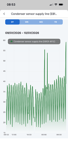

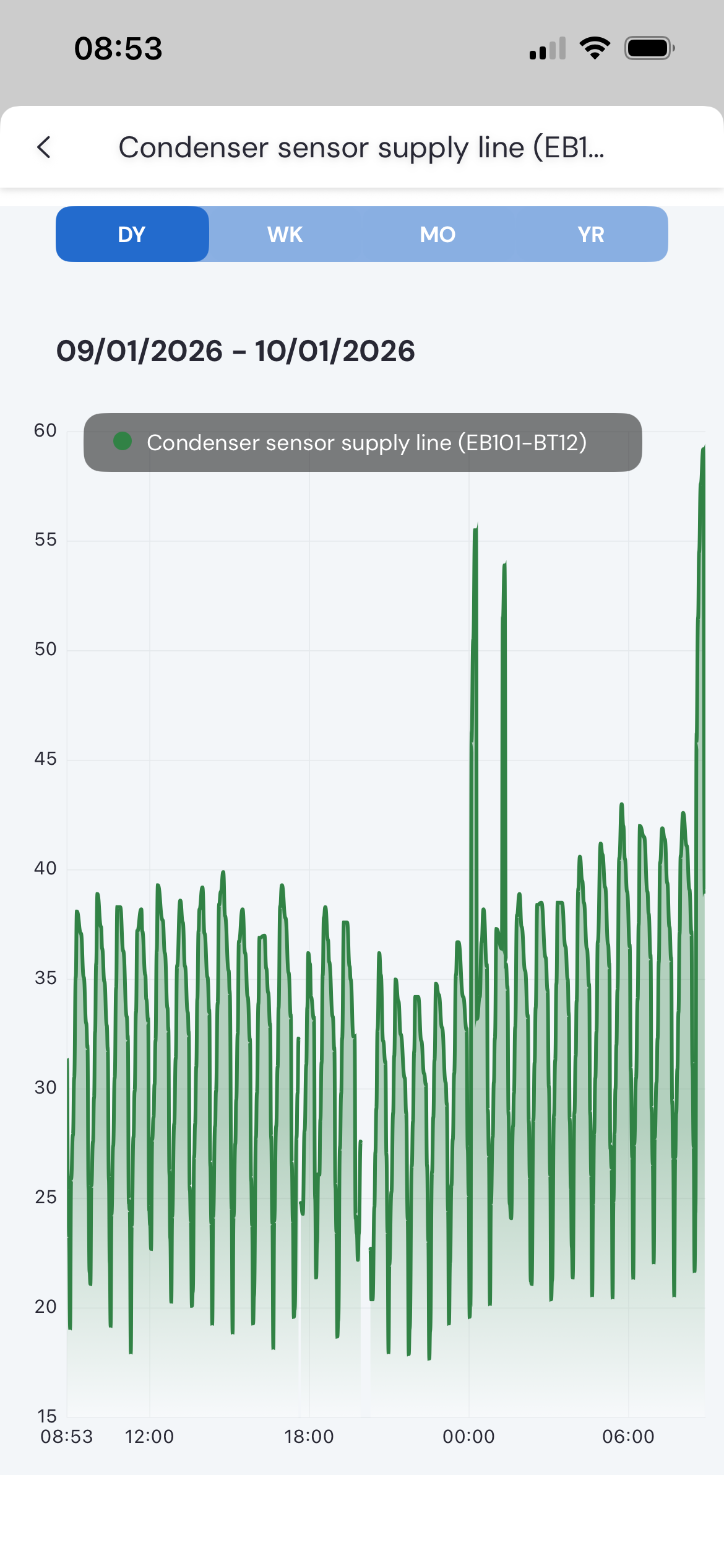

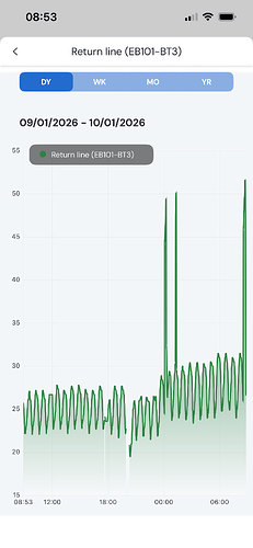

Hi Sam,
Sure - not a problem. I’ve attached the graphs below.
On a side note I’ve been trying to check the hot water diverted valve (by asking for a temp increase in hot water) and it seems fine. It also shows the heat pump is capable of supplying temperature above 50 so it doesn’t look like a catastrophic issue with the heating period pump itself. I’m still slightly confused why the hot water has stayed at a high temp despite showers / baths.

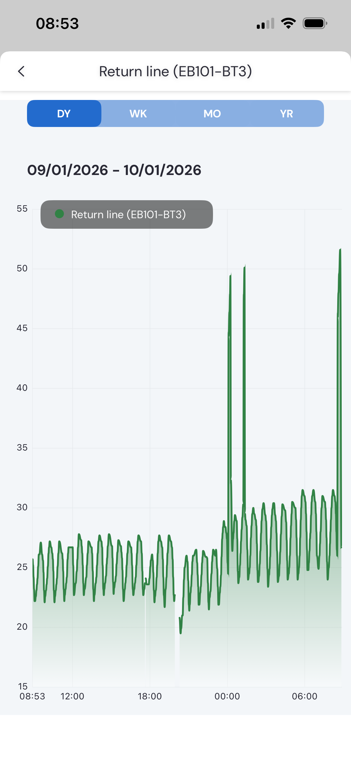

Here are the graphs:
BT3 - 1 Day
BT12 - 1 day
Charge Pump - 1 Day
Just let me know if you need longer time period graphs.

Thanks Dave. It’s good to know DHW cycles work OK.

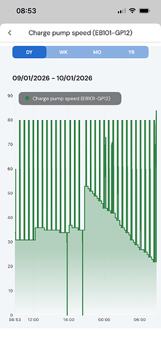

I’m surprised the Charge Pump isn’t being driven harder - seems it’s only briefly peaking at 80% whereas I’d expect it to be closer to 100% whenever the compressor is running.
Could you check the settings in Menu 7.1.2.4 please, for the Charge Pump Speed. If the maximum is set to 80% that can go higher; 100% wouldn’t hurt. You might also want to try temporarily changing it to Manual speed control and forcing it to 90% or 100%, to see if that improves matters.
As Sam noted before, your DeltaT seems a bit high so maybe there’s something odd happening with the automated charge pump speed control (which aims for a specified DeltaT). The settings for that are in menus 7.1.6.n.
I’m no UFH expert but I believe 2 litres/min is a better flow for UFH loops with a heat pump - but I agree that if you can get an ‘adequate’ UFH flow with just the NIBE Charge Pump that’s preferable to adding the complication of a second circulation pump.

So I’ve manually set the pump to be at 100% when the heating is on and if anything has made things worse.

Interesting. That DHW cycle 08:30 - 08:45 looks ‘normal’ and it will be good to confirm you can reproduce that again. Both Flow and Return temperatures are high, and steadily rising (more or less) together.
Presumably it was 09:45 when you forced the Charge Pump to 100%, corresponding to the step-down in the flow temperature. That does makes sense: for a given heat output from the compressor, a higher flow rate through the heat exchanger means a lower flow temperature. However that higher flow isn’t giving you any more heat transfer to the house…
It’s the Return temperature profile that looking the most strange to me. I’d have expected the Return temperature to rise more quickly from the start of a cycle, more in line with the Flow temperature as that increases. I don’t think you’re ever going to see a Flow temperature of 50C when the Return is down below 30C. So maybe we should approach this from ‘the other end’ - why is the Return temperature so low?
My other thought is about Defrosts. Are you able to tell how often those are happening?

This is quite odd.
It would be interesting to know if your heat pump is cycling off or just defrosting. The flow temperature is dipping below the return temperature, this only happens on my system when it defrosts. In your system you don’t seem to have a large buffer tank (or other store of heat) so a defrost will take heat straight out your CH circuits and perhaps explains the flow dropping so low so quickly. Nibe uplink has a messages / error section which usually lists defrost events so if you can find that it could be useful information to tie up with the above graph.
For the time period shown above (when you changed the setting) can you post a graph of compressor frequency, this should indicate what the heat pump is trying to do

Just as a comparator. I run a F2040 16kw unit with a SMO40 controller. I have 8 radiators downstairs and UFH open plan upstairs. Everything is open loop, no thermostats or zone valves with a circulation pump on the UFH manifold and a second one for the radiators, these are separated from the NIBE charge pump by a 3 port buffer tank.
The upstairs is new, lots of glazing but insulated well with SIPs. The downstairs is brick and old, cavity walls with no insulation and suspended timber floors with no insulation and lots of air bricks to keep it nice and cold under the floor.
I have regular defrosts but I’m not linked up to NIBE uplink so I can’t tell you how many.
I run curve 7 and right now my S1 is 36 degrees for a 1.5 degree outdoor temperature. My house maintains a very steady balanced 21 degrees on this curve and flow temperature.
Assuming your house is better insulated than mine you should be able to drop the target flow temp right down to below 40 using curve 7 or 8 and maintain a comfortable indoor temperature. This won’t solve the big delta T you are seeing on flow and return but it will definitely help stabilise things whilst we continue to understand exactly what your unit is trying to do.
