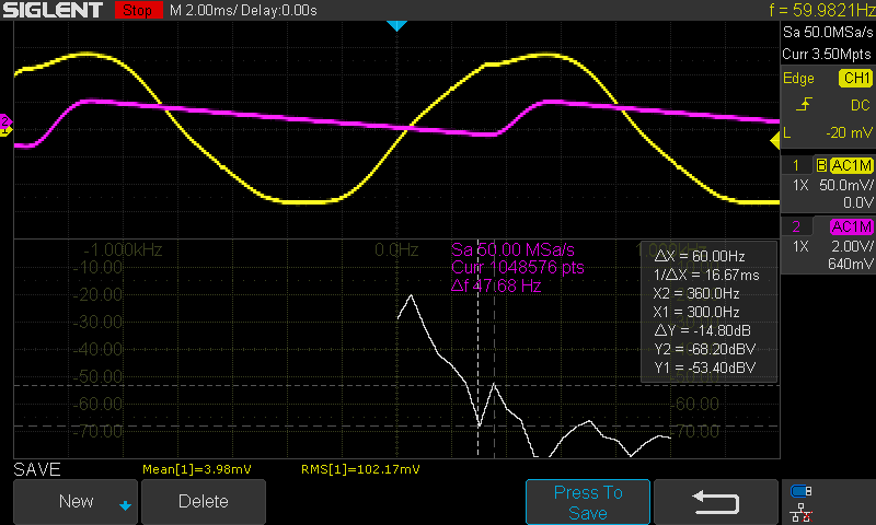

Here is the voltage (yellow) and current (purple - resistive 11A load) right before the input on the IC:

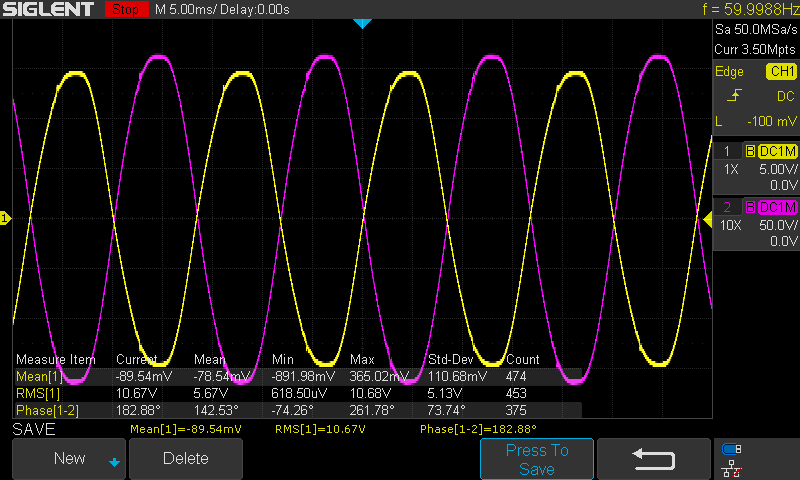

Here is my AC right at the plug (yellow) and a 9V AT not plugged into the meter (purple - different AT from the first test)
What’s the load out of interest? Any idea what’s going on with the purple positive peaks in the first shot? They seem way distorted compared to the Yellow, but only on the positive peaks, the negatives look much better. It looks to be coincident with a little disturbance on the Yellow which might be caused by your DC cap charging up, but I can’t immediately think why that would disturb the load and/or CT output (Purple).
[EDIT] - unless maybe your Vcc is sagging?
The load is a hair dryer. I have to do some more testing, but the positive peak divot may be because of the SMPS, yes. I tried with a 100uf cap, but it isnt stable enough to power an esp32 on startup.

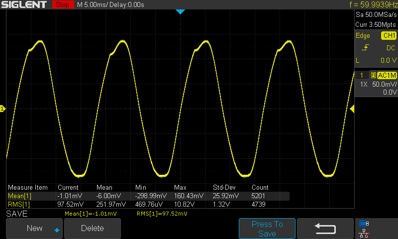

The first capture on this thread was from a previous version. I’ve since added some more caps to the latest, and changed the SMPS to a different IC. This is a capture from the current meter with a ESP32 hooked up:
The divot is still there from the half wave rectifier/220uf cap, but it’s no longer as flat at the top and bottom.
One thing I’ve learned about this IC, through testing different designs, is it’s very good at filtering out noise. I’ve tested this extensively against other meters and it’s always right on.
I haven’t tested this, but if you wanted to only use the AC transformer for reading voltage, theoretically you could de-solder the rectifier (diode) to the left of the transformer jack, and use a usb phone style DC power adapter to back feed 3V3 though the ESP32 usb jack. There’s nothing preventing the 3V3 pin from being back fed.
It can’t distinguish between noise and signal other than by frequency. Generally you pick a cut-off frequency and declare everything above that as not of interest and filter it out. A typical value for that might be somewhere in the 2-10 kHz range when measuring mains power. Can you get your scope to do an FFT of that distorted voltage signal? Is that signal as measured at the input pin of the IC?

Sure! While I was at it, I put a probe on the cathode of the half wave rectifier. The result makes sense. The voltage signal was measured at the input, yes.

What you have there is an absolutely classic picture of charging the reservoir capacitor in the power supply and the effect that transformer impedance and any other series resistance has on the voltage. Apart from a second transformer so that you can separate the functions of power supply and voltage monitor, all you can do is ensure the current demand of the unit is the absolute minimum, and the transformer impedance too is the absolute minimum.
