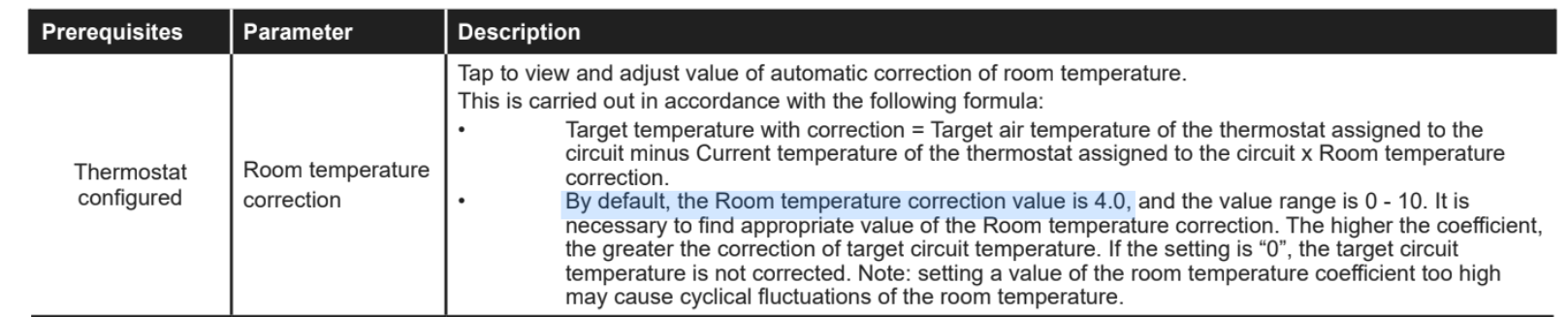

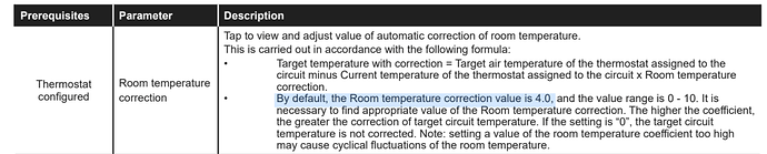

thanks Glynn - te the Room temp correction - mine is set at 0 which is probably the default?

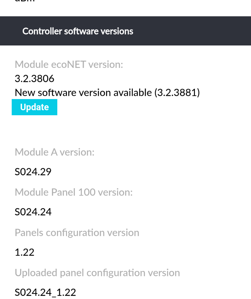

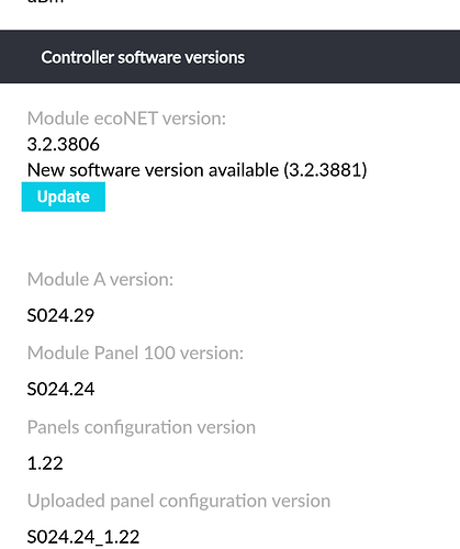

This is the update message, it’s actually in the app..ok to update?
Default is 4C
Yes, this only updates the Econet interface, not the heat pump itself. The heat pump cannot be updated via OTA.

Thanks @glyn.hudson. does the controller show the heatpump firmware version?
I checked in with Grant and they say my heatpump has the latest firmware.. although re update on the app their response is a little less confident..
HI Michael,
This button refers to the cloud software of the app – it has no relevance to your heat pump – please do not press it.

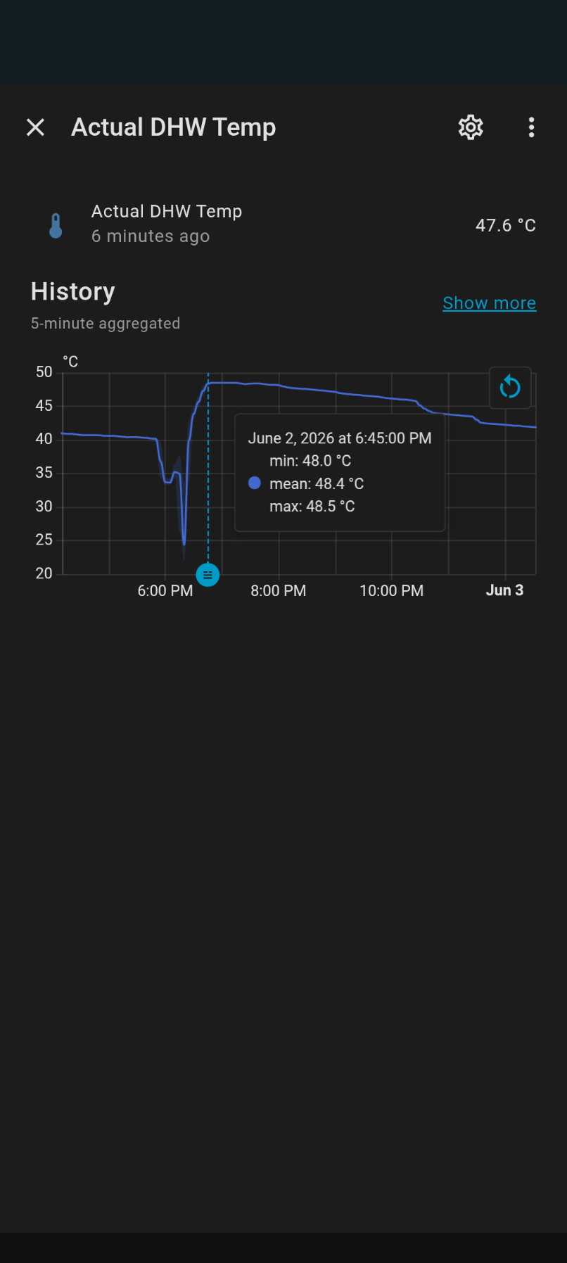

Hi folks, I’ve noticed when the hot water cycle is running the top of my rads can be luke warm. Probably not a big deal but the house is hot enough in the summer without adding any additional heating. Did I read something about the circulation pump running after a hot water cycle has run?
That’s not normal, it sounds like maybe your diverter valve is not working correctly or something has not been plumbed right.
At the end of a DHW cycle the diverter valve will move back to space heating a small amount of hot water will be put into the space heating circuit (about 0.15kW), this is not enough heat to be able to feel any significant warmth in rads.
Thanks I mentioned to my installer and he’s going to check. We have a volumiser, not sure if that makes any difference?
Id assume during a hot water cycle the heatpump water temp is closer to 50 degrees? Our hot water set temp is 48, if it was pumping around both the hot water and rads the rads would feel significantly warm? They are definitely not hot id say like warm at top cold at bottom and I’m not sure if it’s at beginning during or end of cycle.. just need to wait for a hot water cycle to run
The volumiser should only be on the space heating circuit
To achieve a set point of 48C the flow temperature slowly climb to reach about 53-55C by the end of the run. But during the DHW cycle the diverter valve should be diverting all the flow into the cylinder coil. There should not be any flow of water and therefore heat going into the rads during the DHW cycle.
Thanks Glynn, yes for sure shouldn’t be any hot water in the rad circuit. I’ve seen some older YouTube videos where reverse circulation can happen so I’ll ask about that but installer will check anyway. The valve is definitely working as I can see the hot water temps rise in the cylinder during a run. I do suspect it’s a little slow. I’ve set point at 48 and hysterisus at 7 and the run takes about 50 minutes to top up the cylinder. The temp sensor is middle of cylinder..200 litres
