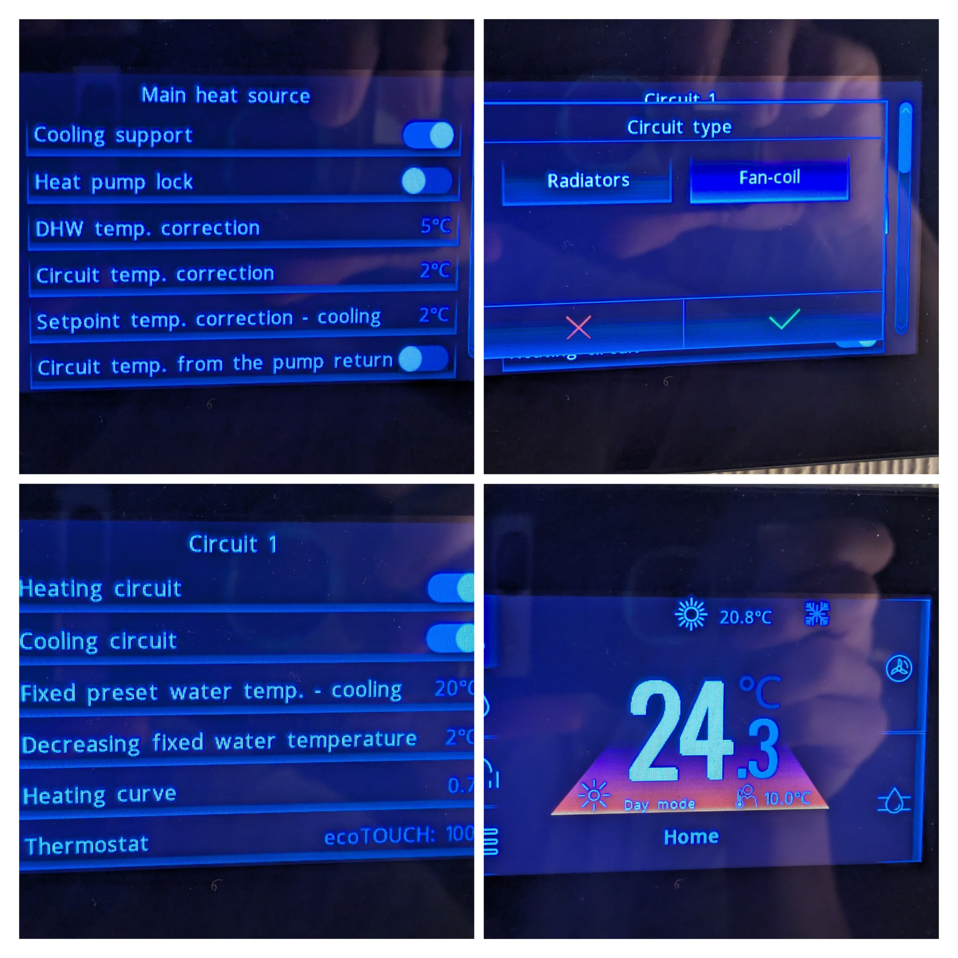

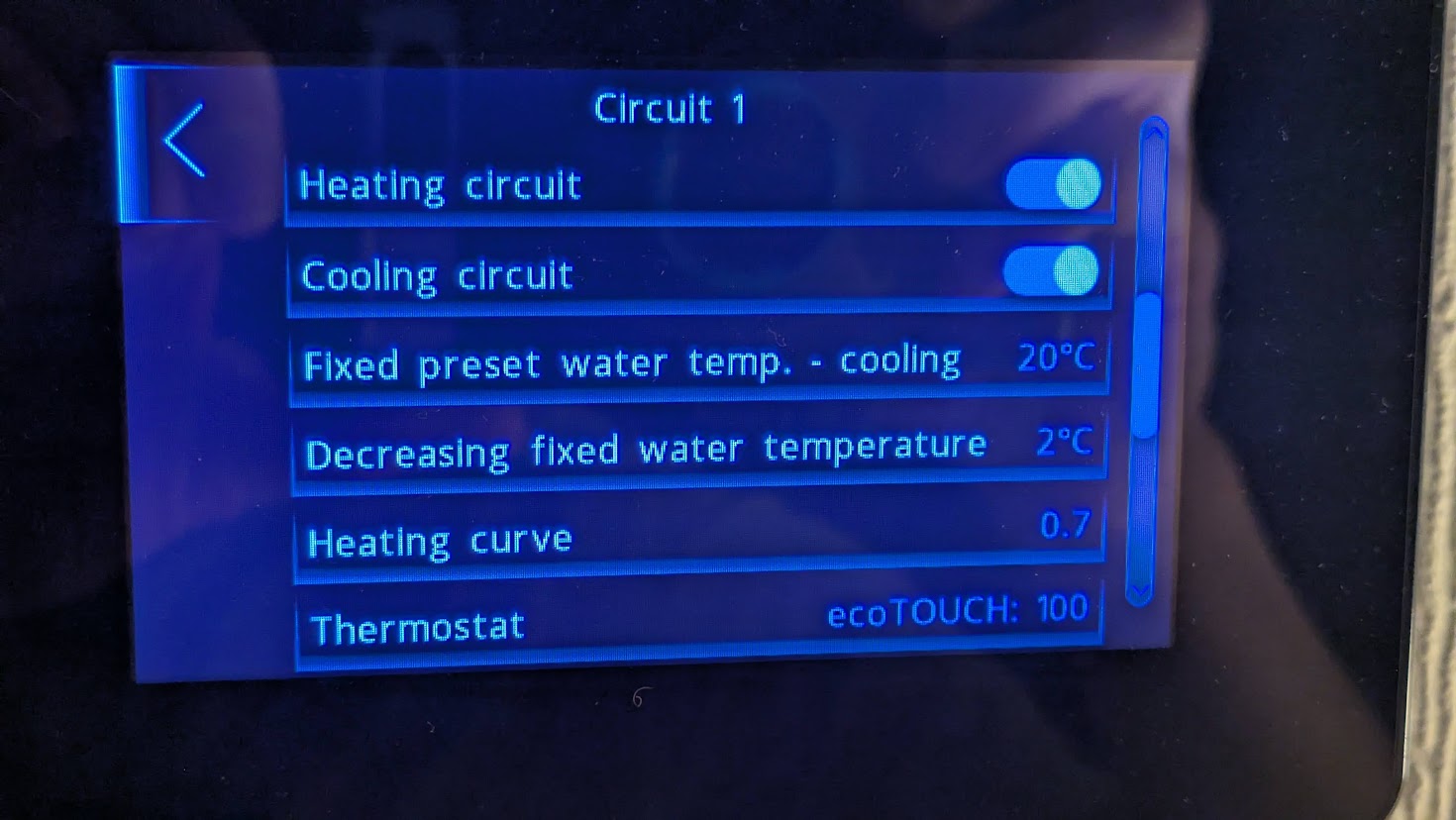

Despite what the manufacturer says the Grant HP290 actually supports cooling ‘out-of-the-box’!
Thanks to @LeeNuss for figuring this out, I followed his instructions and it works :grin:
These steps are copied from @LeeNuss 'a post on the other thread
  • Cooling support needs to be enabled for the heatpump via the 0000 service menu → Main heat source → Cooling support
  • Circuit type must be set to either UFH or Fan Coil - radiator circuits don’t support cooling. (min cooling temp is 18C for UFH, ~7C for fan coil)
  • Cooling needs to be enabled per circuit - each circuit has its own cooling enable switch
  • Operating mode needs to be set to Summer, or set to Auto with the outdoor temp above the summer threshold
I’ve just tested this myself, here’s some screenshots of what these settings look like

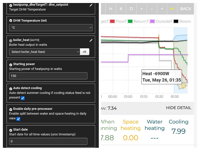

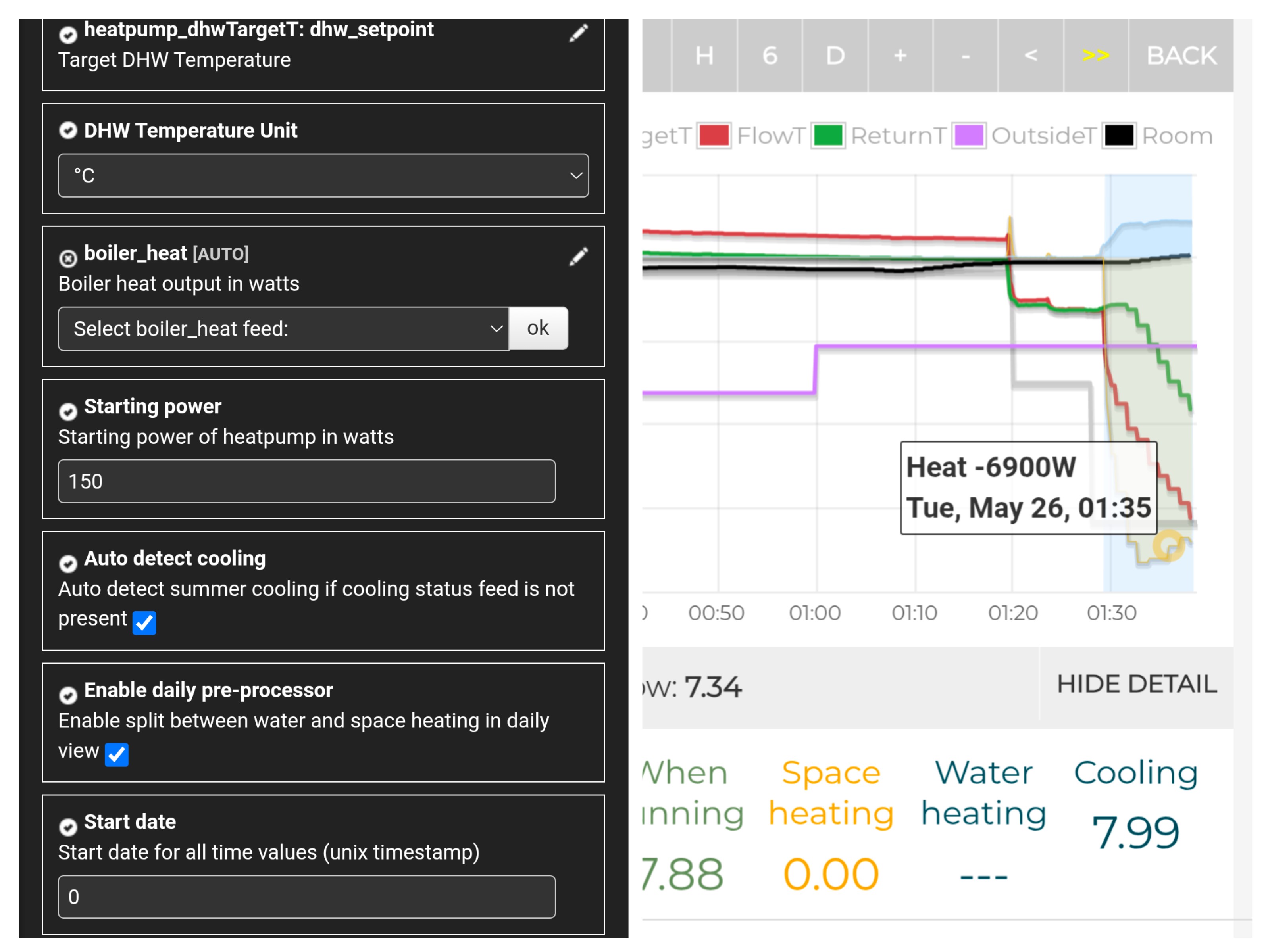

If you do enable cooling, and you’re using our Emoncms monitoring, make sure to enable Cooling Auto detection in MyHeatpump app settings. If you don’t know how to do this, get in touch

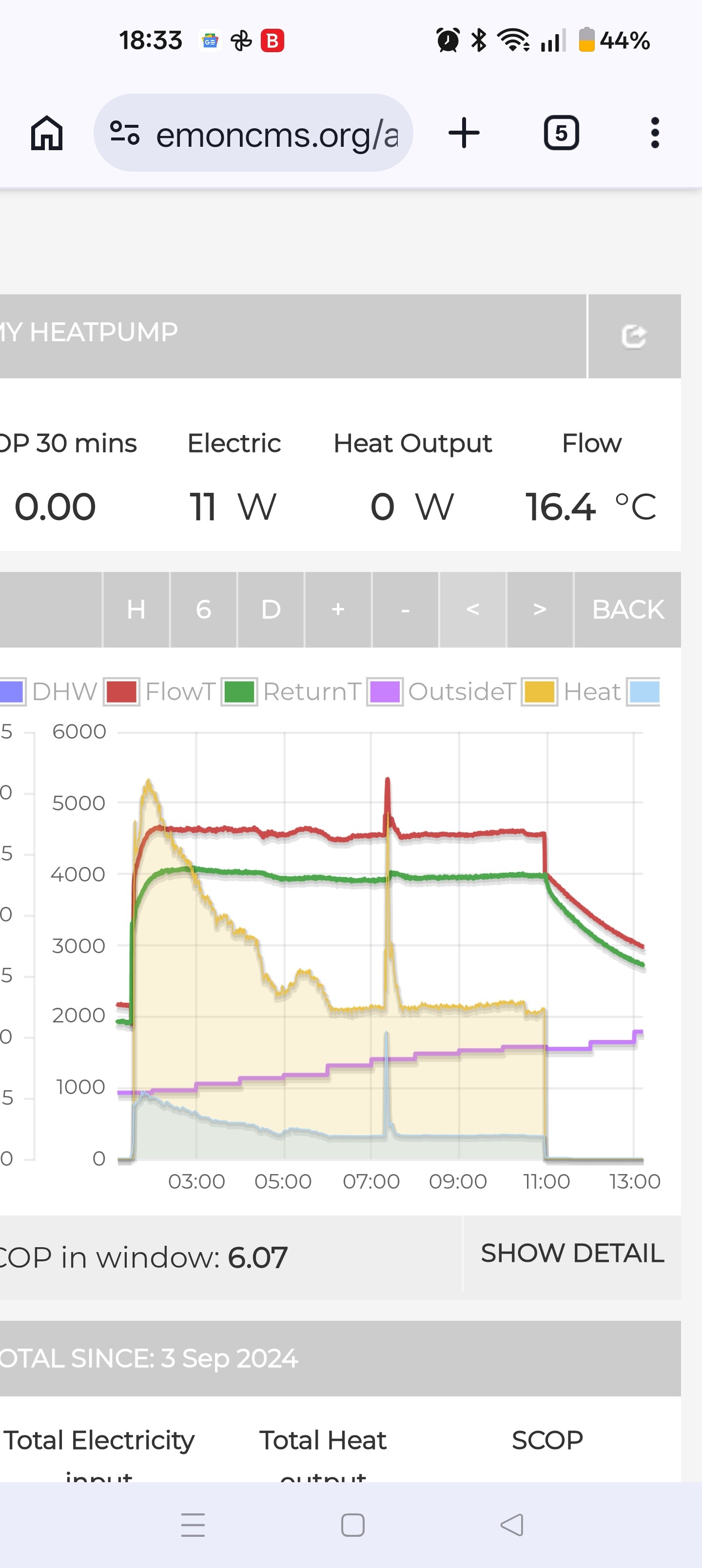

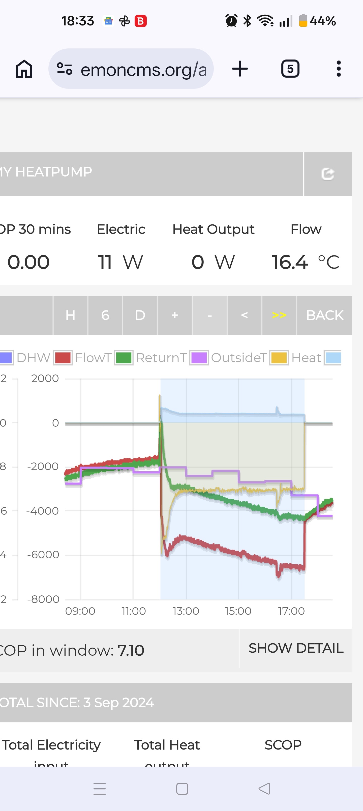

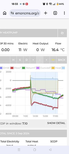

Tried out cooling on the HP290. Great COP, terrible cooling ability with radiators as expected :slight_smile:. Its a real shame there’s no easy way to utilise this feature to effectively cool.
I run fully single zone UFH in thick screed.
Cooling is super simple and runs well. Set to 15 degs it runs for hours and with great CoP.

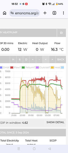

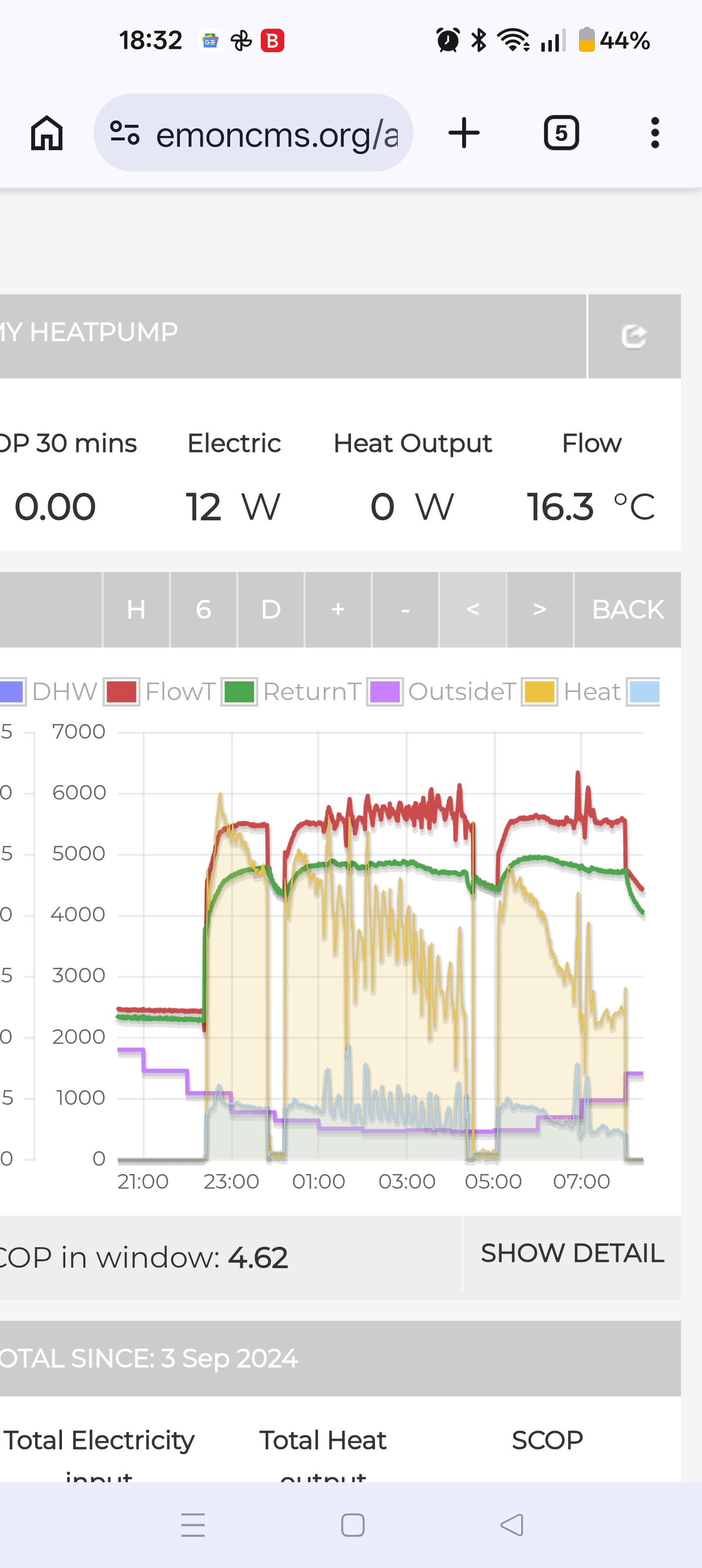

Heating has been a little different, it is almost reluctant to cycle, so will do everything it can to keep running. Even if this means hunting around the set point, which can lower CoP from 6 to about 4.5 or lower.
Think the main issue is the algorithm to control seems to be optimised for radiators, the floor acts as huge buffer and return temp is almost too stable so heat pump does a control change doesn’t see the return temp shift it expects.

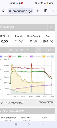

To counter this, my WC curve is almost flat, 26 to 28 degs. The I use a simple thermostat as a start, stop permission. Have set the controller to believe there is a buffer, this stabilised things (I don’t actually have a buffer). Mild day heat pump runs for a few hours and if it’s colder it just runs longer.
Today’s cooling run
A good running mild day
Another day with hunting
I think if I didn’t have great insight to what’s happening with the heat pump, the normal person would see a 4.6 CoP and think it’s running great and not knowing you get better 6+

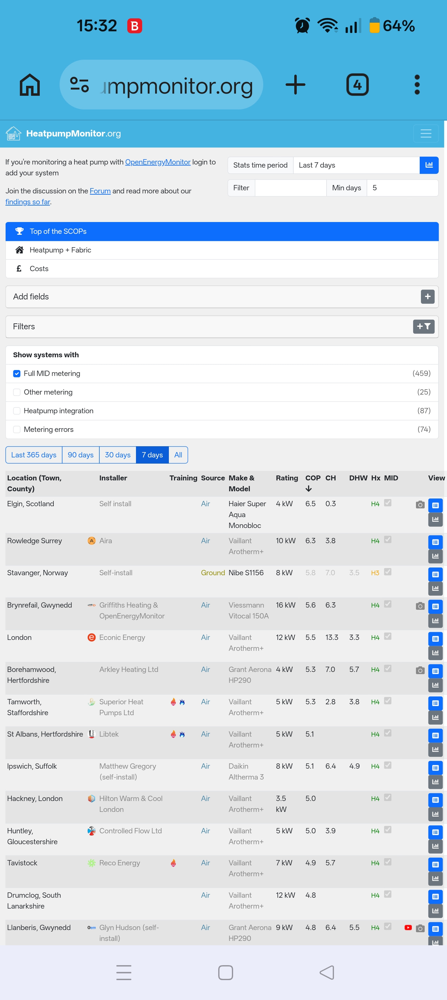

Nice work, is this system on HPM?
It’s No 1 on 7 day stats, No 3 on 30 day, 90 day is catching up.
Great stuff: https://heatpumpmonitor.org/system/view?id=337
