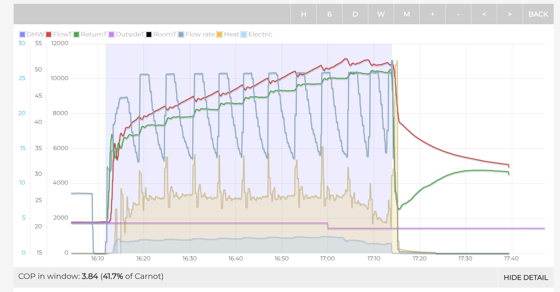

Did you ask the engineer why your circ pump speed is always cycling? Your unit is the only 4kW unit I’ve seen which does this. This behaviour seemed to start after the outdoor unit FW was updated? It’s quite strange https://heatpumpmonitor.org/dashboard?id=717&mode=power&start=1783436650&end=1783442830&flow=1&carnot=0.41700000000000004
Yeah, I agree there’s never been a P03 error on mine and so I won’t see any improvement. I’d hoped he might address the oscillation issue, but it’s been referred up to the technical team. Their previous answer was that it was to do with the flow temps I was running at causing flow to drop and then go into recovery, but this is not the case in the summer time where I’m only heating hot water.

That don’t make any sense, since it’s doing it for DHW. Also, there are other 4kW units running low flow temperature that doesn’t have the issue. It doesn’t seem to affect performance, it’s just a bit odd! Can you hear an audible change in flow rate? I’m assuming you’ve tried to reset the pump speed setting to default?

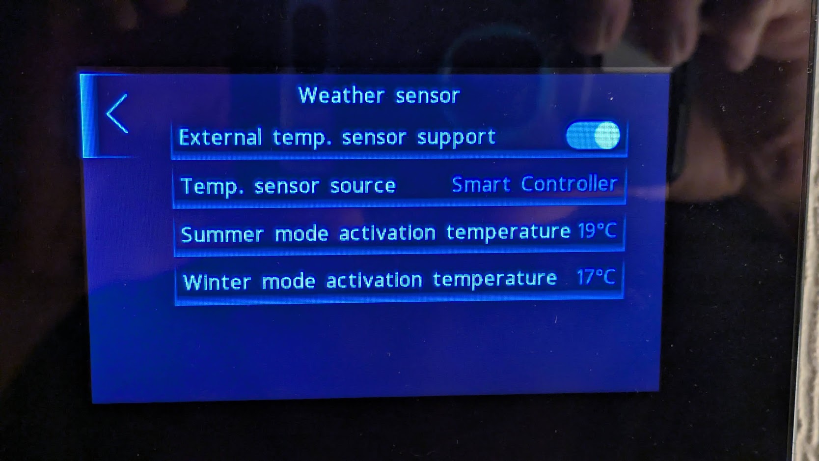

Random unrelated one Glynn (although this seems t be the “Anything Grant R290” thread now anyway! :D) - what are you (and anyone else) doing in the summer with your ASHPs? I forgot mine now has pump blockade off so it’s just sitting there pumping a bit pointlessly, what are you you doing to avoid this, do you just manually turn on pump blockade?
The pump will stop once it switches into summer mode. I’ve set this to happen when the outdoor temp reaches 19C. Then will revert to winter mode when the outdoor temp drops below 17C. The setting for this is under the Weather Sensor setting
Check the mode of the heat pump is set to Auto, so it will automatically switch between winter and summer mode.
Ahhh gotcha, yeh mine is set purely to winter. What else does this setting do? The manual seems very unclear on it!
I think it just a hard cut-off, as soon as the outdoor temperature reaches this threshold it will stop all space heating and switch to cooling (if enabled).

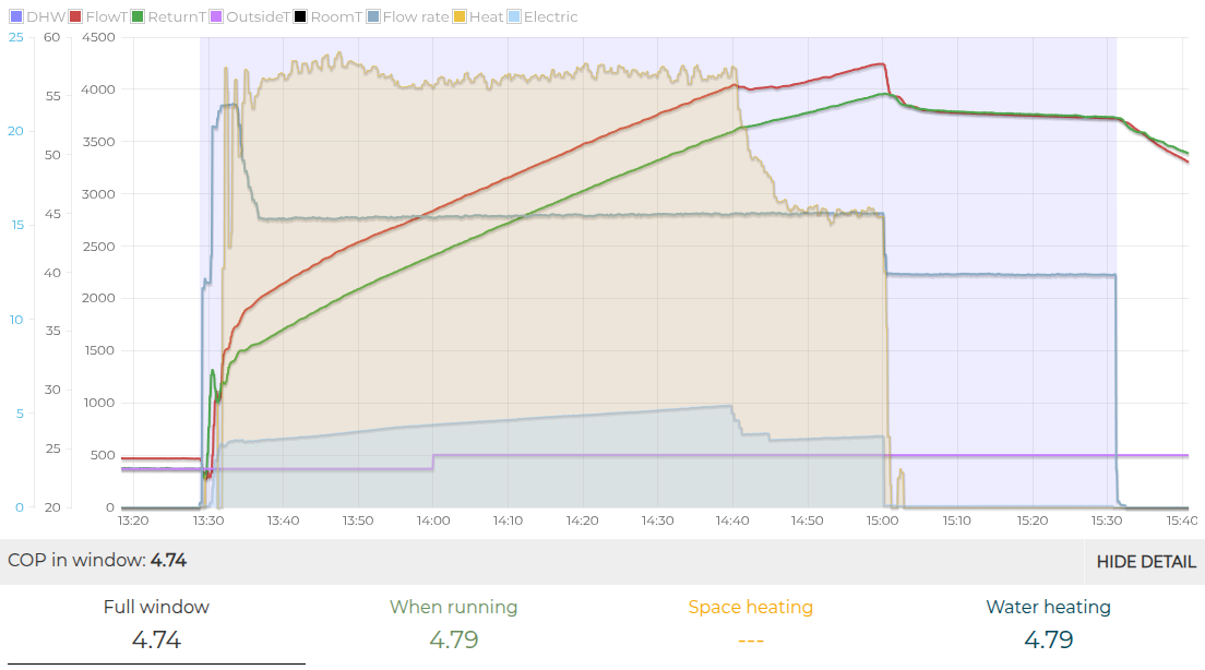

I know this started as a DHW thread :-). Anyway, we finally moved in over the weekend and just have the Grant 6.5kwh up and running. Was surprised to see my DWH cop is around 3.2. As it was 27° i thought i would be into the 4s. @glyn.hudson - I know you have the heat geek cyclinder - do you think this is worth 0.5-1.0 of a COP. We have the grant 300l cyclinder… Hard to get info on the coil size. My target temp is 45°, cyclinder is about 6m from the HP. Primary pro on the 28mm pipework. The stat is low enough on the tank, hysteresis is 10. I have silent mode on, but it seems to run flat out at 7.2kwh :man_shrugging:
As well as switching on silent mode you need to set a silent mode schedule to activate it.
Try moving the sensor to a higher pocket, ideally level with or higher than the top of the coil. It makes a big difference for efficiency if the thermocline layer is above the top of the coil I.e the tank is least 80% depleted. Having the sensor lower in the tank, even with a high hysteresis will result in the DHW being reheated when the thermocline is below the coil level.
So I have a solution to the oscillation problem, following up on the reply @LeeNuss added in Dec (that I missed in the thread), I’ve set the minimum flow to 50 and that has resolved the issue. I’ll try incrementally reducing from here to allow the max range possible.
