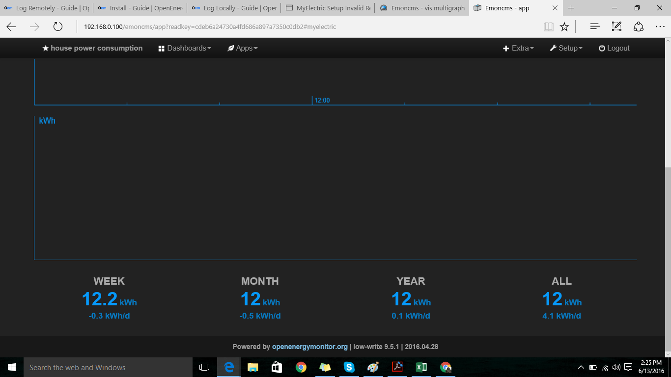

MyElectric Setup Invalid Response Object error
i ready get installed the CT sensor to neutral
but I cant get graph I show you my screens
what would be wrong on it
Regards

It looks like data is not being written to your feeds, the size field should increase at 4 bytes per interval (if 10s 4x6x60 = 1440 bytes per hour). Perhaps the emoncms feedwriter script is not running. You should be able to check this from the Setup, Administration tab

Ah ok, Can you click on Refresh Feed Size on the emoncms feeds page, could you also share a screenshot of the use feed? Im still not sure yet where the issue is located, I will need a bit more information to work it out
thanks … this is the last Refresh Feed Size
I made the creation feed process two times more , and change to 15s , now its getting data on Size as you mentioned before
but I still see this error whitout any data on my electric app

I had few ours on getting data but don’t create any kind of graphic
In the graph view (last screenshot) do you see any data when you zoom right in to the last hour?
Don’t appear any graph on it
but on the feed section appear this
I had this period time connected Window: 17:30 8 Jun > 17:45 15 Jun, Length: 168h15 (605700 seconds) but in the size KB its like stuck on that values and not go up , as you mentioned before that size kb should going up trough the time
its would be a problem in CT ( Neutral ) AC connection or its a issue in my emonpi soft config ?
Sorry I dont think I was clear enough in my last question, can you see any data when you zoom in with the graph view at address: 192.168.0.100/emoncms/graph/13? Your screenshot shows the last 7 days, there may be data visible if you zoom in to the present day.

Some Graph start appear in my electric app
As you suggested I play with zoom and I can see this
let me know your opinion about

I still cant create bar graph in my electric app ( last graph showed )
