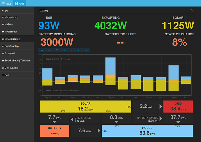

Hi, long time user and fan of emoncms here! I’ve just got a battery added to my solar PV system. Is there a document anywhere which explains what all the numbers & arrows mean in the lower half of the app screen please?
I’ve got mine working but struggling to comprehend all the flows exactly. I can’t find this app screen described in the emoncms documents.
Does the app support battery forced export?
Here’s a screenshot zoomed in on the Octopus Flux Export peak period. The battery is force discharging at 6.4kw. I don’t understand the box I’ve circled in red, 12.3kwh going where?
Hello @butako1 good spot! I agree there is something not quite right there. I am planning to do some work on this app soon and will take a look at this then.

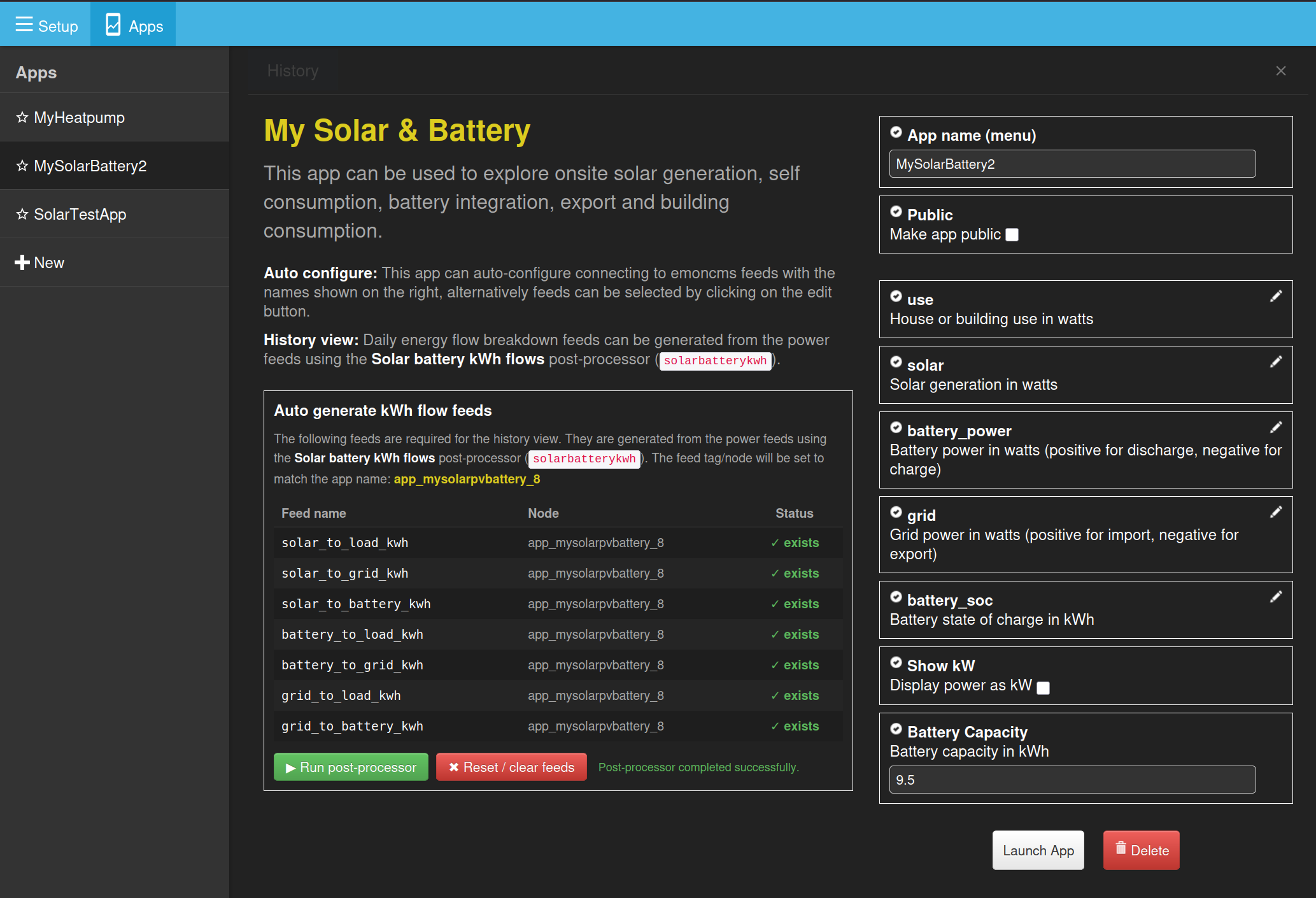

There is now a development branch that adds support for battery to grid / export, the calculations are fixed in the detailed power view so far, I still need to fix the historic daily kWh data view. Im also trying to work through a simpler way of setting up all the feeds as it does get very complicated!
Daily history mode now matches the power view (in the mysolarpvbatteryfix branch for testing):
The app now requires the latest version of the emoncms post processor module and generates the kWh feeds for this on the fly when you load the app, a bit like how the MyHeatpump app builds all the daily summaries.
This reduces the feeds required when configuring the app to only the main power feeds.
See in the screenshot the power feeds selected as usual on the right and a new section for auto generated feeds on the left.

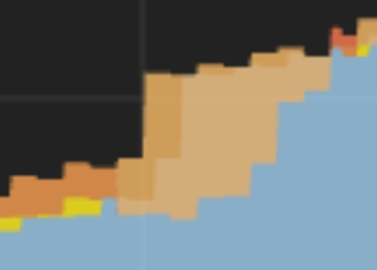

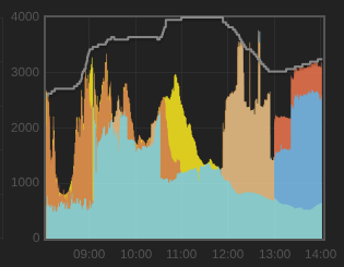

I’ve been trying out this new branch, as it’s one of the apps I look at every day. The main power view seems to work well. I appreciate the switch to common terms like battery to load, solar to grid, etc, though it’ll take a little getting used to. I’ve added some suggestions to the pull request.

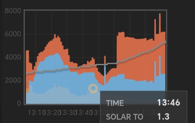

My one complaint is the solar to load colour is hard to differentiate from grid to load, both a pale blue.
Edit: the battery to load and battery to grid colours are also very close:

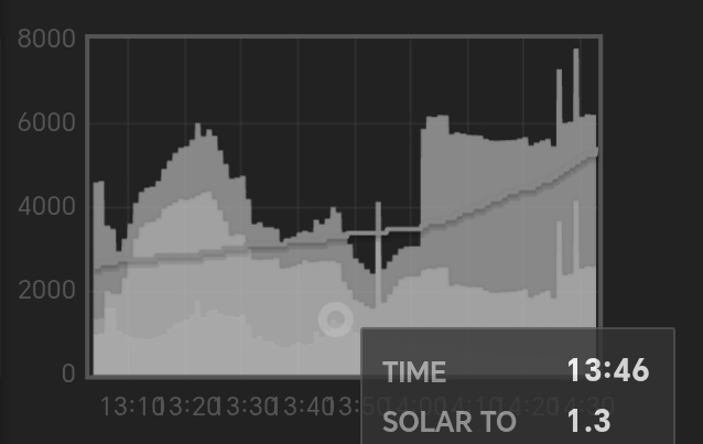

What happens when all the colour is removed is…
Switching to cyan #aaffff seems to work better, IMHO:

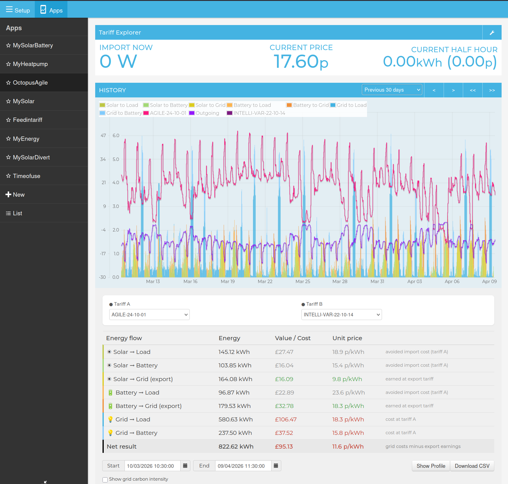

The Octopus Agile tariff app is also now updated and uses the same core: solar, use, grid, battery power feed approach with post processing. I think the agile tariff app is actually more useful than mysolarpvbattery as it calculates the actual cost/earning values of each power flow on a half hourly basis. I think ideally it would be great to integrate both of these apps into a single app.
I’m actually wondering if I can merge the features of quite a few different emoncms app/dashboards into a single integrated tool that makes it easier to track how well optimised solar, battery, home and tariff combinations are. There are a number of time of use apps for folk with e.g economy7 or other “fixed” time of use tariffs - but these dont cater for solar and batteries - so combining the best of all into a single all encompassing tool might be the best approach rather than having a lot of partial solutions..
What tariff are you on @Timbones?
I’m on a fixed Cosy Octopus tariff. I’m not sure about merging the apps, but if it’s an optional field or toggleable setting I guess it’ll be okay.
Would be really interested to see what the octopus tariff app shows for your system on cosy @Timbones and if the net p/kWh matches your own calcs.
