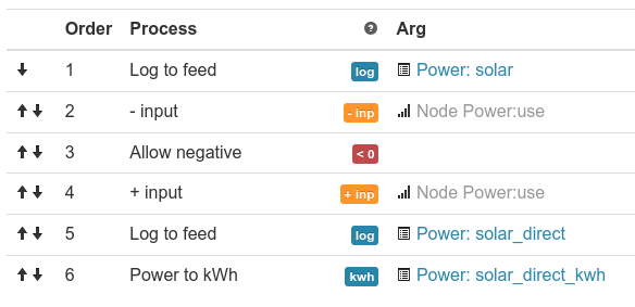

Here’s another way to compute solar_direct using solar and consumption without max_imp:
This will log use when less than solar, otherwise it will log solar.

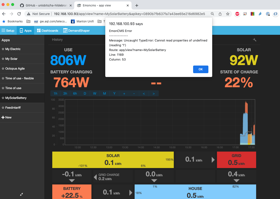

I’m just getting to grips with my Victron battery system and I have the following error when I hover over the graph
Wondering if this is me or a real bug?!

Hi Tim, This may be related to this bug- Improve handling of different feed intervals in MySolarPV battery app · Issue #149 · emoncms/app · GitHub
it seems to be caused when the data intervals aren’t matched in the feeds. I have a similar issue, whenever I mouse over blank data like that I get an error. And the gap looks quite bad if it’s there for a while.
Sorry for necroposting here. I am getting an emoncms error with this App only:
EmonCMS Error
Message: TypeError: series.data[item.dataIndex] is undefined
Route: app/view?name=MySolarBattery&readkey=
Followed by my api key. I’ve cleared cache and used another browser. This is a local emoncms install. What basic thing am I doing wrong? Thanks!
Edit: Same error with online access to emoncms.org.
Hello @homeontherocks this should now be fixed. I have updated emoncms.org, if you update your local app module it will pull in the changes.
Fantastic, it works great now! Thanks!

Sorry to bother again, but the error below is still occurring if I click on the Week, Month, or Year view and hover over the graph.
EmonCMS Error
Message: TypeError: undefined is not an object (evaluating ‘series.data[item.dataIndex][1]’)

I’ve fixed the series.data error. I assume that was with the standard MySolar app rather than the MySolar battery app?
Grid charge should indicate charging of the battery from the grid. Can you give a screenshot example of what is confusing? If the values dont look right, I wonder if it’s feed configuration related…?
So my powerwalls are solar only charged. The only exception would be Storm Watch, which hasn’t happened recently.
Still getting series.data errors but only when the data set is incomplete (ie if I select W and have an entire week of data no problem).
