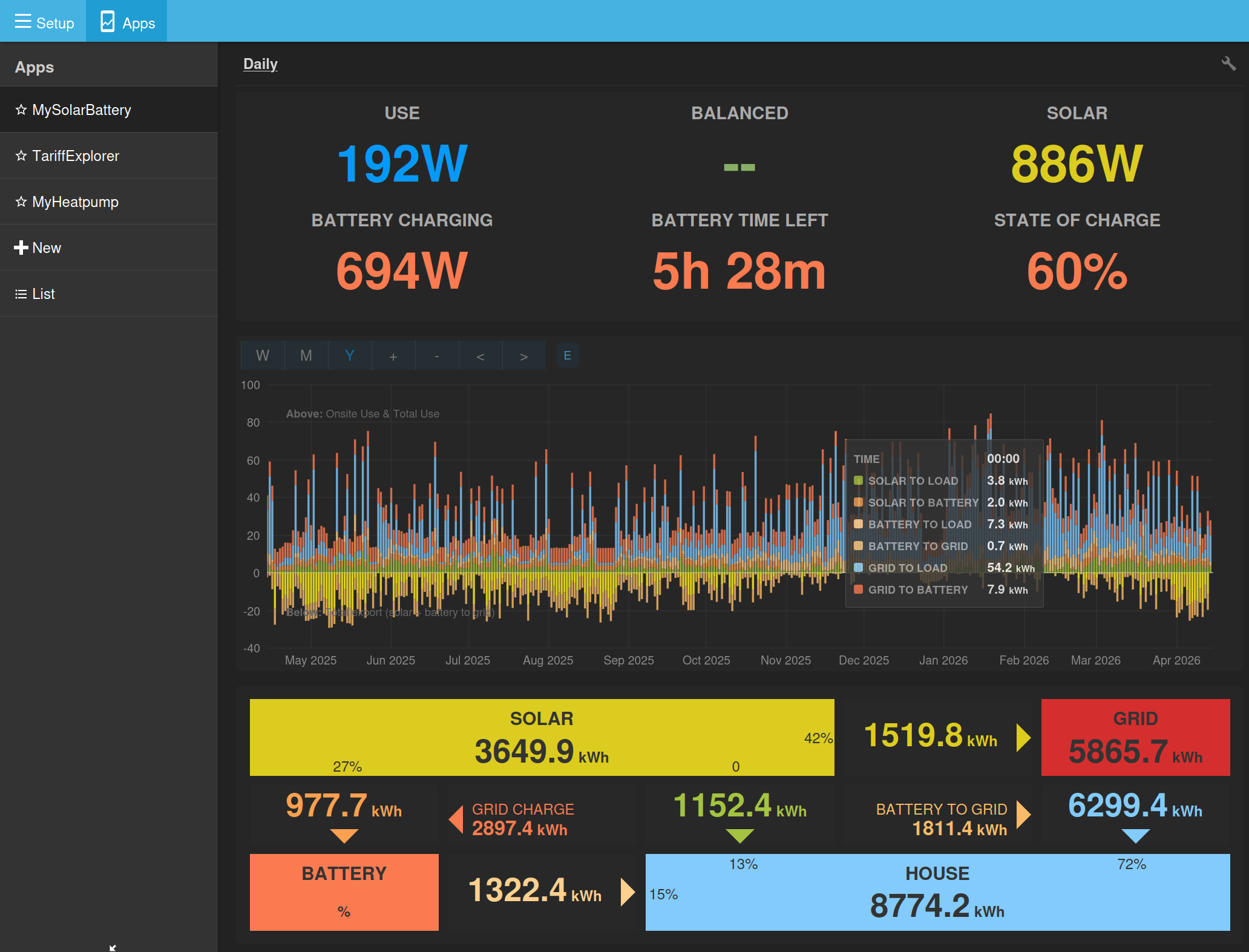

shows the totals in the stats boxes at the bottom
Love it, though you can probably lose a decimal place on the numbers.
Also, daily history includes today, but this will never have data in it. Can this be show up to yesterday instead? An additional shift by half-a-day would also be nice, if possible.
Edit: Iād expect a week to show 7 bars, and a month to show 30.
and uses the tool tip for daily values instead

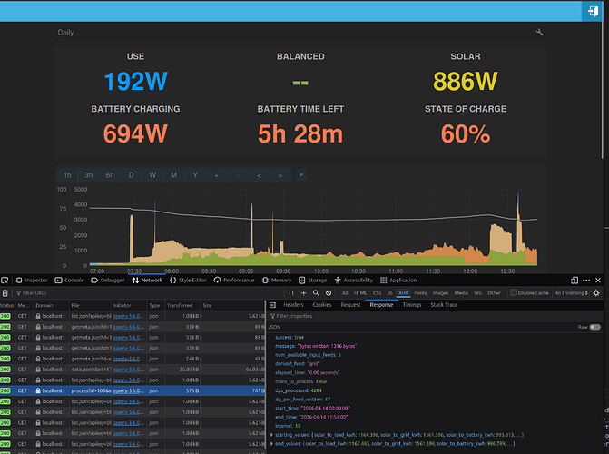

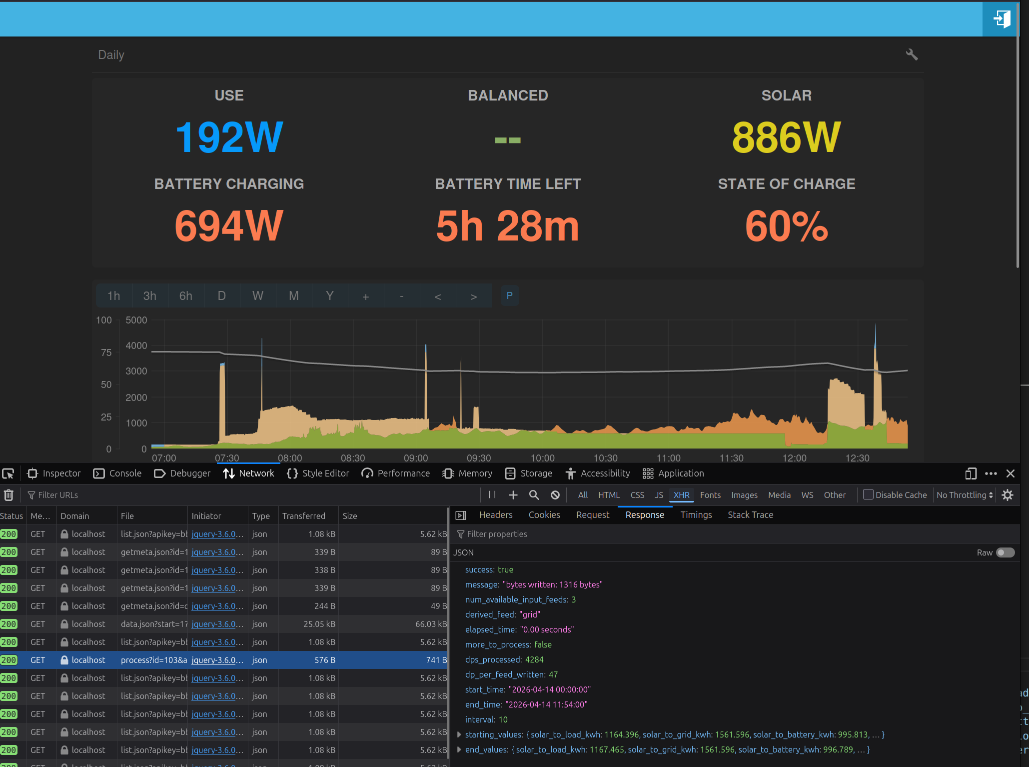

Tooltip is very nice, but is often empty on the daily chart. The bottom 2 or 3 series are usually fine, while the upper ones are usually not. Nothing in the console to say why this is.
Can you check what you see in the browser network tab?
Oh. It is working now. Not sure whatās changed; perhaps something got stuck in cache.

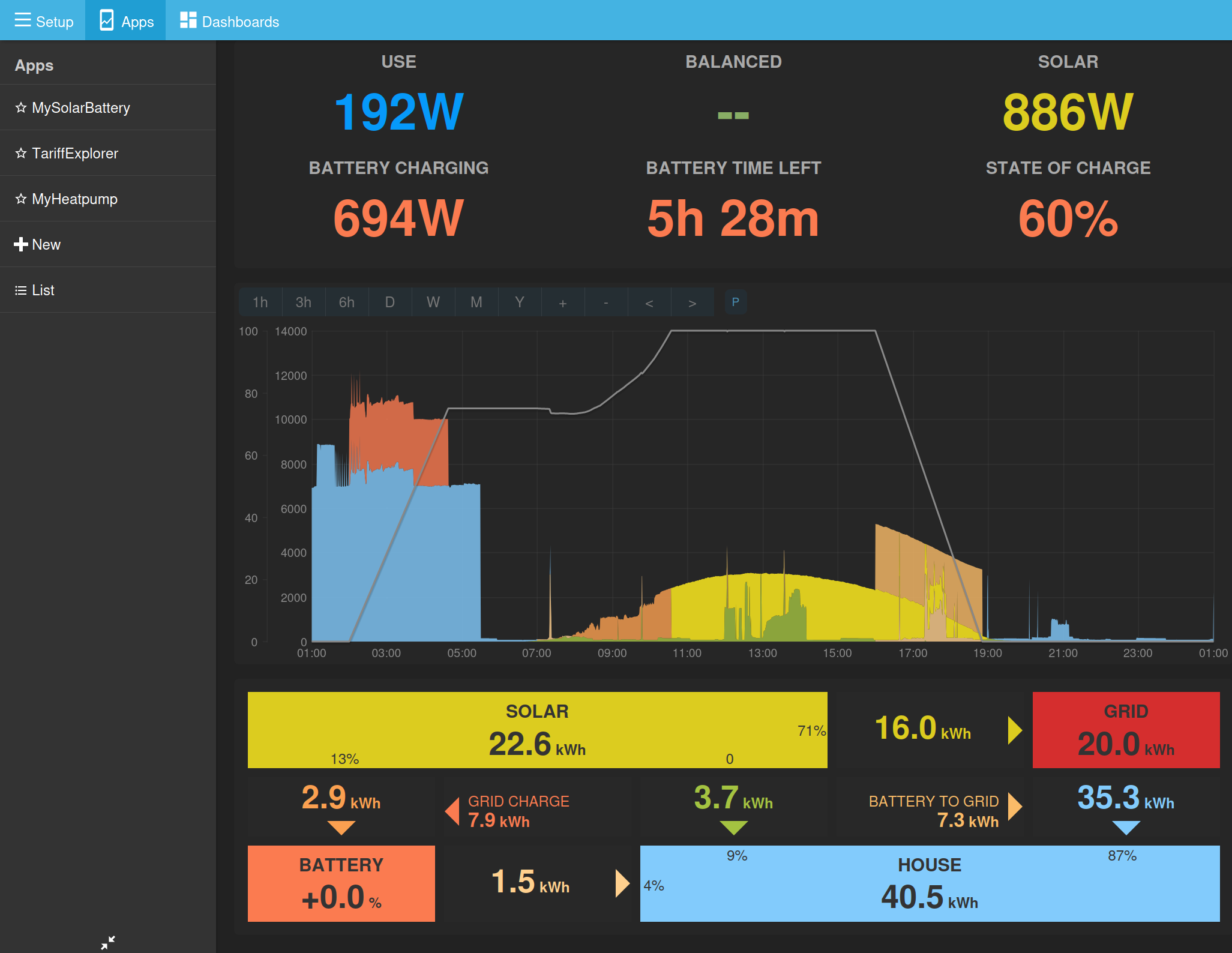

The tooltip only shows when the mouse is near a data point, and not when in the coloured area between points. Given that the contents of the tooltip is the same for any series at a given point on the X axis, can it simple appear all the time?

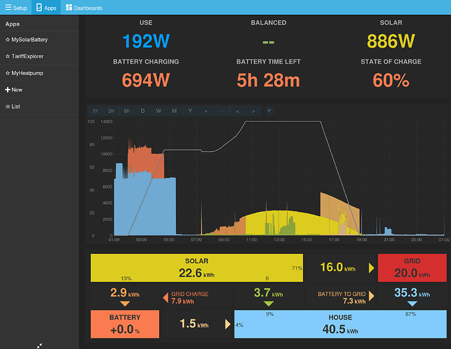

I applaud your creativeness and ambition, but there is something that has been troubling me for a while which I havenāt been able to express clearly enough, so I have kept (mostly) quiet about it. Adding heat pump and/or divert to the app is only going to make it worse, so now I need to have a go at explaining it. Here goesā¦
A system with Solar PV (and Load and Grid) only is simple to understand, the flows of power are obvious and unambiguous. Introducing a battery, however, also introduces a strategy. How? There has to be some battery control logic - when to charge, when to discharge, and at what rate. In the most basic (and obvious) case the strategy will be to:
Use whatever Solar there is to power the Load
if thereās some Solar left over, use it to charge the Battery
any remaining Solar has to be exported to the Grid. It has to go somewhere.
This is the strategy the app uses to calculate the 3 Solar flows (Solar-to-Load, Solar-to-Battery, Solar-to-Grid).

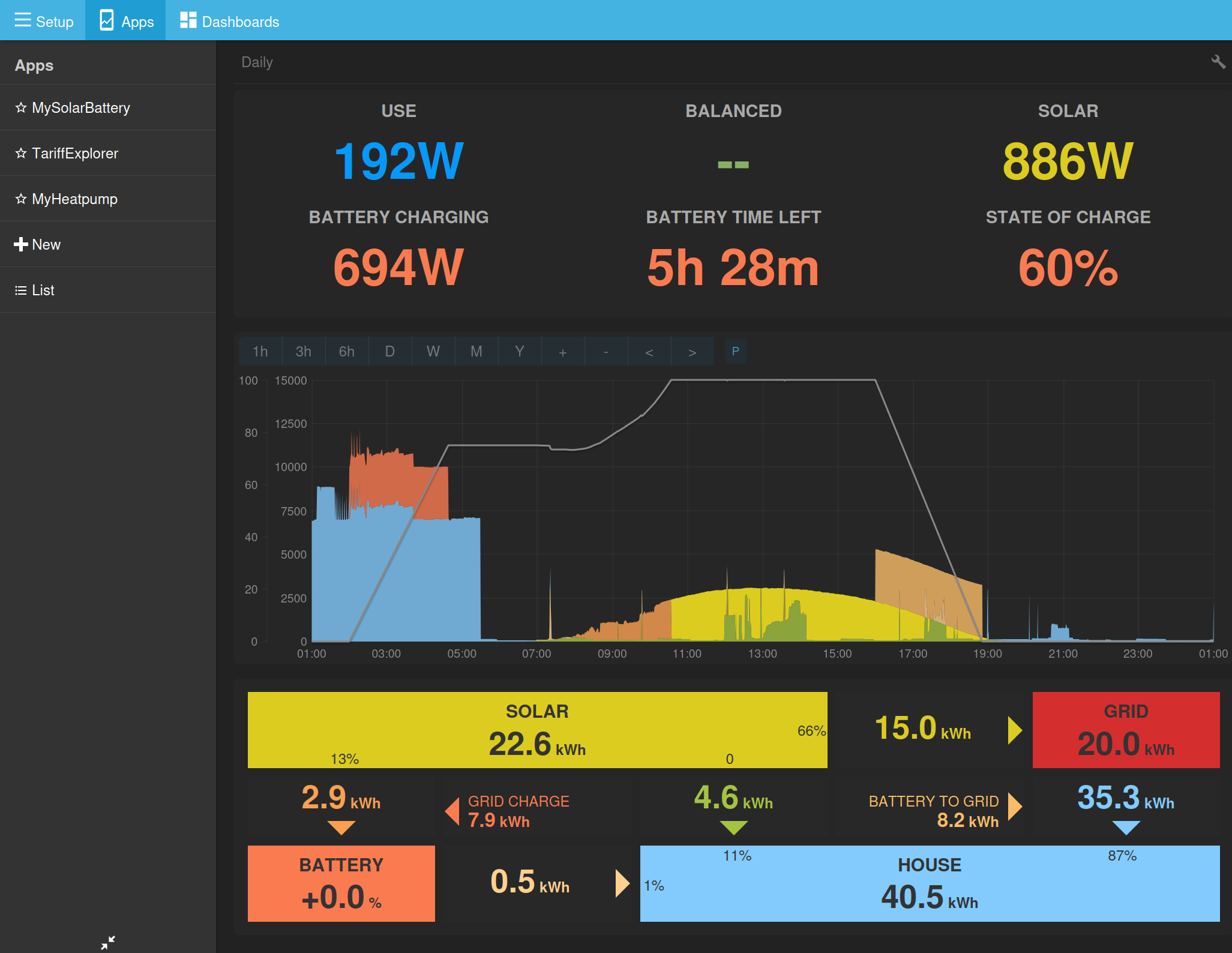

But the world is no longer simple. Many of us employ time-of-use (TOU) tariffs, either fixed (e.g. Octopus Go/Flux, or dynamically variable such as Octopus Agile) and the set of 'Intelligentā variants. Many will also be using the Smart Export Guarantee (e.g. Outgoing Octopus) so that there is an additional value in exporting to the grid.
Battery systems exploit these new tariffs by using a dynamic strategy, which is primarily based on the cost of importing and exporting power to the grid at any particular time and whose goal is normally to minimise cost to the user (others are possible). They do this by dynamically controlling the battery charge/discharge rate - it is the only thing they can control. The result is that the battery indirectly controls grid import/export (within limits, because there is a physically imposed maximum charge and discharge rate).
The problem is that the app doesnāt have any idea about this strategy. So when it allocates power (and derived energy) to the 7 possible routes (solar to load, solar to battery, battery to grid etc etc), it sometimes gets it āwrongā. Wrong is in quotes because itās NOT wrong, the app is just using assumptions which may be different fro the ones actually being used by the system. So itās possibly better to say āmisleadingā.
Does this matter? Partly. It does NOT distort the energy totals generated/consumed by the 4 entities Solar, Battery, Load and Grid. It DOES distort how the flows of power and energy between the 4 entities are presented though. So for example:
ā¦the most striking area of concern is in the energy distribution section at the bottom, the totals in the boxes are correct. The distribution of energy between them assumes a different strategy from the one actually being employed by, in this case, my Tesla Powerwall battery system. So the energy flow values are not āwrongā, they are different from the ones that the Tesla app will show you (sometimes by a lot) which reflect the Powerwallās strategy. For example the Tesla app will show you that Solar-to-House is 0 kWh, Solar-to-Grid is 3.9 kWh (1.7+2.2), Battery-to-Grid is 0kWh and Battery-to-House is 3.1 kWh (1.0+2.1).
Of course the Tesla app can do this because it is the one who is controlling the battery charge/discharge rate - it has āinside informationā. Incidentally Tesla historically have not been very obliging when it comes to sharing such information via an API for example, so thereās no potential solution there I donāt think.
Of lesser concern is that the realtime graph and tooltip show the app-assumed values which are different from the flows reflecting the batteryās strategy.
So again, does it matter? For me the main issue is that anyone using this assumed flow information literally might be being misled over how their system is operating; and one of the biggest benefits of this app is that it helps people understand their systems, and in this case it is compromised. Of lesser concern is that I personally just have to remember to ignore all the flow information, which means I have to interpret the colours of the realtime power graph differently and I probably wonāt use the Daily charts at all.
I donāt know if this is possible or likely, but people might also try and attribute monetary values to the different flows, and it could be easy to get them wrong.
I know @Timbones has observed this issue too. I desperately wish I could offer even the bones of a solution, but I canāt.
My one remaining question is this: is it better not to show the flow information at all, rather than displaying potentially āwrongā information?
It is this issue that caused me to stop developing this app to include Diverts a few years ago. Adding heat pump is, as I said, going to introduce yet more assumptions I fear.
Apologies for the ramble. I think itās important.

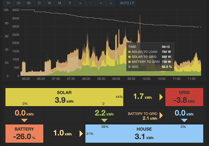

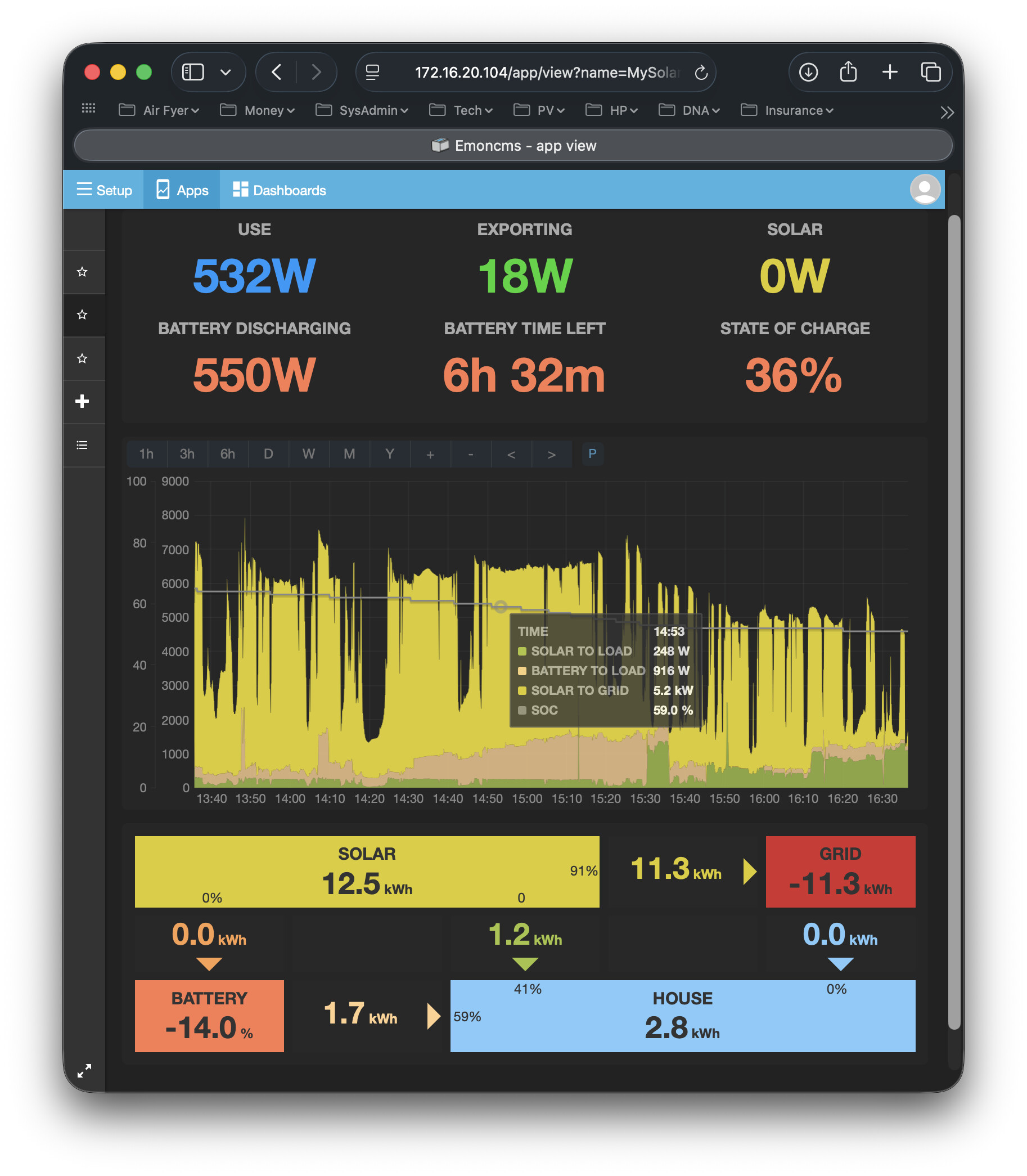

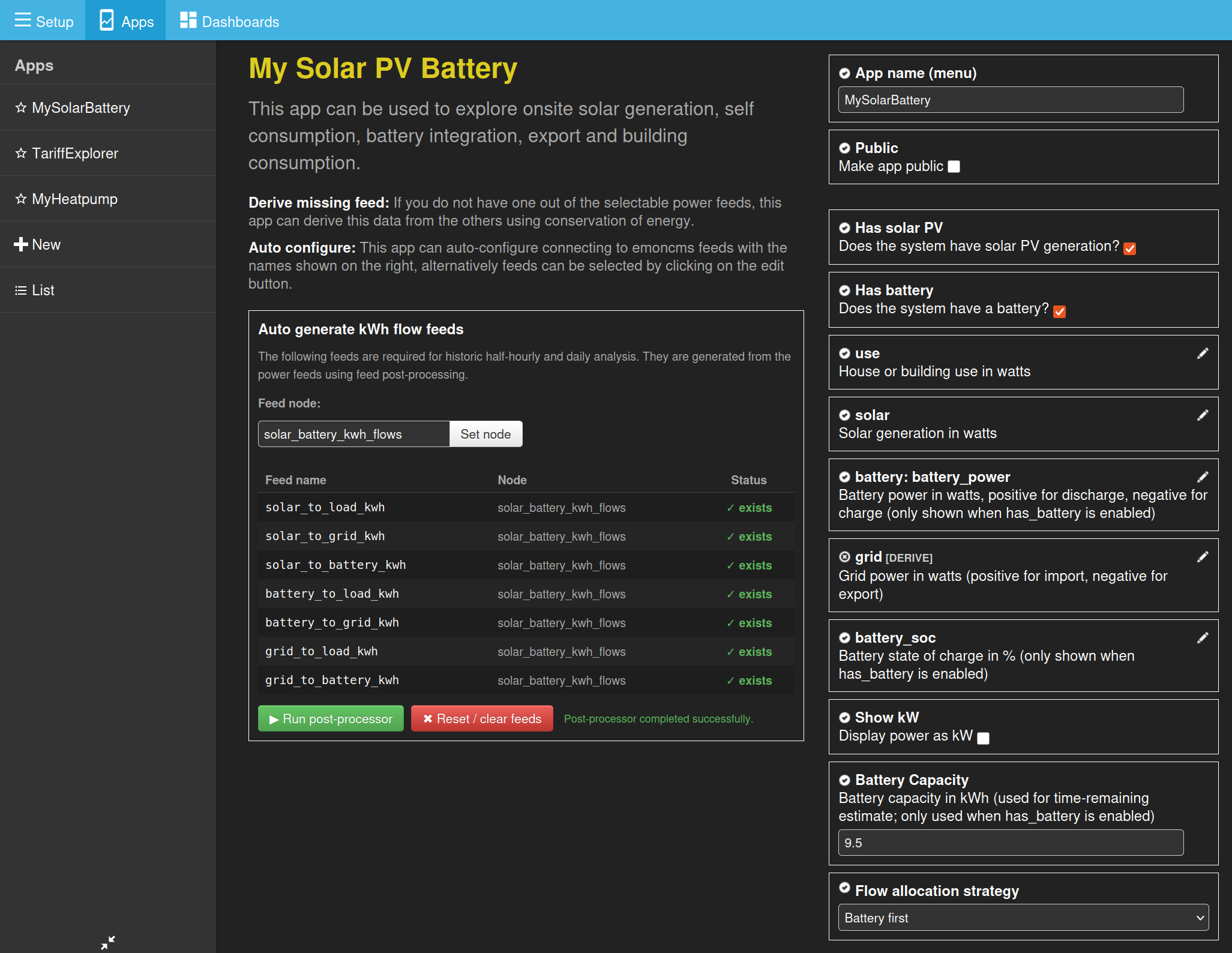

As a preliminary test, Iāve added the option to select between āSolar firstā and āBattery firstā:
I wonder if you could test this on your system? You will need both the latest mysolarpvbattery branch and the latest postprocessing module. When you change the selection, the history feeds need resetting and then reprocessing.

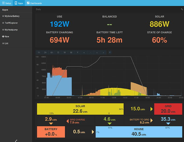

An example:
Solar first:
Battery first:

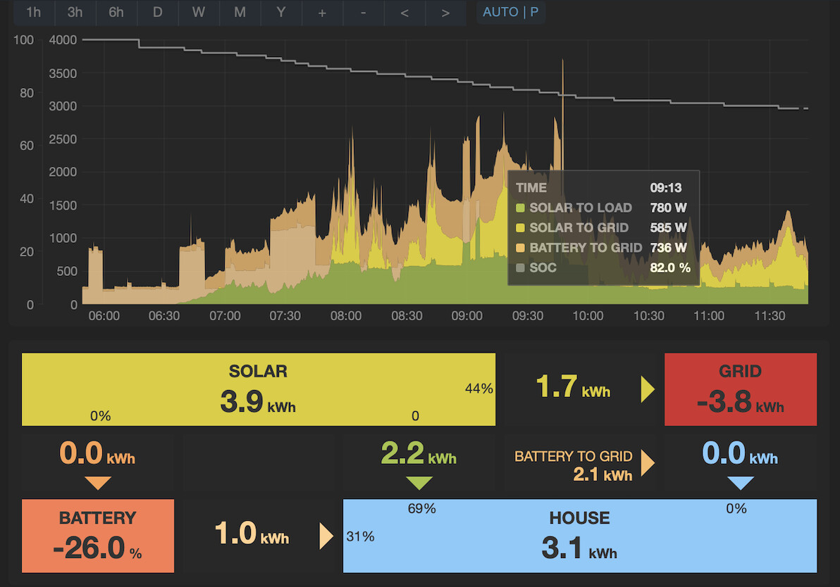

Notice how a bit of that battery output around 17:30 gets allocated to load first and the solar gets exported instead.
Interesting @TrystanLea. It definitely shows different behaviour - in the right direction - but Iām not sure the values are right yet. The tooltip colours donāt seem to match the graph though?

This makes no difference to me. I created two identical apps with different strategies, and they look the same to me. I think itās because I never export from battery, only solar. I cannot find any combination of feeds that looks any better than what the app already does.

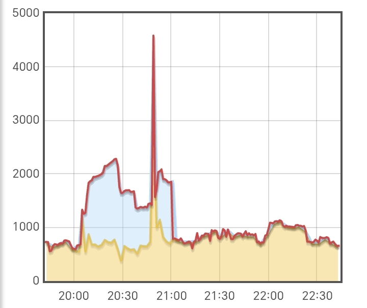

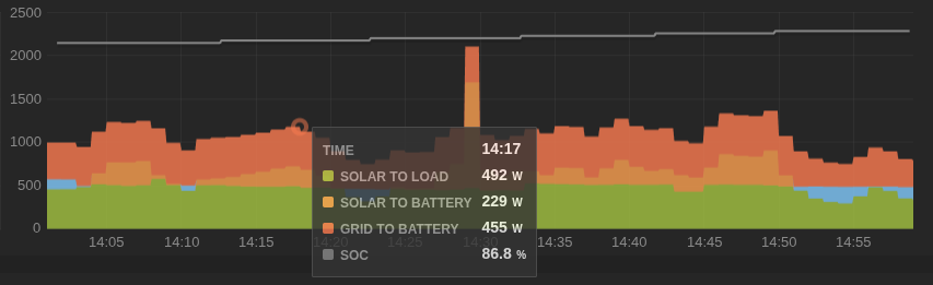

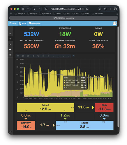

@Timbones this (below) was the situation you mentioned earlier, could you screenshot it again with the tooltip in place please?
I have the same āproblemā during the charging period. I have some solar to battery, but I also have the entire load pulled from the grid. The chart stacks them in the order solar use + grid use + grid charge, when reality is 100% grid use + solar charge.
@TrystanLea In trying to verify the ābattery firstā strategy display, Iāve uncovered a graph redraw bug. To reproduce it, refresh page then switch to 1hr timescale. After a short pause it refills the right-most portion with identical values, and SOC is missing. After a minute or so it resumes plotting normally but without SOC and with a plateau of identical values still there.
Also the tooltip behaviour is still not quite right near the right edge of the graph. If you move the cursor to where the tooltip switches over, and then continue moving the cursor to the right, the position of the box moves relative to the cursor so that the top right corner of the box ends up way to the right of the ccursor and hits the edge before the cursor does.
Specifically battery-to-load looks light brown on the graph but yellow on the tooltip.
Thanks @PeteF the colours look ok to me in your screenshot - which probably means thereās not enough contrast between them and we need to adjust the colours slightly.
Youāre absolutely correct, I hadnāt zoomed in, added contrast would be great. Is there space to make them slightly larger as well?

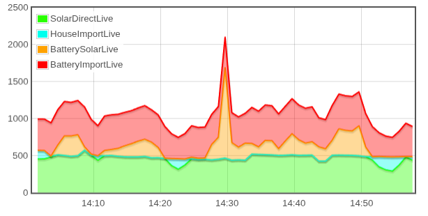

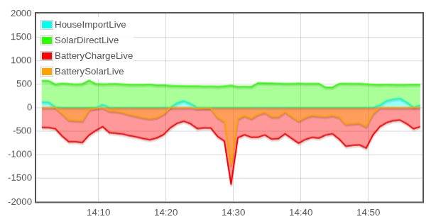

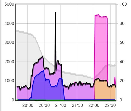

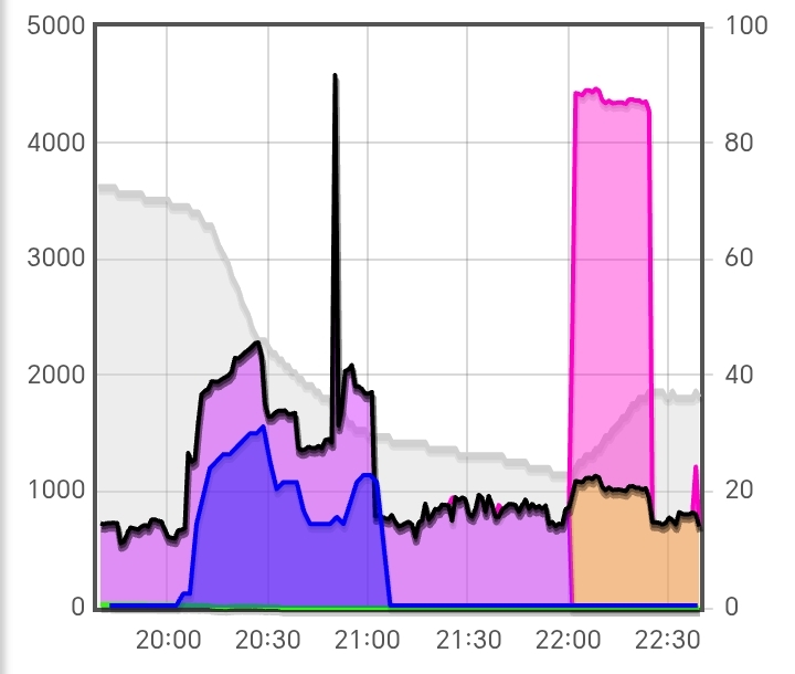

[April 3rd, 14:00 to 15:00]
Hereās the same data presented in Graph widget:

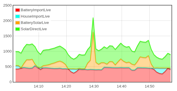

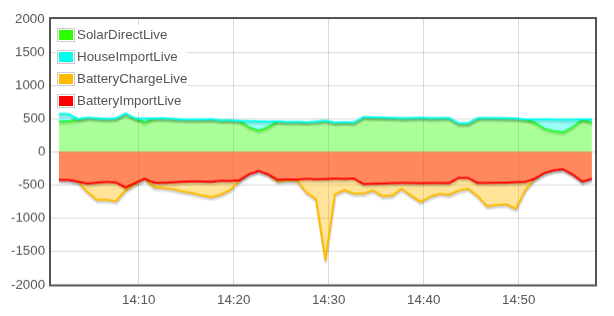

I can swap solar to home (green) with grid to battery (red), and get practically the same shape:
Or I can put the battery charging as negative power:
Or this other different way, swapping top two and bottom two:
This shows how inverter will pull extra watts from the grid (red) to match solar use (green).
Not sure any of these are ābetterā, and this is only 1 of the modes the system can be in.
(does not show discharge or export, but theyāre fine)
