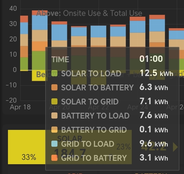

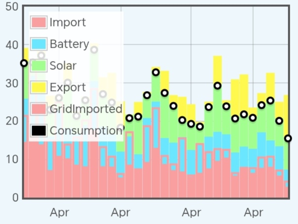

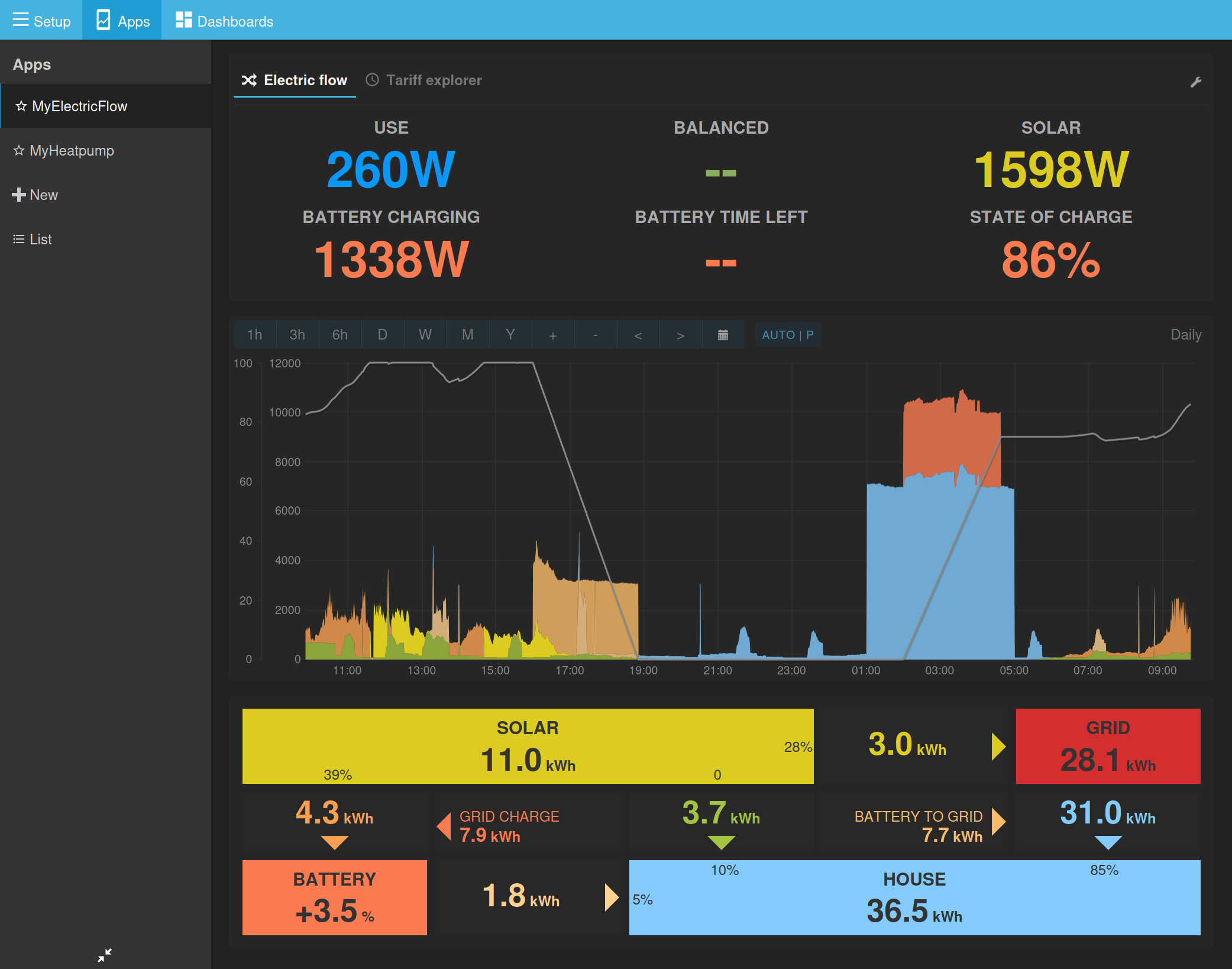

It dawned on me that the stacking of energies on the daily history is potentially misleading as the top of the bar doesn’t match consumption:
Total load on that 2nd day is 30 kWh, yet the bar reaches nearly 40!
The energy that attributed to charging (9.4 kWh) and discharging (7.6 kWh) the battery is partially counted twice (and some is lost). I think it’s impossible to properly show energy flow between 3 sources on a chart that only has 2 directions (positive and negative).
I have one possible alternative visualization, where only the 3 ‘to load’ energies gets stacked, with a black point for total consumption. Grid to battery shown as a red outline, solar to battery is the blue bit without outline and solar to grid (yellow) sits on top.
I don’t know if this is better, or that any single visualisation will work, or even if it matters at all. :man_shrugging:
I agree and have a similar feeling about the power graph. I wonder if we’re trying to present too much information, simply because we have it to hand. For example in the power graph (a) it’s a bit of a struggle to work out what is stacked and what is overlaid, and (b) the peak value measured off against the y-axis (the sum total of the stacked items) sometimes doesn’t seem to reflect anything useful.
@TrystanLea is it straightforward for you to describe the graph plotting and stacking logic with respect to the 7 flows?
It might be better to present less information in each graph, but endeavour to select that combination of elements which present a clear and unambiguous state of affairs. Perhaps more than one ‘view’ (i.e. power and energy graph) is required?

Yes maybe splitting out into different views in the daily mode makes most sense:
  • Consumption only by source (3 ‘to load’)
  • Solar to sink (use, battery, grid)
  • Battery charge by source (positive), discharge by sink (negative)
  • Everything as currently displayed..

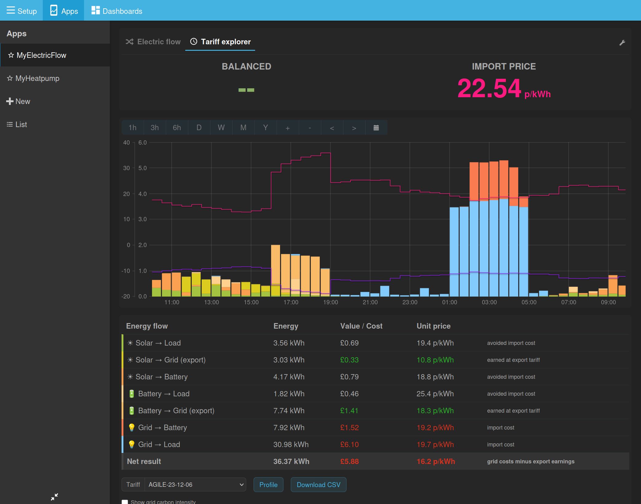

Thanks @Timbones ! I wonder if that would still fit if I merge in the tariff app..

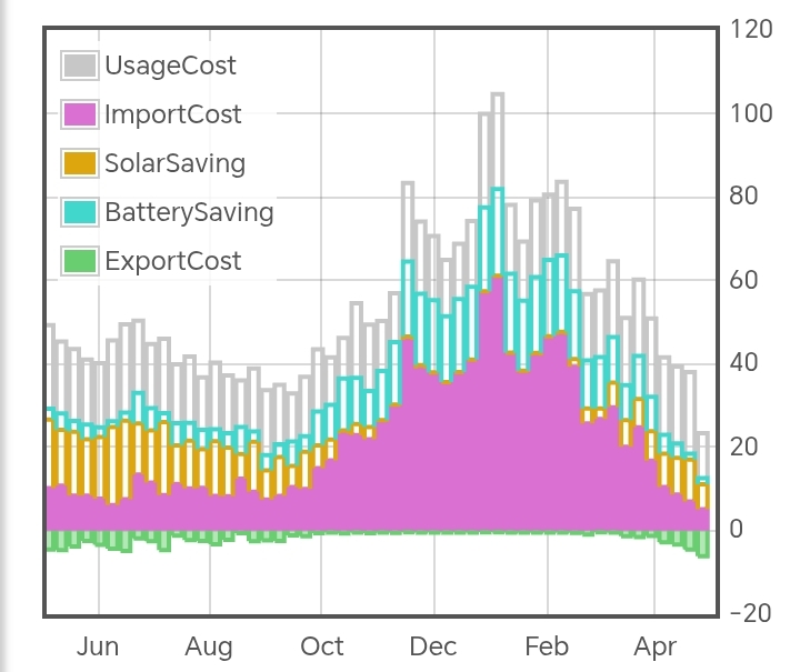

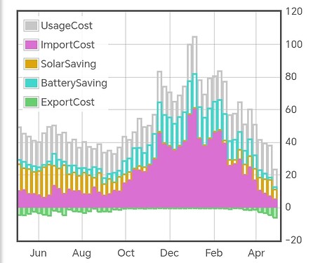

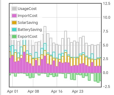

I feel that the tariff explorer would be more useful if it was focused on daily costs, rather than half hourly energy flow, to avoid duplication.
For example:
  • purple is the actual cost, i.e. import × unit rate (+ standing charge)
  • orange is what it would have cost without solar: consumption × unit rate
  • blue is what I saved by importing cheap power at night: grid to battery × 90% × difference between night and day prices (assumes battery is discharged in same day)
  • grey is what it would have cost on the standard tariff: consumption × standard unit rate (+ standing charge)
  • green is revenue from exporting back to the grid
  • Y-axis is in £s
Zooming out to a year:
(When period is greater than 2 months, I like to show weekly instead of daily, then monthly above 1 year)
I would like the app to show me total cost or saving for the 5 series over the period in the graph. Average unit rate too.
  • Actual cost = £X (x.xxx p/kWh)
  • Standard cost = £Y (y.yyy p/kWh)
  • Export revenue = £Z
  • Solar saving = £A
  • Battery saving = £B
(Strictly speaking, some of the solar saving is provided by the battery and is difficult to separate. May need to tweak or define these terms better. Will also need localisation of currency symbols.)
If a second tariff is selected, I should be able to see which is cheaper. Maybe the graph only shows two sets of bars in this case.
  • Tariff 1 = £X (x.xxx p/kWh)
  • Tariff 2 = £Y (y.yyy p/kWh)
There does need to be a caveat about load shifting (or maybe some magic to automatically shift loads between cheap periods). My house is tuned to run on the Cosy schedule - if I switched to another TOU tariff, I’d need to adjust to a different schedule. A simple tariff comparison would not factor that in, and may provide inaccurate conclusions.

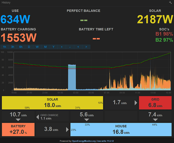

Since the Solar Battery App is undergoing some changes, would it be possible to add support for showing the state of charge for multiple batteries?
As an example, I managed to hack the existing app a while back to produce this:
I’d like to try this new version, but don’t want to lose my separate SOC monitoring.
Thanks @ebsol are your batteries connected to the same inverter? do you just sum the charge/discharge powers?
Thanks @TrystanLea. My system has two identical inverters each with its own solar string and DC coupled battery. So, as you say, I sum the data and feed it to emonpi so it sees them as one single unit, but in addition I also send the SOC’s for each battery separately.
The inverters are meant to manage the SOC’s themselves to maintain the same levels. So if, for example, one string gets shadowed, the other will compensate by sending some power over AC to boost the level. But as you can see form my graph, I doesn’t do a perfect job, so I like to keep an eye on it.

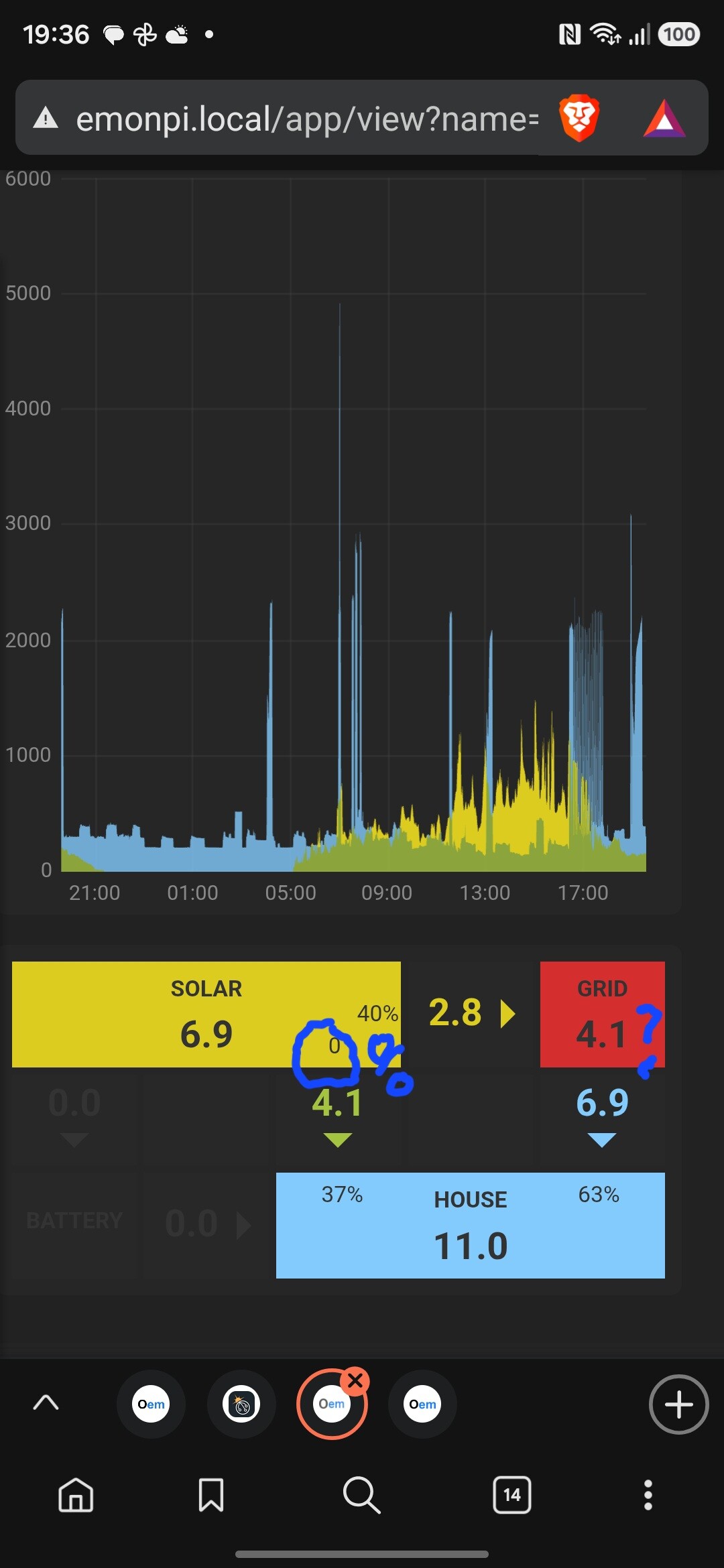

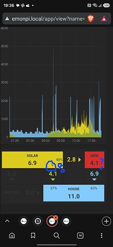

Minor bug in MyPowerFlow? The percentage value is missing on the Solar to House.
What does the Grid value represent?
Thanks @vworp, this is now fixed!

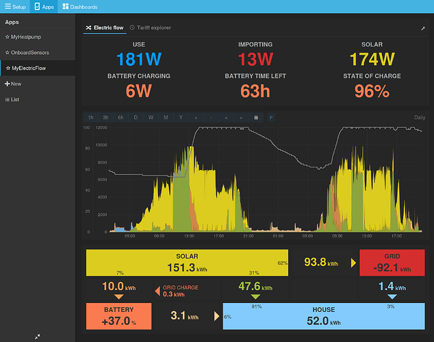

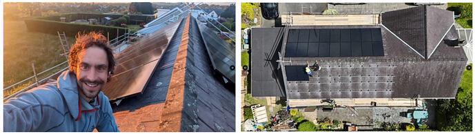

@glyn.hudson has also just completed his epic new Solar PV installation: 38 x 515W Eurener panels = 19.6kWp (9.3kWp East / 10.3kWp West), 10kW Fox hybrid inverter and existing 9.5kWh AC coupled GivEnergy battery :tada:
Here’s the first couple of days of data :sun:
@glyn.hudson has given me permission to share his live MyElectricFlow dashboard publicly, here it is: https://emoncms.org/app/view?name=MyElectricFlow&readkey=82a1cb1cf5b17b6e9dd419edc6a17970. It’s a good demo of the app if anyone is intrigued :smiling_face_with_sunglasses:
Looking at Glyns dashboard, I think I need a bigger roof…

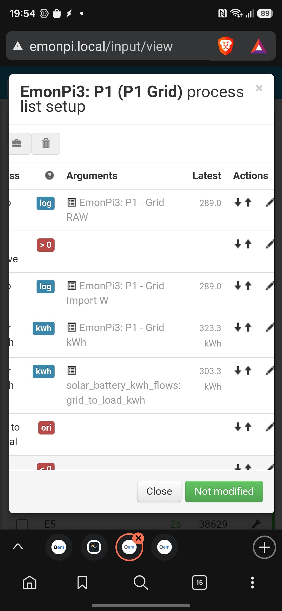

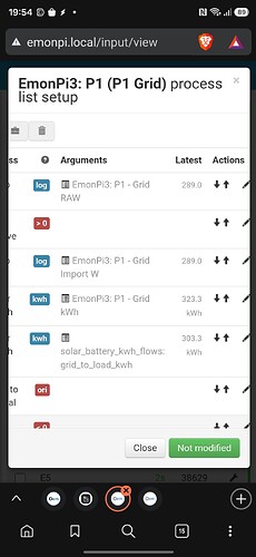

I’ve got a bit of a discrepancy with the feeds that MyElectricFlow has created and my pre-existing power to kwh feeds.
Will this be because the app creates feeds with a 900s interval, opposed to my original 10s?
Yea having that much power, it’s another level!
the solar battery kwh flows shouldn’t feature in your input processing, those feeds are written to via the myelectricflow app post processors..
I would remove the input processes for those and then rebuild the kwh flow feeds via the MyElectricFlow app config. Then use the chart to compare both over the same time basis..
