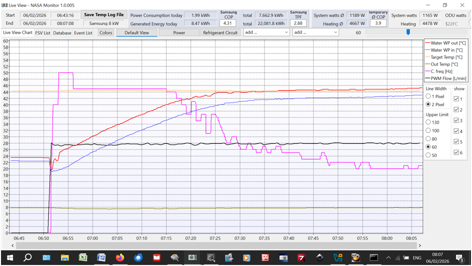

Have you any evidence for this, @MikeJH (assuming that you are referring to compressor stop/starts)? As illustrated below, HP output is high immediately after start-up - quite possibly higher than heat consumption - so LWT may rise quickly to WL target, and could even stop the compressor, especially if the circuit thermal inertia is small.
But in theory circulation rate should make little if any difference to the energy balance - the heat input (from the heat pump) and the heat dissipation (from the emitters) are essentially fixed, and it is the difference between them sets the LWT rise rate, hence cycling propensity.

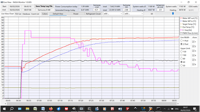

However, by “cycling”, you may be referring to the rather curious compressor inverter frequency variations (magenta line in the following example) in the speed control algorithm as LWT (red line) approaches WL target (yellow line) - a sort of “two steps forward, one step back” strategy:
Just out of interest, the 50Hz speed above corresponds to the Safety Start algorithm which switches to the Normal Operation algorithm about 5 minutes after initial start. Don’t ask me why Samsung wrote the algorithm like that, but I can’t fault the LWT rate of approach and overshoot, so it does seem to work!

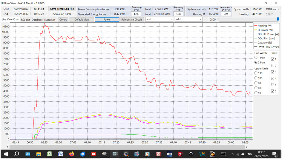

Also, the 50Hz Safety Start does produce a high energy output. Here’s the corresponding energy flow log:
That’s over 10kW (red line) from an 8kW nameplate unit, at a fairly good initial CoP of about 5 (energy consumed is yellow line) though this falls to about 4 once compressor speed has reduced to minimum, due to the proportional increase in parasitic losses.
