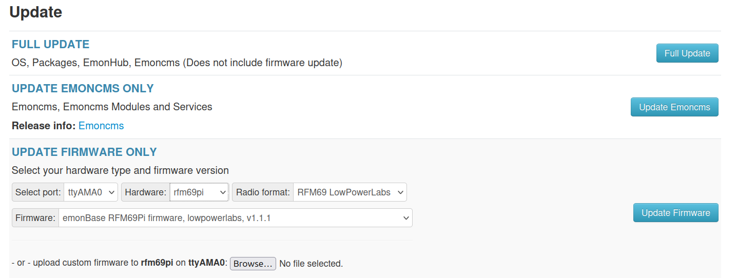

Monitoring System Firmware Update
I do have (of course) every version of emonLibCM that I released, I don’t (of course) necessarily have all the other versions because it’s rare that anyone is notified of something changed or appearing on Github.
The first digging step revealed there is no V2.4 of emonLibCM. The present and last one on Github is my V2.2.2.
So, I’m at a loss to explain that step you illustrate.
I apologise Robert. I have checked the library contents and can see that the version information of the eminLibCM I downloaded form github is V2.2.2. I think I got mixed up with the emonTx3cm firmware version number.
No harm done, only a few handfuls of electrons have been mildly inconvenienced..
These libraries, at least the copies I have of them, appear to be far from identical.
As the emonTx3 LPL radio signal was recieved by the RFM69Pi, when loaded with the emonTh2 firmware, I had a good look at the parts of both the emonTh2 and emonTx3 sketches that send the data.
The emonTh2 uses the RFM69_LPL library and the function ‘send_csma’. The standard emonTx3 sketch uses the RFM69 library and the function ‘sendWithRetry’. The majority of other emonTx3 sketch calls to the RFM69 library looked the same with the exception of the ‘setPowerLevel’ call in the initialisation. So I tried pointing the emonTx3 schetch to the RFM69_LPL library with the ‘setPowerLevel’ function commented out and Lo and Behold - Success. The data packets were recieved and sucessfully decoded.

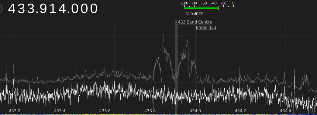

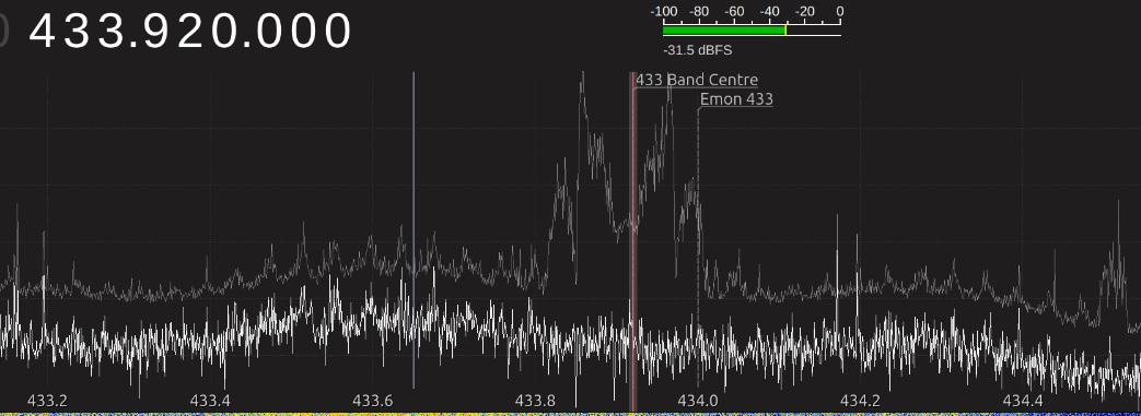

Do you know if the LPL you’ve used uses 433.00 MHz or 433.92 MHz – and which one do you want to use going forwards? I think we agreed it will be 433.92 as that is in the centre of the band – not that I think it matters, given the minimal likelihood of you causing interference with a neighbour.
Unfortunately, we’re in the middle of an unaccustomed heatwave, and I can’t think straight in those conditions. If that happens, I might not be able to do it for several days.
So am I, possibly related to trying to solve multiple problems at once.
The transmitting devices appear to be all configured for 433.00 MHz. The emonhub log indicates that the RFM69Pi is configured for 433 MHz.
Yes - 433.92 MHz, which looks like it will require the RFM69Pi frequency to be set. I assume this is achieved via the serial interface provided within emoncms.

I think you’ve missed a trick. You can feed it your own file - but the UI to do it is anything but clear.
When you click and select rfm69pi, firmware emonBase RFM69Pi.... V1.1.1 pops up and appears to be the only choice - and indeed that’s what gets uploaded when you click
“Update firmware”. DON’T CLICK IT.
Instead, navigate using the “Browse” button on the next line to a .hex file you’ve created on, or uploaded, to the RPi5 and (here’s the awful bit of UI) it will upload immediately as soon as it is selected, probably unseen off the bottom of your screen. No confirmation is needed or allowed.
So that’s how to put a new sketch into your RFM6Pi.

Transmitting at nominal 433.92 MHz works, but it looks to be closer to 433.914 to me, though I’d be happy to put that down to temperature.
433.0 MHz also works, but 868 and 915 don’t. Probably a brain problem due to an overtemperature failure.
