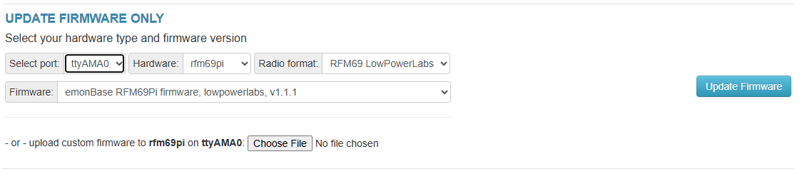

  1. Updated one emonTH with V4.2.1 firmware configured for JeeLib Classic. Data recieved by the emonBase. This was a good sign.
  2. Updated same emonTH with V4.2.1 formware configured for Low Power Labs. Updated rfm69pi configured for Low Power Labs. EmonTH data recieved by emonBase. Also good.

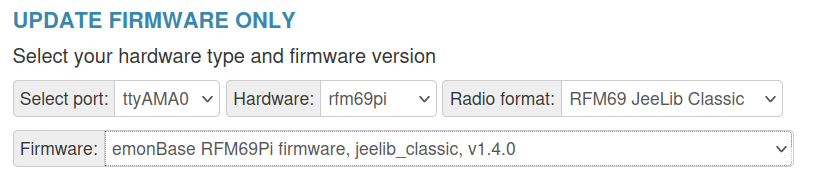

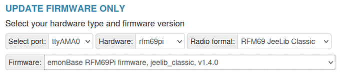

  3. Updated rfm69pi configured for JeeLib Classic. Data recieved by other existing emonTH and emonTx. Good.
  4. Updated emonTH with V4.2.1 firmware configured for JeeLib Classic. NO data from this emonTH recieved by emonBase. Not good.
  5. Changed both emonTH and rfm69pi to Low Power Labs again and emonTH data recieved by emonBase. Good.
  6. Changed both emonTH and rfm69pi to JeeLib Classic again. No data from this emonTH recieved by the emonBase. Not good. Data recieved by other existing emonTH and emonTx. Good.
Tried many times to revert the emonTH to Jeelib Classic. No success.

I don’t understand why you want to go back to JeeLib, once you’ve proved you converted your emonBase successfully. My primary concern was the processor in the RFM69Pi is not an ATMega 328P, hence I would expect you to have struggled to update it using the Arduino IDE and uploading the compiled code to it via the RPi. Now that you’ve by-passed that, I think you will not have a problem with the emonTH’s and emonTx’s, because even if you ignore the pre-compiled upload from your emonBase and use the Ardiono IDE, it’s the same procedure as you’ve used before - the only difference is you’ll need the LPL library file when you compile.
The reversion is just to allow some time to set up the change for the emonTxs without losing all my monitoring functionality for too long.

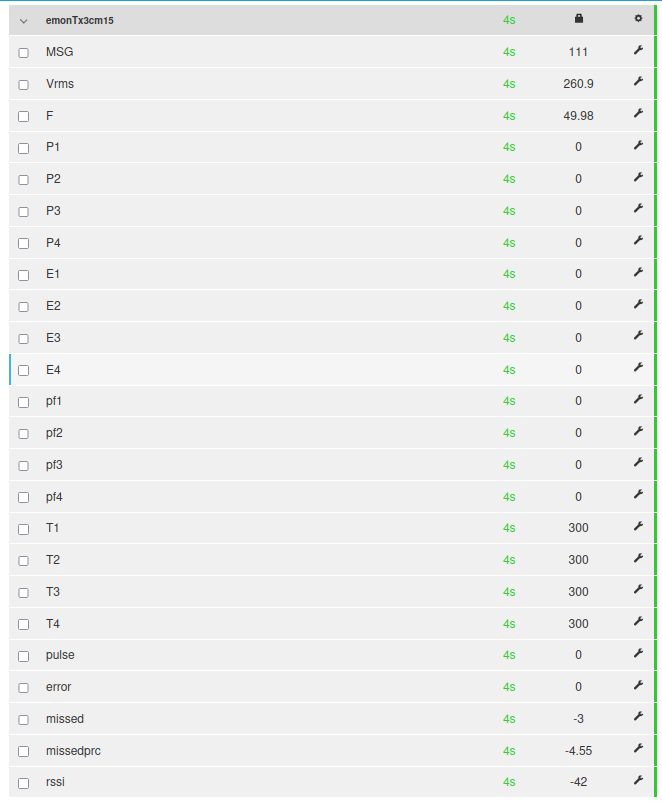

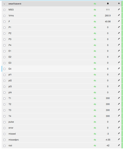

By way of checking that I still know what I’m doing (with Arduino, ATMega 328s, etc) I got the Github emonTx3 LPL sketch working fine using LPL, albeit with an 868 MHz radio working at 433 MHz, into an emonPi3. My initial problem with the watchdog was down to having two fixed-focus acrylic lenses in my eyes :roll_eyes: (I’d picked up the emonTx3 with an RFM12B.)
Now the bad news (perhaps) is, having put your Node 15 definition into my emonhub.conf but with your comments preceded by # (not // - it’s not C or C++), I’m also getting data from your sketch - having changed to LPL as you did.
2026-06-28 22:56:27,370 INFO     SPI        Packet received 53 bytes
2026-06-28 22:56:27,370 DEBUG    SPI        812 NEW FRAME :
2026-06-28 22:56:27,371 DEBUG    SPI        812 Timestamp : 1782683787.370379
2026-06-28 22:56:27,371 DEBUG    SPI        812 From Node : 15
2026-06-28 22:56:27,371 DEBUG    SPI        812    Values : [50, 259.5, 50.01, 0, 0, 0, 0, 0, 0, 0, 0, 0, 0, 0, 0, 300, 300, 300, 300, 0, 0, 0, 0.0]

And it’s made it into emonCMS and onto the Inputs page too…
I’ve only got the a.c. adapter connected for now.
I replaced one of the # comment deliminators with your // and it all blew up…
