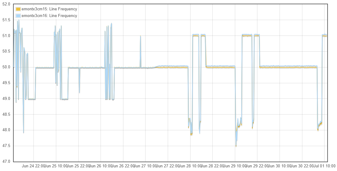

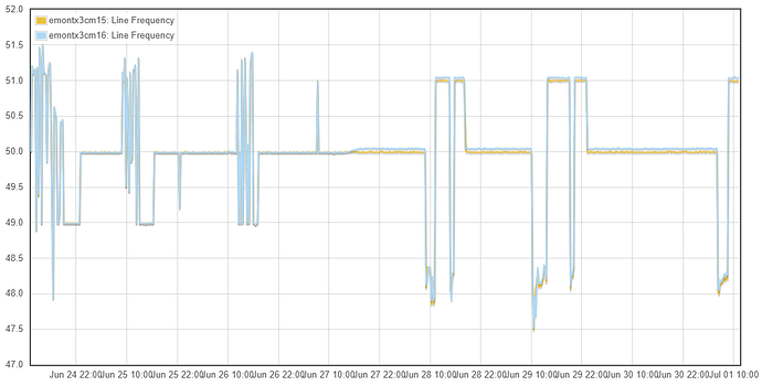

What is also interesting and most probably unrelated to the radio problem is that I now have two emonTx3 units connected to the same supply and they are indicating slightly different frequencies. One is loaded with firmware from 2020 and the other is loaded with firmware compiled last week, when I made sure I had the current versions of all the libraries. The older firmware is typically indicating 50.00 - 50.01 Hz and the newer one is indicating 50.05 - 50.06 Hz. Before I updated the firmware, they were always within 0.01 Hz of each other.
I use the measured frequency as an indication of the availability of spare solar power in our off grid power system. So I will also need to investigate that difference before I use the measurements to drive discretionary load switching. Do we have good record of the changes between v2.04 and v2.4 of the continuous monitoring library?

You can see the emonTh data but no emonTx data and nothing being discarded. There is a communication error which is not present when the JeeLib firmware is loaded. (see below)
Here is the emonhub log output from immediately after reloading the RFM69Pi with the JeeLib firmware. The same combination of emonTx3 and emonTh were operating. No communication error this time but lots of discarded frames.

2026-07-01 09:47:22,170 DEBUG    RFM69Pi    12 NEW FRAME : OK 16 55 43 85 85 191 8 164 70 85 85 168 170 88 85 85 85 184 170 170 170 108 113 85 85 178 81 85 85 206 68 85 85 174 170 166 170 82 85 86 85 120 80 137 80 36 81 160 80 85 85 85 85 85 (-62)
2026-07-01 09:47:22,170 DEBUG    RFM69Pi    12 Timestamp : 1782863242.170096
2026-07-01 09:47:22,170 DEBUG    RFM69Pi    12 From Node : 16
2026-07-01 09:47:22,170 DEBUG    RFM69Pi    12    Values : [32354, 240.42000000000002, 51.050000000000004, 0, -3, 13, 0, -19, 9273, 1255, 4507, -0.05, -0.13, 0.07, 0.03, 13.25, 15, 11.370000000000001, 15.25, 0, 0, 0, 0.0]
2026-07-01 09:47:22,170 DEBUG    RFM69Pi    12      RSSI : -62
2026-07-01 09:47:22,170 DEBUG    RFM69Pi    12 Sent to channel(start)' : ToEmonCMS
2026-07-01 09:47:22,170 DEBUG    RFM69Pi    12 Sent to channel(end)' : ToEmonCMS
2026-07-01 09:47:22,257 DEBUG    MQTT       Publishing: emon/emontx3cm16/MSG 32354
2026-07-01 09:47:22,257 DEBUG    MQTT       Publishing: emon/emontx3cm16/Vrms 240.42000000000002
2026-07-01 09:47:22,257 DEBUG    MQTT       Publishing: emon/emontx3cm16/F 51.050000000000004

I’m afraid I cannot replicate this so far. Using the same emonTx V3.4, with line frequency in your sketch scaled by 0.9988 in order to match my multimeter (accuracy 0.1% ± 1 digit, but out of calibration), I get the same as the multimeter ± 1 digit (except when frequency is changing rapidly, due to the different timebases for measurement) using either emonLibCM V2.2.2 or emonLibCM V2.0.4 as you tested. I could not think of nor see a change that should have affected the frequency measurement. I was not consulted about the later versions, so I’m not aware of the changes.
Fortunately, my editor can do a side-by-side comparison of two files, so I’ll try to do some more digging tomorrow, but it’s 01:45 local time here and I’m quitting for the day.
This one is really odd but the correlation with the time that I updated emontx3cm16 is quite evident.
I would not chase this one yet. I will load emontx3cm16 with some firmware based on the older version of the library and compare them again on the weekend.
Unfortunately there’s no git history, it was all uploaded at once. Am I right in saying this is the file we’re discussing?
No.
With respect to the EmonTx3 we started out talking about a customised version of this file: emontx3/firmware/emonTx34/emonTx34_CM/emonTx34_CM.ino at master · openenergymonitor/emontx3 · GitHub
And the last few posts about a discrepancy in reported line frequency are about the supporting library at GitHub - openenergymonitor/EmonLibCM: Continuous Monitoring alternative to EmonLib · GitHub
Thanks Simon. So, the Tx3 firmware has the same issue (very limited git history), but there’s a bit more history for the CM :slight_smile: I’ll try to find some time to look at it.
