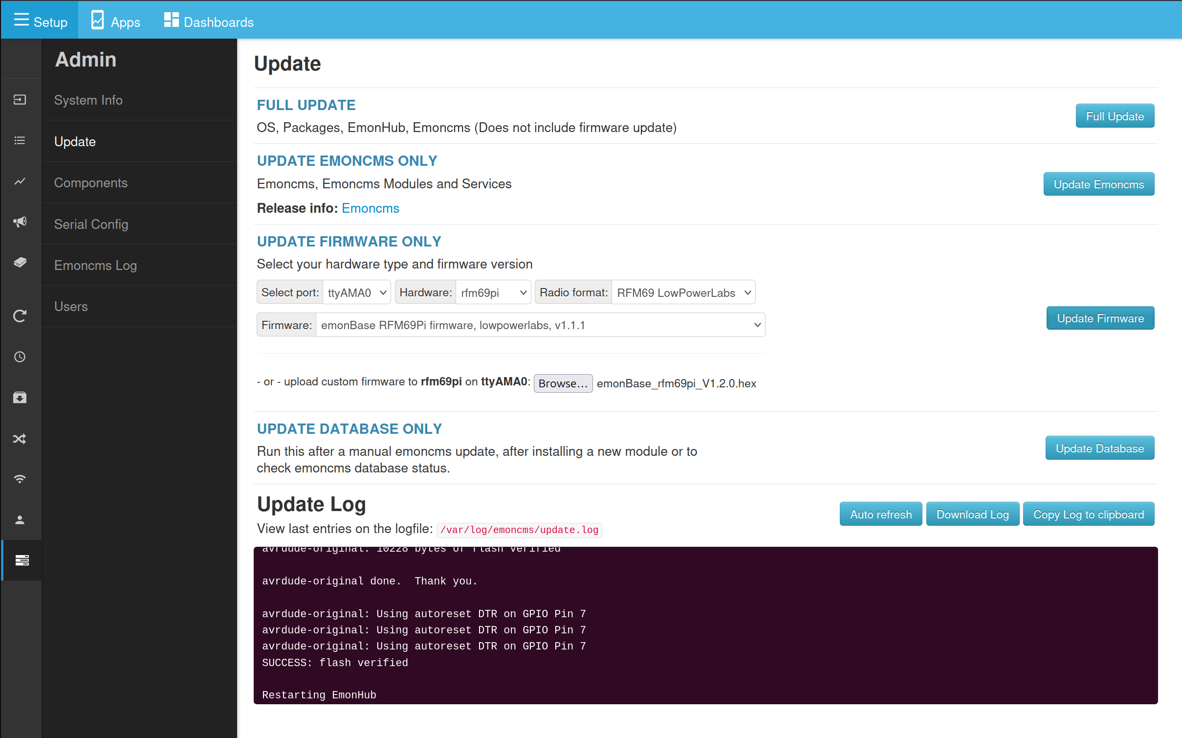

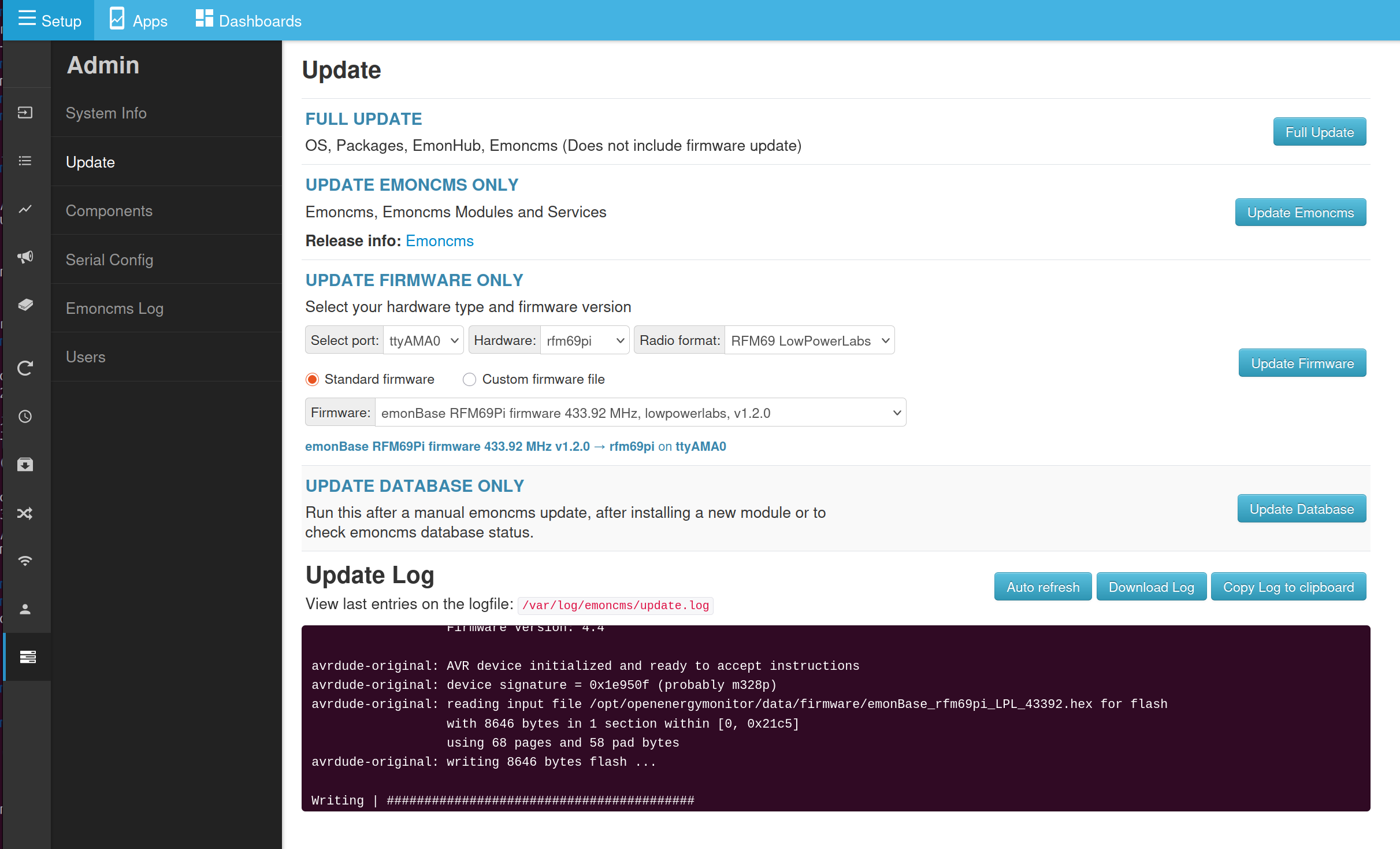

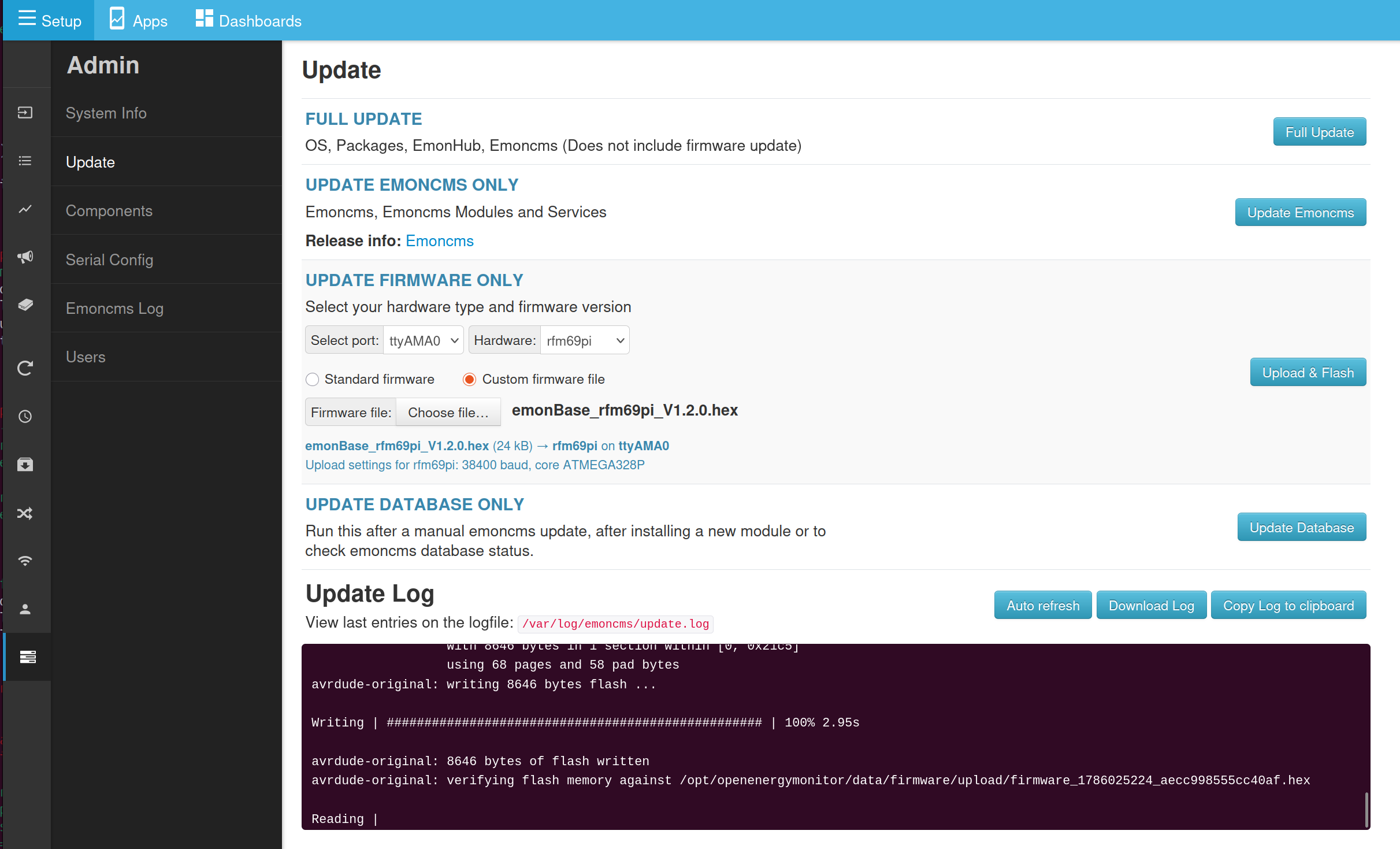

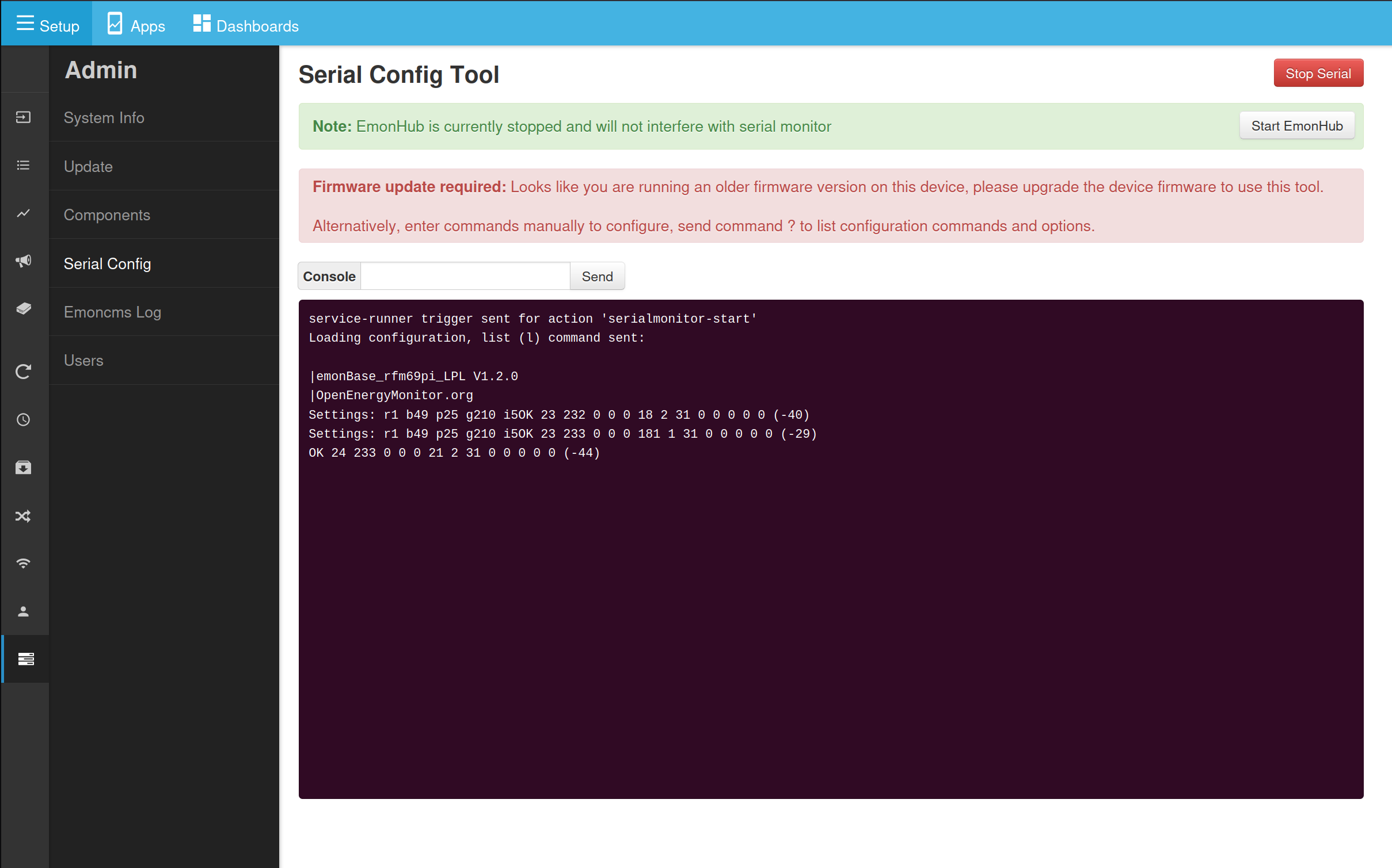

I think we’re there. I’ve just sent Trystan a V1.2.0 of emonBase_rfm69pi, and asked him to test it on the real thing, because I’ve had to use an emonTx V2.2 as a stand-in for a RPi + RFM69Pi.

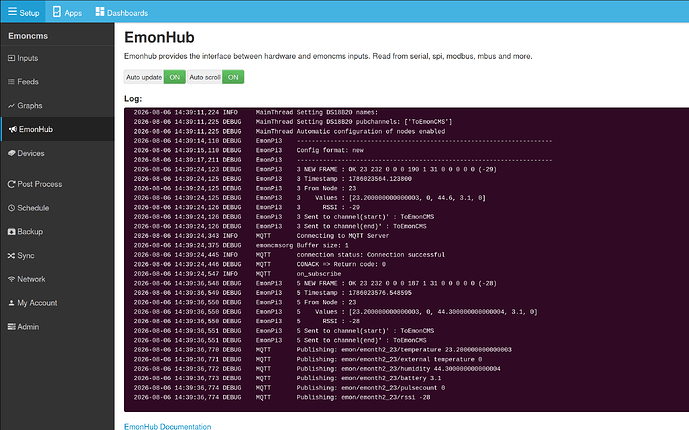

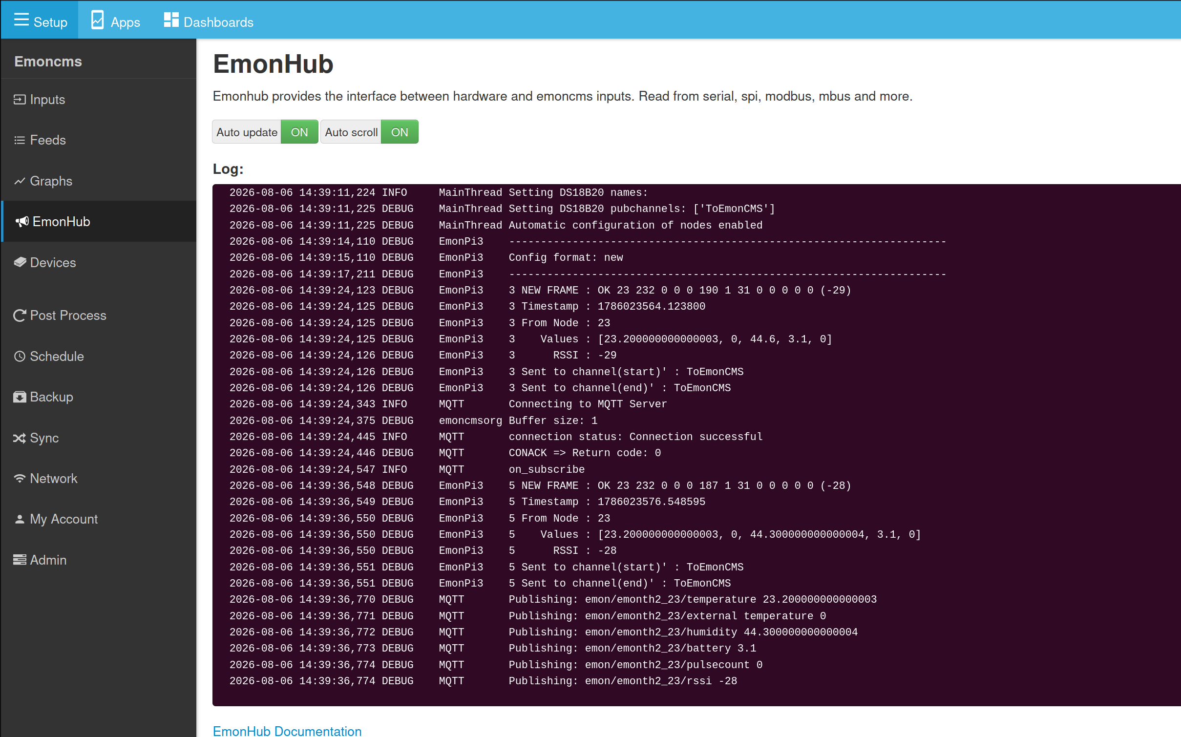

It is proven to work transmitting on both LPL and JeeLib Native, at 434, 868 & 915 MHz on JeeLib, and 433.00, 433.92, 868.0 & 915.0 MHz using the OEM version of LPL (RFM69_LPL).
It is proven to receive using LPL at 433.92 MHz, which is all you need going forward. (But I have no reason to think it won’t receive on all frequencies - only the frequency setting mechanism has been changed.)

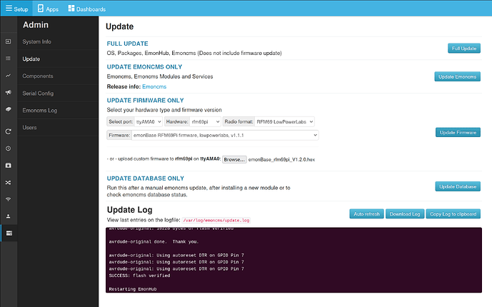

So I think what you need is:

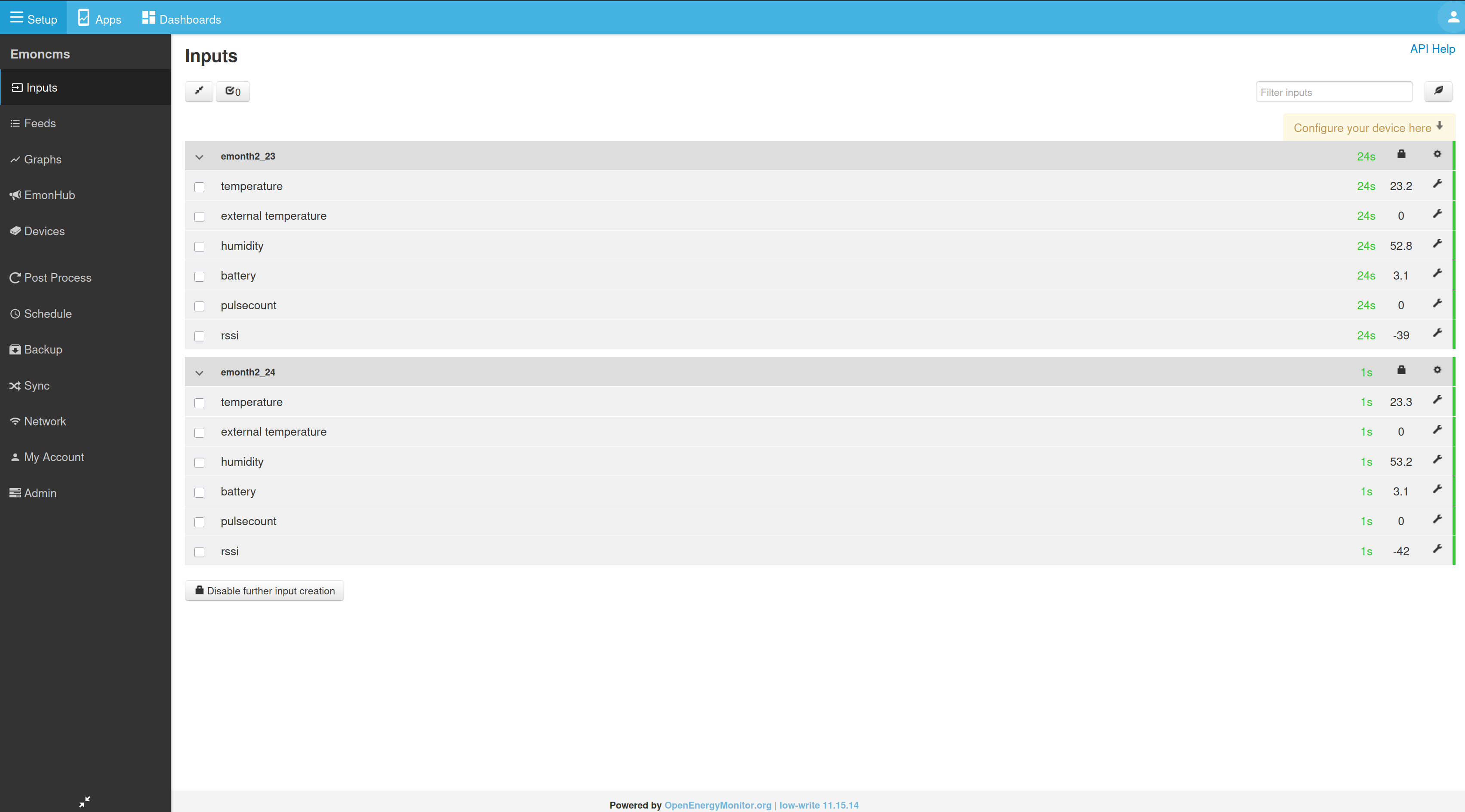

For the emonTH2: “emonTH2 LPL firmware (433.92 MHz), lowpowerlabs, v4.2.1” from the update page in emonCMS.
For the emonTx V3.4, your sketch as I’ve modified it.
For the emonBase: “emonBase RFM69Pi firmware, lowpowerlabs, v1.2.0” from the update page in emonCMS when Trystan has tested it and makes the compiled file available. If you compile and upload it yourself, heed the warning at the top of the file and be certain you choose the one without the bootloader.
I’ve also added my RFM69_LPL, which is what I compiled and tested with.
