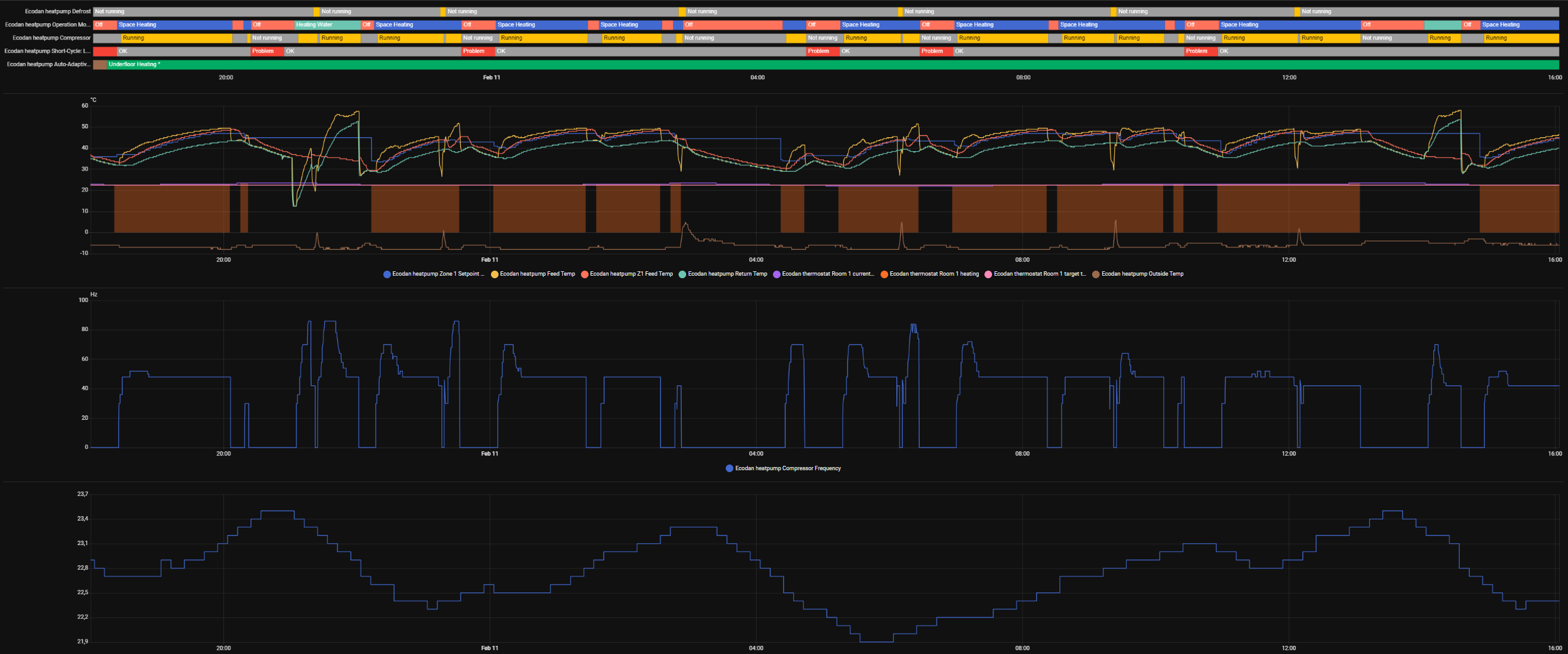

Still same:
After few days I’ll try some other slower profile, just to get some data.

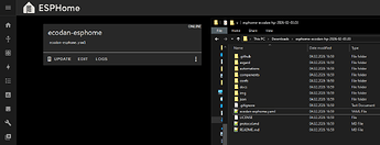

Bit offtopic but,

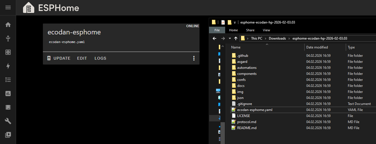

So I can compile/install directly from HA like this:
Just editing conf file by adding following lines with my mqtt broker info?
# Example configuration entry
mqtt:
  broker: x.x.x.x
  username: livingroom
  password: !secret mqtt_password
  discover_ip: True # enable device discovery
some_option:
  topic: domoticz/in  #that's domoticz listening folder

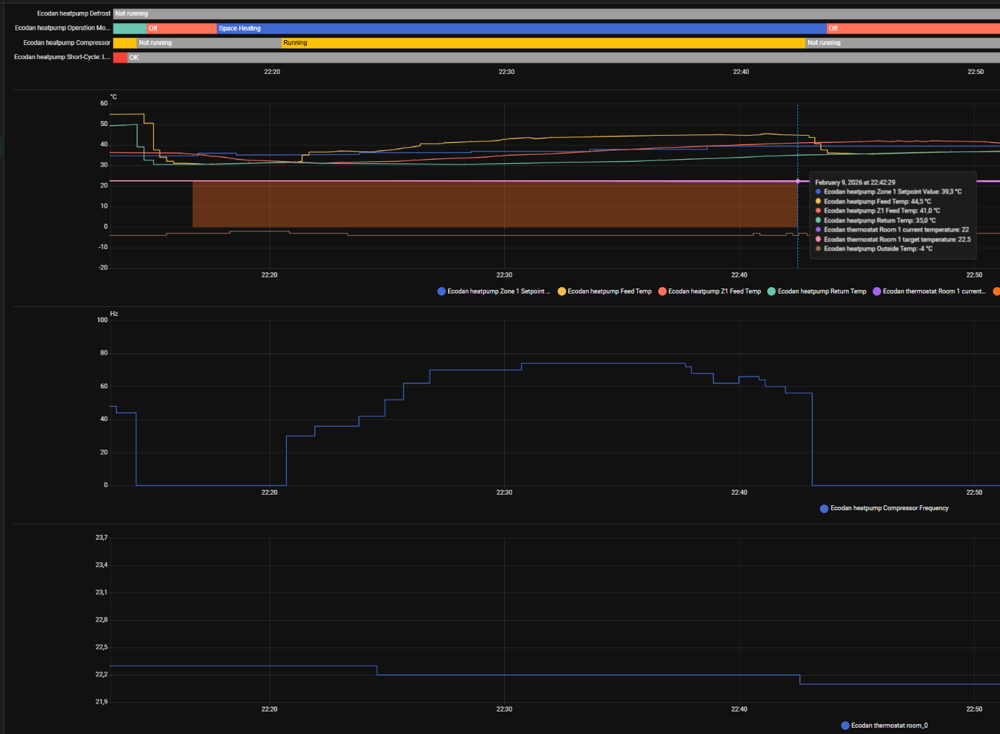

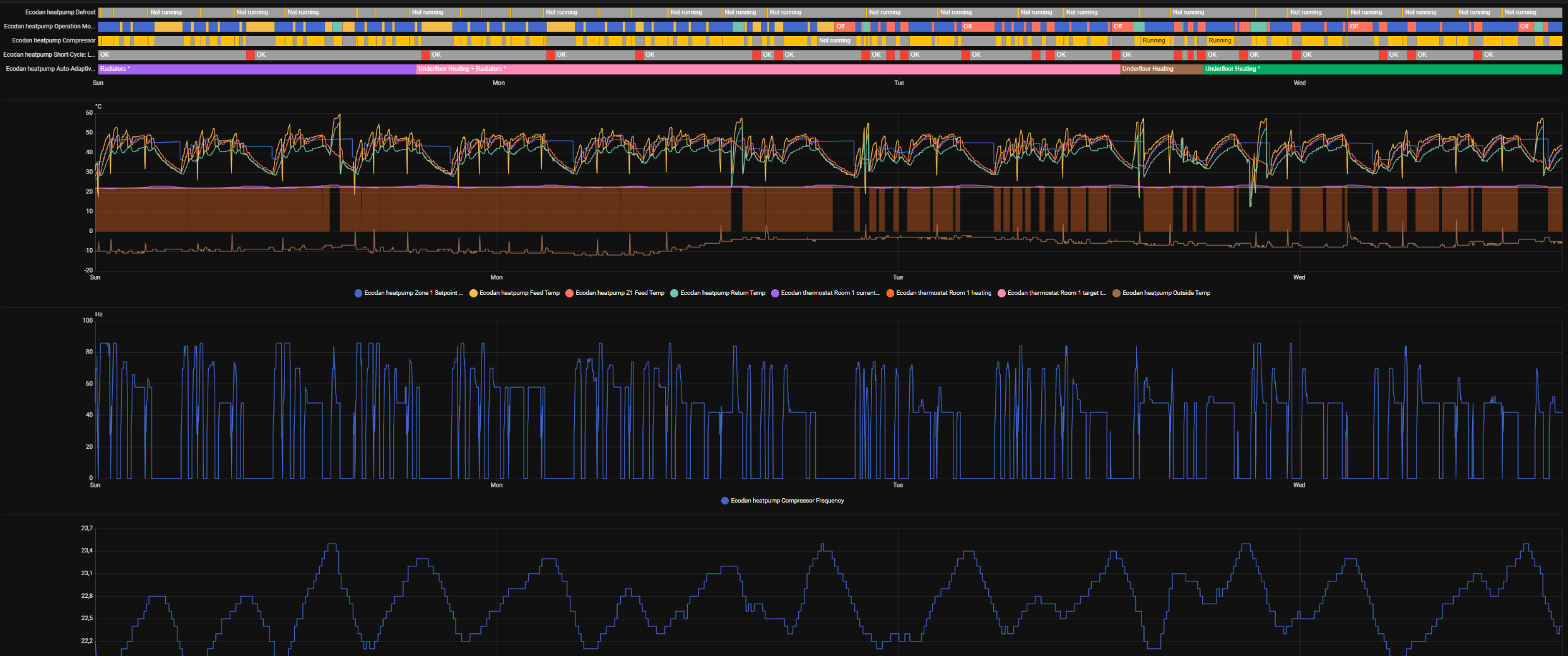

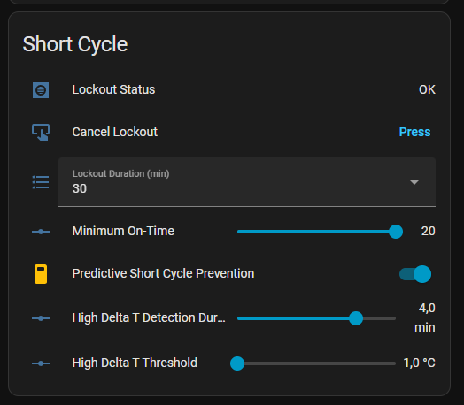

E: so managed to get one strange stop on logs. Room setpoint has been 22,5, room temperature was dropping but it cut off, at around 22.40.
device_logs_2026-02-09T21-52-52.txt (28.8 KB)
compressor shuts down because with mixing tank the FTC uses this hard stop condition:
actual z1 feed temp (41c) - z1 feed temp setpoint (39.3) >= 1.5
There’s an option to to avoid this, its the predictive cycle prevention
But it seems demand is off after the stop, so probably setpoint reached?
I see you use domoticz, it will die when you feed it with the ecodan feed. You probably want to set it to a lower polling rate esphome-ecodan-hp/ecodan-esphome.yaml at main · gekkekoe/esphome-ecodan-hp · GitHub
As for compiling, I assume users compiling themself are capable, so please consult all docs and howtos.
I have it enabled from the beginning with :
And since the flow setpoint is managed by atom and room temperature isn’t reached, I should decrease detection time to about 2min and increase high delta maybe 2-3C? I know the main issue for increasing flow is the annoying compressor/outdoor temp. frequency policy.
By the logs I see, it detects high delta at 22:36:49 and 22:38:34 adds boost +1C.
Then 22:38:49 recovered from high delta, but 22:40:19 high delta again and 22:42:45 compressor stops because there wasn’t enough time to add boost.
[22:33:34][D][auto_adaptive:312]: Z1 HEATING (Delta T): calculated_flow: 37.80°C (boost: 0.0)
[22:33:34][D][auto_adaptive:092]: CMD: Set Z1 Heat Flow -> 37.8°C (36.8°C)
[22:33:35][W][ecodan.component:352]: Command timed out. Retrying (attempt 2/30)...[1]
[22:36:49][D][short_cycle:074]: Zone: 1: High Delta T detected (1.2°C). Starting timer.
[22:38:33][D][auto_adaptive:431]: [*] Starting auto-adaptive cycle, z2 independent: 1, has_cooling: 1, cold factor: 1.35, min delta T: 3.00, max delta T: 8.00
[22:38:34][D][auto_adaptive:218]: Processing Zone 1: climate source: 0, Room=22.0, Target=22.5, Actual Feedtemp: 39.5, Return temp: 33.0, Outside: -4.0, Bias: 0.0, heating: 1, cooling: 0
[22:38:34][D][auto_adaptive:238]: Effective delta T: 6.28, cold factor: 1.35, dynamic min delta T: 5.71, error factor: 0.25, smart boost: 1.00, linear profile: 1
[22:38:34][D][auto_adaptive:312]: Z1 HEATING (Delta T): calculated_flow: 39.30°C (boost: 0.0)
[22:38:34][D][auto_adaptive:092]: CMD: Set Z1 Heat Flow -> 39.3°C (37.8°C)
[22:38:49][D][short_cycle:098]: Zone: 1: High Delta T has disappeared. Resetting timer.
[22:40:19][D][short_cycle:074]: Zone: 1: High Delta T detected (1.2°C). Starting timer.
[22:42:45][I][short_cycle:244]: Compressor STOP detected
[22:42:45][D][short_cycle:158]: Compressor stop event: stand-alone-cycle prevention: 0, saved z1 flow setpoint: 44.0, saved z2 flow setpoint: nan
Thanks for the tip.
Managed to verify conf file on HAbuilder, I’ll try later to install it.

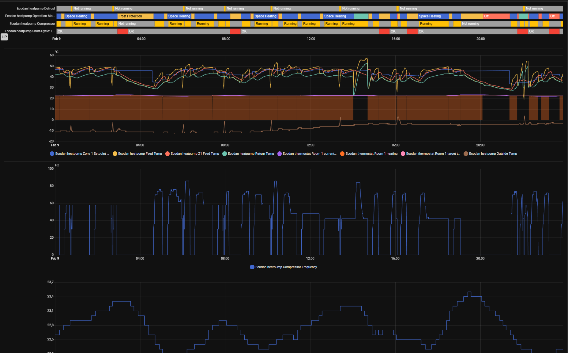

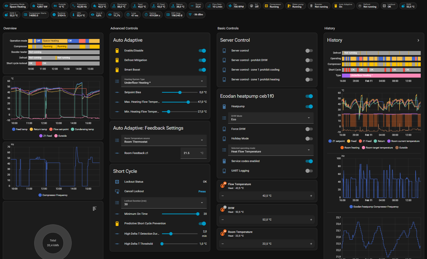

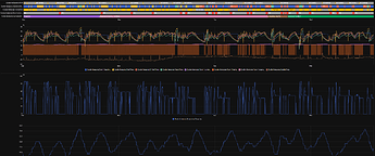

Some insights, that UFH* profile seems to be best solution for me with 100L buffer on flow limited to 47C, sheet steel radiators and average insulation house. Some runs even got almost to 2h (avg ~1h), setpoint stable 22,5C.
Tried also silent mode lev1 but that still kept compressor topped at 48Hz, amb -7C. Good thing is that this can be set on the run, at least on FTC6. If there would be a way to this remotely, then this could be adapted to ambient temperature and it would get rid of those occasional startup spikes. During DHW times the limit can be scheduled to return normal.

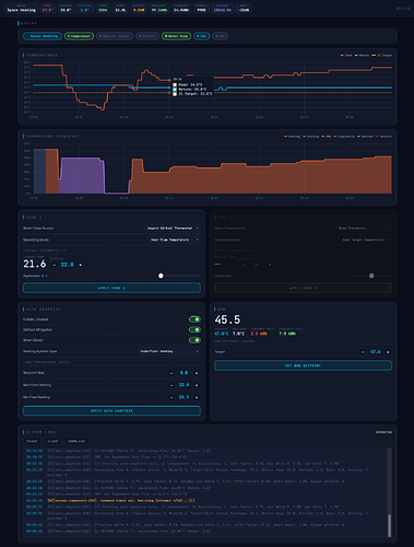

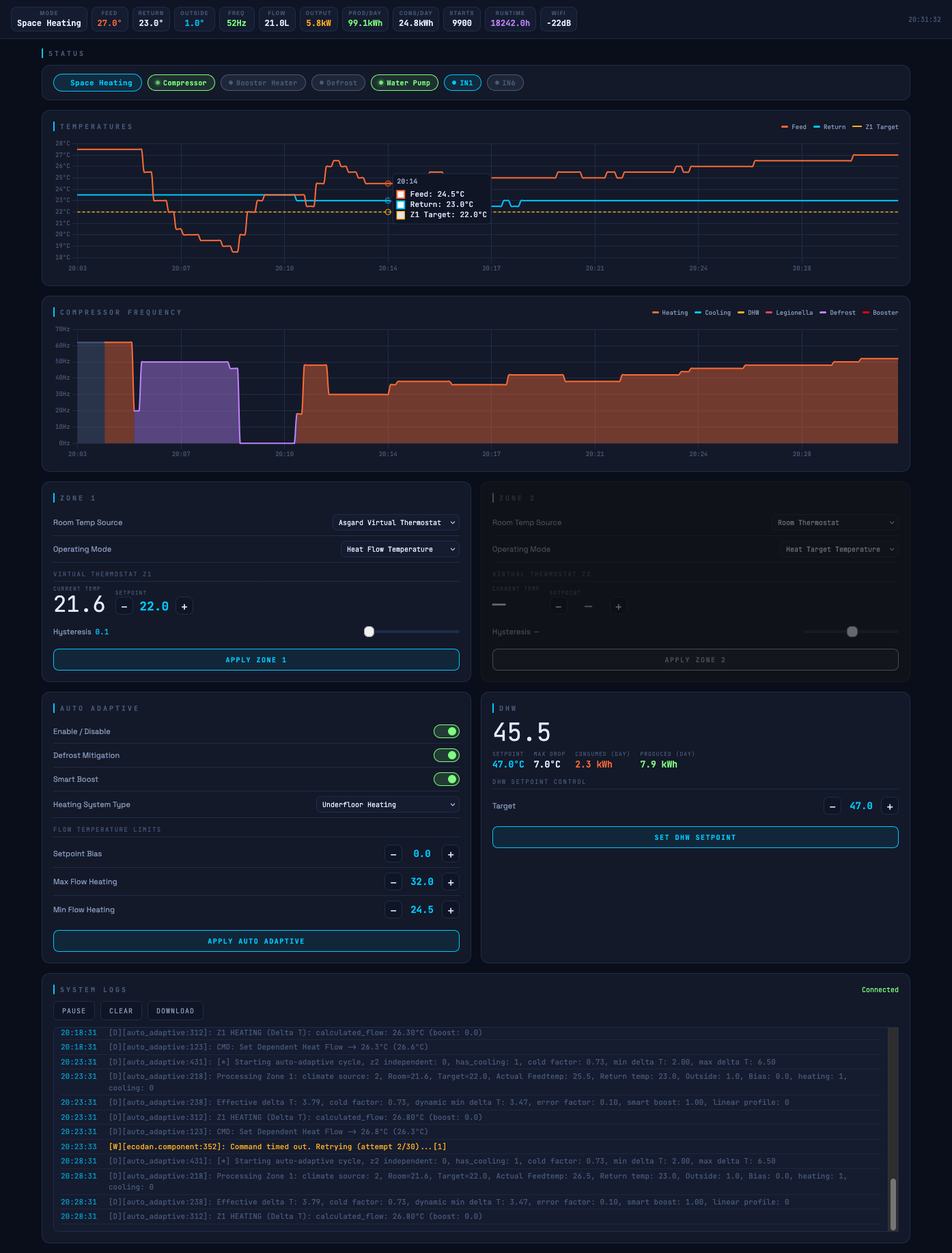

Preview of upcoming stand alone mode. To be used without HA. Should be able to do all basic actions without HA to support users without HA (or don’t want to use it)

it’s available in pre-release Release Major release (Asgard stand alone mode) · gekkekoe/esphome-ecodan-hp · GitHub

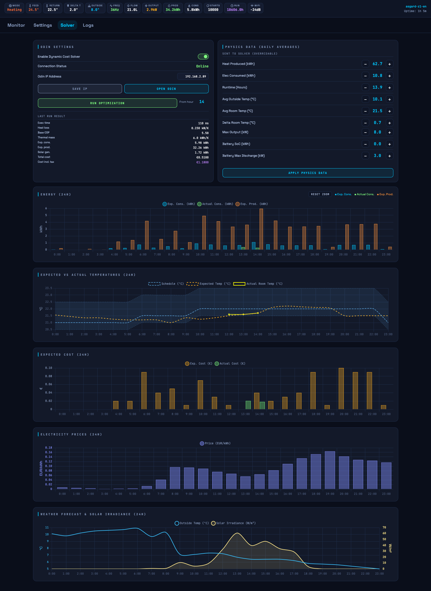

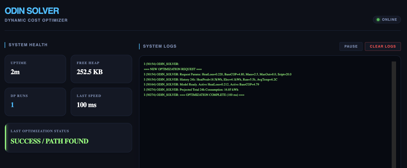

Some work in progress info on the solver Introducing Odin Solver · gekkekoe/esphome-ecodan-hp · Discussion #297 · GitHub
Made a lot of progress, currently validating and tuning the optimizer
The optimizer turned out to be a generic endpoint, so it can optimize/solve heating plan for any heatpump brand. Need to see how this will work out
