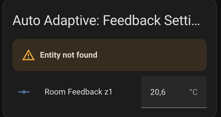

Hello since several updates now I’m missing the thermostat card in the dashboard: entity not found.
I admit I haven’t been reading this thread for some months now but I’m quite lost.
  1. is it an intended behaviour? Why is the entity missing?
  2. what’s Odin and Asgard? Are alternatives for those who have no HA server?
I believe this might be helpful for many, thanks a lot and keep up the amazing work!
it’s mentioned in the release notes:
entities have been changed to allow more fined grained control. You should update your dashboard to reflect this (the example dashboard has been updated for this).

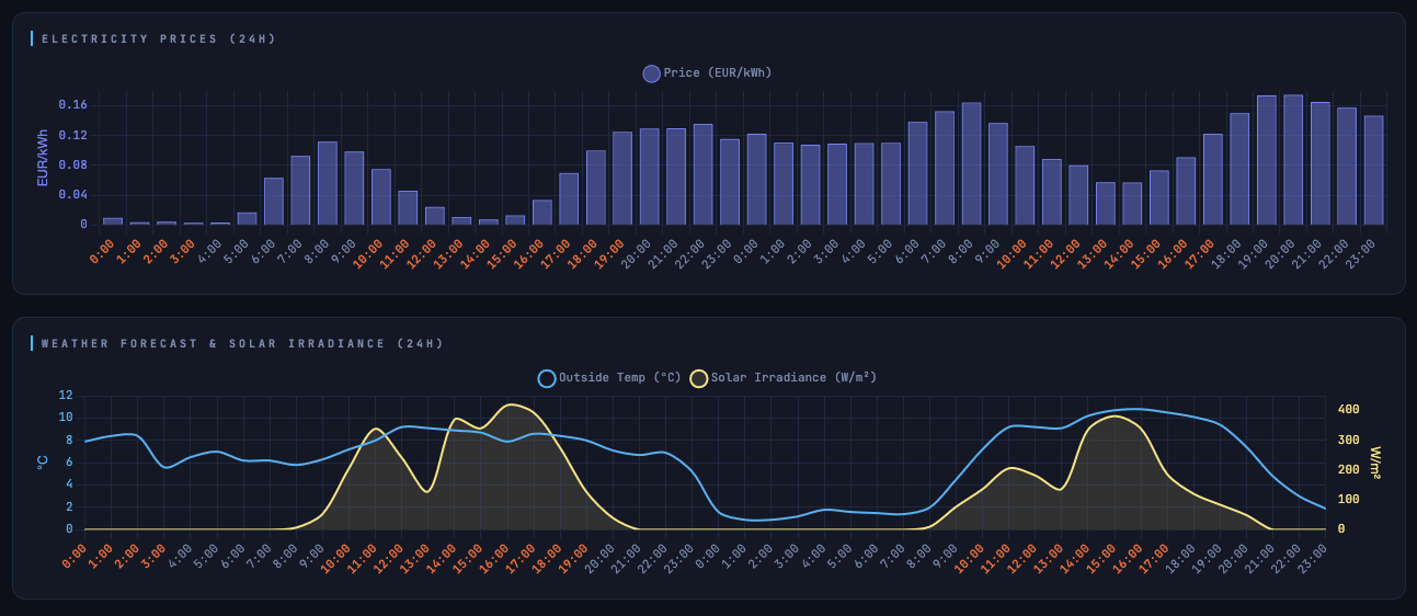

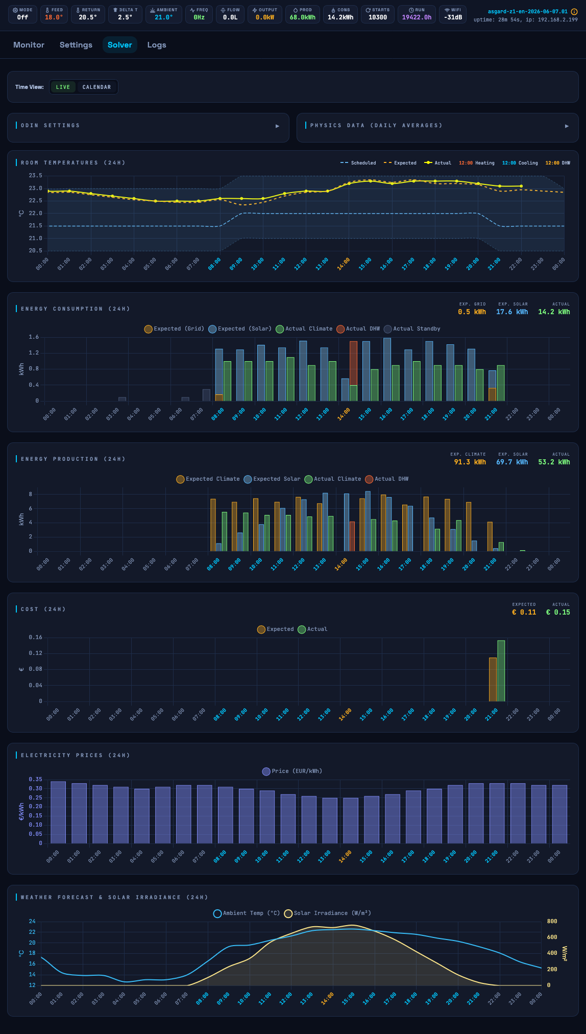

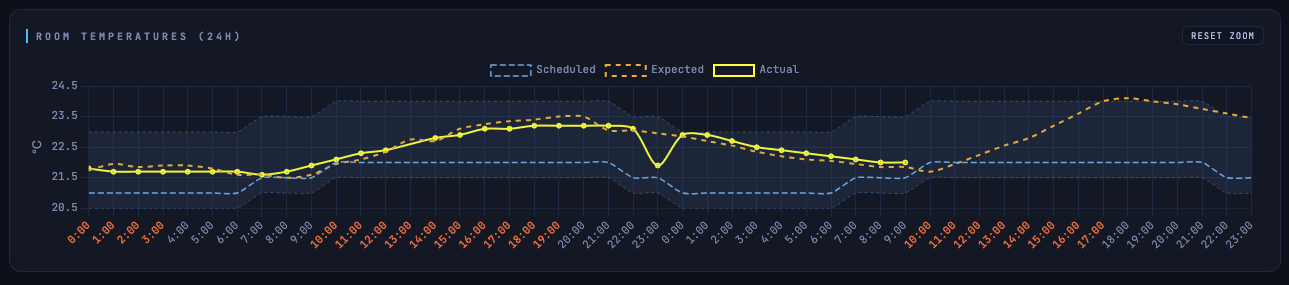

Beta is going well and I wanted to share some preliminary results:
  • orange dotted line: expected (planned) room temp
  • solid yellow line: actual measured room temp
  • blue band: desired/allowed room temp bandwidth
  • red colored x-axis times indicates that Odin is applying heating at those hours
  • DHW is also planned in the free blocks (currently not planned for today)
In this example we can see that Odin is buffering heat when its cheap to bridge the gap till the next ‘cheap’ block. The expected cost for the next day is 0 since it buffered what it needed the previous day and it expects the solar to sufficient.
Expected consumption 10.70 kWh
Expected production 51.06 kWh
Solar used by HP 10.70 kWh
Total solar generation 10.70 kWh
Expected cost €0.0000
  • Ignore the dip at 23:00, I was fixing a day transition issue

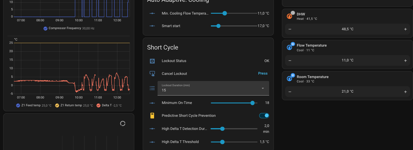

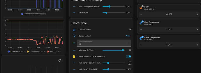

Hello! Are there any adjustments I should be making to prevent the compressor from short-cycling? I solved this easily for heating, but unfortunately, this is happening with cooling. Thanks a lot.
read general tips on auto adaptive cooling here: Howto: Auto Adaptive Cooling · gekkekoe/esphome-ecodan-hp · Discussion #356 · GitHub

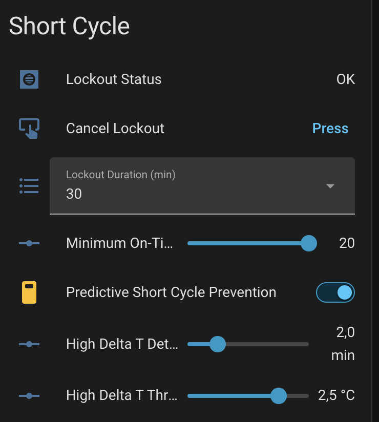

Thanks for the link. I’ve read through it carefully and configured the settings as follows, increasing the Delta T and on-time up to the max of 20 mins.
My system uses 2 hydronic split units, not underfloor radiant heating (which is only used for heating), so I don’t think I need the dew point calculation.
My suspicion is that the splits aren’t exchanging heat fast enough.
I’ve had similar questions about cooling on my GitHub too recently, it appears cycling and cooling are quite a common issue.

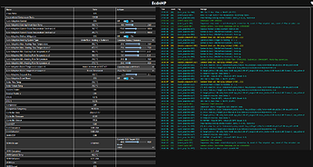

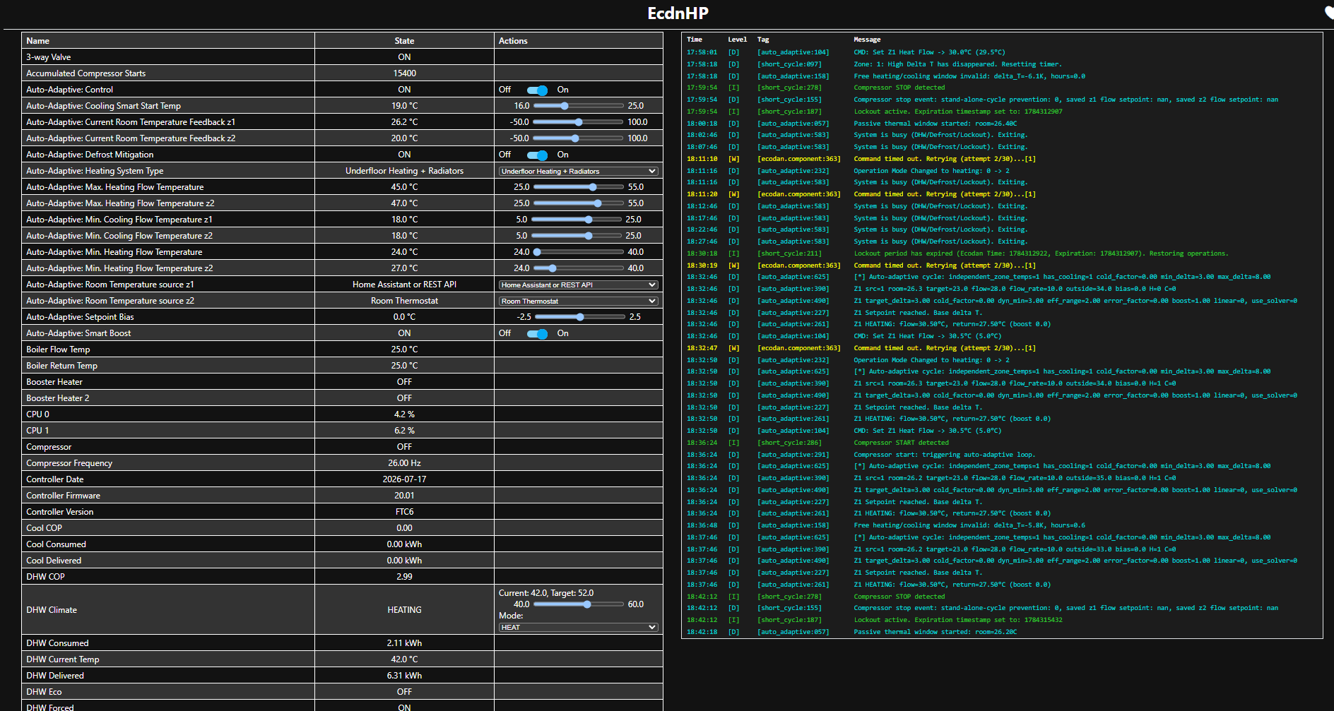

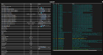

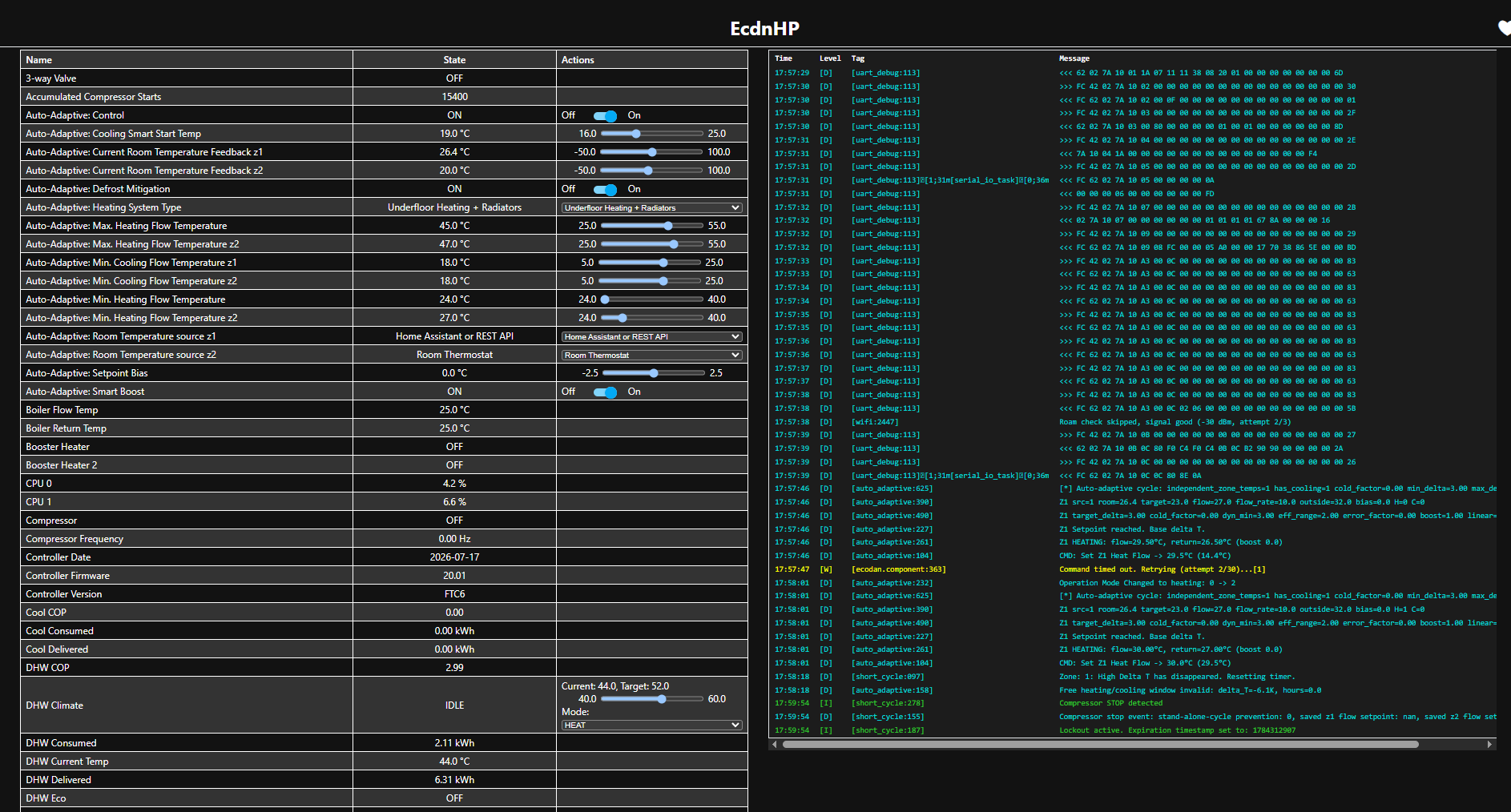

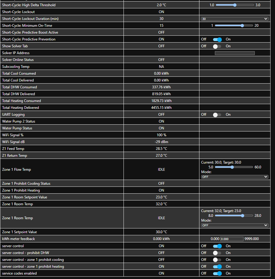

@gekkekoe do you know, why would it keep the flow temp at 30C when min is 24C and room temp 27C, room set 23C, outside 32C.
That causes the compressor to start, temp is sent via curl to cn105, not using in1/2
2026.6.5 (config hash 0xf0f2243c)
E: and again after lockout period, had to manualy disable heating on HP:
Your room temp is 26.4c but your current room temp is 23.0c. You should not have demand with these numbers. You are probably using mrc only, and then demand is always on for fixed flow modes. Please consult the documentation, it’s mention there. You need to setup a stop condition.
The 30c is because your return temp is 27c, and your min delta T is 2.5c (setpoint reached from your profile). So final flow setpoint is 27+2.6 = 29.5c.

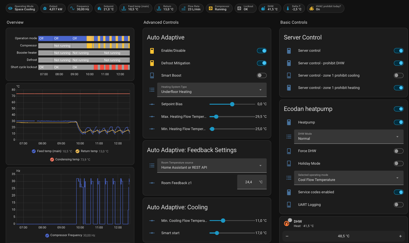

In the other news: here’s a screenshot of Odin doing cooling today, keeps the temp pretty good within the allowed bandwidth
I’ve wired IN1 to GPIO5 via opto on atom s3 and added to my conf:
output:
  - platform: gpio
    pin:
      number: GPIO5
      inverted: true
switch:
  - platform: output
    output: ecodan_in1_output
Feeding my room temperature via curl now to 3 endpoints
local cn105_ip        = "*.*.*.*"
local cn105_endpoint  = "/number/Auto-Adaptive%3A%20Current%20Room%20Temperature%20Feedback%20z1/set"
local cnrf_ip        = "*.*.*.*"
local cnrf_endpoint  = "/number/room_0/set"
local asgard_ip        = "*.*.*.*"
local asgard_endpoint  = "/number/ecodan_heatpump_virtual_thermostat_input_z1/set"
But the In1 doesn’t change automagically. Should the Auto-Adaptive Control trigger the IN1 logic or is it only Asgard that can do that and I should add my own stop conditions?
Also changed “Master Room Sensor z1” to RRC1 and TH1 on HP. Auto-Adaptive: Room Temperature source z1 as API and Asgard.
Manualy switching from UI triggers the output and stops HP.
E: nvm, somewhere from the back of my mind I recall reading from somewhere about IN1 and seperate automation, AAC only keeps the flow temperature under control. That’s why you created Asgard for standalone system.
yes, you will need to make your own thermostat that controls the in1
