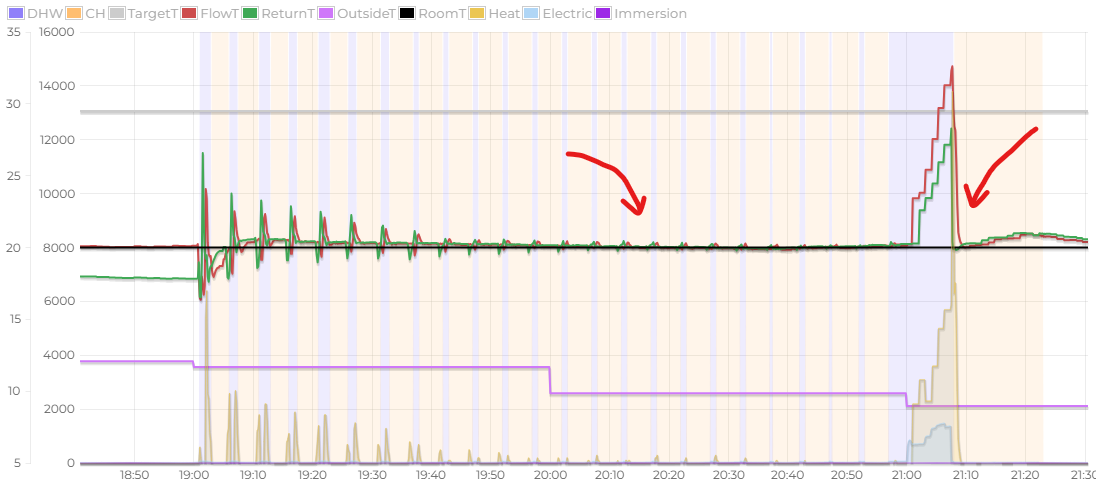

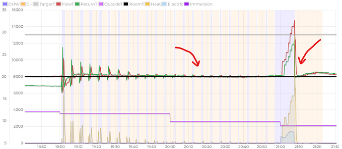

Hi @F1p I have finally managed to capture a telnet output from when the short DHW cycles are occurring till after an actual run that happens after.
DWG_problem.txt (185.3 KB)
It was roughly between the two arrows:
Some bad news unfortunately, the logs appear to be from the wireless thermostat simulator (CNRF) bridge
Ah poo, wrong IP address!
I’ll try again when I next catch it.
Ok @F1p I have, I hope, managed to capture from the correct ESP Home.
DWG_problem_2.txt (703.1 KB)
DWG_problem_3.txt (978.7 KB)
DWG_problem_4.txt (308.1 KB)
My telnet connection dropped a couple of times, hence why it is in 3 files. But hopefully I captured the key parts.
