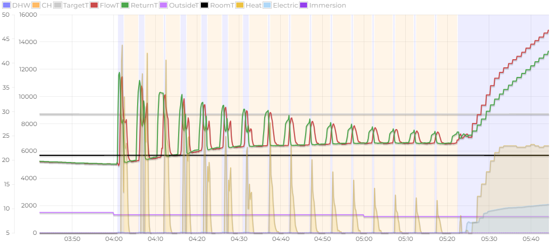

When I just have the MELCloud adapter connected straight to the CN105 connector rather than via the ESP dongle this problem goes away. I can verify this as I have the EmonHP setup.
Do you mean you don’t see the spikes because home assistant isn’t reporting Setpoint anymore? Am i correct that EmonHP would only see actual?
I think it will still be happening, you just cant see it unless you are refreshing the main controller very quickly (its probably only 46.00C for 2-3s)
I can’t see what the setpoint is unless the the ESP dongle is connected in HA.
But with EmonHP I can see that the short hot water cycles aren’t happening when the ESP dongle is disconnected as the flow and return temperatures don’t change.
When this behaviour is happening I can see a spike in the return then flow temperatures as it switches the 3 port valve and the water being pumped around has the slug of warmer water that was sitting in the cylinder coil.
When it is happening it looks like this in Emoncms:
I don’t see this behaviour when it is just the MELCloud adapter connected.

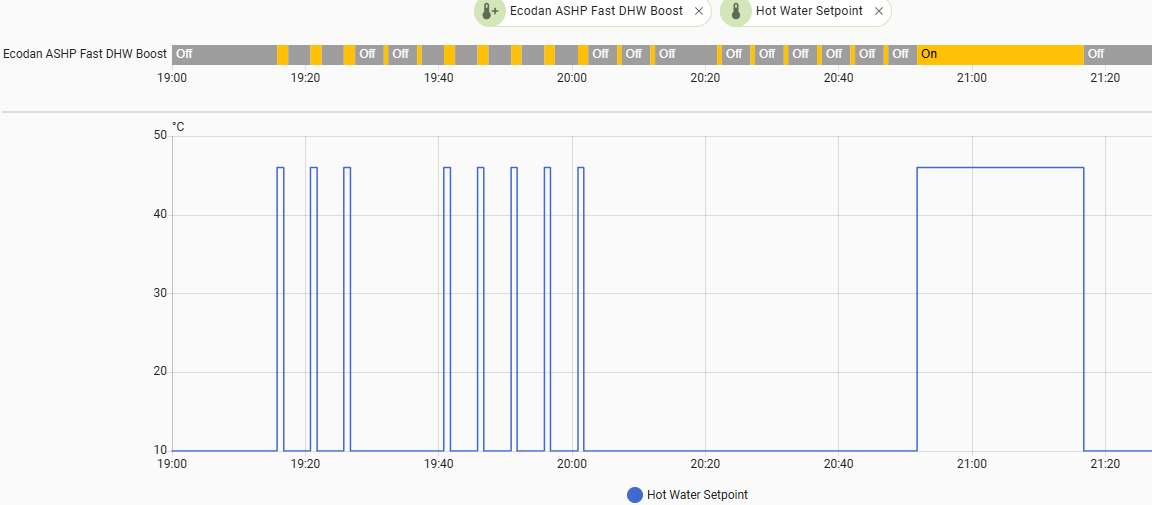

This is what Home Assistant has recorded for last night. As you can see only the longer boosts have the setpoint adjusted.
I’ve asked Havenwise if they can let me know what they changed in MelCloud during that period so we can see why it is ending up as this when the ESP is involved.
If I see the behaviour happening again later I will capture for longer to maybe get a couple of these events.

Response from Havenwise:
“1915, we started a hot water cycle. This sets power to on, sets the target temperature (in this case to 46C), and sends a hot water boost command. This is repeated periodically until the tank is at temperature. This cycle finished successfully at 2015.”
So it looks like the dongle is cancelling or reverting the requests for a while until eventually one sticks.
I have passed this on to them.

Thanks - the duration of each boost request seemed quite consistent, how long are each ‘on’ and ‘off’?
It has started again, I missed the start but will try and capture the telnet for as long as possible now.
Here are some timings for the most recent runs:
I would be interested in capturing the end, where is transitioned to Off if possible please
