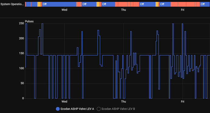

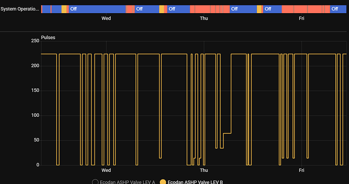

Could someone post a plot of their LEV A and LEV B over a heating cycle.
I just want to check what I should be expecting.
@F1p is there an easy way for me to increase the resolution for these?

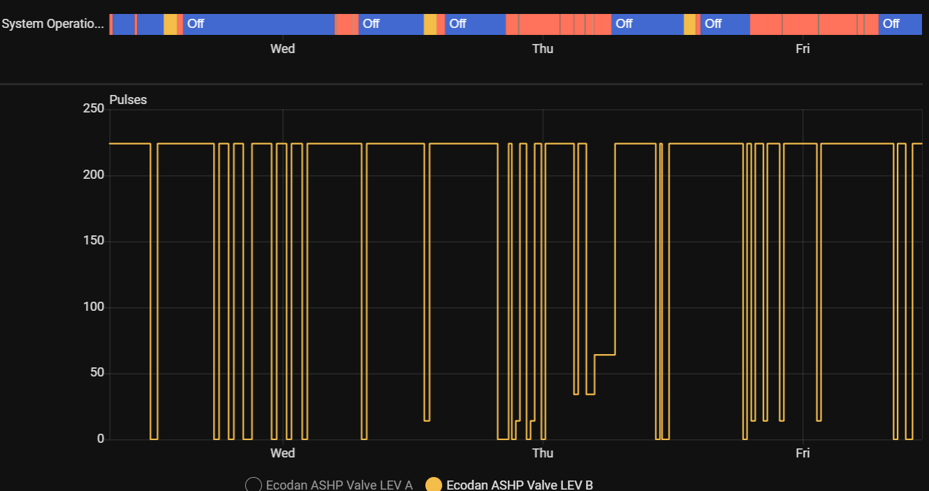

My LEV B seems to be either 224 or 0… where LEV A seems to be a bit more varable:

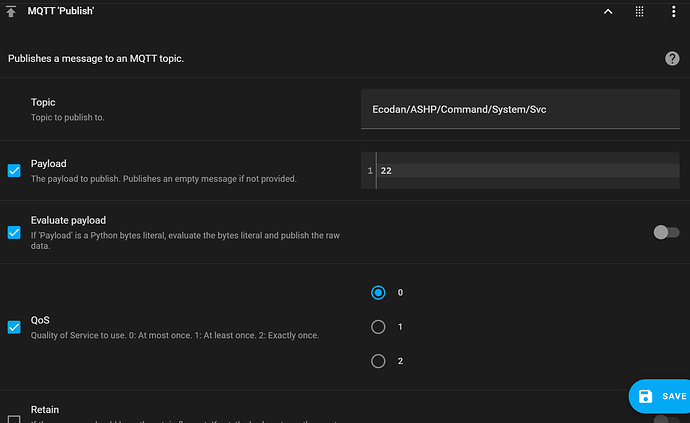

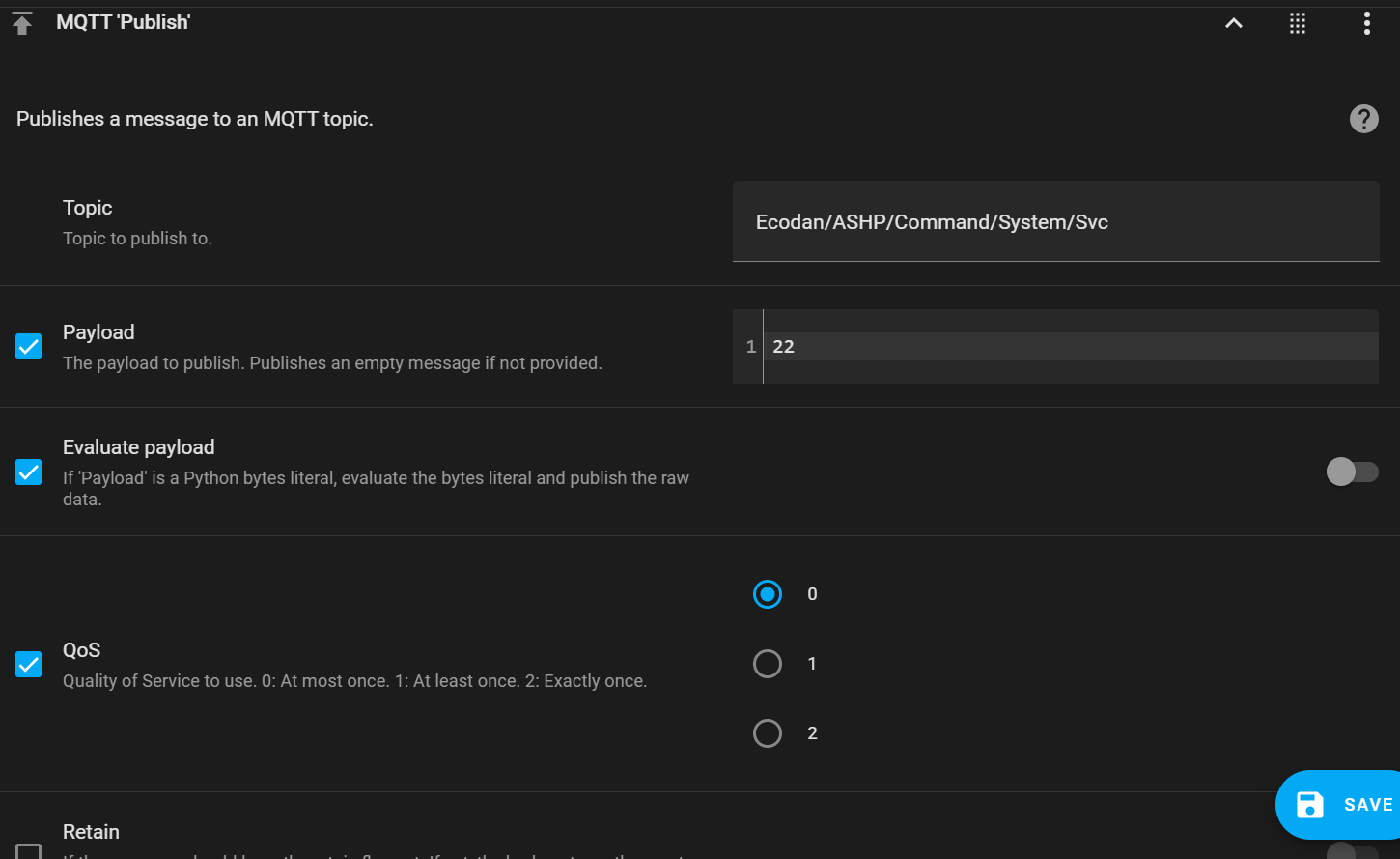

Yes if you want to poll quicker - build two automations for MQTT Publish at your desired polling rate, using Payload 22 for LEV A and Payload 23 for LEV B like this:
Thanks @F1p
I will record my LEV values for a while at a higher resolution to see what’s going on.
If I understand correctly each pulse sent to the LEV moves it on a little bit. So I assume no pulses means the valve isn’t moving and 224 means it is moving as fast as it can to a new position.
Rather than the value representing the current position.
However it doesn’t indicate the direction of travel of the LEV so it could be opening or closing.
But then I’m confused as when my compressor isn’t running both LEVs read 224 pulses all the time.

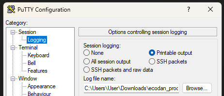

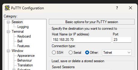

Interesting - Yes, please obtain logs when Havenwise writes, you can connect via Telnet with a Client such as PuTTY and write a log file
I would be interested to see the logs over a 5-10 min period, espeically when it does this “flicking” that you observe

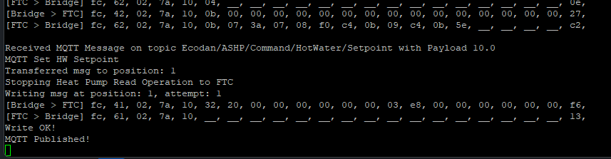

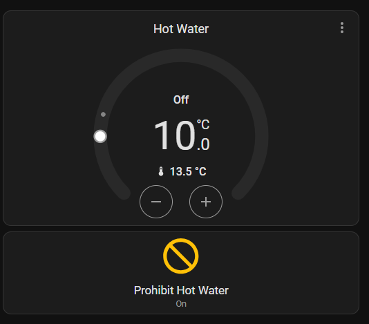

It is interesting that Havenwise will attempt this, because 10°C is out of range for the FTC, i tested mine, note via MQTT only:
Telnet Log of write occuring from Home Assistant:
Climate card does retain 10°C as value after a few cycles, meaning it has stuck:

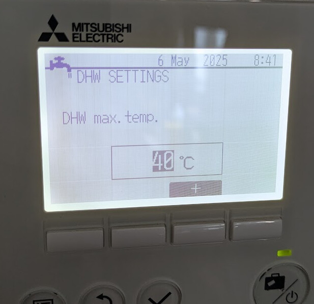

But 10°C is out of bounds on the FTC, so it displays 40°C - wonder who is correct…
I disallow temps outside the range btw.
Are you able to set the temp to 10c with the melcloud UI ? Would be surprised if that worked.
I think writes are made by the 3rd party Havenwise app via MELCloud API, not the UI
10°C is a valid setpoint it seems, I tested on my unit and it didn’t start running
you were able to set it via MRC ? I know you can do it over cn105.
Not via MRC, but it’s definately set as 10 in the FTC, not 40 as per MRC

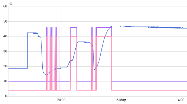

This was what the setpoints were doing last night when the problem was occuring:
The longer periods were when the DHW run was actually happening.
