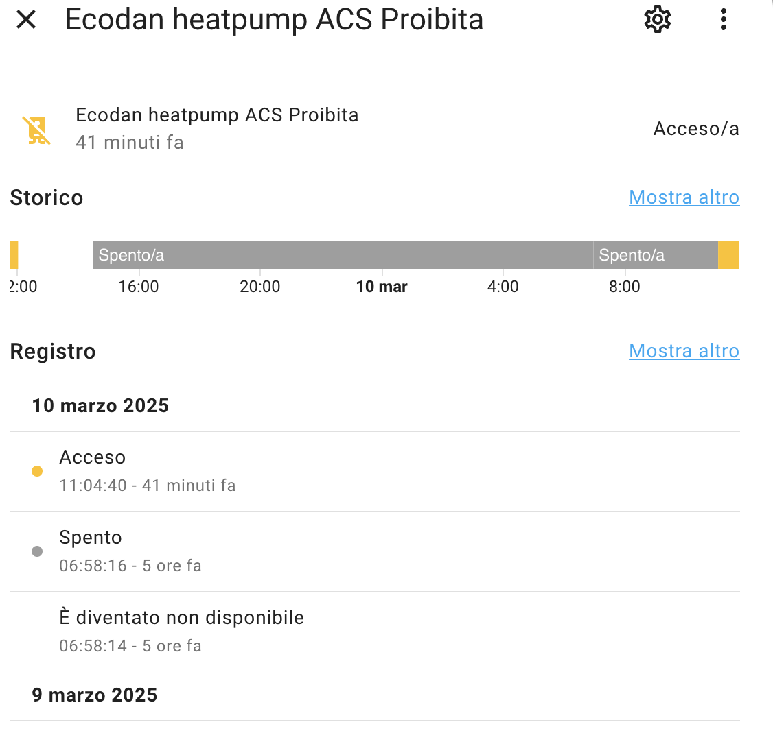

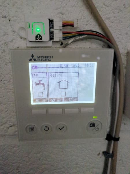

@gekkekoe I set the holiday mode ON (on the FTC6 I can see the holiday mode activated with the icon) but the waterpump is heating and also making DHW. On DHW is overriding the time schedules. Isn’t it weird?
@samumar82
yes this is very weird. For me dhw and heating are disabled when setting holiday mode. only legionella is running.
what are the prohibit flags (bin sensors) showing for dhw and heating ? And do you by any chance also have svc enabled?
The holiday mode switch I put in ON mode is: switch.ecodan_heatpump_modalit_vacanza
I set holiday mode yesterday afternoon (DHW should run from 13:30 to 15:00 as per schedule on the FTC6) and as you can see the DHW prohibit sensor (binary_sensor.ecodan_heatpump_acs_proibita) was not ON until this morning when I had a shower and the pump heated up DHW (outside on schedule).
What is SVC?
svc is server control. Hmm this is weird, I would expect the holiday mode to have enabled the prohibits on heating and dhw. At least it works like that here. But @F1p mentions that it takes the holiday settings from the MRC (controller on the inside unit). You probably have enabled dhw for holiday mode settings.
(I do find the settings strange to be honest, why would you want to enable dhw/heating/cooling during holiday…)
Correct that’s weird.
SVC disabled.
How can I check if dhw/heath/cool is enabled on holiday mode?
(copied from @F1p )
The binary sensors for dhw/heating/cooling will show what is currently prohibited.
I had the flag both on DHW and heating, so when they are flagged means they can still run also on holiday mode? I tried disabling them and will try tomorrow the holiday mode.
that is correct, but what are you trying to achieve, sounds like misuse of the holiday function :wink:
