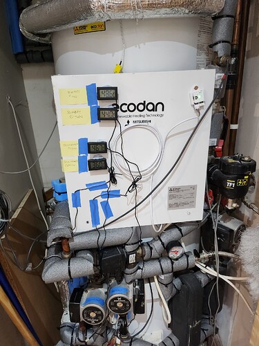

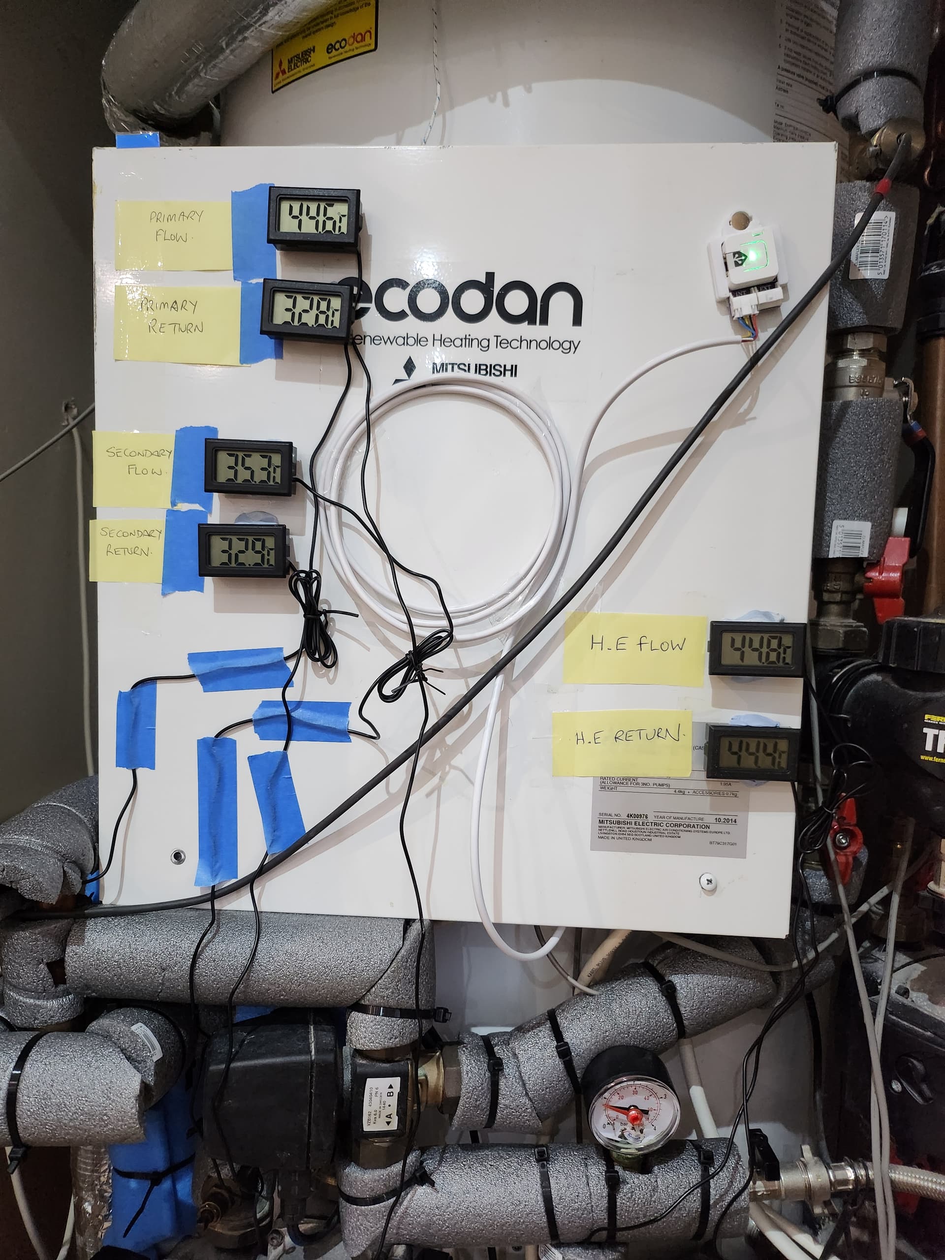

I went to site today, checked the thermal probe positions against the pipework and reseated them with ties, thermal paste and Al foil over the top. I also measured the DTs across all the radiators, which varied from about 5C to 1.5C. Some of the lowest ones were fully open.

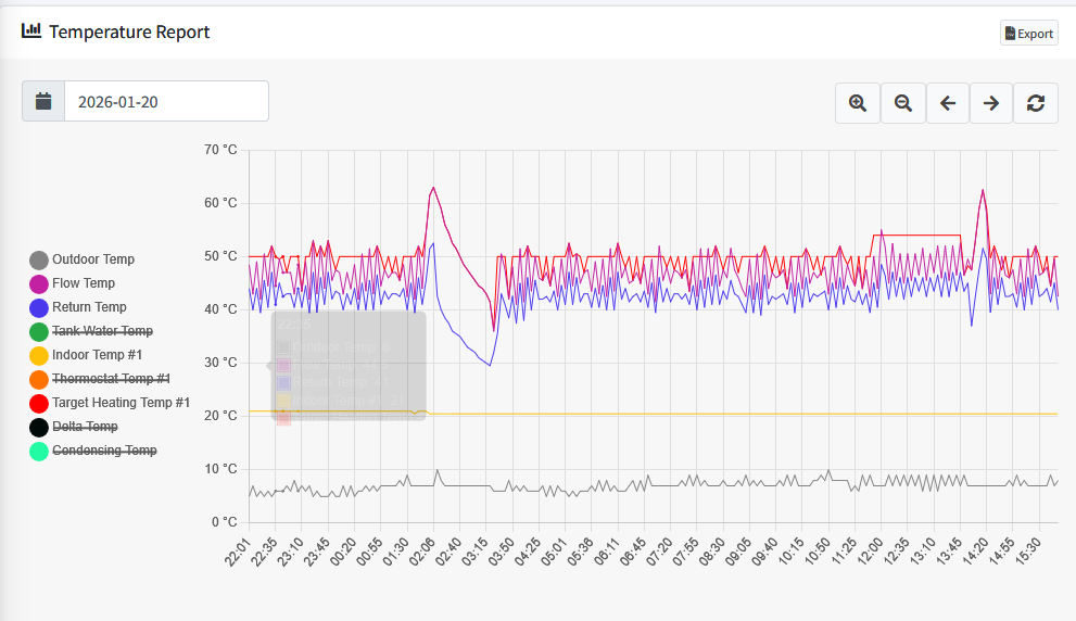

The HP was oscillating again so I switched to constant flow temp and got this
The system still wouldnt stabilise but I did get some movement on the secondary side temperature.

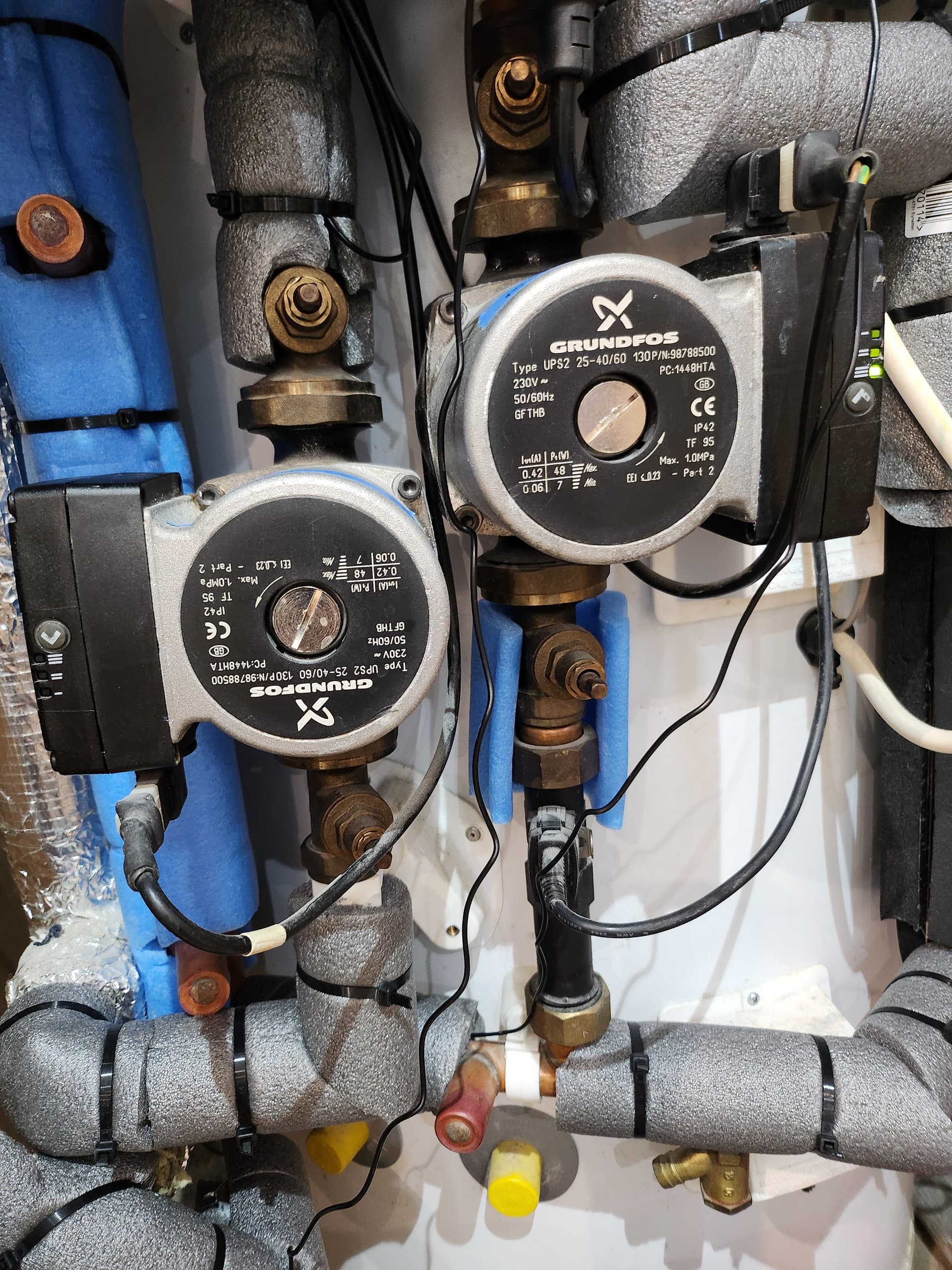

I then switched back to Auto Adapt and noticed something new

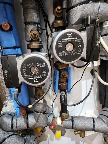

The light on the secondary pump had gone out. Does using AA mean the pump is controlled by PWM? The reading at that point were as below

Here is the plot from today
No. The speed of the secondary pump is fixed, and turned on when in unit is in heating mode.
The light on the pump went out in your second picture, before switching to AA mode - looks like it may have been heating DHW at that point.
I have never seen Grundfos Auto Adapt working “properly” in any situation where I tried it, anhow, I think CC or CP are the appropriate modes with a LLH.

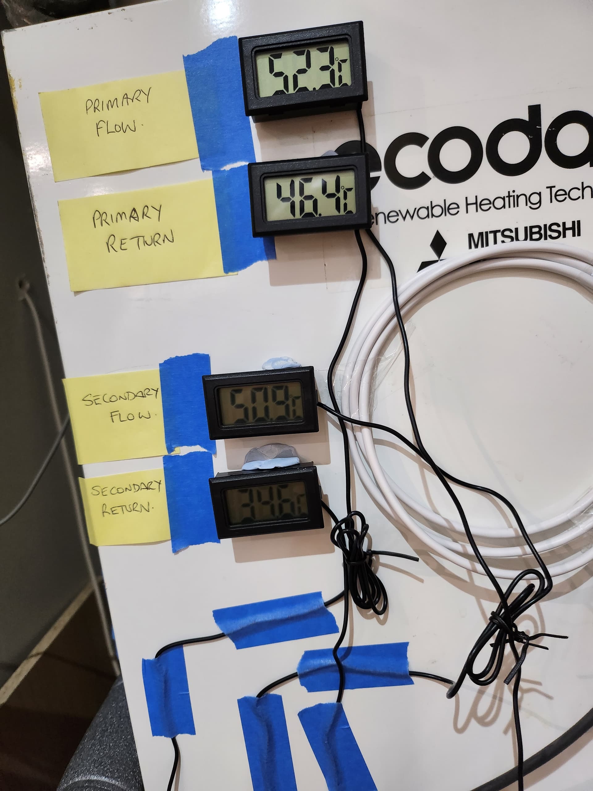

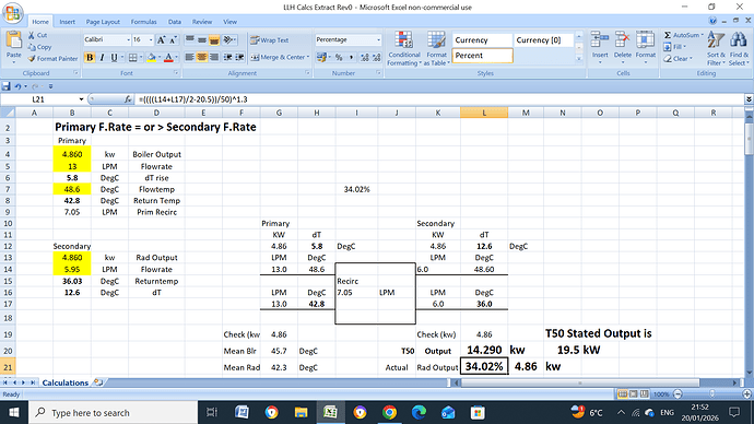

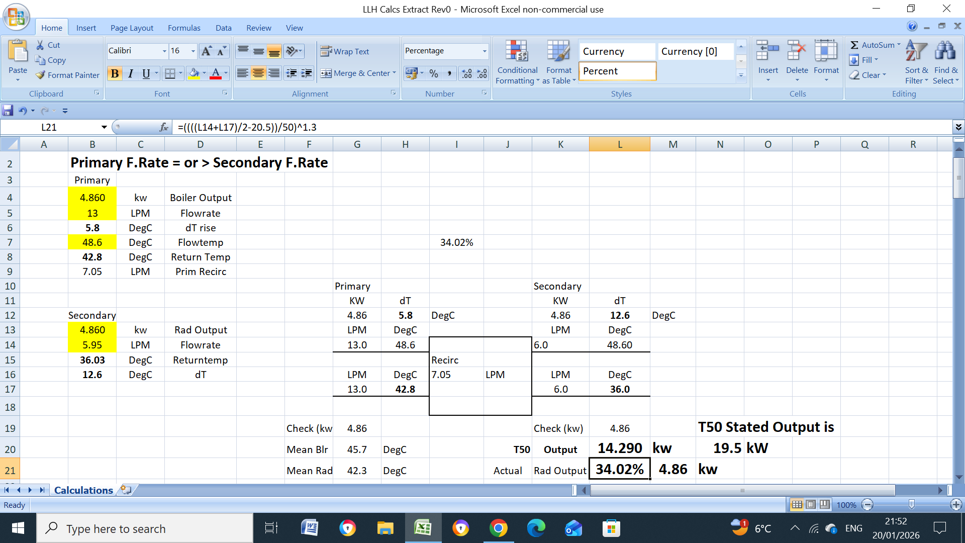

Before?? you tried AA, Your readings…Prim 48.6C/44.0C/dT4.6C. Sec 46.7C/36.0C/dT10.7 Mine Prim 48.6C/42.5C/dT5.8C/13.0LPM SEC 48.6C/36C/dT12.6C/5.95LPM HP Output 4.86kW Can’t make any sense out of the second set of readings but will have another look.
That explains it. I didnt think I had seen it before. Btw I did open the lockshield valves and a couple of rads that had a low DT
I think its hard to make any sense of the readings until it settles in a stable position.

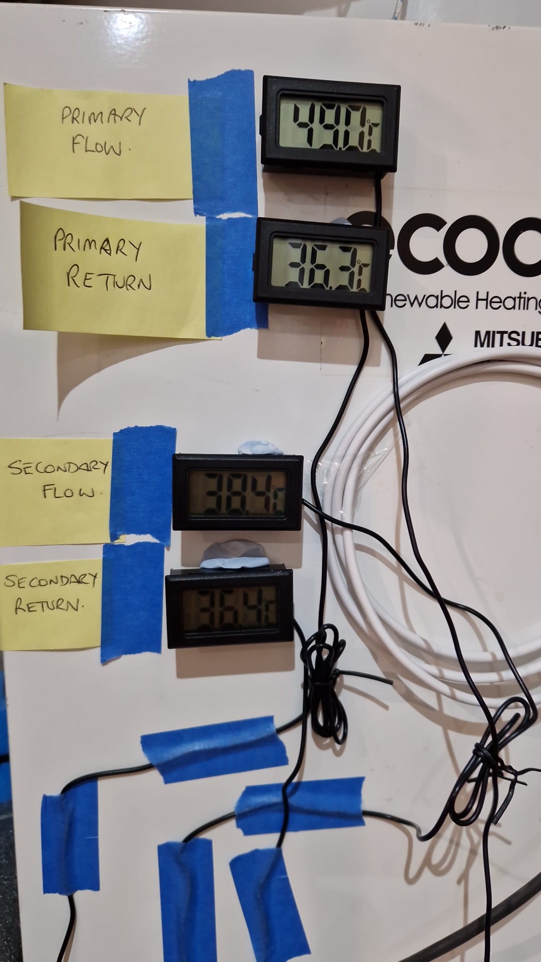

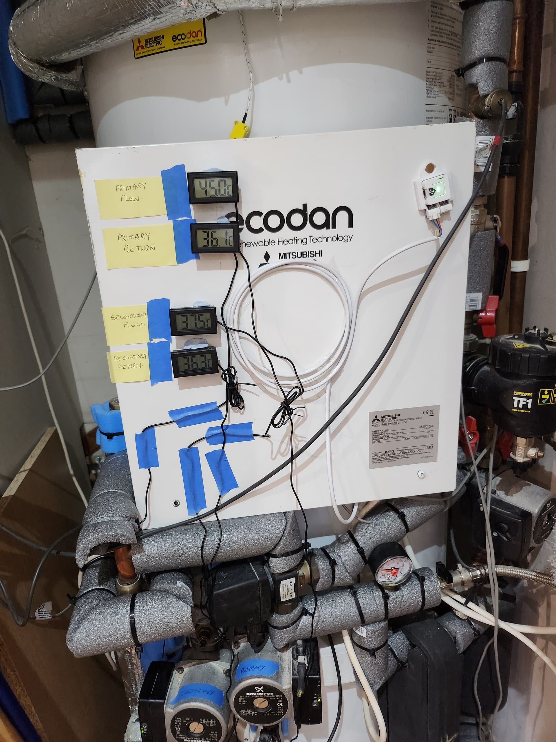

Success! The heating stabilised and I got readings at 8:42am
I also got reading at a radiator Flow-38.8C Return-31.5C
Would you agree this suggests that the problem is with the LLH and not heat losses within the floor slab?
Thanks in advance :slight_smile:

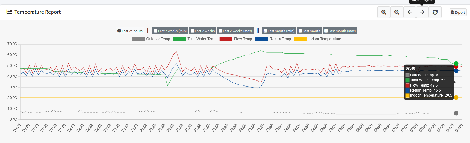

Primary flow temp (49.0) agrees with Ecodan’s own sensor (49.5), but the primary return does not (36.3 vs 45.5). This suggests an increase in temperature between the LLH and the primary pump. The secondary return (36.4) is close, giving some confidence in the sensor readings at the LLH. It’s possible that hot water is taking another route from flow to return…
Which kind of goes back to your first suggestion of a dodgy 3 way valve?

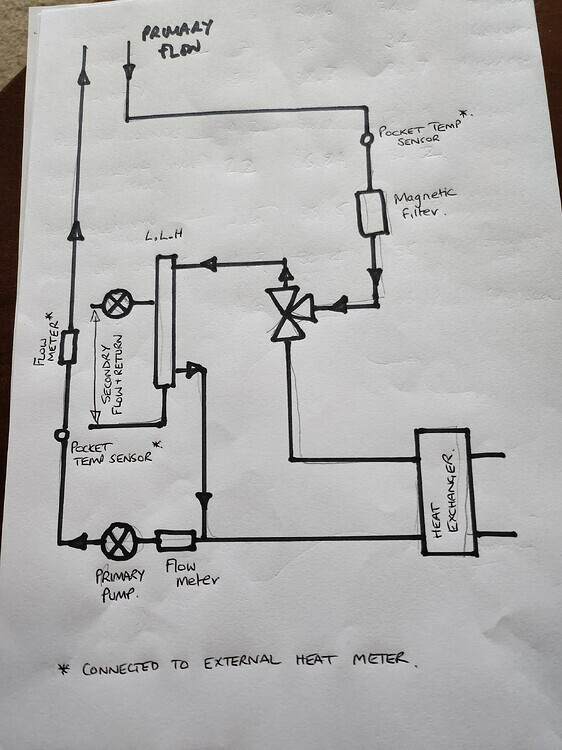

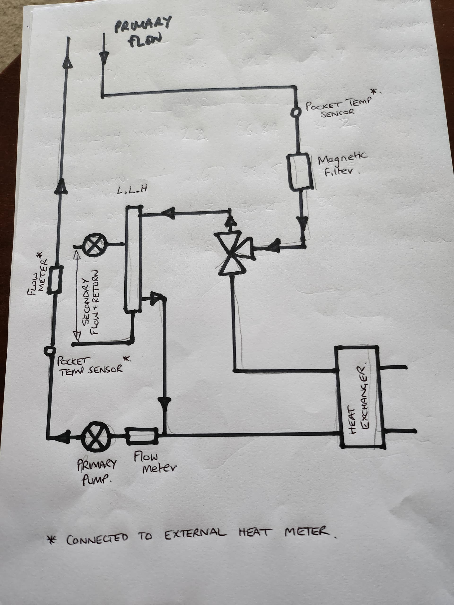

Here is a flow diagram of the system. The levels of the inputs and outputs to the LLH are as the installation

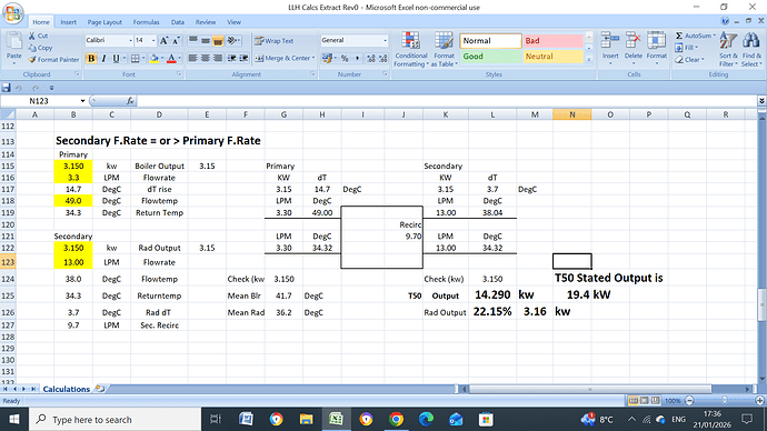

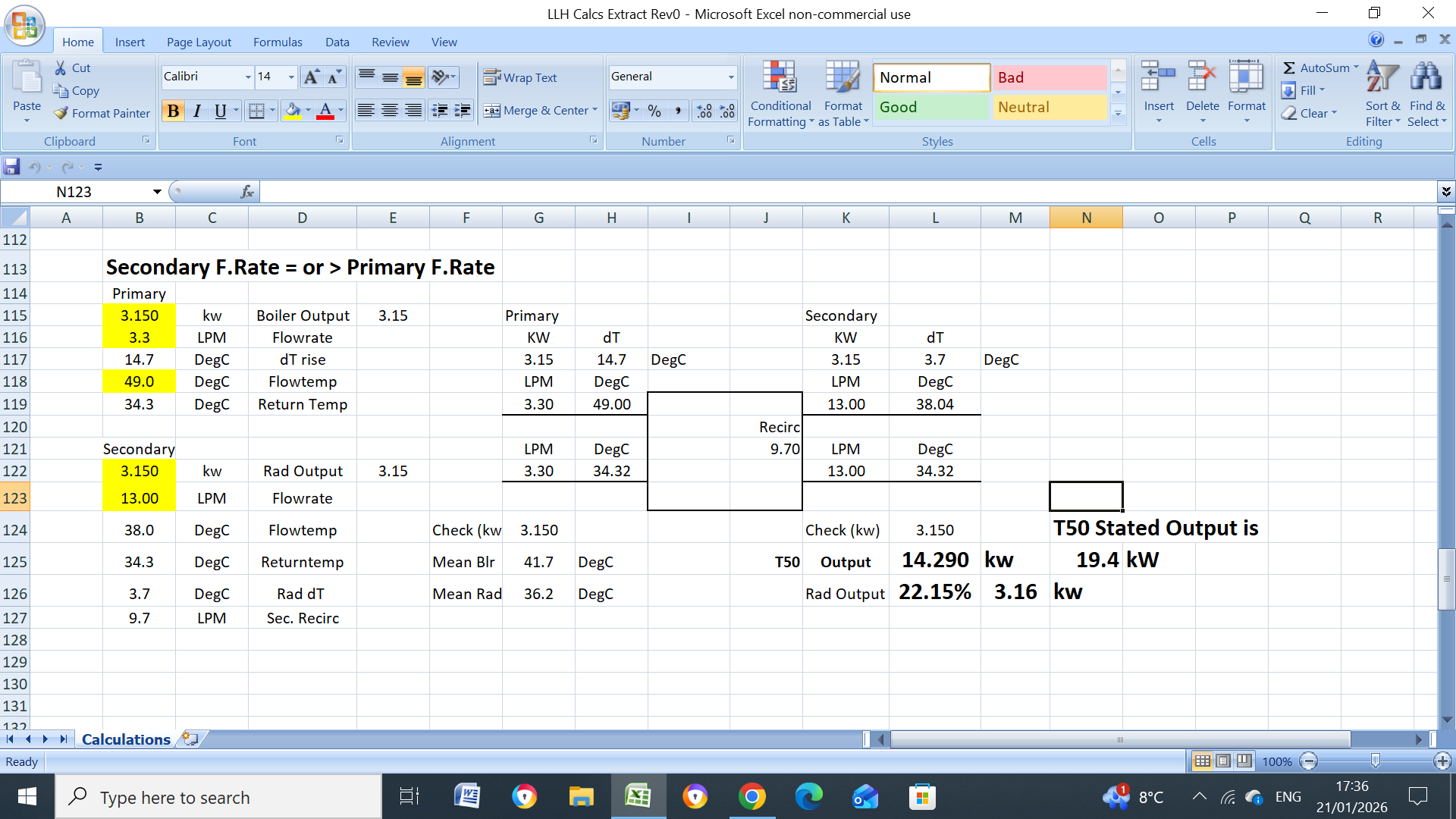

The only way I can get your LLH Secondary flow/return anyway close to your rads is to have a primary flow of only 3.3LPM and a secondary flow of 13.0LPM, output 3.15kW, but primary return is then only 34.32C, doesn’t make sense.

I will position some more temperature probes around the DHW circuit and see if that helps.

So, HW may be leaking through the 3 way valve, down through the PHEX, and mixing with the (primary side) return from the LLH?. (Nice schematic BTW)
Thanks :grin: I was searching for coloured pens.
Went this morning and positioned probes on the flow and return from the heat exchanger. Sure enough the heating water was circulating through it. Spot on Tim.
That looks as if there could possibly be massive bypassing through the 3 way valve, or where ever, because (9.7*44.85)+(3.3*32.85 = 13*41.8.
I’m not sure I follow your maths there John; seems you’ve used absolute temps instead of deltas.

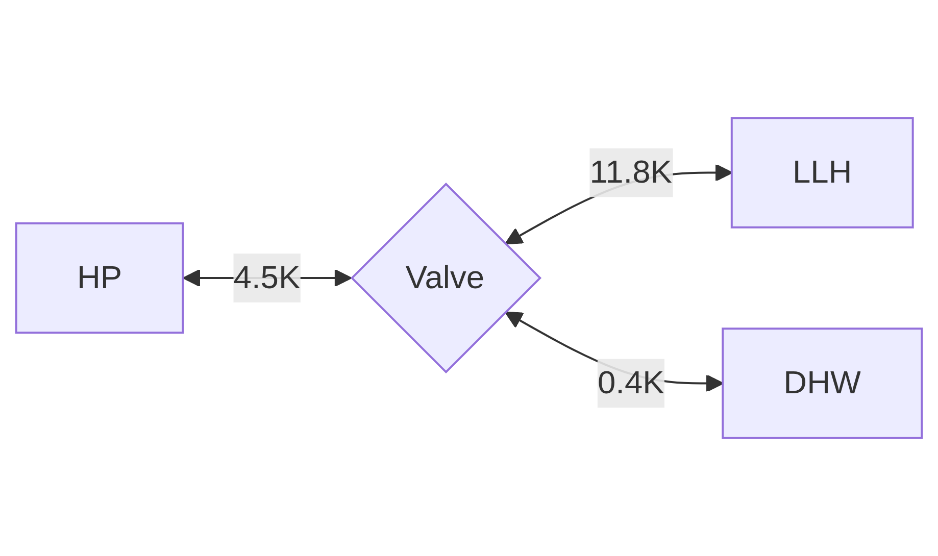

I think there are two simultaneous equations to solve here:
  1. power on each side of the valve adds up to power from heat pump
    11.8° K × X l/min + 0.4° K × Y = 4.5° K × 13 l/min
    (ignoring specific heat capacity and conversion to l/sec as common factors)
  2. flow rate on each side of the valve adds up to total flow rate
    X l/min + Y l/min = 13 l/min
Solving both of these gives 4.7 l/min through LLH and 8.3 l/min through DHW circuit. Or a 36% / 64% split. If the valve is stuck in one position, this would also reduce the heat going through the HEX when heating water [I’m guessing].
Does that make sense? Is that right? I’m not 100% sure…
