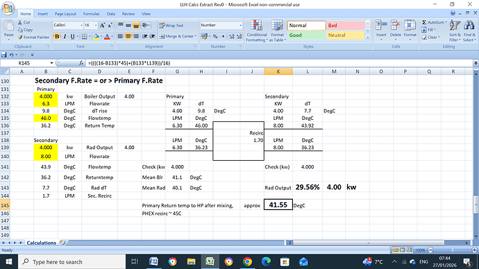

Only struggling Mark?, but I’m not going back to school at 80 :nauseated_face: . My calculated numbers arn’t hugely different to yours, but not as accurate as Tim’s. there is definitely a very large bypass through the PHEX, it will be interesting to see what effect it has on the Rad outputs + COP when the 3 port valve is replaced.

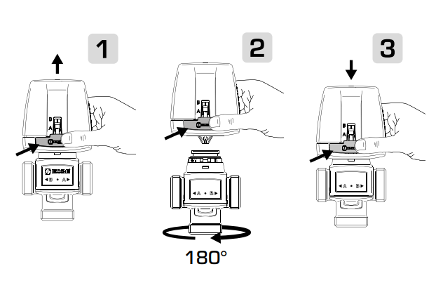

Maybe, just remove the 3 way valve actuator and turn/ensure valve spindle fully in heating position, take another set of readings. Post 75 might indicate that the valve was OK, then.
I did get a proper installer to look at it. He discounted the valve idea out of hand and wanted to rerun all the radiator pipework through the loft and fit a new heat pump closer to the cylinder. :money_mouth_face:
It looked like I couldnt remove the valve casing but I could try a little gentle persuasion with a blunt object :grin:
It says here “The entire actuator can be replaced without dismantling the valve”
Thanks John.
The installation guide suggests you simply press a button and pull it off:
Caveat: I’ve never done it, and am not a plumber. Good luck!
Hi Tim. Yes I watched a youtube video. The catch must be on the blind side but ill give it a go. :grin:

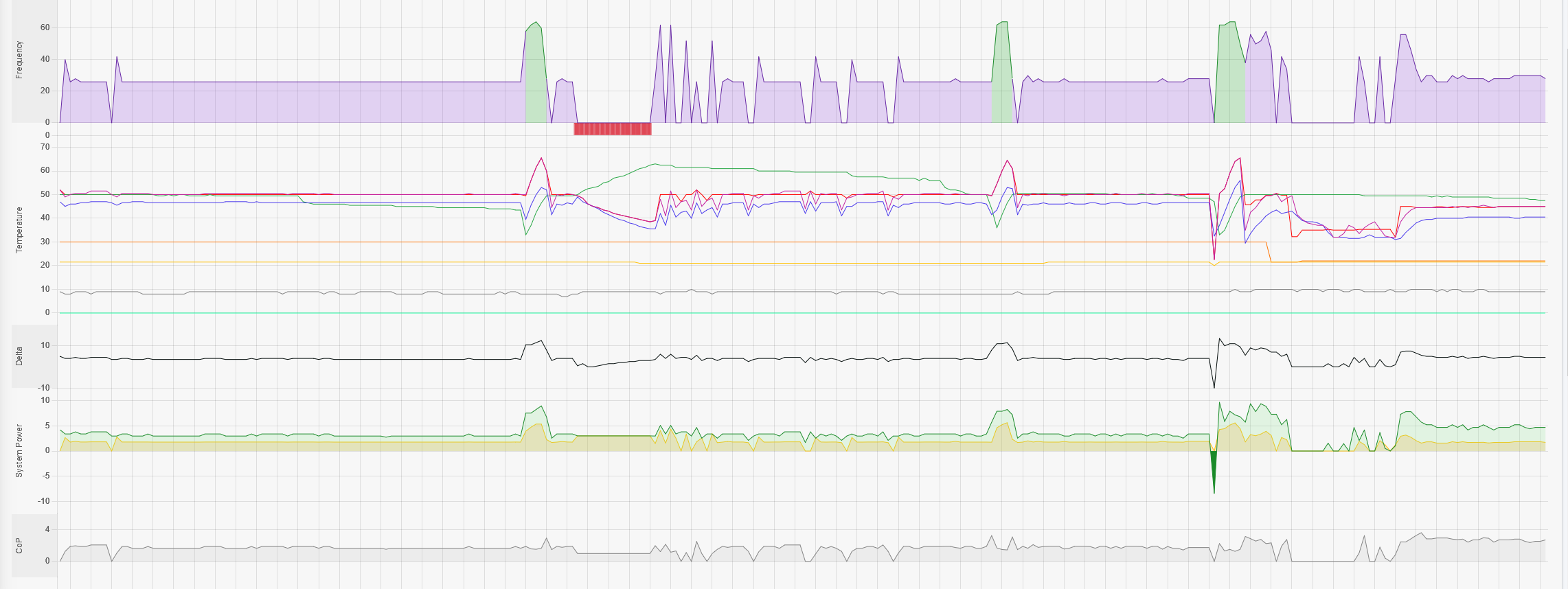

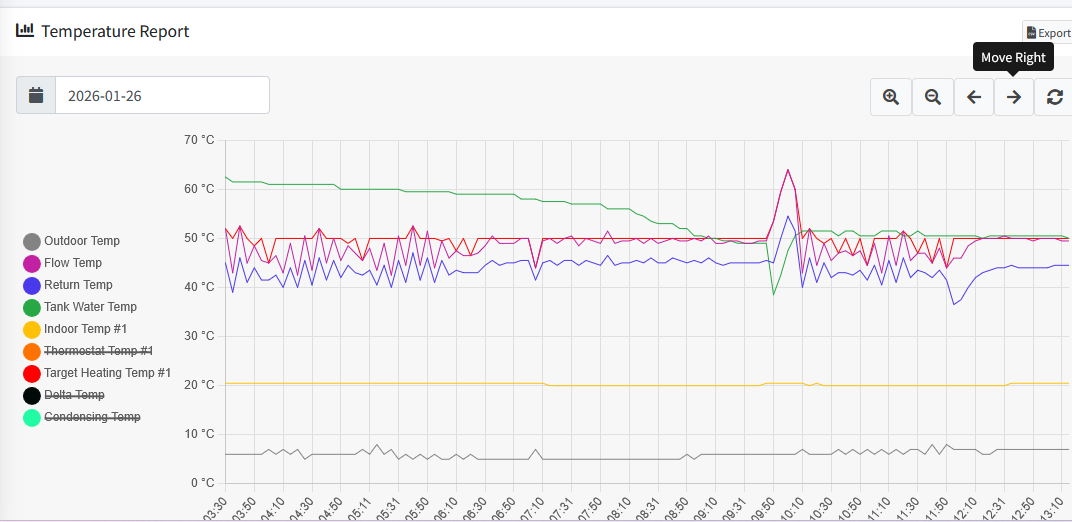

Managed to get to site today and opened up the valve. Immediate difference upon pulling the pin out!
Also the plot looks so much better after about noon :-). Thanks guys for all your help, new 3 port valve about to be ordered
That is looking much better. I also note that the flow rate is also higher at 16 l/min. This should result in more heat actually getting to the radiators.

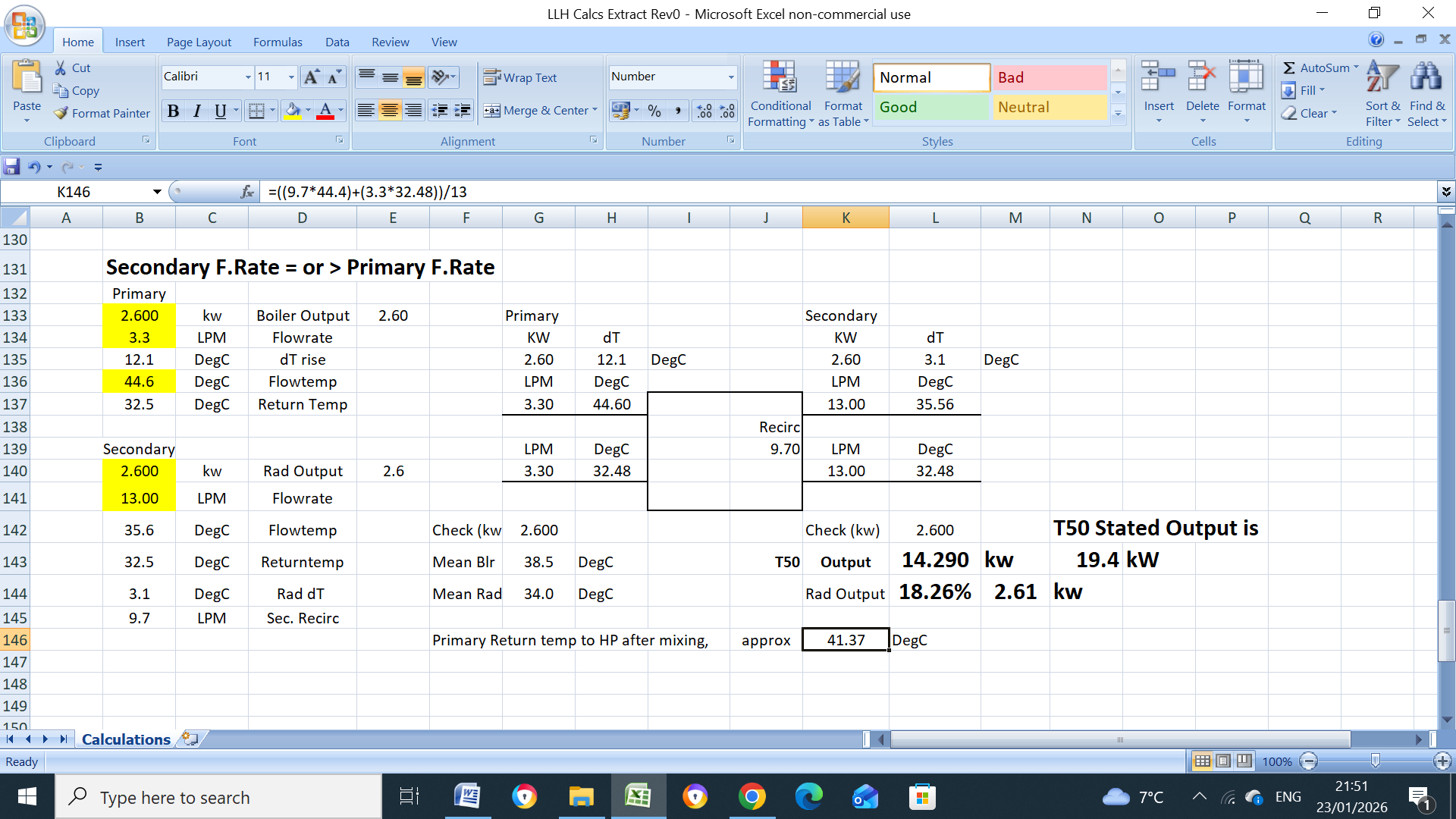

Wonder does removing the 3 way valve actuator mean that its the HW function that’s enabled hence the increased flow of 16LPM through the Primary return to the HP?. My calcs below show, (assuming 16LPM) that 6.3LPM at ~ 35C is mixing with 9.7LPM of PHEX bypass at ~ 45C to give a HP return, 16.0LPM at ~ 41.6C. The LLH secondary flow only calculates at 8.0LPM. HP output 4.0kW.

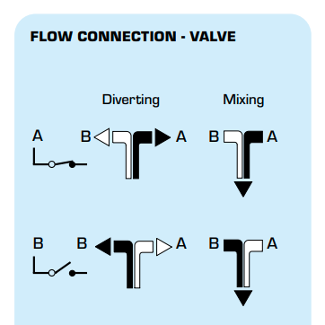

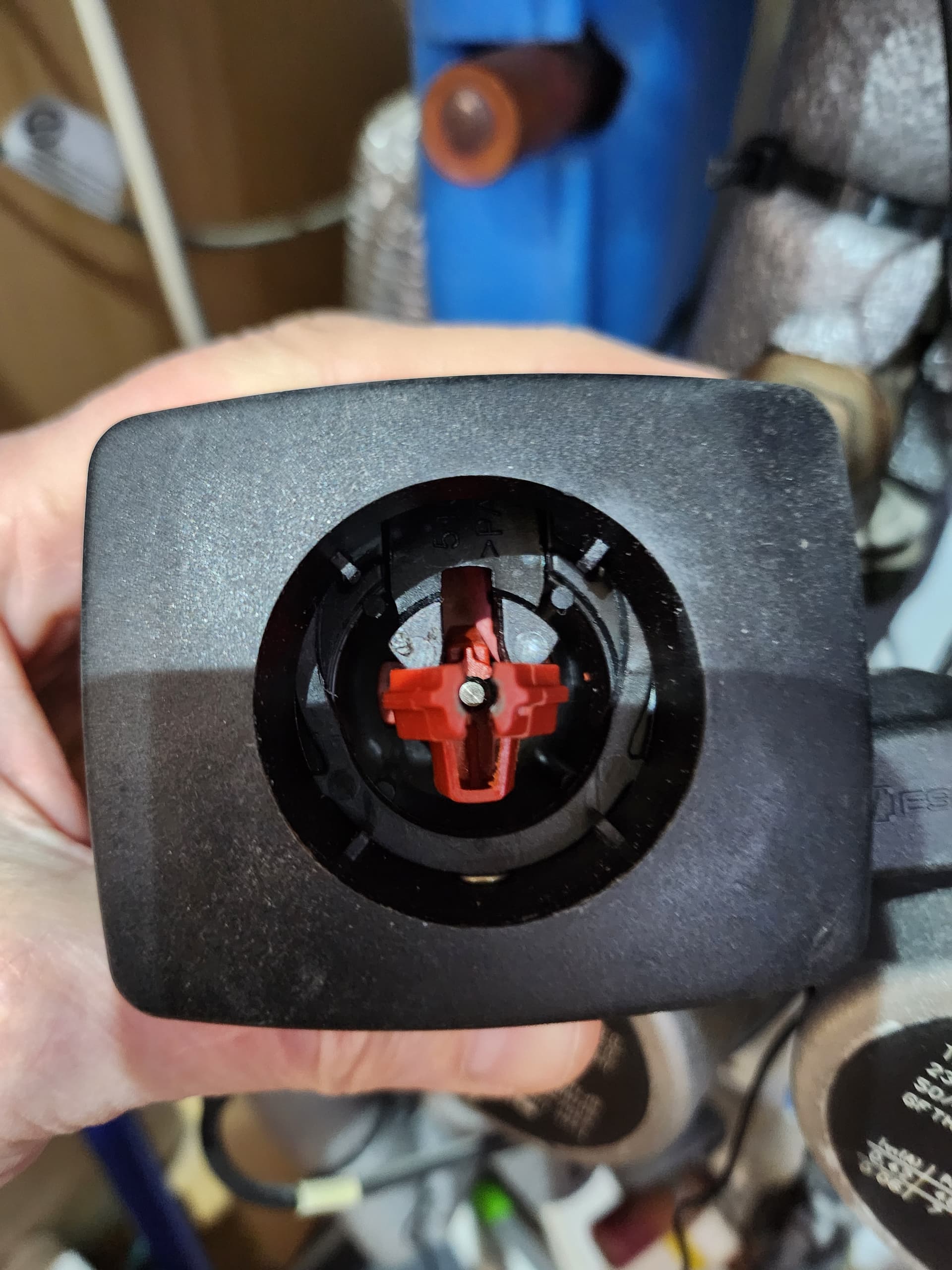

In its resting position, the valve directs flow to central heating (position B). When energised by applying power, the valve directs flow through the HEX for hot water (position A). I believe this is fairly typical for this setup.
My hypothesis is that the valve is not returning fully back to its rest position B, either because the actuator is faulty or there’s some crud inside the valve itself. Mark’s experiment yesterday suggests the former.
Since the hot water cycle has been run, the flow rate has fallen back down to 13 l/min, so the problem is not solved yet. Hopefully a new actuator or valve will address that.
Does this look like the pin has snapped?
It does, though I don’t know what it should look like. Something may have jammed within the valve to cause that to break, I guess.

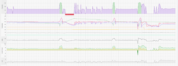

So the valve was changed today, with a clear difference. COP went from 2 to 3 with the flow temp reducing using auto adapt mode. :slight_smile:

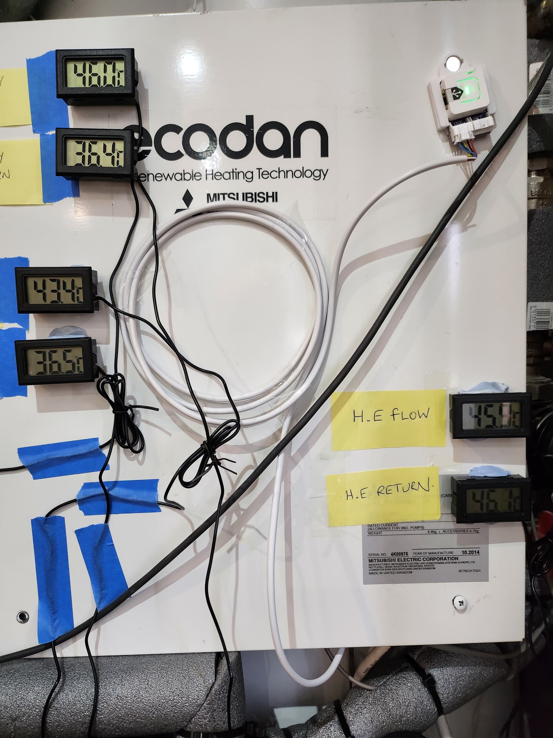

Great news, maybe a set of your sensor readings again sometime when you get a chance.
I might go to site tomorrow John. :slight_smile:
