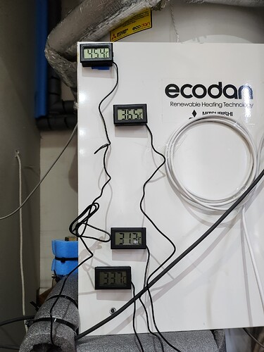

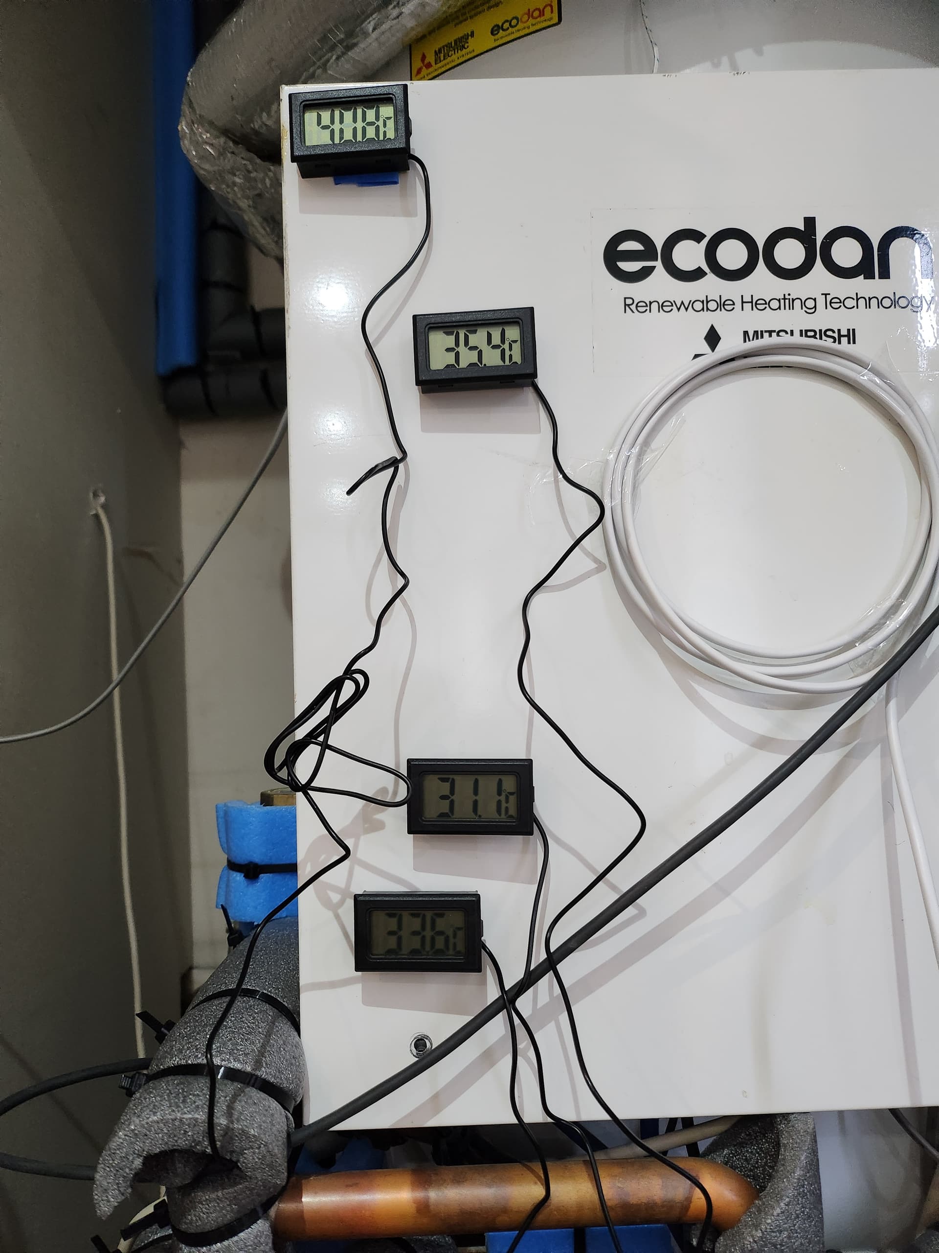

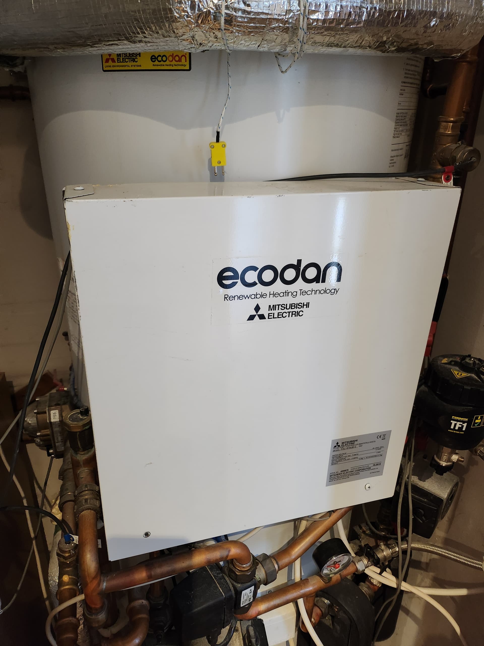

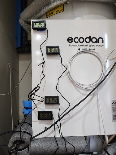

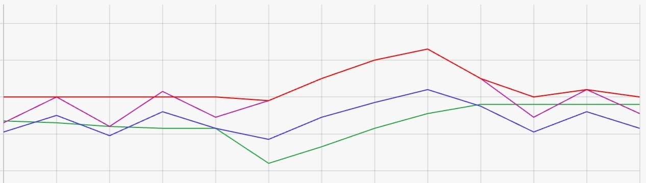

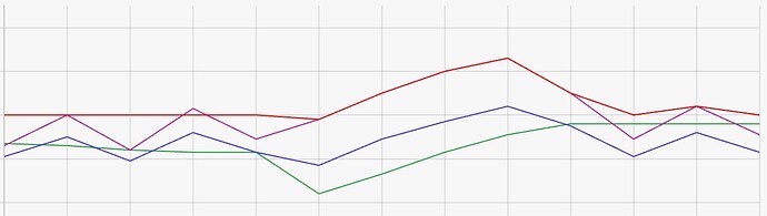

I positioned the temperature probes I bought around the LLH. Here is whats happening. The pictures are taken minutes apart and you can see the oscillation in flow temps
Best to wait until they steady down, can you confirm that (from the top) the first probe is the primary flow, the second is the primary return, the third is the secondary return and the fourth is the secondary flow?
I had assumed a different order of sensors, so I’ll wait for Mark to confirm.
Are these sensors strapped tightly to the pipework, or just stuffed under insulation?

OK, so the order of sensors is the same as the pipes coming off the vertical LLH. Top sensor - Top pipe, bottom sensor bottom pipe. With all the insulation it was hard to see. I was just looking for a schematic but no joy yet.
They are all stuffed under the insulation.
The room temperature is measured in the hallway by the remote mitsubishi sensor/controller, no third party thermostat.
The property cant reach the the set 23C but seems to be able to hold 20.5C more or less.
Its probably safe to assume that the top probe is the primary flow, what’s a bit surprising is that neither of the secondary probes is reading some where close to 40C, except that there is a huge imbalance with the secondary flow far in excess of the primary.

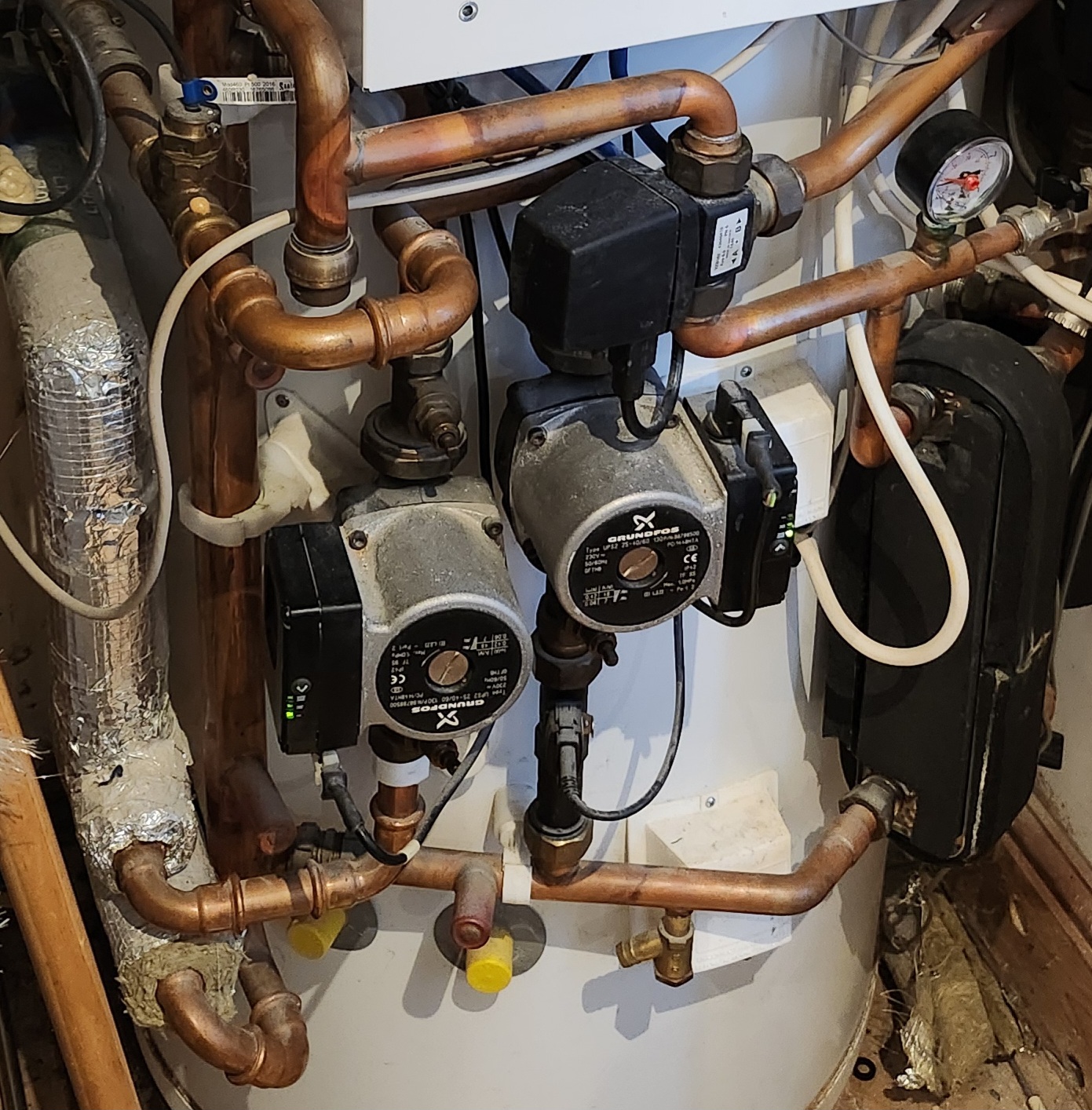

Also worth checking that the two circ pumps are installed on the correct pipes and orientated correctly.

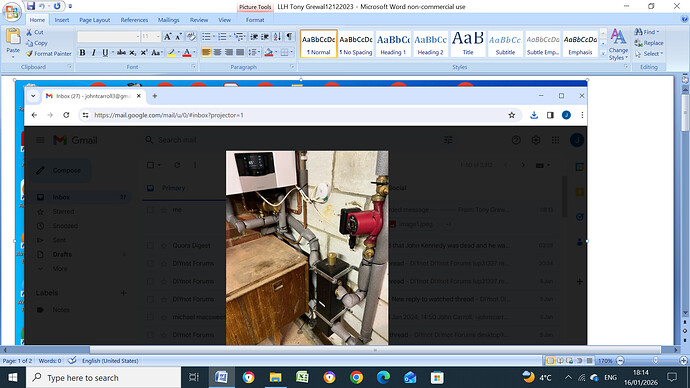

So, how is the secondary return (bottom pipe) hotter than the secondary flow (top pipe), have a look at the pump installation.

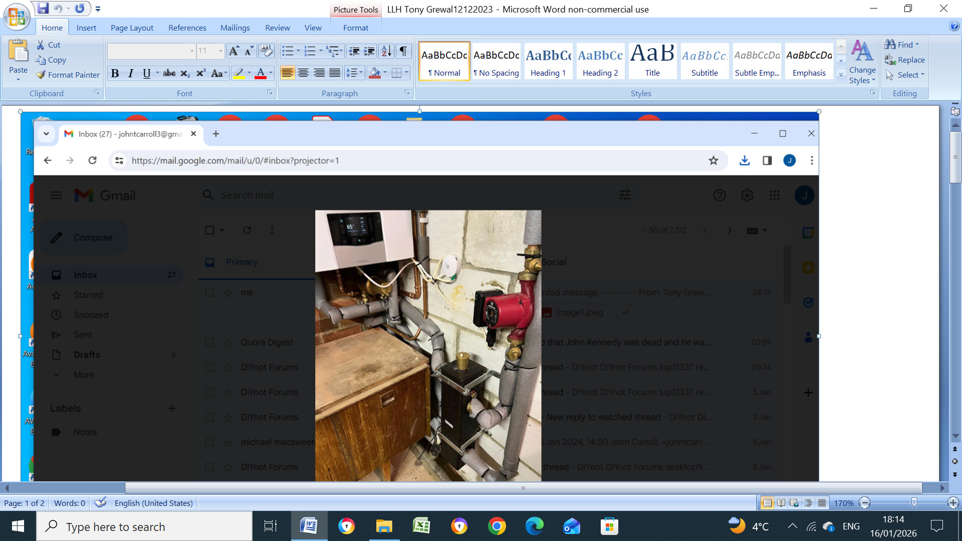

These are my best pics pre insulation
Does this help?
If its not making sense, then I will go back and check. take off the insulation and zip tie the probes to the pipes.

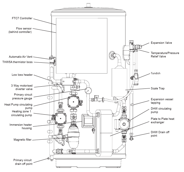

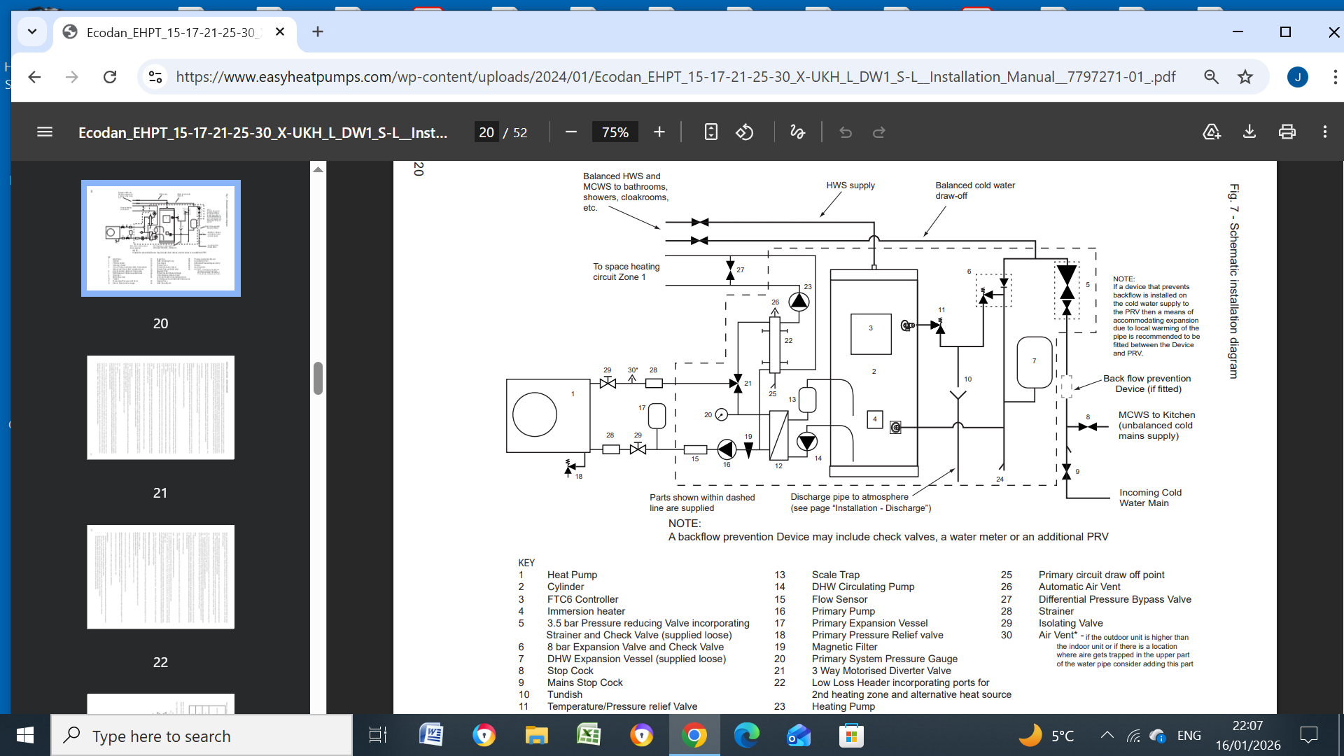

The “LLH” in the schematic looks more like a Low Loss manifold, a conventional LLH looks like the one below, the primary pump is the (gas) boiler’s own circulating pump
Well it definitely looks like the one in the schematic as you can just about see from the photos
Yes, this schematic gives a good view. As long as the probes are securely positioned in their proper locations then should get a bit more info with system running steadily.
The primary pump,16, should be pumping/arrow pointing, to the HP and the heating pump, 23,should be pumping/arrow pointing away from the secondary side of the LLH.
The pump on the right is the primary and left secondary. They appear to me to be in the correct orientations.
