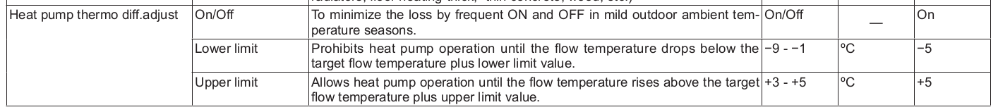

If you can increase the speed of the primary pump, that will bring down the dT and may help the heat pump operate within max/min flow temps. With AA mode enabled, you can adjust these limits in the service menu under Operation settings > Heating operation:

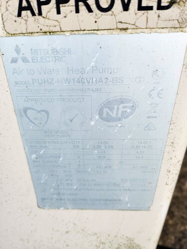

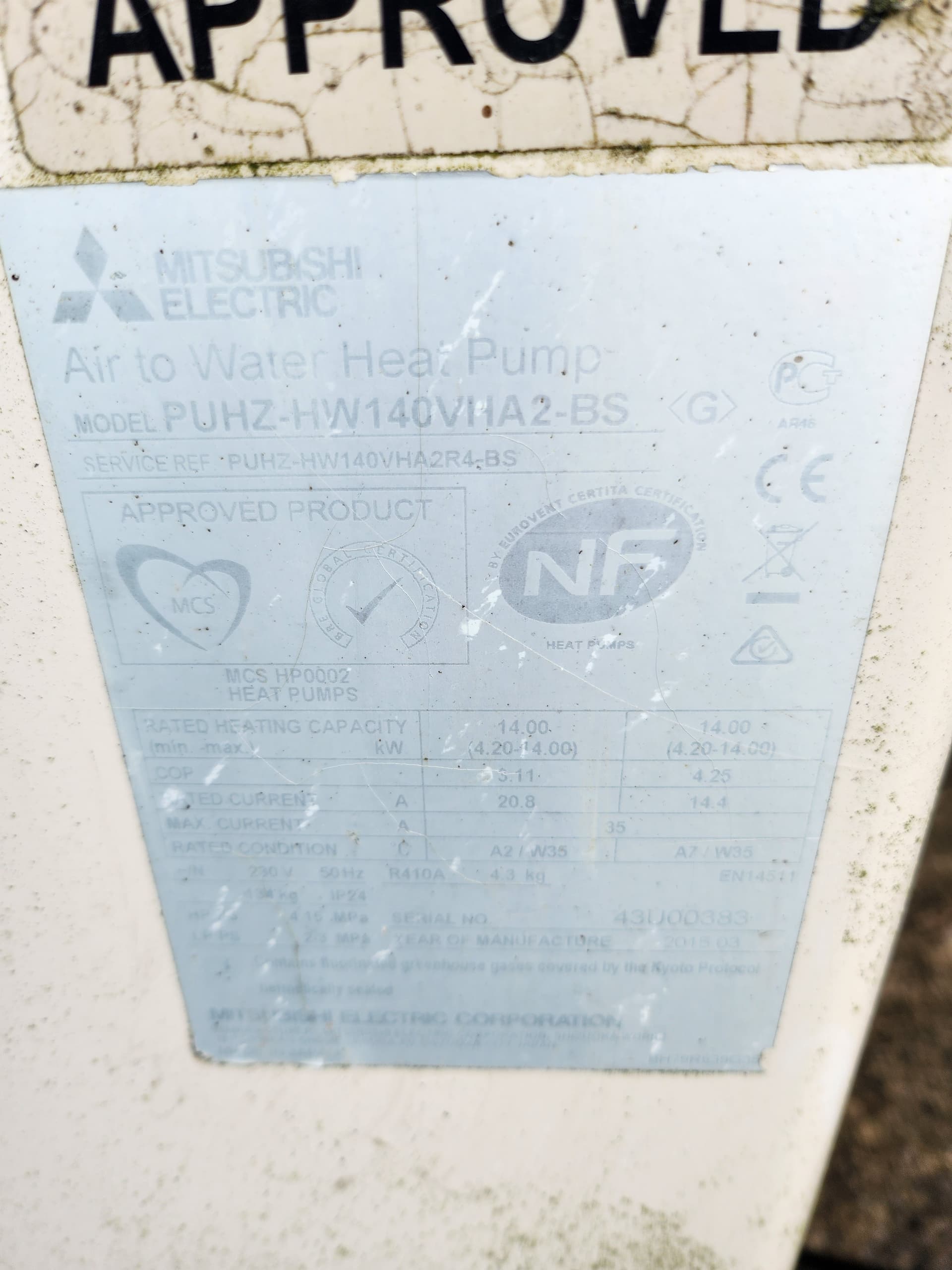

Here is the HP Model

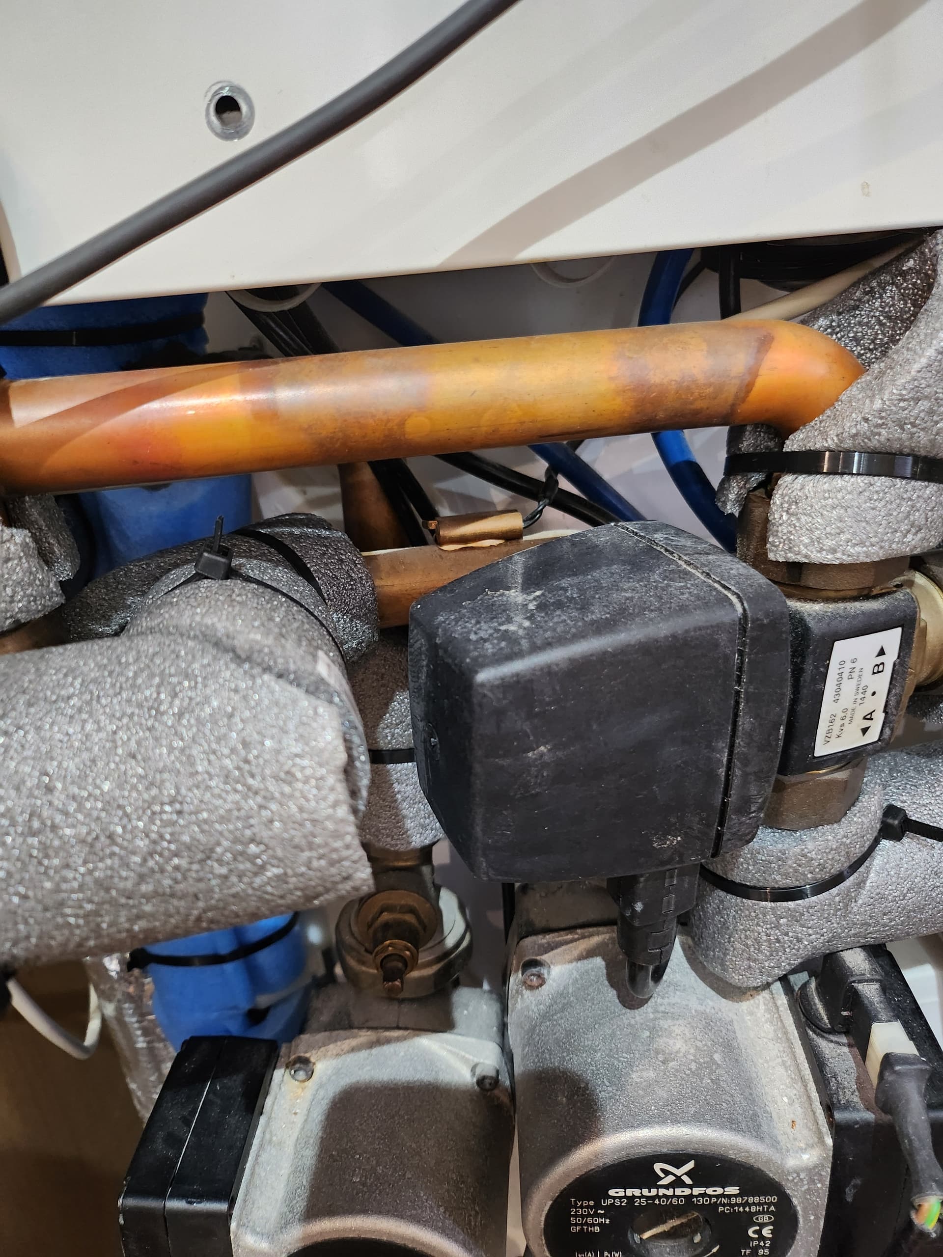

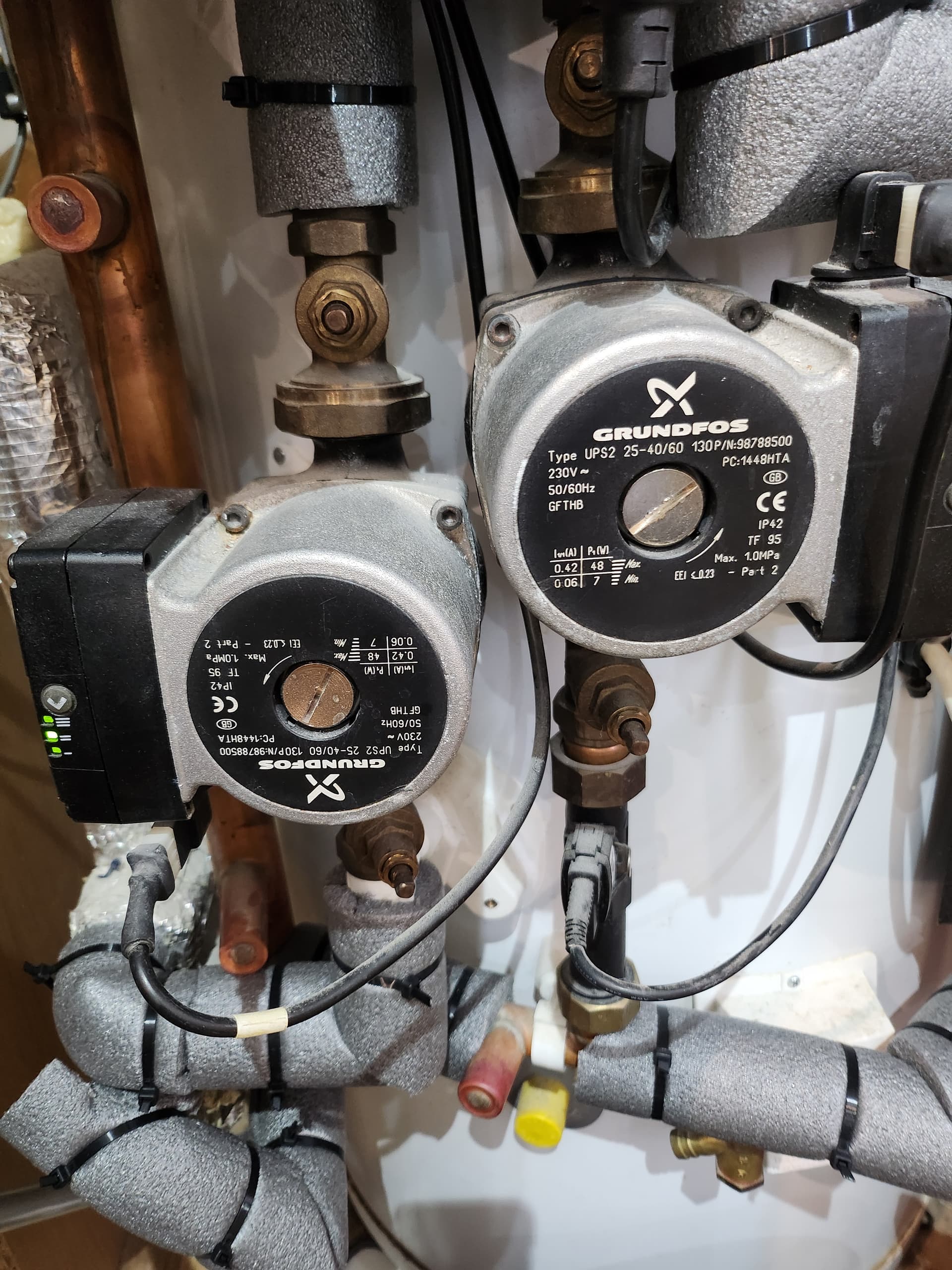

And the pumps, unfortunately the primary is at max.

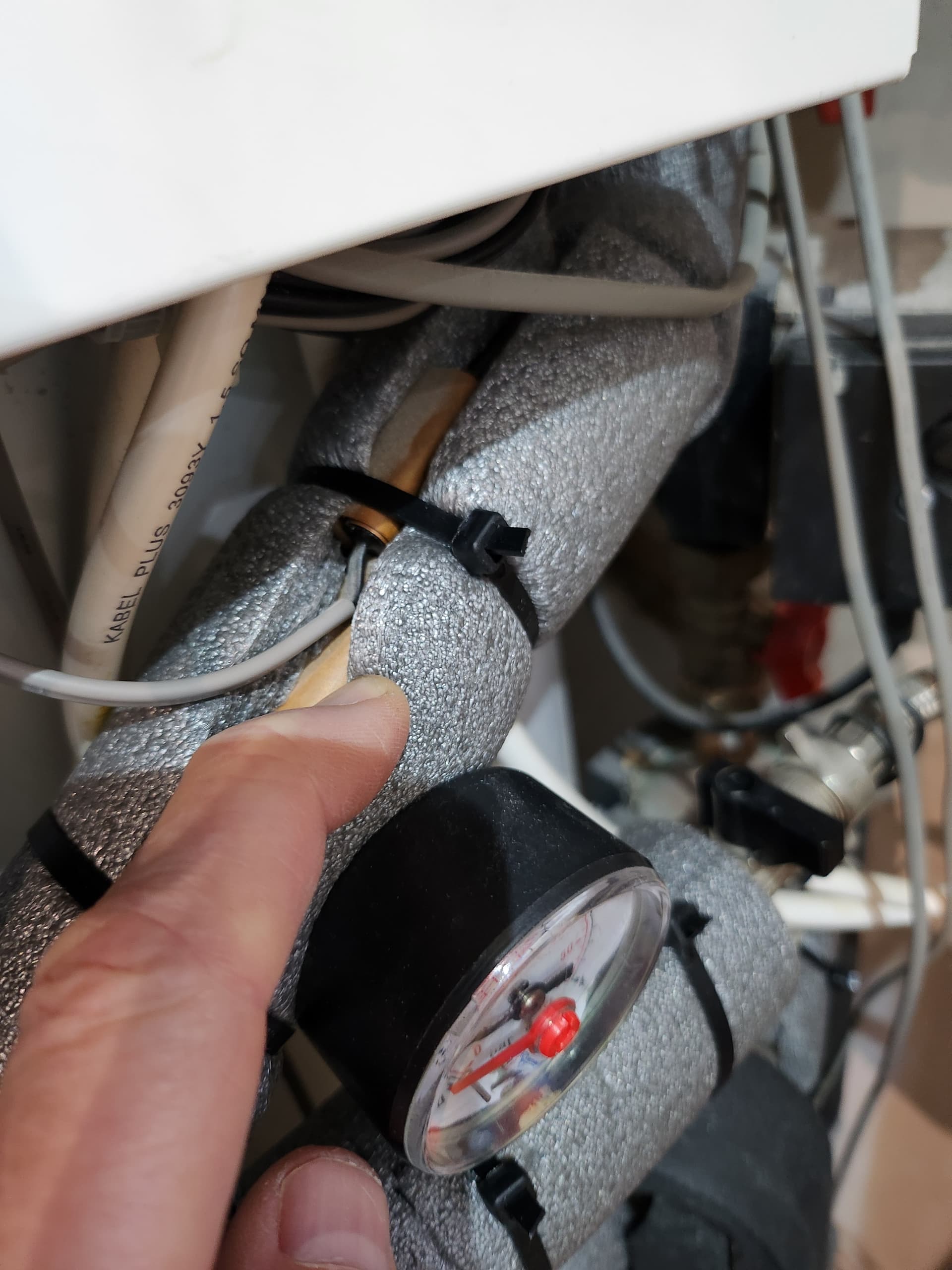

The temperature sensors look closely placed to the pipework

I changed the Thermo diff setting from 5C/-5C to 5C/-9C.
I noticed that the primary pump and secondary pump were running at different speeds. Primary -3 Secondary -1 Im given to understand that this causes distortion and a loss of efficiency?
The second temperature sensor could do with insulating, but that won’t affect how the unit operates. Will just make dT seem bigger than it really is.

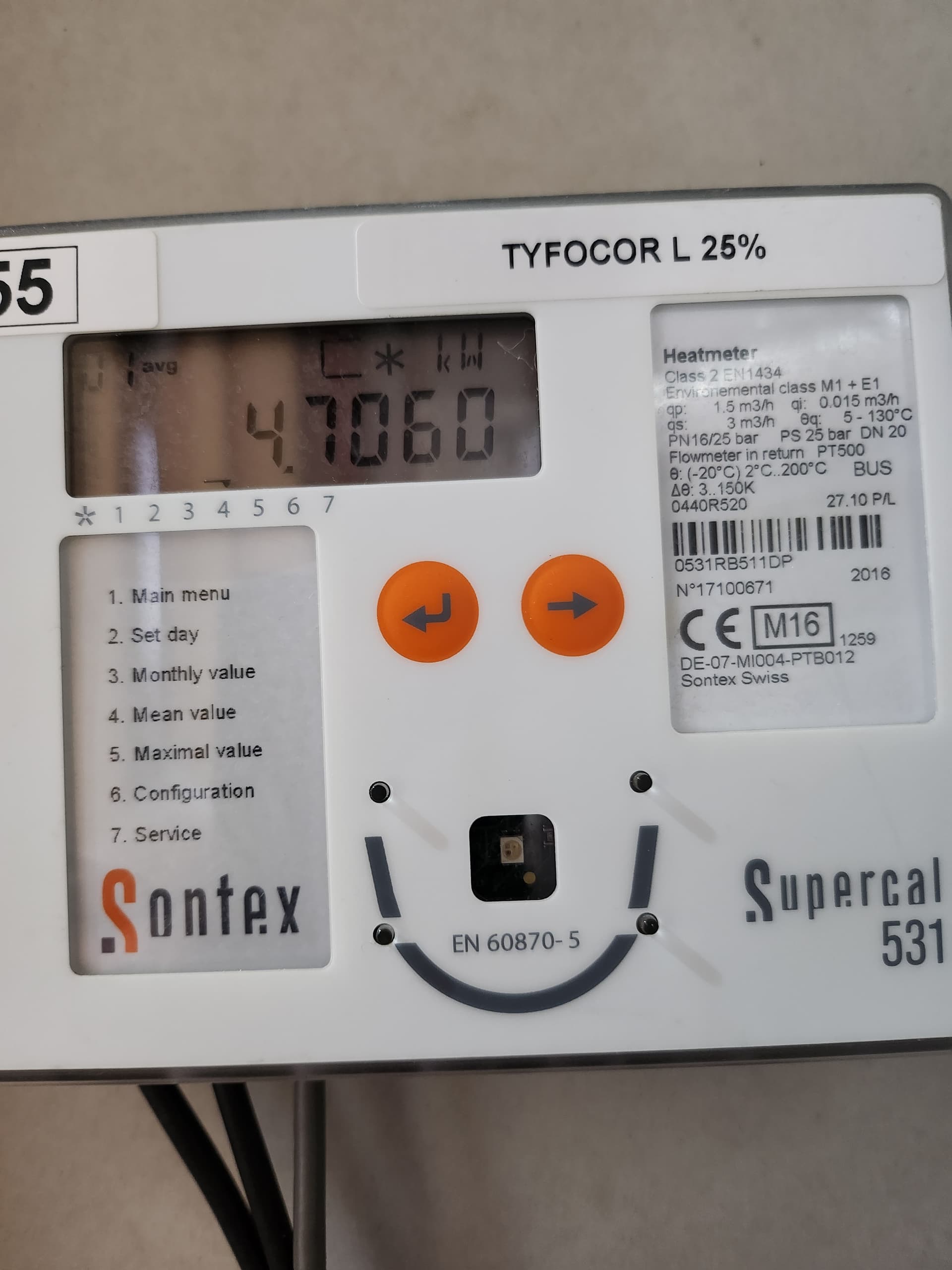

Is the Sontex heat meter wired into the Ecodan? If so, then that may be where heat power measurements are coming from, and will be affected by how well its temp sensors are installed.
Did you check the pump speed settings in the service menu?

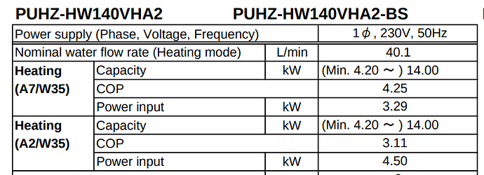

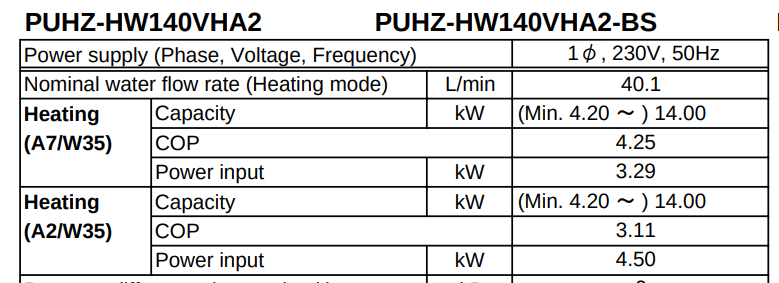

The model PUHZ-HW140VHA2-BS is a single phase 14 kW unit with R410A refrigerant. Minimum heat output is 4.2 kW.

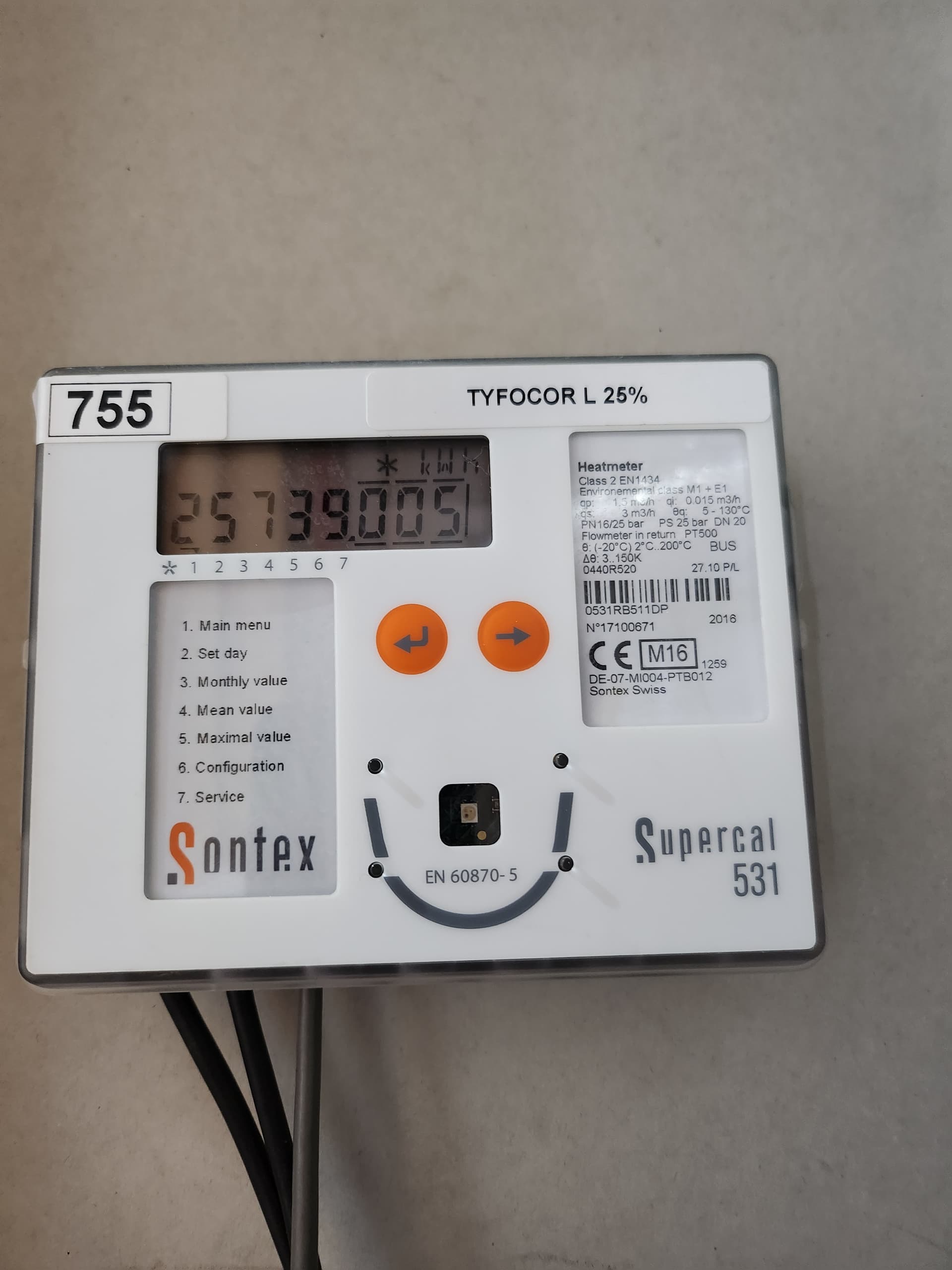

I note that the Sontex is calibrated for Tyfocor L 25%, a solution of glycol, so heat calculations will need to be adjusted accordingly (specific heat capacity is reduced from 4180 to 3940 kJ/kg.K at 50°.
I did insulate the second sensor before I left :slight_smile:

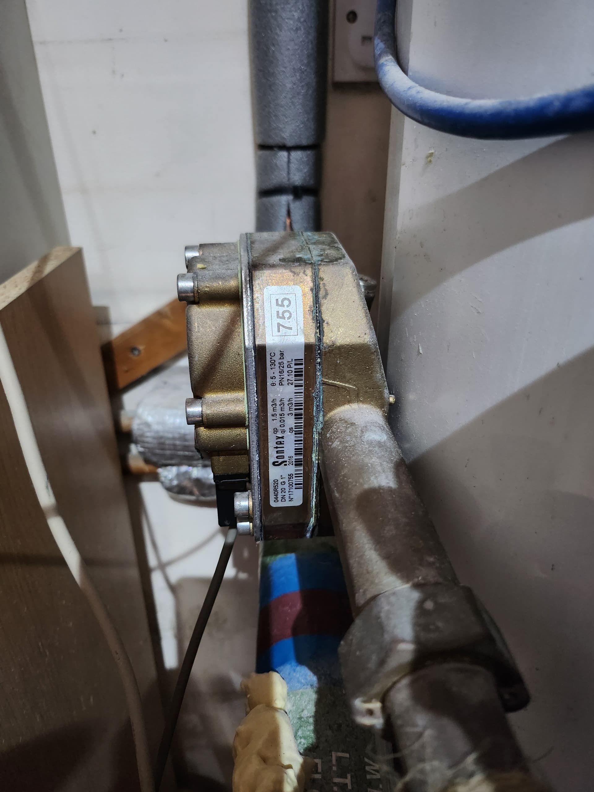

The heat meter was connected to 2 pocket sensors and this below, which I thought might be a flow meter, so I think it separate to the ecodan.
I misunderstood you about the pump speeds and thought you just meant the Thermo diff was there. The pumps seemed to controlled by the push switch on their sides with 3 settings I, II and III

Yes, that’s right. I have the exact same setup, and it’s wired to my Ecodan so it reports actual measured heat rather than estimating it. If this is the same for yours, this will mean that the flow and return temperatures will not be directly related to the heating power presented on Melpump. Not a problem, but worth bearing in mind.

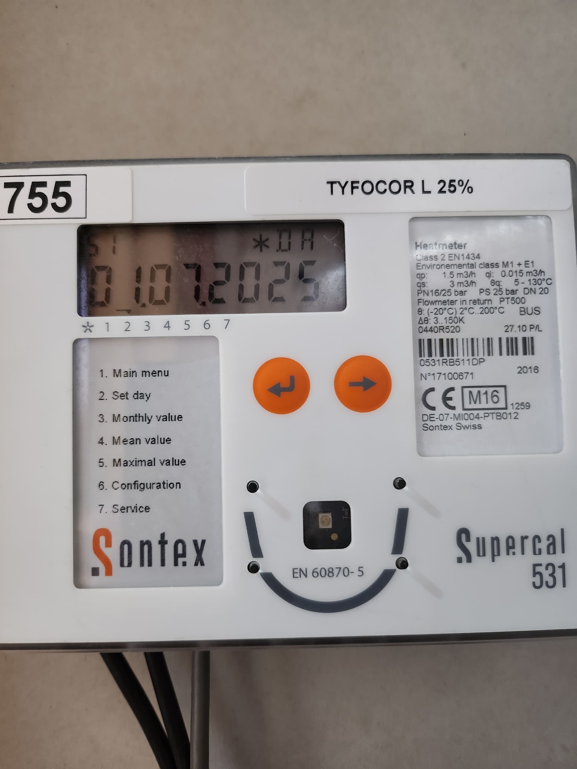

The heat meter is showing total 25,739 kWh since installation. There will be an electric meter nearby (possibly also connected to Ecodan) that will report total consumption since installation, which will give average COP.
Ah. Looking at your photo, there are only 3 wires: flow + 2 temps. Mine has a 4th wire connecting it to the Ecodan, which yours does not. So Melpump is estimating heat power only from Ecodan’s sensors.

I would how difficult it would be to connect the 4th wire?

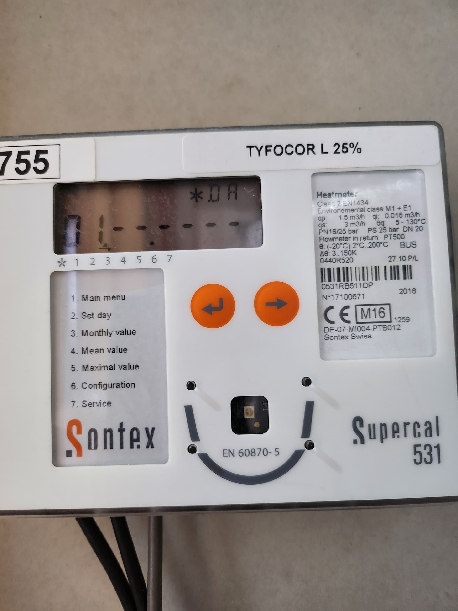

Hard to see, but there’s a marker on the LCD above the numbers 1 2 3 4 5 6 7
Your first photo shows ‘4. Mean value’ of 4.7 kW, last photo shows ‘5. Maximal value’ of 7 kW.
I see it now thanks :slight_smile:
Probably straight forward if you follow the Ecodan FTC4 installation manual. There are a couple inputs on the controller plus a couple DIP switches. Don’t know if the electric meter bit would need to be done by a qualified electrician…

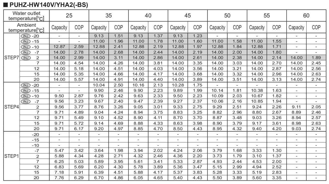

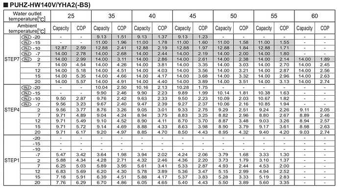

For reference, here’s the performance data from FTC4 Databook for that model of heat pump:
  • STEP7 Maximum performance
  • STEP4 Medium performance
  • STEP1 Minimum performance
  • (INJ) icon means injection circuit is active (electric booster, if fitted)
  • Gray highlighted data means integrated data including defrost operation.
So, running at 50°C when it’s 2°C outside at minimum power (3.73 kW) has a COP of 1.8.
(will be slightly worse with glycol)
Thanks, a COP of less than1.8 sounds much more like whats happening.

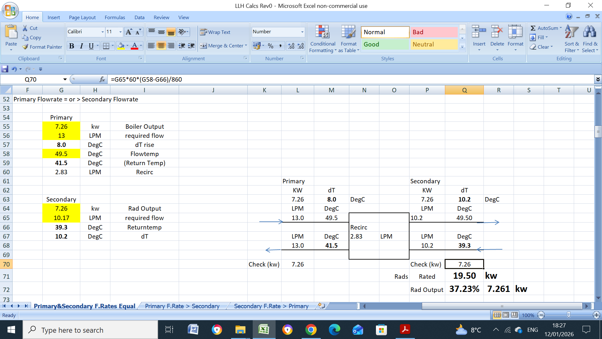

The primary pump head (from the pump curves) is 5.6M at 13LPM, by my calcs the HP might be outputting 7.26kW, if so, then a flowrate of 25.07LPM would be required to maintain (my) a dT of 8.0C which would require a pump head of 20.8M at its full output of 14kW or a pump head of 15.3M at 12kW output, no way can this be true so the 13LPM simply cannot be correct except its throttled down somewhere??.
Letting that aside, if the secondary pump is running on speed 1 and assuming the rads+system resistance is the same as the primary resistance then the secondary flowrate will be 10.17LPM at a 3.42M head giving my output of 7.26kW with primary flowrate/flowtemp/returntemp/dT of 13LPM/49.5C/41.5C/8.0C and a secondary of 10.17LPM/49.5C/39.3C/10.2C
Tim, over what period are these values? Are these “all time” and the pump has never exceeded 7kW of heat delivery, or is this over a shorter period? Thanks
Morning John. I have to admit to not following what you are doing.
Simplistically if the DT is 4C, flow 13 l/m and antifreeze being used then the instantaneous power is
4*13/60*3940 = 3.4 kW
This intuitively sounds about right at an OAT of 9C given my heat loss calculation. Im struggling to believe that either the temperature sensors or the flow meter can be hugely inaccurate.
I imagine that the 3.4 kW is reduced by the use of the LLH before it gets to the radiators.
What am I not getting here?
I downloaded the FTC4 manual Tim and this is what it said under pump speed.
Actually I think I might have the FTC 5
Oh, okay. They must have added it to FTC5 which I have.
I think I do have the FTC5 so Ill check again next time im up
