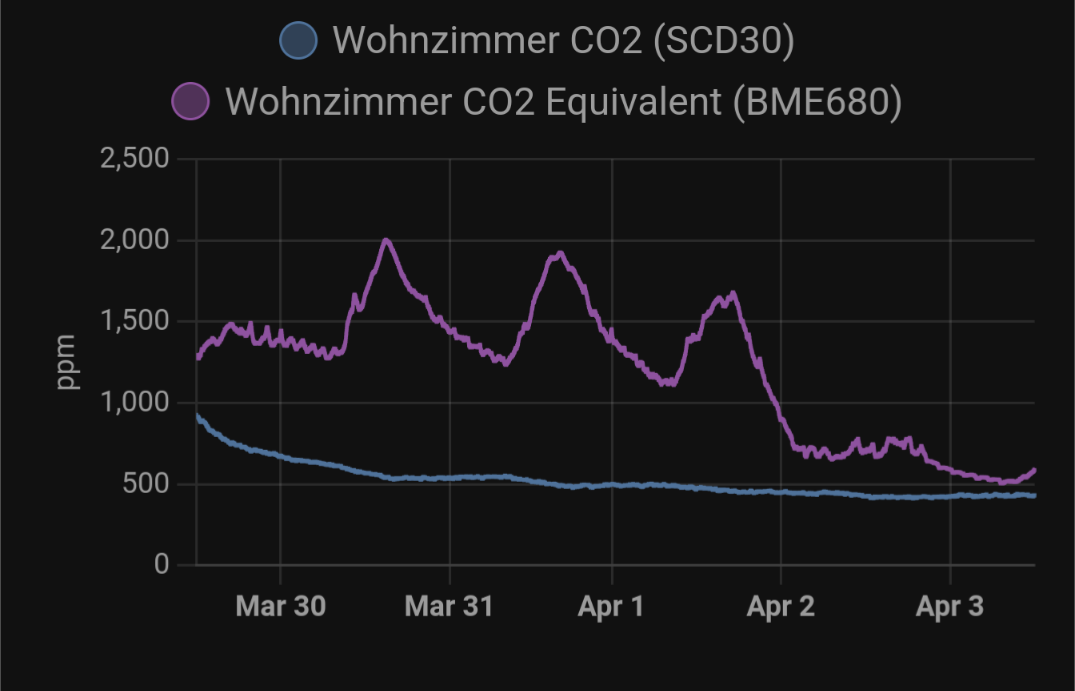

curious could you use the far cheaper ENS160 as they are only 1/4 the price off SCD4X or their sensitivity is not high enough
I can’t speak for that specific sensor but generally the sensors calculating an equivalent CO2 value and not measuring it directly are only very loosely correlated to actual CO2 values. Here’s the BME680.eCO2 für the same period as above. From that trace I would think someone broke in every day I was away.

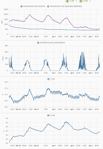

okay thank you for the reply . it would seam the CO2 reading from BME 680. is affected by secondary factors. I am guessing house humidity and/or temperature as it peaking and bottoming at the same time of day . with a little math probably one could correct it so one make the line more closer to the output of SCD30. if I was to guess March 30,31 and April 1 were sunny. and March 29th ,April 2 and 3 was cloudy
Excellent thinking, humidity seems to the culprit! On Apr 1st, humidity peaks but not temperature (probably less direct solar gains).

thank you for the graphs … I assume H_WZ is humidity from your graph . and peaks of humidity almost maps exactly right over top of the variance . so it looks like it might be a very easy error correction to do. but it also looks like temperature causes a bit variance as it shifts the baseline up/down slightly as the temperatures rise and fall. so will i buy a couple ENS160+AHT21($6) and see what I can do with them. as they have eCO2 plus humidity and temperature so it should provide an all in one device for error correction

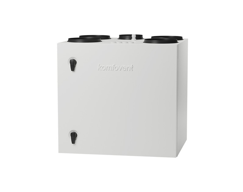

Next level = rotary heat exchanger
e.g.
Those rotary units don’t need preheating to avoid icing
This is one direction of travel for HVAC I think - all in one units for proper filtration of incoming air; air exchange and humidifiation/dehumidification; heating/cooling and hot water preparation. Not the right price point yet and not enough of them using R290 etc but heading in the right direction!

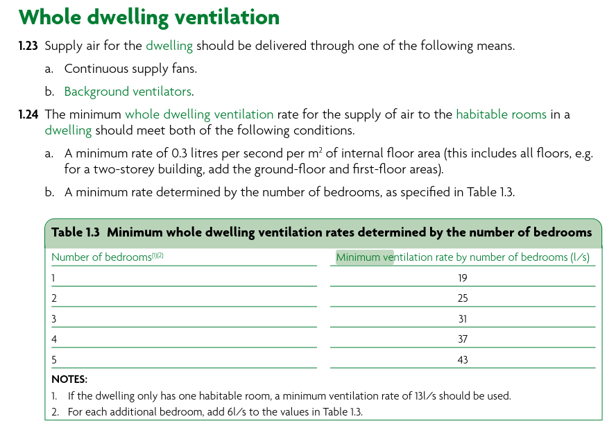

I guess another way of approaching this question of what should the air change rate be on heat loss calculations is from the perspective of newer regulations around ventilation in buildings and the wider discussion around inadequate ventilation from a health perspective in a lot of buildings.
The minimum whole dwelling ventilation rates in the part F UK building regulations are probably a useful guide as well as being a regulation requirement:
https://assets.publishing.service.gov.uk/media/61deba42d3bf7f054fcc243d/ADF1.pdf
For our 3-bed mid-terrace house 77m2 floor area and 186 m3 building volume:
1. 0.3 litres per second per m2 of internal floor area:
77 m2 x 0.3 L/s x 3600s = 83,160 L/hour
83,160 L/hour / (186 m3 x 1000) = 0.45 ACH
2. 3 bed, 31 L/s = 111,600 L/hour = 0.6 ACH
So it looks like the minimum ventilation rate that I should assume for heat loss calculations in our house is 0.6 ACH which conveniently is the average value that I measured above :grin:
An issue that we do have however is that the ventilation rate drops below this during calm weather and so our ventilation rate will be too low for periods of time - as are the ventilation rates of a very large % of the building stock of course and what these regulations and PAS 2035 standards for retrofit etc are trying to address…

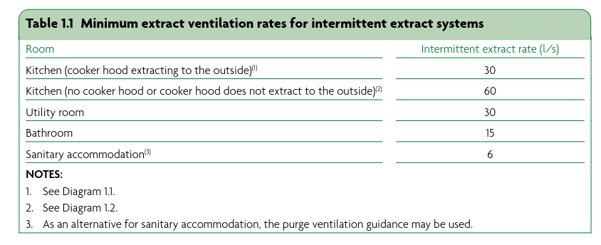

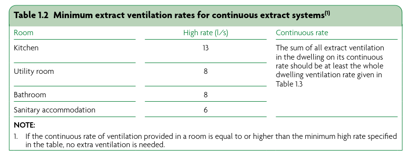

Also of interest:
This extract ventilation is pulling air in to those spaces from the rest of the dwelling and so the overall whole house ventilation rate is still below the minimum levels in table 1.3 (apart from the cooker hood without extract).
these are also below the whole dwelling ventilation rates:
There’s also an interesting piece about ventilation control which allows operation ‘according to the need for ventilation’ which I guess allows for demand controlled ventilation.
Passivhaus ventilation: It’s not a lot of hot air mentions that a ventilation system of a passivhaus must be capable of complying with standard DIN1946 and therefore capable of supplying at least 30m3 per person per hour. In our case that relates to about 0.48 - 0.64 ACH depending on how you class a 10 month old. I guess we would definitely need 0.64 ACH as the kids grow up.
These figures probably give a good floor for the air change rates that should be assumed in a heat loss calculation, Im edging towards the view that for a house like ours a slightly higher value around 0.75 ACH may be a reasonable value to use, it’s a little above minimum but not full storm conditions…
