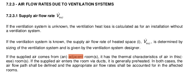

Great sleuthing as always @TrystanLea
I hadn’t spotted the assumption in the MCS spreadsheet that all “make up” air for a room was external.
That’s clearly wrong. This should be calculated as a “whole house” air change rate then apportioned across rooms based on either volume or occupancy. Else you undersize emitters in the main spaces with supply air (the air that actually needs heating) and oversize them in the rooms with extract air (which doens’t need heating).
Agreed! I’m currently working my way through the BS EN 12831 standard itself which is what MCS references (albeit the 2003 version, google search BS EN 12831 free download).
It describes the simplified calculation method that most heat loss calculators use (including the MCS spreadsheet) which assumes external source air and a more complex calculation method that specifically caters for the physical reality of different ventilation methods including a worked example for simple extract ventilation that calculates based on air sourced from adjacent rooms!
All in all I believe this means that as long as the installer follows this more comprehensive method detailed in the BS EN 12831 standard they will still be complying with MCS.

Here’s my worked example of the simple extraction example:
BS12831_simple_extraction2.ods (23.5 KB)
The standard doesn’t appear to say anything about time averaging extraction rates? and the calculation methods adds the extraction rate to the base infiltration rate which if you use instantaneous extraction rates with all extractors running results in some pretty sizeable ventilation heat losses…
E.g for my house with my blower door test result of n50 = 10.13 ACH which gives an infiltration rate of 0.41.
Adding non time averaged… intermittent extraction rates from part F to the kitchen and bathroom adds 0.89 ACH on top of the base infiltration rate = 1.3 ACH
Adding continuous extraction rates from part F to the kitchen and bathroom adds 0.41 ACH on top of the base infiltration rate = 0.82 ACH
I would say if I time average the extraction rates we are talking at most 1h for the bathroom and 1h for the kitchen extractor this would result in very low equivalent continuous rates around 0.04 ACH which is then too low at 0.41 + 0.04 = 0.45 ACH (lower than part F minimum whole dwelling ventilation rate that is)
I’m looking for a figure closer to 0.6/0.7 ACH which I think is more representative of average conditions in our house and the range that gives the measured heat loss that Im seeing…

On the plus side the above EN 12831 standard’s more comprehensive calculation method is certainly a significant improvement on what most standard heat loss calculators are doing. It provides justification and a calculation method for sourcing ventilation requirements for bathrooms and kitchens from adjacent rooms, which is a useful step forwards in my understanding.
I think I might finally have EN 12831 standard justification for choosing a lower air change rate
that’s right in the range Im looking for…
If I select the more comprehensive calculation method for the natural ventilation only:
If I put my own house through this calculation with the n50 blower door test that I have and use the minimum hygienic air exchange rate I get 0.69 ACH, which is purely in my case the minimum hygienic air change rate…
BS12831_ventilation_calculations.ods (27.4 KB)
That’s slightly lower than minimum continuous extract ventilation which for our house would work out to 0.78 ACH (corrected down from 0.82 above).
0.69 ACH is still above Part F minimum ventilation of 0.6 ACH for our house so I still wonder if there’s a way to justify using slightly lower levels for Table D.6 as long as the result complies with Part F… Anyway that’s probably as good as Il get for now…
