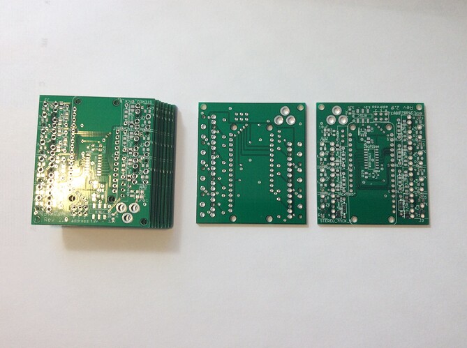

No need to shrink it any more. I just received a batch of ten boards from offshore. They look great, but will populate and test tomorrow when some needed components arrive from DigiKey. The total for 10 boards was $33 including shipping.
Here it is. The one on the right. On the left is the new board populated with screw terminals instead of stereo jacks. You can use either.
I’d like to get out of the hardware business. Not my forte. I prefer the software side. You guys have an infrastructure to distribute, so you may be interested in adding it to your store. I may approach other shield manufacturers and suggest they produce it. As a last resort I’ll see what the offshore house can offer for assembled units and maybe put them on eBay. The design is open, so I expect nothing from it.

Thanks for the photos. This is a possibility, we are evaluating options atm. With regard to automated SMT manufacture, its much easier if the SMT components are on one side and the thru-hole solders on the other since it’s not possible to use a solder wave to automate the thru-hole soldering if there are SMT components on the same side. This is not a big issue, it would not be a big issue to change this. We would also need to fit the unit into an enclosure so a physical design of the PCB would probably be needed. We would probably also put the ESP-12 directly onto the PCB.

From my perspective, IotaWatt is a software entity. It runs on an ESP8266, uses an SDcard, real time clock, and up to three eight channel ADCs. That’s the hardware requirement. I’ve taken care to keep the hardware specifics such as voltages, logical to ADC physical channel mappings, and reference voltages as parameter driven as possible. While not configurable through the browser based utility, the logical to physical channel mappings are just json elements in the config file. I have several different board layouts and they all run the current software with a few lines different in the config file.
After several iterations, I have come to the conclusion that there are no best answers to hardware layout. It’s all tradeoffs for the intended user. This current shield approach is designed to make it useable as a mix and match with commodity boards that exist today.

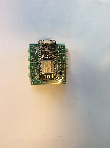

At long last, all of the major pieces are in place and seem to be working reliably. Here’s what the beast looks like. I’ll get a better picture in daylight tomorrow.
The top board is an AdaFruit “feather” ESP8266. Under that is an AdaFruit feather “data-logger” shield that has the SDcard and a real time clock. Below that are three IoTaWatt 2.1 ADC shields. The visible side has nine inputs., the other has 12 for a total of 21.
On average it samples about 35 inputs per second, so each input gets sampled about 1.5 times per second. Each cycle sampling consists of about 490 voltage and current readings. That’s at 60Hz. At 50Hz the cycle rate would decrease slightly and the samples per cycle would increase.
The top ADC is configured with burden resistors, has channel 0 set for VT input, and is running at 3.3V.
The second ADC has channel 0 set for CT input (though none connected), has no burden resistors so is running voltage type CTs (SCT013-030), and is also running at 3.3V.
The bottom ADC is configured like the second except it is running at 1.2V, so it has a 33mv CT connected and an SCT013-050 CT that is remarkably accurate at low wattage with the 1.2V and 12 bit ADC. The trade-off is that it will overdrive at about 25A.
Each of the ADC boards can be configured independently, and run at either 3.3 or 1.2 volts. Any channel may be used for voltage sensing, but channel 0 on each shield has a select-able attenuation circuit and 5mm jack for a VT. With three shields and three VTs, three-phase should not be a problem.
