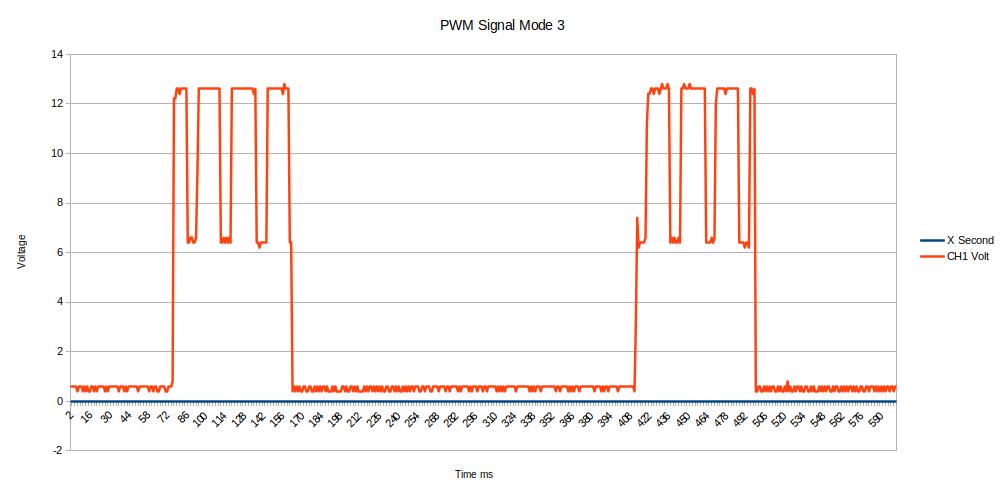

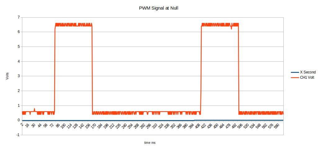

I have begun scoping the PWM Signal …
The PWM Signal is now controlling the pump , but with a very odd looking PWM Signal!
When the pump is “stopped” however I get the
following signal
The Pump changes the pump speed correctly BUT, and there is always a SAMSUNG BUT ,
When OFF the System issues an E912 error saying that the Flow sensor is still detecting too much water flow when switched OFF.
I have been trying to reduce the Flow rate to stop this , new fault, but am resigned to trying to fix ANOTHER Side effect fault !
The Reduced flow rate also vastly reduces the apparent pipe losses…
I may have to compromise and have a switched Motor with a PWM Signal controlling motor speed when required!

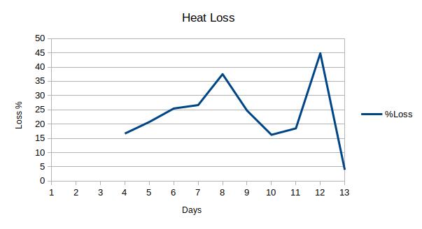

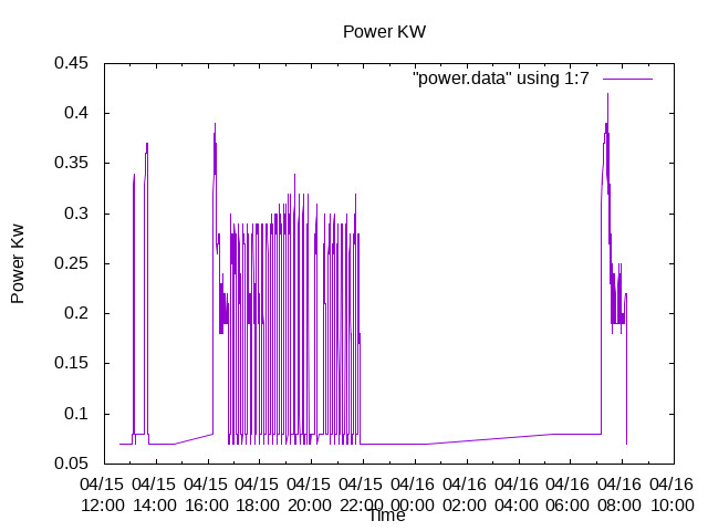

When the Water Flow rate was reduced to 12 lpm the following results were obtained.
The Losses were reduced considerably…
losses-16-04-23
While the REAL COP was also improved
COP_REAL-COP-16-04-22
I have no doubt that most of these improvements would have resulted from the reduction in flow rate , but , I am , at least for now gratified with the improvement !

I have scoped the PWM Signals to find the operating point …
This curious PWM Signal shows an operating point the Mark to space ratio is 92 over 238 , or 38%.

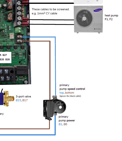

Am I right in thinking that the 1st LED is RED and the 2nd LED is YELLOW in PWM control?
Just to confirm, as standard on a fixed speed pump it would usually wired in to B7 and B8 on the board terminals.
If using a PWM pump, it is wired in to B1 and B6 with the PWM wired in to the two PWM terminals:
Ant
The Wiring between the Reference/Signal on the SAMSUNG PCB is different on some GRUNDFOS drawings.
I have tried both the B1/B6 and B7/B8 for Neutral and mains. B!/B6 is on all the time while B7/B8 is switched. I must use B7/B8 because I get e912 errors from the noise when switched OFF.
Still not working…

If the Grundfos motors are supplied with the switched 240 vac from Pins B7 and B8 and the PWM is either Working OR NOT Working the system will display NO warnings OR ERRORS on either the SAMSUNG OR the GRUNDFOSS Motors. The user will have NO Indication whither the PWM system is working OR NOT.
My Particular system , and I suspect some others, is defaulting to the MAXIMUM MOTOR SPEED giving NO INDICATION of the PWM Status.
I am NOW driving my system from TWO !0 Khz Waves with a 40 % DUTY Cycle setting my Flow rates to 9.4 lpm .
i know that other users will have working PWM Systems …
Please give any evidence about the PWM Working or NOT Working ?

The Loss between the Heat pump and the Power Water meter…
losses 22 04 23 TAMK SEt1 2 40%
Both show a n improvement …but I will average the results over several days before reaching a conclusion.
My Power measurements clearly show continued Hyper-Cycling …
4217
So I still have hyper-cycling …
In close up the cycling is…
Power DEtail
The Cycling time is 21 mins …an improvement , but I will await several more days of data before cheering too much.
