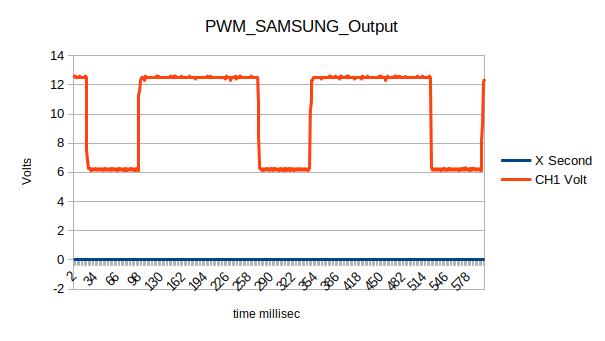

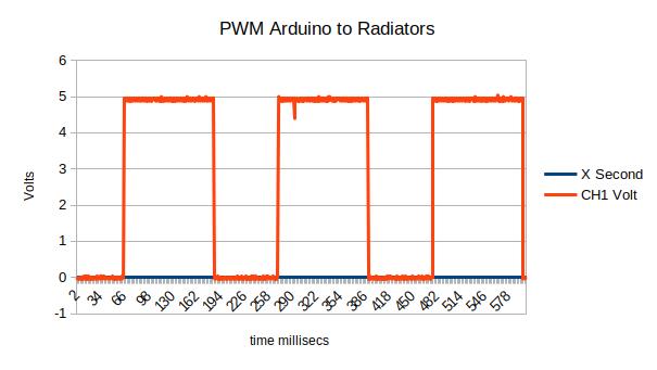

Having looked at the PWM Output signal on an Oscilloscope I would say that my PWM is totally failing!
The Original PWM Signal is plainly faulty …
PWM_HP_OUTPUT_1
I have replaced the Faulty signal with …
PWM_ARDUINO_RADIATORS_OUTPUT_1
Following a visit from a French Samsung Engineer , I was told that "my Flow rates were “Excessive , and should be controlled to increase the Output Water Temperature.”.
The Temperature Drop between the Advertised 35 to 42 Water Temperature and the actual , measured Water Temperature at the Radiators was averaging 11 C !.
On Asking the French Samsung Engineer "How do I Control the Flow rate " I was told that the Flow rate was controlled by the PWM Signal.
I pointed out that My PWM Signal was plainly faulty , prompting the Comment that “Only the Germans REALLY KNOW HOW the PWM System works”.

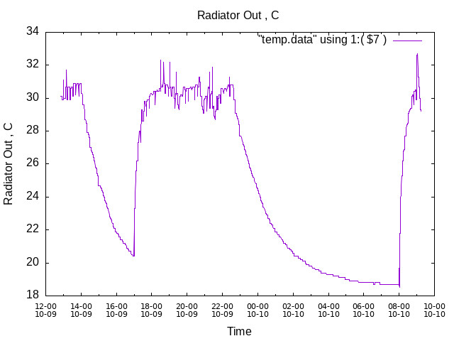

I have subsequently produced my own Arduino PWM Signal increasing the Radiator Temperature to nearly 35 C, a Temperature Drop of 7… 9 C !
Temp_Rad
So , My Home made PWM seems to work…
However, I still have the anomaly that my system has TWO PWM Motors , on BOTH the Primary and Radiator Water circuits.
I have used the same PWM to drive the Radiator Water Circuit, again successfully.

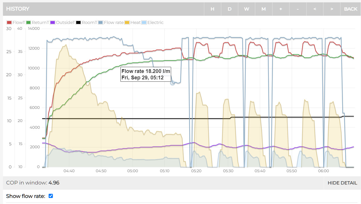

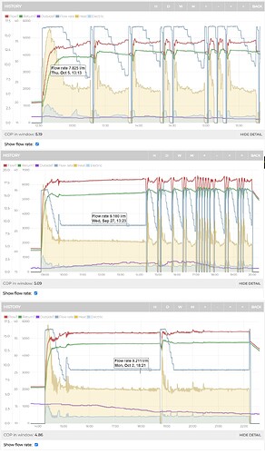

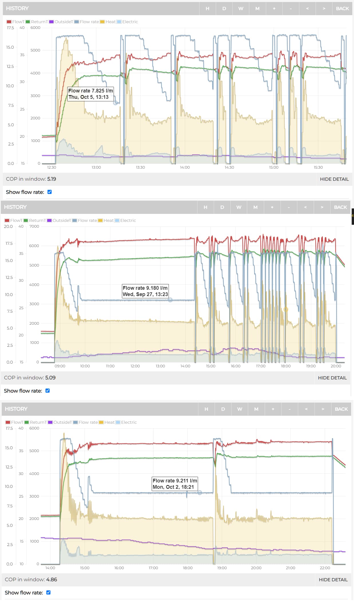

On heatpumpmonitor.org there are two Samsung 5kW and 16kW that I think both were DIY installs, with the flow rate modulating down when the output modulation goes down.
https://heatpumpmonitor.org/system/view?id=45
https://heatpumpmonitor.org/system/view?id=60
Hi Vinny,
Superb , utterly superb!! , proof and Information on the Modulation of the Water Flow rates for SAMSUNG 5 kW Heat Pumps!
The PWM Controlled Range of 7.5 lpm to 15 lpm is especially useful in that I can use the PWM Signal to control my Faulty PWM Driver.

Armed with the Information supplied by Vinny, I have programmed my Arduino to control the Water Flow rate proportional to the Delta_T across my Heat Exchanger inlet ports.
The Water Flow rate now starts with a high Water flow rate of 15 lpm at the start of the Cycle dropping to 8.8 lpm at the end of the cycle.
This is, hopefully, only a temporary measure awaiting the replacement Samsung mother board complete, finally, with a working Water flow rate PWM Control.

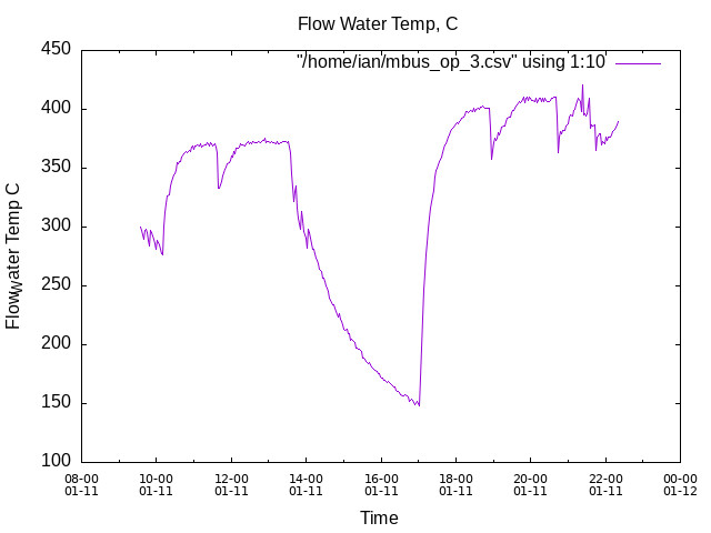

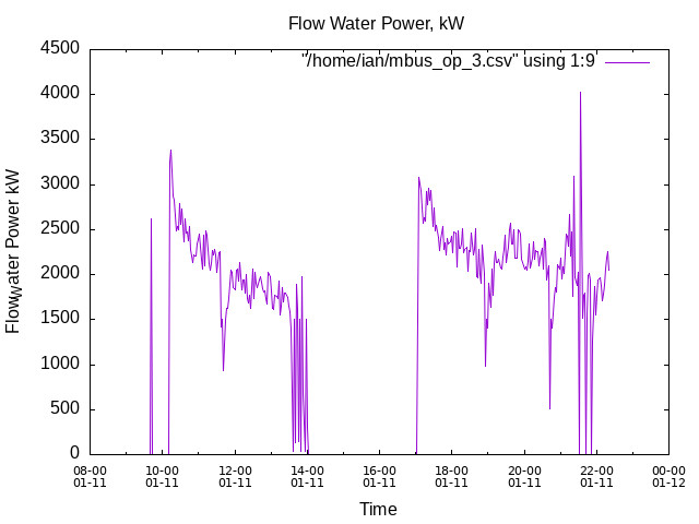

I have fitted an M-BUS Water meter showing that the Heat Pump only outputs about 2 kW maximum into the water circuit.
The Water power is shown in the attached Power for 11-01-24,
Water_Flow_Power
The Flow Water temperature , again measured by the Water Meter shows a Temperature drop of 6 C from the advertised Temperatures shown on the front panel of the Samsung control panel. see
1-7-12.pdf (19.9 KB)
Water_Flow_Temp
Note the Temperatures are multiplied by 10 !.

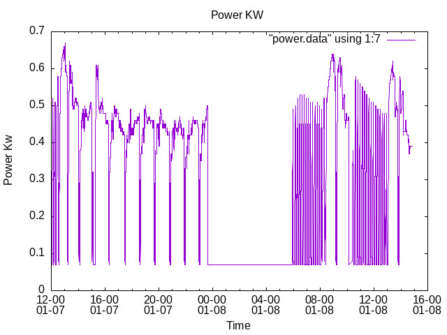

The System continues to violently “Short cycle” as shown in the attached jpg.
1-7-12
