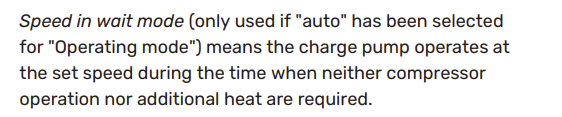

Do you have a “speed in wait mode” option at 5.11.1.2? I believe “wait mode’” = standby, i.e. compressor off.
No I didn’t have that option available, I do now so have made the change as you suggest. Sometimes reading the manual does indeed help…I had the “Operating mode” set to intermittent rather than auto and therefore the option was not available to me on the screen
(from the SMO40 installation manual)

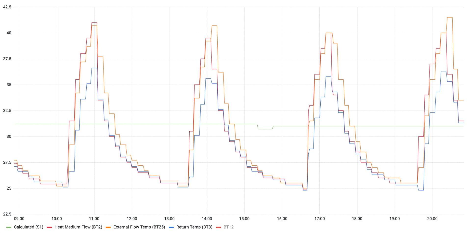

today I managed to drop the curve down to 7 without any noticeable discomfort in the house, if anything it was still a little warmer than necessary. The off periods between cycles seemed to be around 1.5 hours which is better than yesterday and today is also colder outside. The changes made were to reduce the curve down to 7 and run the charge pump at 10% in “wait” mode.
I have had lots of problems with the uplink API calls today, a lot of timeouts so my available data is limited but the behaviour today was generally in line with this snapshot

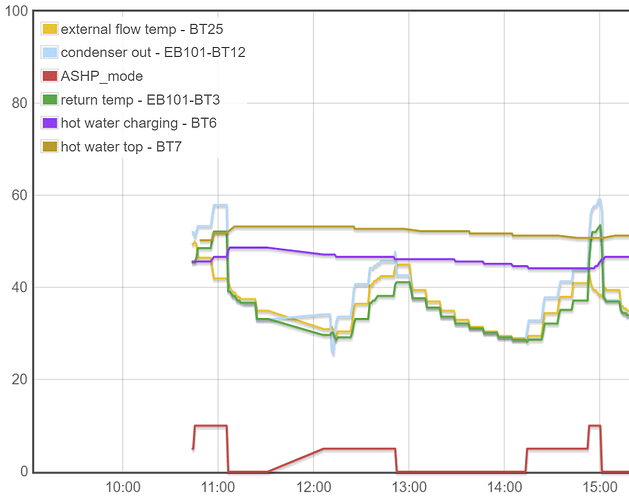

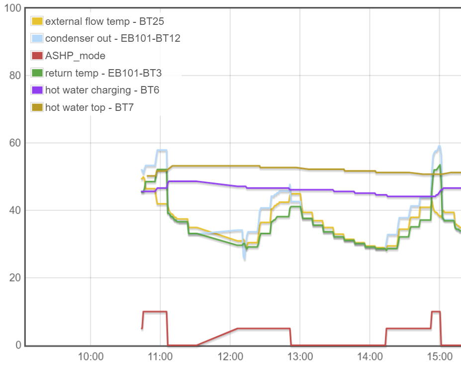

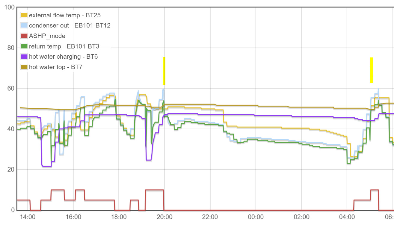

One thing I notice a lot after a period of heating, is a spell of DHW for a short period. Is this normal Nibe behaviour? An example of this is shown at 1500 where the ASHP_mode jumps up from 5 to 10 (this signal is my own one determined from the API to show the operating mode of the ASHP 0=off 5 = heating 10 = DHW). At this time there was no direct hot water used in the house so I am not sure why it wants to inject some heat into the cylinder.
Looking good Sam; those graphs are much more ‘normal’ for a NIBE system. Vastly better than a week ago!
My older F1145 doesn’t have a variable-frequency compressor so it’s only ever On or Off; your F2040 has an inverter so I’d expect it to be modulating down and doing more slow-speed-running and less cycling. It’s worth taking a look at the Compressor Curve (probably in menu 5.1.23) to see what that’s set to. Maybe also add Requested Compressor Frequency to one of your graphs (if you don’t have that already) so you can keep an eye on how ‘hard’ its running.
I have my DHW reheat ‘blocked’ on a schedule so it’s only allowed to run overnight (on cheap-rate power) - mainly because I have a solar PV diverter that does most of the hot water via the immersion heater, so I give that chance to do its thing during the daytime. Other NIBE owners seem to get regular DHW runs during the daytime, more like you are describing. What ‘comfort mode’ do you have your DHW set to - Economy? Luxury?
It’s typical behaviour for a NIBE system to do a hot water ‘run’ at the end of a heating ‘run’ (or vice-versa) - but only if it thinks it needs to.

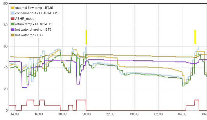

This is what is still confusing me, why it “needs” to do a hot water run. As per the below graph, I am losing temperature in my water cylinder but it isn’t dropping to a level below my lower limit in the settings. My lower limit is 42 degC and upper is 50 degC for Normal comfort (my selected level). On the graph for BT6 the value at just before 1300 is 47.2 and when the ashp starts the recharge BT6 is measuring 44.2, this is above the 42 degC lower limit. It as though the ASHP is “predicting” the lower limit is being reached and starting the cycle whist the ASHP is still up and running.
And a final thought, a 3deg drop over less than 2 hours seems too much especially considering there was zero demand for hot water at the time. Looking back at some of my data, I found a period of no ashp activity over night and BT6 is shown to drop just 2 degrees in around 8 hours, but as soon as the ashp / circulating pumps run at 0400 the BT6 decrease accelerates and I see the same reheat at the end of a heating cycle. Again there was no DHW use at this time.

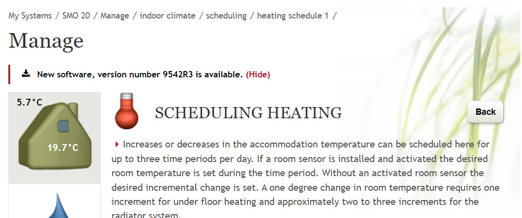

Yep - should be under Hot Water, 2.3 ‘scheduling’. I have mine set ‘off’ from 04:30 - 00:30 every day, so it only kicks in after 00:30 and before 04:30, which means there’s always 50C hot water for the morning. The immersion heater (solar PV divert) thermostat is set closer to 60C so if that has got to temperature the day before the heat pump doesn’t attempt to heat the DHW at all.
Yes; that’s too much, and worth more investigation. My DHW tank was 56.9 at 00:00 then 53.9 at 08:00, so losing 3C in 8 hours (more like your best-case 2C in 8 hours). On complex installations with multiple DHW tanks there have been cases of the CH pump circulation ‘stealing’ heat from the DHW tank coils but based on your schematic there should be no chance of that if the 3-Port Valve is working properly.

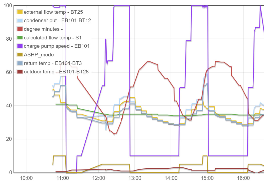

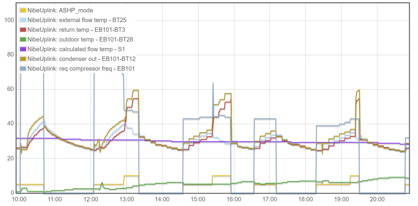

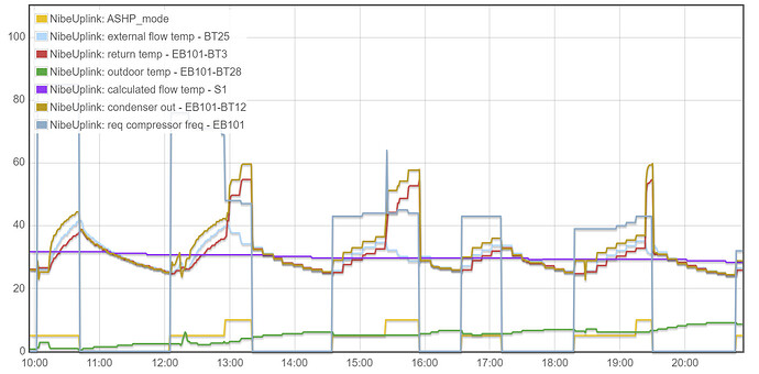

Today I went to curve 5, the house was probably a little on the cool side but not cold. I added compressor frequency, the first two cycles are at a higher duty but then the last 3 are lower. I am not sure why? The only difference I can see is delta T on the first 2 is near 7 deg whereas for the last 3 cycles its down at 4deg.
I am consistently getting the hot water recharge at the end of a heating run so I am now going to focus on that because it doesn’t seem right. I plan to add some probes to the flow and return in/out the hot water cylinder and see what is going on during the heating cycle - this will take a few days to get set up but I will report back any findings.
It’s because of the outdoor temperature, influencing the compressor frequency via the Compressor Curve. The first cycle in particular was at close to freezing, so it picked a higher frequency (speed) than for the later ones. If you can tweak the Compressor Curve down a bit it should run less ‘hard’ (although I’m not sure how much lower than 40% it will be happy to go).

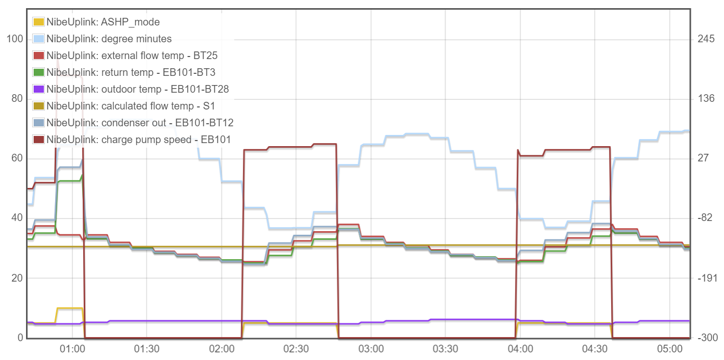

As per earlier advice, I have switched my buffer tank pump and underfloor pump to run 24/7. When the heating demand is satisfied and the Nibe control system detects this with 0 degree minutes the ASHP shuts down and the ASHP charge pump stops. The buffer pump and underfloor pump are still operating and circulating the previously heated water. I can see from my graphs that the ASHP flow, ASHP return AND the buffer BT25 flow all very quickly converge on the same temperature and there is no dT between them. This suggests to me the water is being pumped outside and is cooling rapidly through the ASHP (which isn’t running). As a result this cooler water circulates through the radiators / UFH and BT25 quickly drops below the target temperature (S1) and the degree minutes go negative, the house hasn’t really cooled down but the ASHP starts again. I have tried running the charge pump in idle mode but if anything this accelerates the effect.
As per my original schematic, is this normal to circulate the heating water (if indeed this is what is happening) through the ASHP when the ASHP is not operating? Or should it just be circulating on the heating side of the buffer tank?

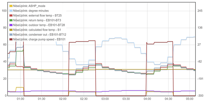

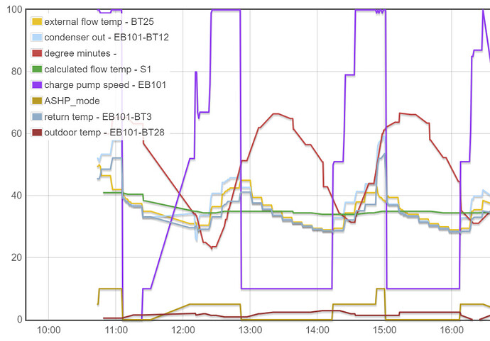

A graph below shows the quick convergence of flow, return and buffer tank until the time the degree minutes hit -60 and the ASHP kicks in again.

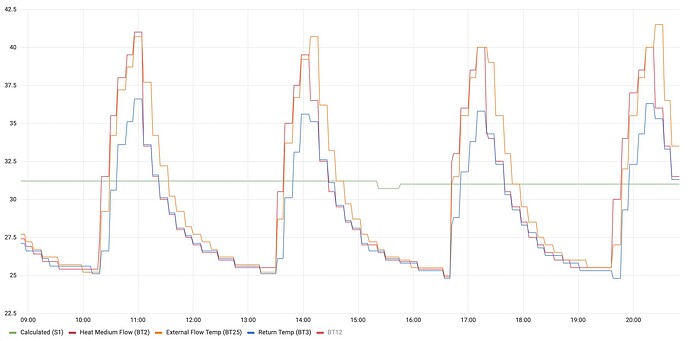

Here’s a graph from my system - looks pretty similar to yours, I’d say: BT25 (Orange) stays a couple of degrees higher than Flow (Red) and Return (Blue) but Flow and Return converge as soon as the compressor shuts off.
When the Charge Pump is off, there will be little water moving through the outdoor unit; your other pumps are circulating via the Buffer Tank, which gradually cools. I don’t think you’re seeing the water cooling via the outdoor unit - you’re just seeing the effect of heating the house.
Bear in mind the ‘Degree Minutes’ are just measuring how the actual flow temp (BT12) compares with the target flow temp (S1) over time. The WC logic is trying to make these temperatures average out the same, not answering any ‘call for heat’ or responding to the temperature of the house:
  • The compressor starts at the configured number of (negative) DMs; sounds like you’re on the default of -60 (I’ve made mine a lot more negative to reduce the number of cycles, since I don’t have a variable-frequency compressor)
  • The compressor runs until the DMs reaches 0 then shuts off; the residual heat in the system keeps increasing the DMs for a while (but they’re capped at +100)
  • Once the flow temp goes below the S1 target, the DMs start reducing and the compressor re-starts when it reaches the configured limit

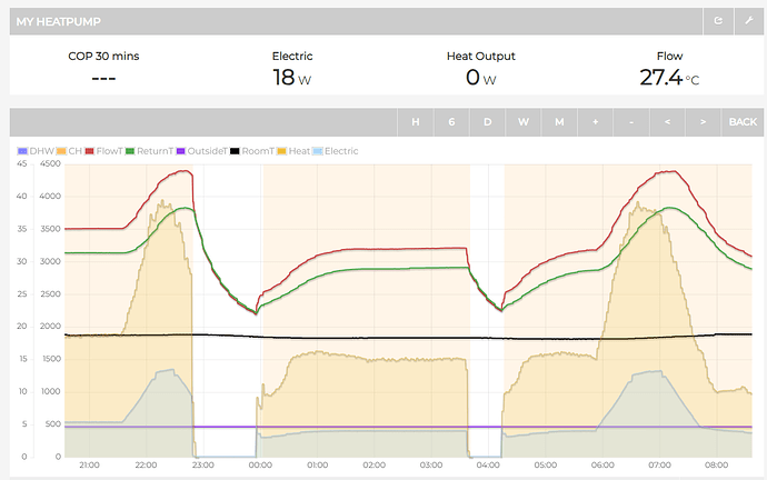

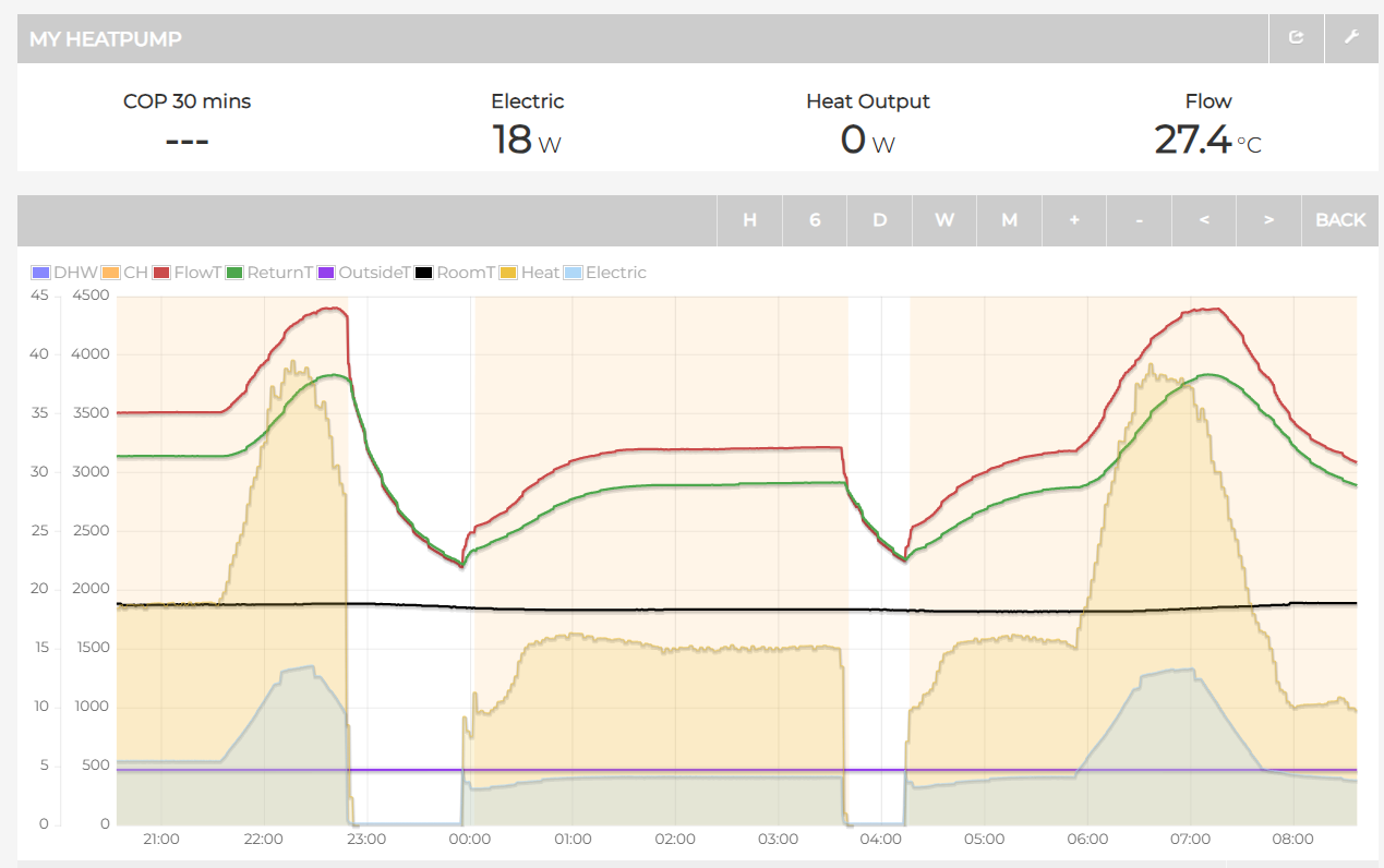

Here is our flow-return and power data from last night.
thank you Dominic.

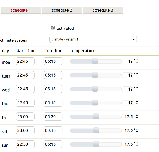

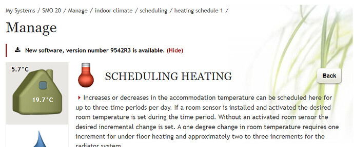

From those graphs it appears you have some form of night set back? the flow is down at 30 overnight? How do you achieve that on the Nibe control system? also what size unit do you run? your electricity consumption is considerably less than mine…I dont yet know if mine is normal for the size of the unit (its a F2040-16) as I dont have any history, My power usage overnight is below (I dont yet have a heat meter)
Using BT12 (or BT2 in my case) was my understanding, but I’ve been watching my system closely this morning and now I’ve swapped to thinking it’s BT25 instead, as you suggested. It is BT25 dropping below S1 that appears to prompt the DMs to start decreasing. I guess it’s BT25 that provides the most accurate indication of what temperature the emitters are seeing.

Our unit is the 6kW F2040 version.
Yes you can input a scheduled set-back temp as I have done here
