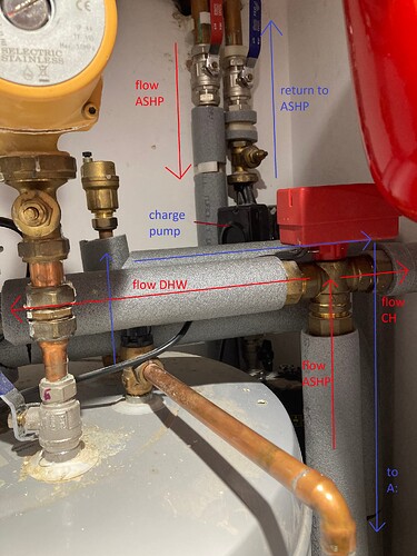

I am really not sure if these photos will help spot the cause of my problems with DHW temperature loss when the ASHP is running a heating cycle. It is a tight plant room with a lot of pipes.
The top photo shows the ASHP flow comes down from the ceiling, round a “U” bend in the pipe work (hidden behind the tank in the photo) to the shuttle valve where it splits off to DHW or CH. The return from the DHW cylinder comes out the top, drops down behind the shuttle valve and connects into a return pipe (shown better on the bottom photo). It is this horizontal return pipe with the auto air bleed valve which is getting very warm with water pulled up out the cylinder coil when the charge pump is running
The bottom photo shows the return pipe coming down from the cylinder, connecting into a T piece on the common return pipe from the buffer tank / radiator / UFH returns before heading back upwards through the charge pump to the ASHP.
Do I have some kind of syphon effect going on? The only solution I can think of is to fit some kind of motorized zone valve or ball valve on the horizontal return out the top of the cylinder which is only open when the shuttle valve is in the DHW position. This would allow water to flow through the DHW charging coil when charging water but prevent any flow through when the charge pump is running with the ASHP in idle mode or CH mode.
I am really not sure if these photos are clear or helpful!

You do have quite a lot of Vertical pipe runs which would encourage thermal syphon effects…
If you’re happy the 3-port Diverter valve is good (and you’ve explained why you think it is) then I reckon the best way to be sure there’s no flow through the DHW coil - except when there’s meant to be - is to add a 2-port motorised valve on the return side of the DHW coil, wired in parallel with the ‘DHW’ position on the 3-port valve.

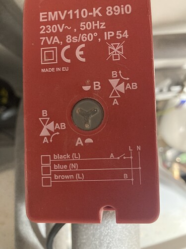

I can see that the head indicates that flow direction B (which I assume is the default position) should go to the CH but the actual brass valve underneath has this as direction A to the CH (and vice versa for the DHW). I cannot determine if the wiring is inverted to match as I dont quite understand the wiring diagrams and how the SMO40 works for switching this valve.

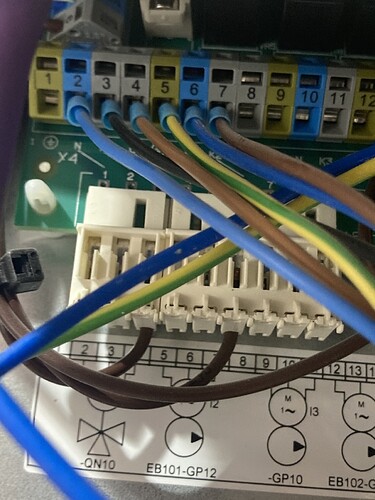

The SMO40 manual shows to wire the shuttle as follows:
The shuttle valve manual (I think) shows to wire as follows:
My physical wiring (pins 2,3 and 4) on the SMO40 board is:
UPDATE 1: With the heat pump in idle mode pin 4 is live which is the brown wire, according to the shuttle valve head this puts the valve in position B. Looking at the plumbing position B is to the hot water tank. I think this means if the charge pump was running this would allow water through the cylinder.
My reading of the manual (and the diagram on the top of the valve) is that:
  • The Blue wire is Neutral
  • The Brown wire is ‘permanent’ Live
  • The Black wire is ‘switched’ Live - and when that goes Live the valve moves to position A; otherwise it’s in position B
So I reckon you can’t infer much from checking only Pin 4; you need to also know if Pin 3 is Live or not. If Pin 3 is not Live then I agree the valve should be in (default) position B.
The puzzle is that your DHW tank is clearly heating up OK, which implies the DHW coil is seeing ‘hot’ Flow from the ASHP when it thinks it’s doing a DHW cycle - and BT25 is seeing ‘warm’ Flow from the ASHP when it thinks it’s doing a CH cycle.
It might help to check what position the grey circular indicator on the top of the valve shows for:
  • A DHW cycle (your Mode 10)
  • A CH cycle (your Mode 5)
  • Idle / Standby (your Mode 0)
I can confirm my shuttle valve is wired as per yours:
Blue pin2
Black pin 3
Brown pin 4
However from your pic the shuttle valve body is the wrong way around in conjunction with the brass body labels.and the pipe connections are on the wrong sides.
Your pic of the red casing shows A towards DHW and B towards heating
Your pic of the brass connector shows DHW on B and heating on A.
That is mine.
The thing I don’t understand is how you are getting heating and hot water still, given the above.
The way I see it: your shuttle is sending hot flow to the tank as required, but, is also allowing warm flow through the central heating and tank at the same time.
Could the mis matched orientation be allowing that?
Just looked online and the shuttle can allow dual flow the valve is at 30 degrees and not 60. I wonder if this is what has occurred with yours?
When in mode 0 (idle) pin 3 (black) was not live, I also checked that.
I am definitely getting the hot water in the cylinder and the warm water into the buffer. Like a lot of my installation, puzzling.
I shall collect the “live” status for brown and black wires alongside the indicator status for all modes.

So it maybe as the motor unit isn’t matched to the brass indicators that the valve actuation is quite correct.
As David mentioned put a CH and DHW cycle on and take pics of the grey indicator on the shuttle and see which way it’s pointing for each.
You can un clip the motor unit from the brass and see what’s what as well.
ASHP idle or ASHP CH
Brown : 240v
Black : 0v
Indicator : B
ASHP DHW
Brown : 240v
Black : 240v
Indicator : A

When doing DHW the head is at position A but the brass body has position A plumbed to the CH flow. touching the pipes confirms the water is only flowing to the DHW via position B on the fitting and not to the CH.
When idle or CH the head is at position B but the fitting has position B plumbed to the DHW. My current theory is that I’m actually getting CH flow through both A and B but I can’t see how or why.
I’ll get the motor off the brass body and see if I can determine what the actual valve position inside the brass fitting is doing.

So you confirmed that during DHW that hot water was going via B. DHW and pipe got hot, and CH pipe did not.
Did you do the same during CH and see if both CH and DHW flows were equal temp?
Once you pop it off the brass, you can manually move the valve and then assure yourself where it should be for a particular position, eg B and then refit the valve body with that in position B.
I don’t know what the internal gubbins are inside, but I wonder if the mismatched orientation could be the issue?
