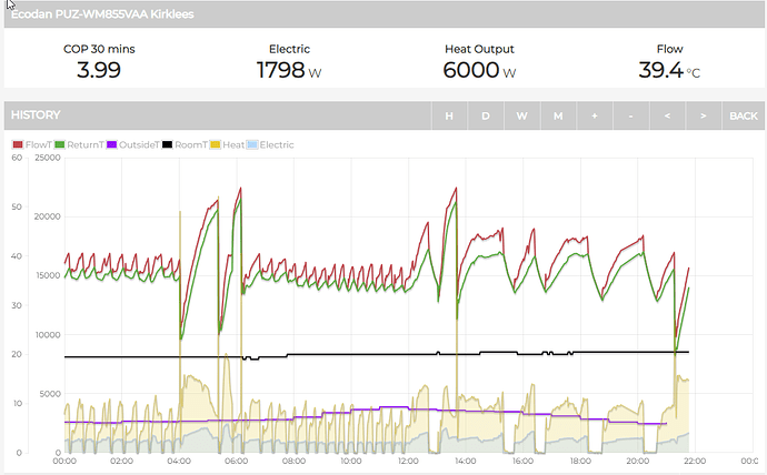

Thoughts…
  • Something is causing it to modulate and turn on and off. It should be running continually.
  • Your flow temp is very high. Right now our flow temp is 32C and our house is warm.
  • Try running with manual flow temp and drop that temperature until you get too cold. The weather compensation is a gimmick as it does not consider demand or solar gain.
  • what do you have connect to the FTC to turn the system on or off? There are a couple of contacts that you attach a switch to. Our original installer connected to a digital thermostat that turn on off the ASHP. It causes all manner of problems and lasted one day.
Our contacts are permanently connected together and we issue a modbus command via the Procon A1M modbus unit to turn on/off.
Have a look when compared to our trace. Ignore the high peaks they are from the DHW and the consumption is for CH only. The only reason it went off between 1630 and 1900 is it shuts down when our Octopus Agile gets more expensive.
The ASHP can only run down to a certain power, then shuts down. The compressor motor has an inverter, but this can only go so far. Then it will turn off.
For example, our ecodan can only go down to 550W. Any lower it will shut down. I have increased the flow temp by a degree which stopped it modulating.

So it looks like every time is at the minimum and tries to go lower, it finds that it’s too low, and steps up a little bit, if that it’s too much it stops.
Alright… I stand corrected. It goes down to about 500W.
It can only only go down so far, then shuts down.
Probably would go lower if warmer outside and flow bellow 30C.
