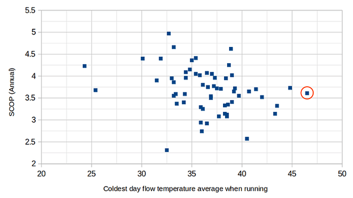

Theory: Heat pump systems on weather comp should show quite a clear relationship between design flow temp and annual SCOP for space heating. The SCOP calculator tool that I built here is a an example of how this can be calculated theoretically Heat pump SCOP calculator. It’s not the only factor in the calculator that affects the SCOP, the other factors in that calculator are the practical efficiency of the heat pump and the minimum modulation level which determines how low the flow temperature can go in mild weather. These would typically be 50% and 40% respectively for systems without sophisticated control of mild weather cycling.
Figure 1: All systems with valid data (minimum 290 days).
Data: scop_vs_flow_temp_figure1.ods (45.5 KB)
Comments:
  • As is often the case with HeatpumpMonitor.org real world data, we see a wide spread of values. Clearly there is more to annual SCOP than the average flow temperature when the heat pump was running on the coldest day. See Heat pump oversizing data analysis thread for another example of wide spread of results.
  • All systems but one have average flow temperature when running that are below 45C, most are significantly below, the average flow temperature of all systems on the coldest day is 36C.
  • On average, systems had a measured average flow temperature when running of ~7C below the stated design flow temperature entered on the form. There are 2 systems with average flow temperature 20C or more below those entered on the form. 12 out of 59 systems were within 2C of the form design temperature. Actual experienced outside temperatures where on average 0.6C higher than form entered design outside temperatures.

System 170: 11.2 kW, Mitsubishi Ecodan
Coldest day:
  • Average flow temperature when running: 46.4C
  • Peak flow temperature on space heating: 52.0C
  • Average outside temperature: -0.7C
  • Carnot efficiency on coldest day 47.2%
  • A good example of an Ecodan on auto adapt

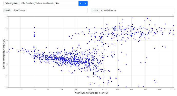

System 8, 7 kW, Vaillant Arotherm
Coldest day
  • Average flow temperature when running: 36.5C
  • Peak flow temperature on space heating: 40C
  • Average outside temperature: -3.9
  • Carnot efficiency on coldest day 49.5%
  • Cold room temperature?
Emoncms dashboard: Emoncms - app view

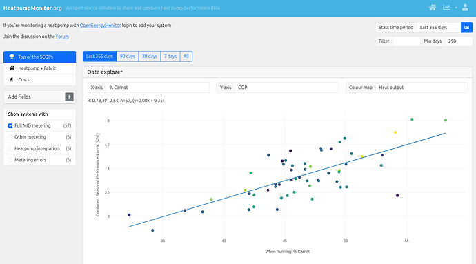

% Carnot is a bit more complicated, my guess is:
  • Make and model of heat pump and age/condition
  • Length of primary pipework
  • Metering error (air issue, quality of temperature sensor placement, water quality)
  • Hydraulic separation (none or low distortion = high, maybe to a lesser extent than the above three).

% Carnot when running seems to have a slightly higher correlation with SCOP/SPF than weighted mean flow - outside temp… R2 of 0.54 vs 0.5: https://heatpumpmonitor.org/?chart=1&selected_xaxis=running_prc_carnot&add=running_prc_carnot,id
Does this suggest that around half of performance is down to system temperatures and around half other factors that contribute to % carnot?
The correlation between % carnot and system temperatures is very week which suggests that Im not leaking a strong temperature related signal into the % carnot figures… these should be non-correlated…

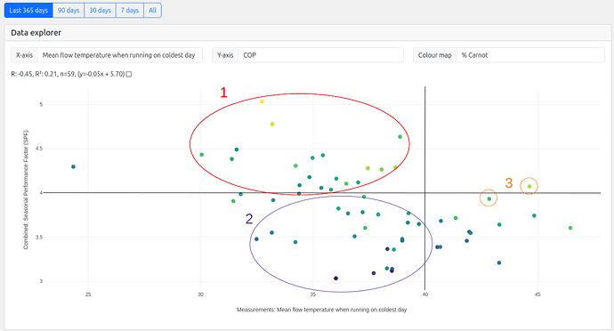

Revisiting the first chart in this thread SPF vs Mean flow temperature when running on the coldest day:
https://dev.heatpumpmonitor.org/?chart=1&selected_xaxis=measured_mean_flow_temp_coldest_day&filter=air&selected_color=running_prc_carnot
  1. The majority of systems that achieve a SPF of 4 or above have a mean flow temperature when the heat pump is running on the coldest day <40C and more typically ~35C.
  2. A mean flow temperature when the heat pump is running on the coldest day <40C is not a guarantee of a SPF of 4 or above as we can see by the systems in area 2. There are also other factors at play.
  3. There are a couple of outlier systems that do still achieve a SPF ~4 with higher than 40C average flow temperature. E.g This 10 kW Nibe S2050 https://dev.heatpumpmonitor.org/system/view?id=167 with an average flow temperature on the coldest day of 44.6C. This Nibe achieves a relatively high % carnot (within the upper bound of other high performing systems when viewed on the weighted by kWh heat delivered flow minus outside temperature chart).
I think it’s worth highlighting and taking on board that the majority of systems that do get a SPF of 4 and above on HeatpumpMonitor.org are running very low mean flow temperatures on the coldest days. 35-40C is significantly below what is more commonly designed for, 45C is usually seen as low and 50C is becoming more common. Design target temperatures are however often over-estimated given over-inflated heat loss calculations and so the in-practice flow temperatures can be lower.
