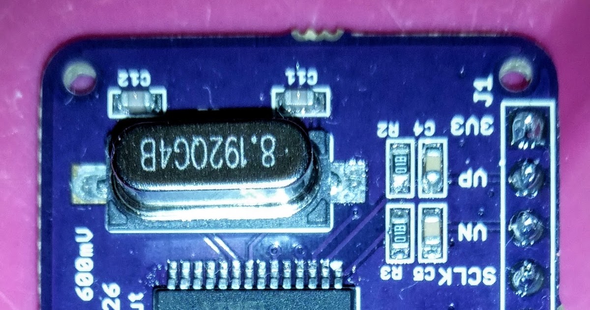

The 3rd revision of the heatpump monitor board is now being made thanks to Ragworm. With additional voltage regulator options. Schematic and board files are available here: https://github.com/openenergymonitor/HeatpumpMonitor/tree/master/Hardware/v3
In the next revision I hope to explore using the ATM90E26 special metering chip for higher accuracy with the help of Tisham Dhar who has been exploring this option, documented on his blog here:
The design will likely move to SMT at this point.
