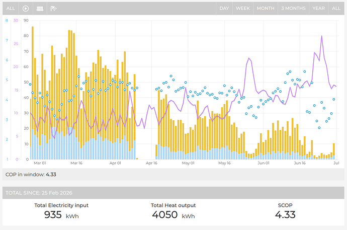

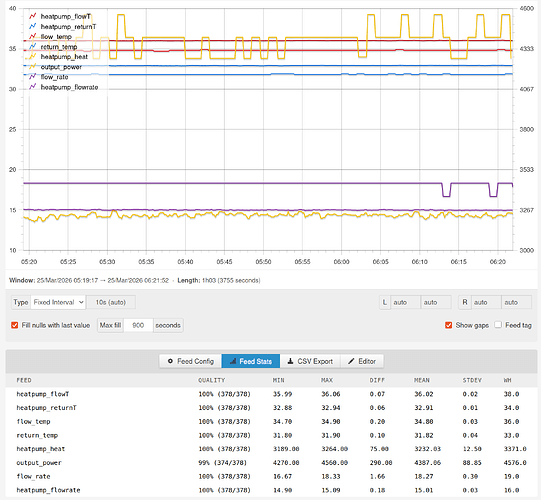

Here’s an interesting result from a Grant R290 unit I helped install back in February.
Performance using the Level 3 bundle: 4.33 so far: https://heatpumpmonitor.org/system/view?id=1088

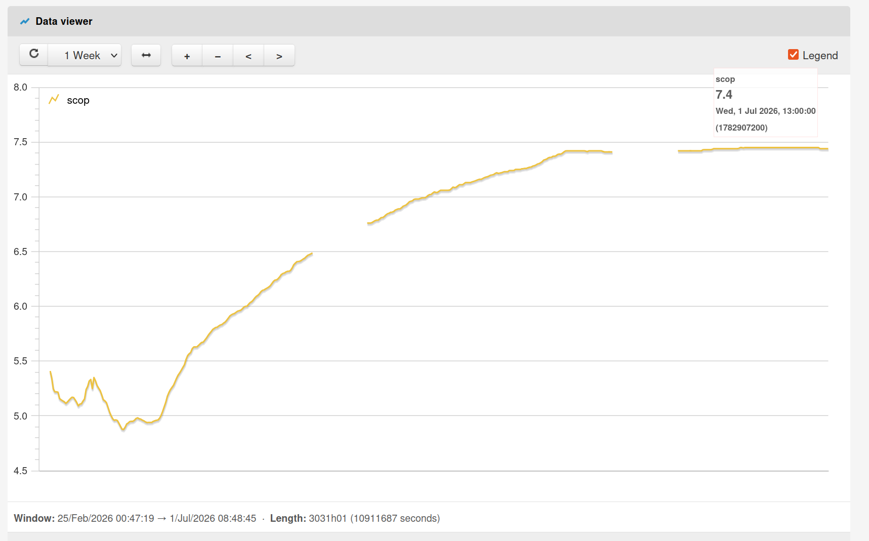

Running SCOP as reported by the local Econet API is settling to ~7.4! :grinning_face_with_smiling_eyes:
So why are we seeing such a difference?

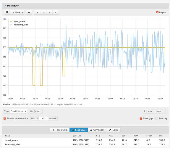

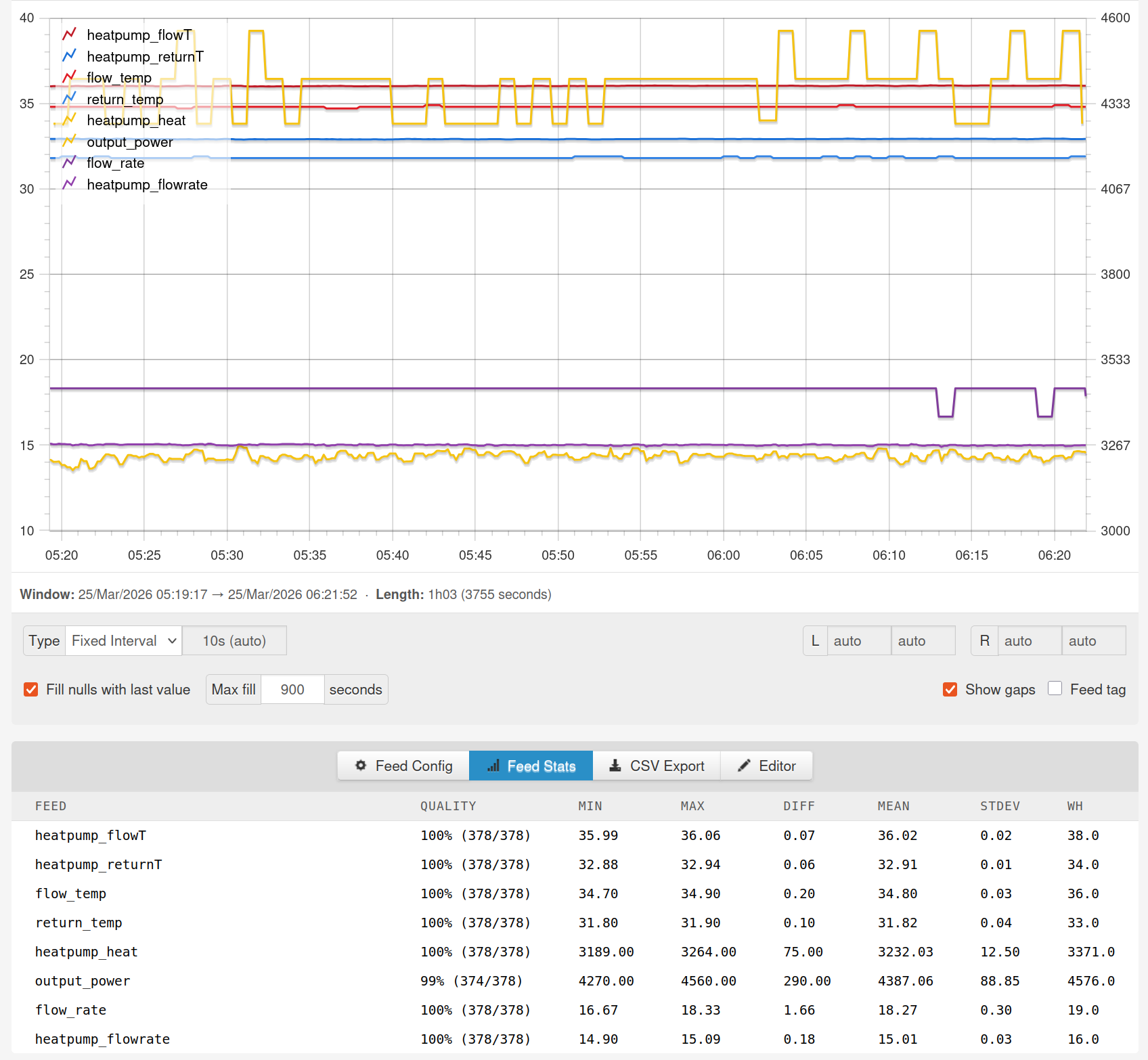

Zooming in on a short run period around the 25th of March where conditions are fairly stable:
Axioma Heat meter:
  • Flow temperature: 36.02C
  • Return temperature: 32.91C
  • DT: 3.11K
  • Flow rate: 15.01 L/min
  • Heat output: 3232W
  • Assumed specific heat = 3232÷((15.01÷60)×3.11) = 4154 J/kg.K (expected result)
Grant R290 inbuilt sensors
  • Flow temperature: 34.80C
  • Return temperature: 31.82C
  • DT: 2.98K (~4% less)
  • Flow rate: 18.27 L/min (~22% more)
  • Heat output: 4387W (36% more)
  • Assumed specific heat = 4387÷((18.27÷60)×2.98) = 4834 J/kg.K (strangely high!?)

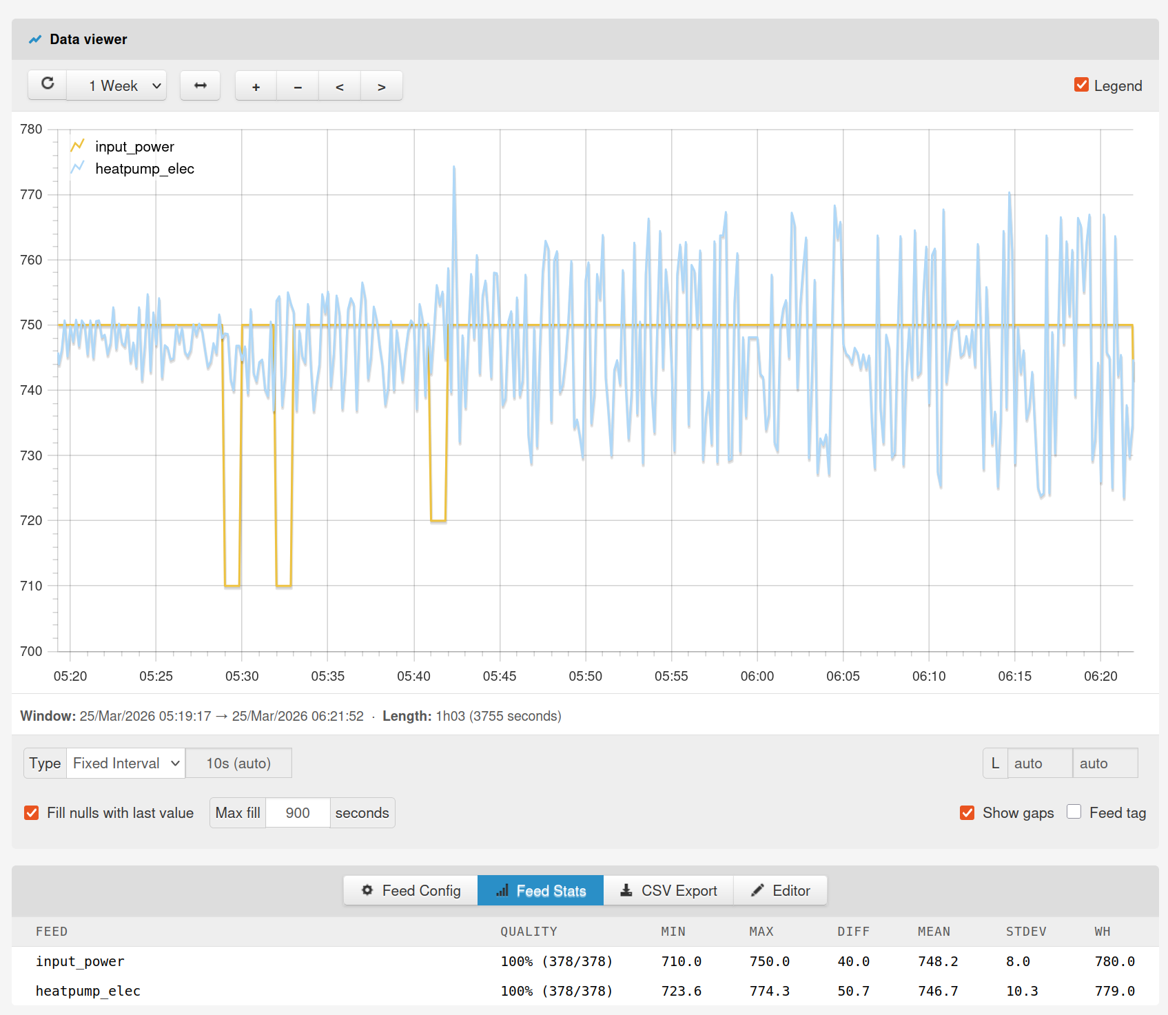

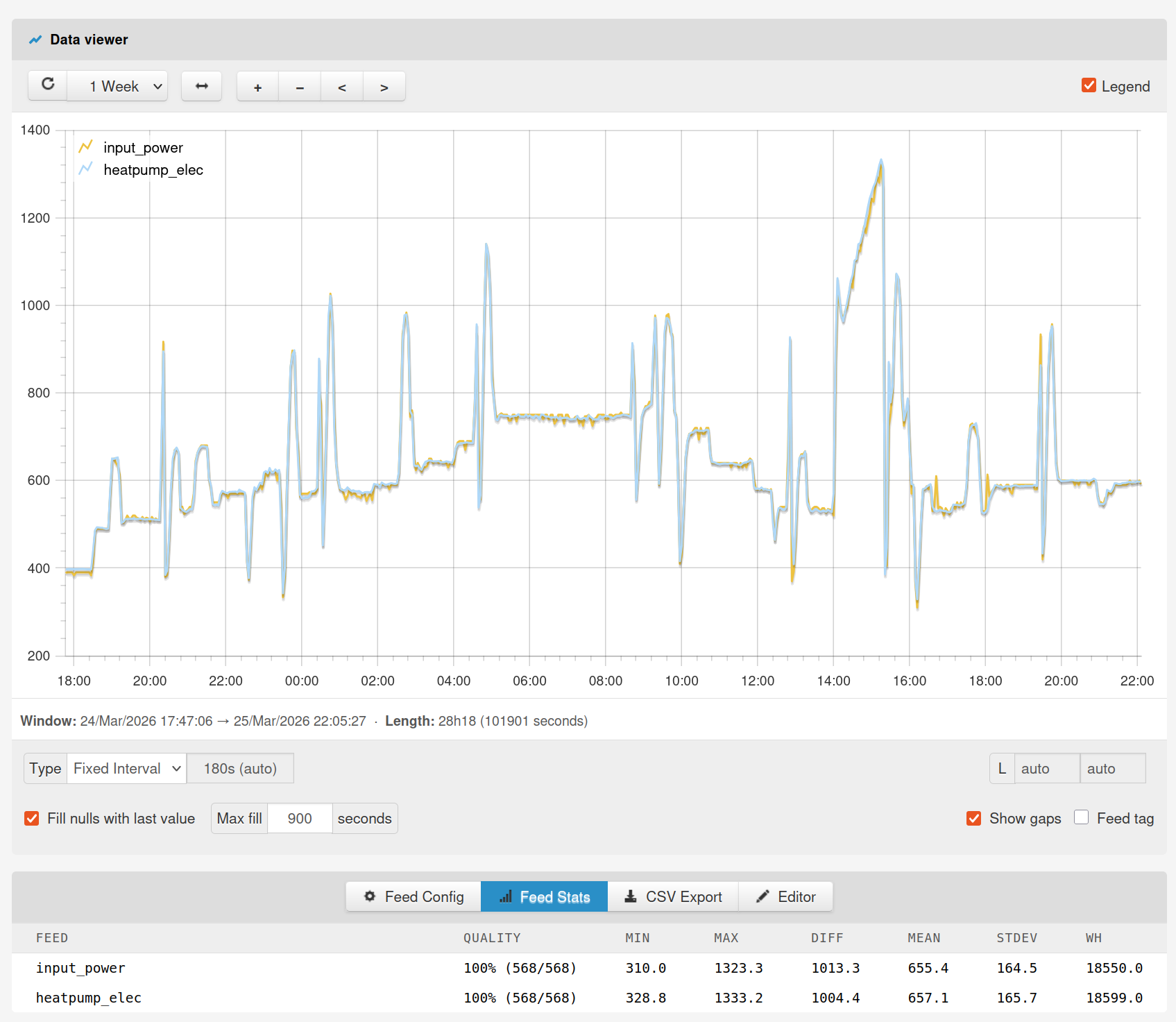

Electric power is much better only a 0.2% difference!
really remarkably good only 0.25% difference here over a longer period!

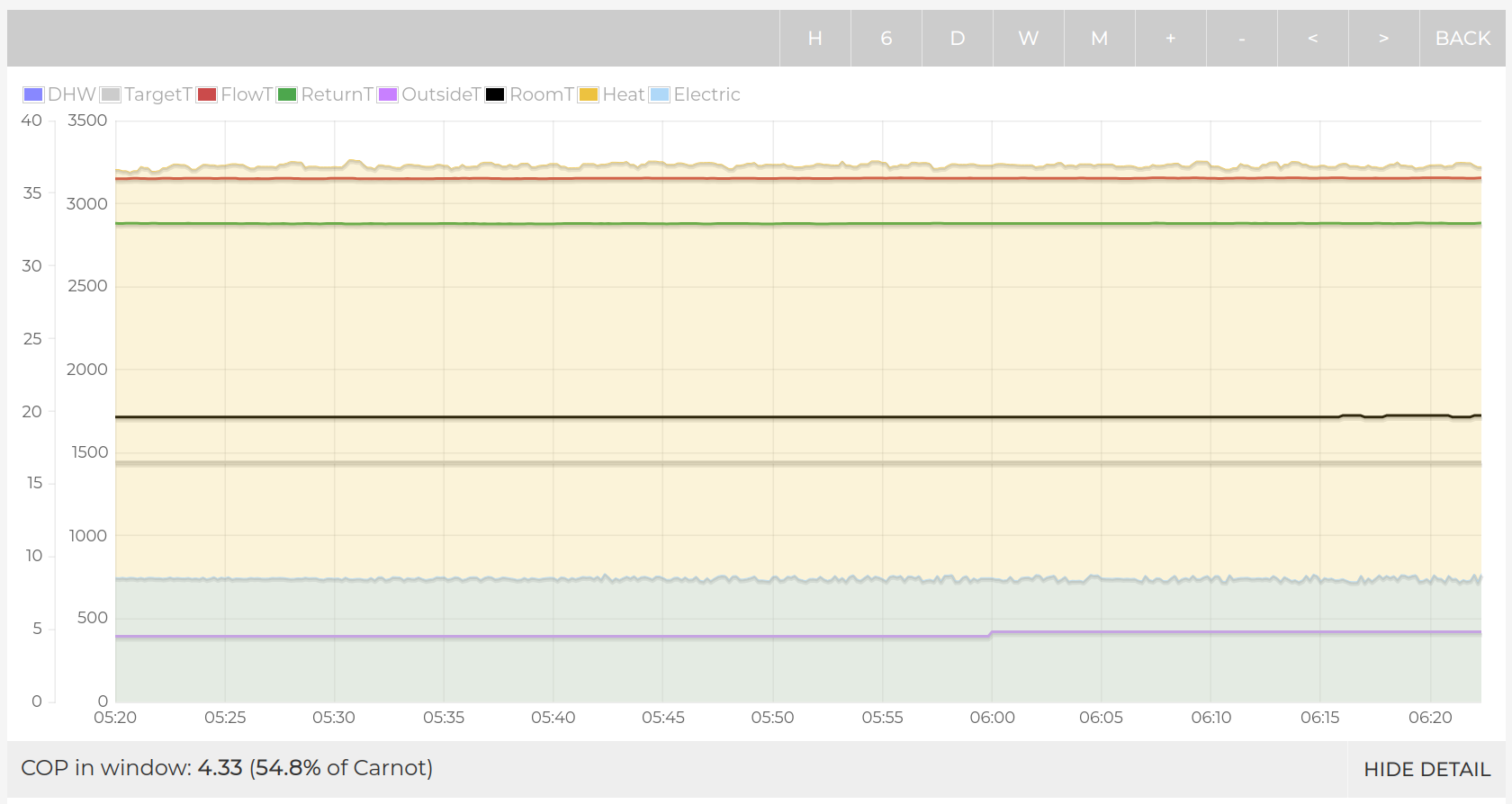

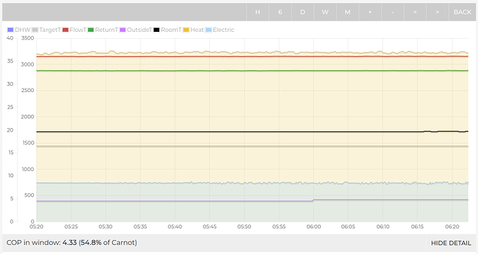

The Econet API reported a COP of 6.3 over the 5:20-6:20am period selected above, even though it’s heat output / electrical input measurements suggest: 4387÷746.7 = 5.9. Perhaps it’s doing a running average or something. The MID metering COP for the same period is 4.33.
Cross checking the % of ideal Carnot using the MyHeatpump app gives 54.8% for the MID metered performance, which is towards the higher end of the range we would expect (but within the expected / realistic range). A COP of 6.3 would be 80% of carnot which is clearly too high.

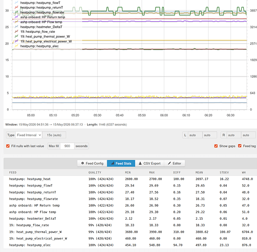

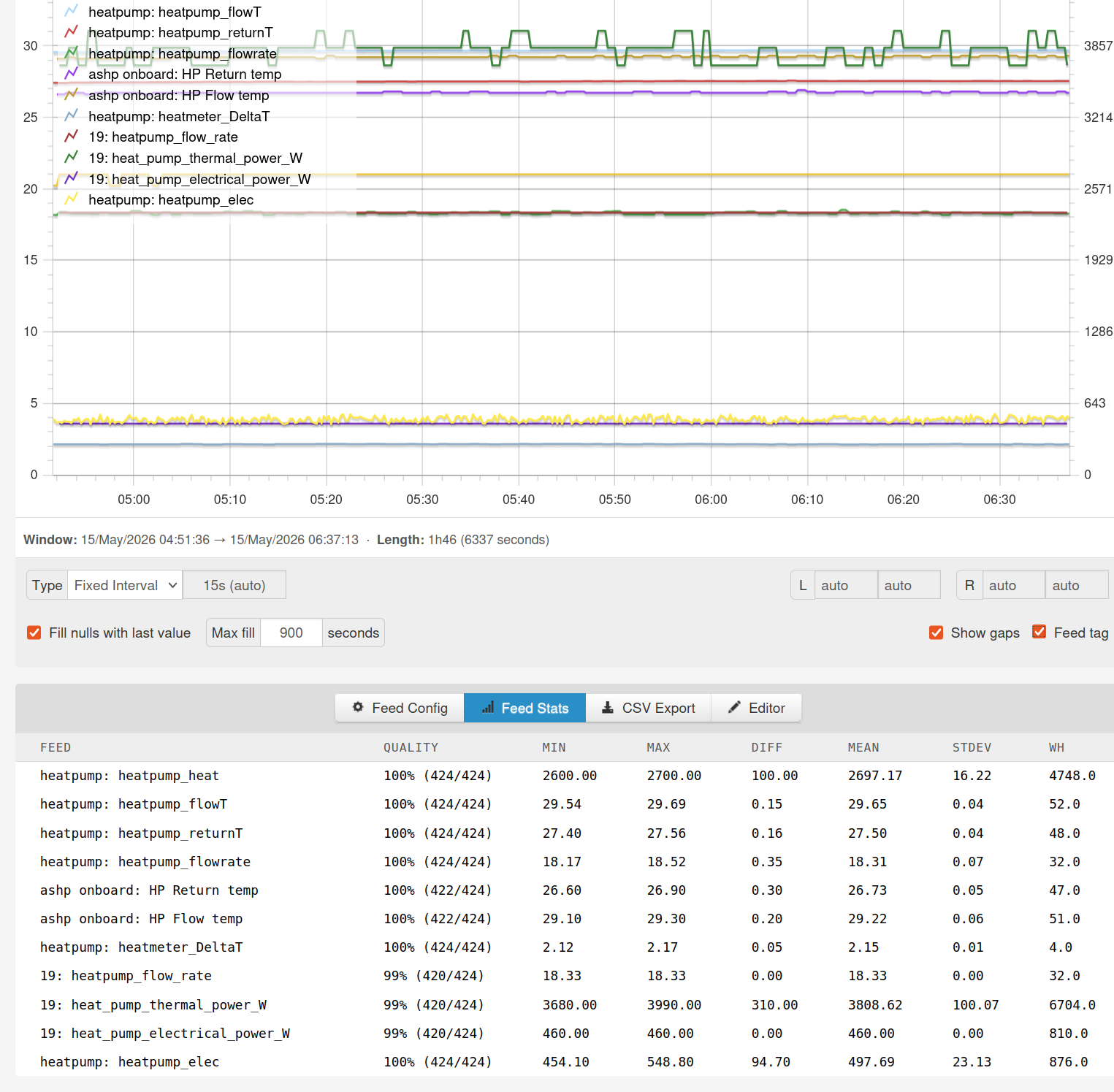

@glyn.hudson’s 9 kW Grant R290 https://heatpumpmonitor.org/system/view?id=748
Axioma Heat meter:
  • Flow temperature: 29.65C
  • Return temperature: 27.5C
  • DT: 2.15K
  • Flow rate: 18.31 L/min
  • Heat output: 2697W
  • Assumed specific heat = 2697÷((18.31÷60)×2.15) = 4111 J/kg.K (expected result)
  • Flow temperature: 29.22C
  • Return temperature: 26.73C
  • DT: 2.49K (~16% more)
  • Flow rate: 18.33 L/min (~0.1% more)
  • Heat output: 3809W (41% more)
  • Assumed specific heat = 3809÷((18.31÷60)×2.49) = 5013 J/kg.K (again very high..)
It’s interesting here that the flow rates are very similar but it’s now the DT and again the specific heat that’s off the mark.

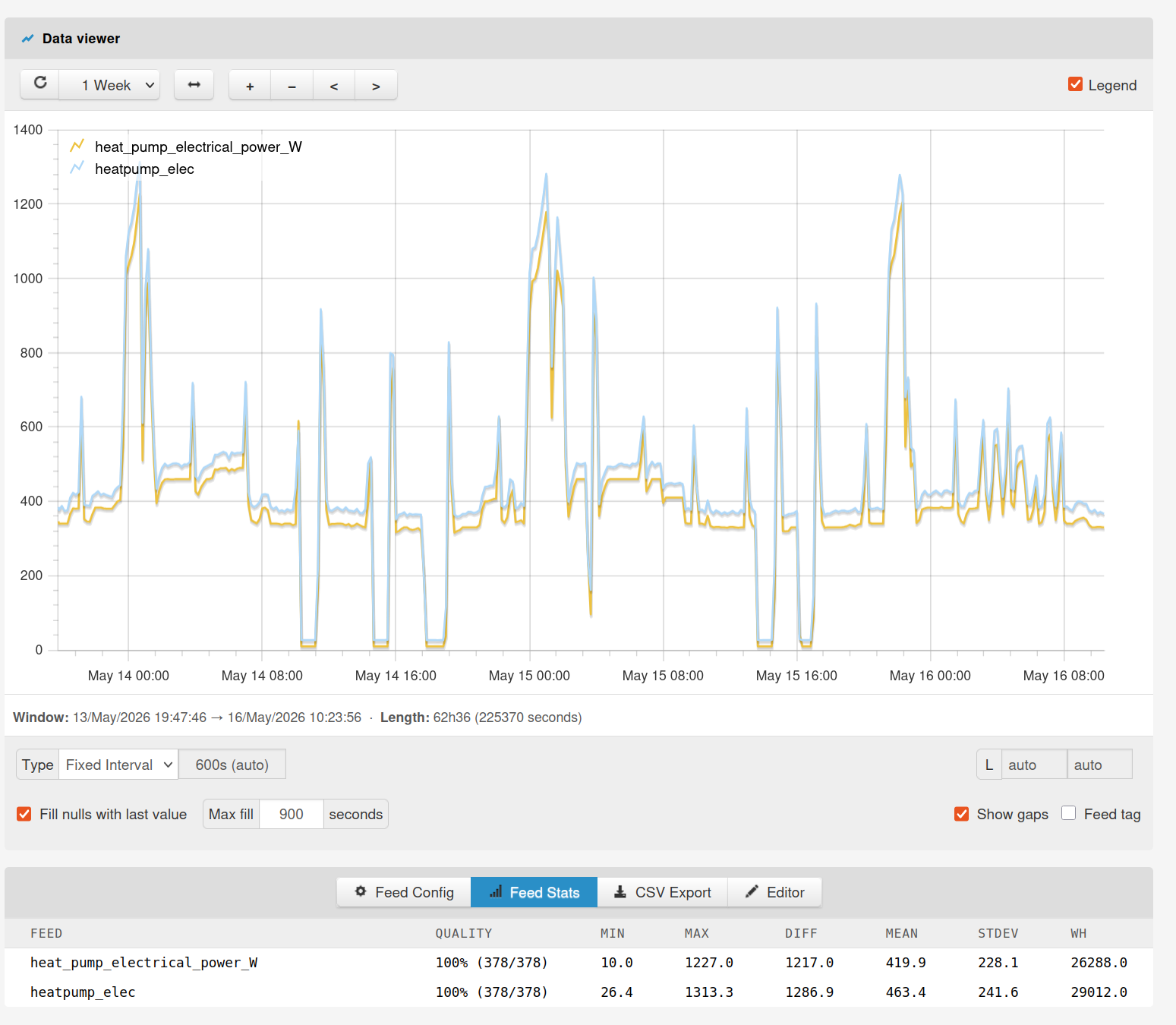

On Glyn’s system the electrical measurement has also got a greater difference, e.g in the same window above SDM120 498W, grant in-built: 460W (7.6% less). Zooming out over a longer period of time the grant is reporting 9.4% less electric consumption in this window:

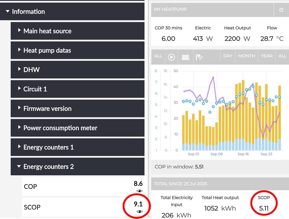

Here’s a comparative screenshot that Glyn took a while back that compared SCOP as reported on Econet with the SCOP/COP based on the MID meters.
