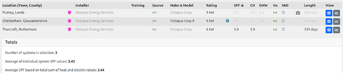

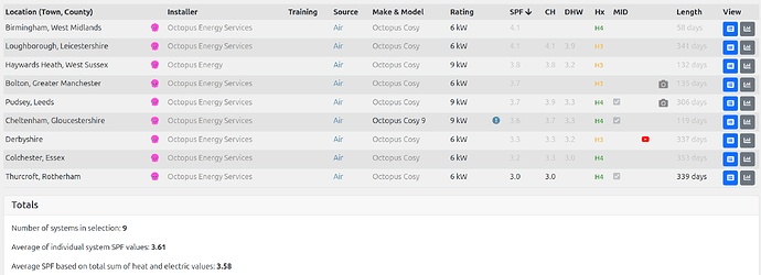

I see we have 9 Cosy systems on the site so far, all getting decent performance:
https://heatpumpmonitor.org/?filter=query:hp_model:Cosy:eq:t,refrigerant:R290:eq:t&minDays=0&other=1&hpint=1&errors=1&add=combined_data_length
Of these there are 3 systems with MID metering:
https://heatpumpmonitor.org/?filter=query:hp_model:Cosy:eq:t,refrigerant:R290:eq:t&minDays=0&errors=1&add=combined_data_length
The performance of the Cheltenham one is lower than in reality due to air errors in the heat meter, the actual performance without air errors is likely to be closer to ~3.8. That would raise the MID metered average of those 3 systems to 3.5.

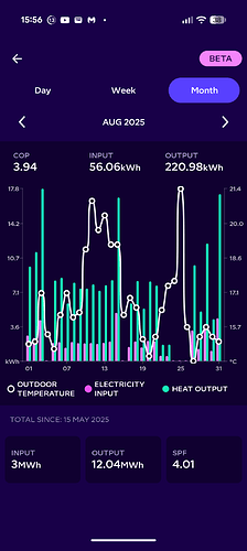

@Swwils do you have any comparison data on yours?

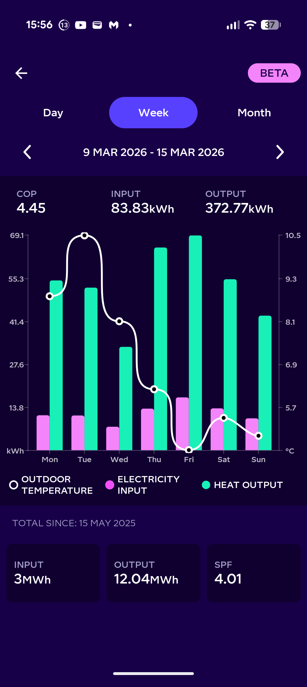

I can do, do you know if the octopus API exposes the data?
If not I’ll get some time and do it manually. My gut feeling is that the octopus app under reports performance slightly.
They leave a lot of performance on the table as well. I think they are being a bit smart showing a variable tarrif cost basis against gas, they should separate out what cost saving is comming from the tarrif compared to the actual efficiency.cost saving. Looking at the data I think it’s clear that MCS oversizing is also contributing, especially with the heavy ramp up the cosy seems to do each cycle.

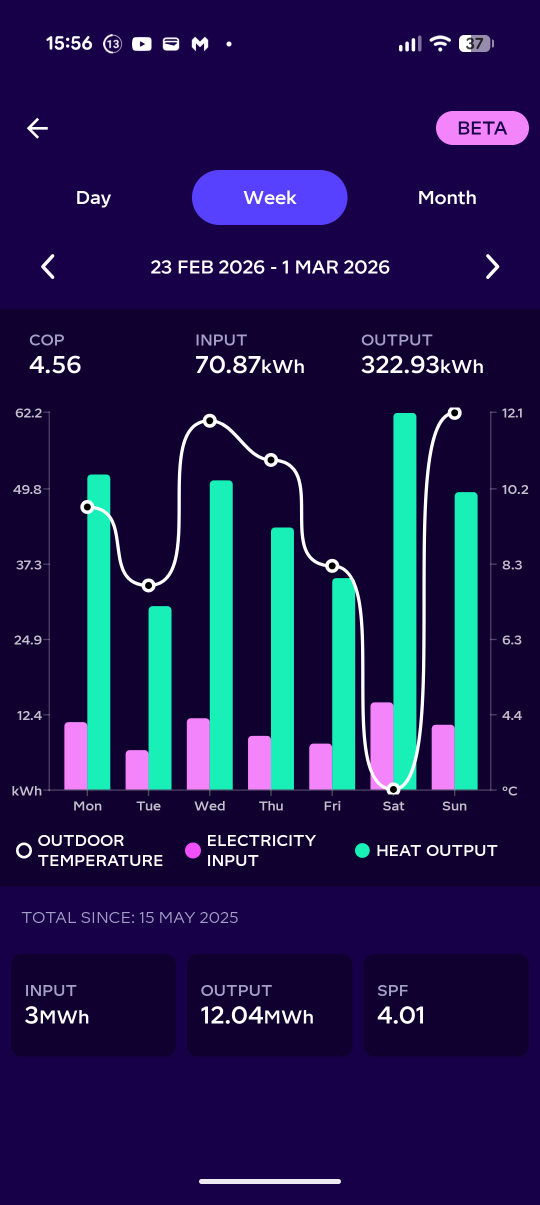

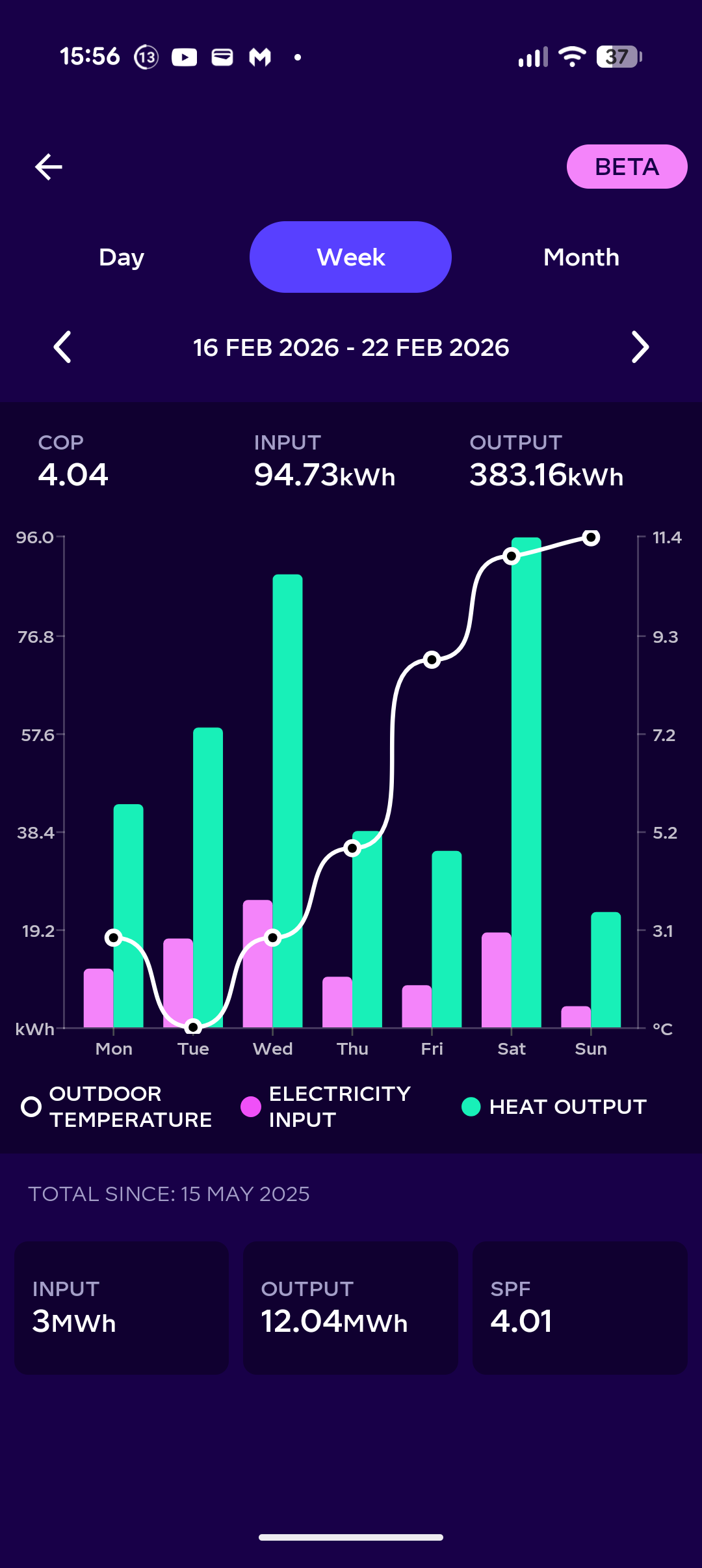

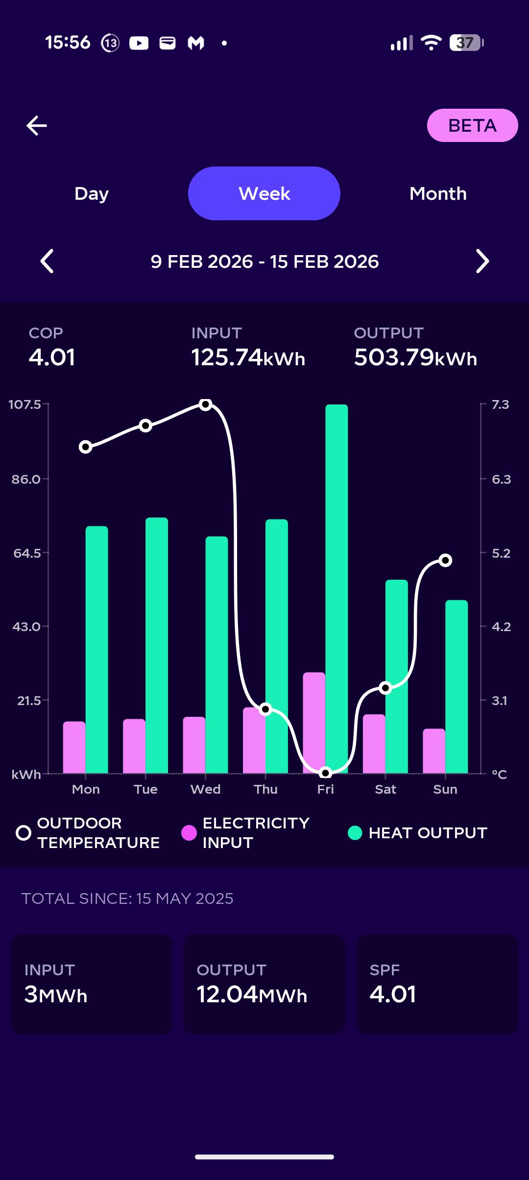

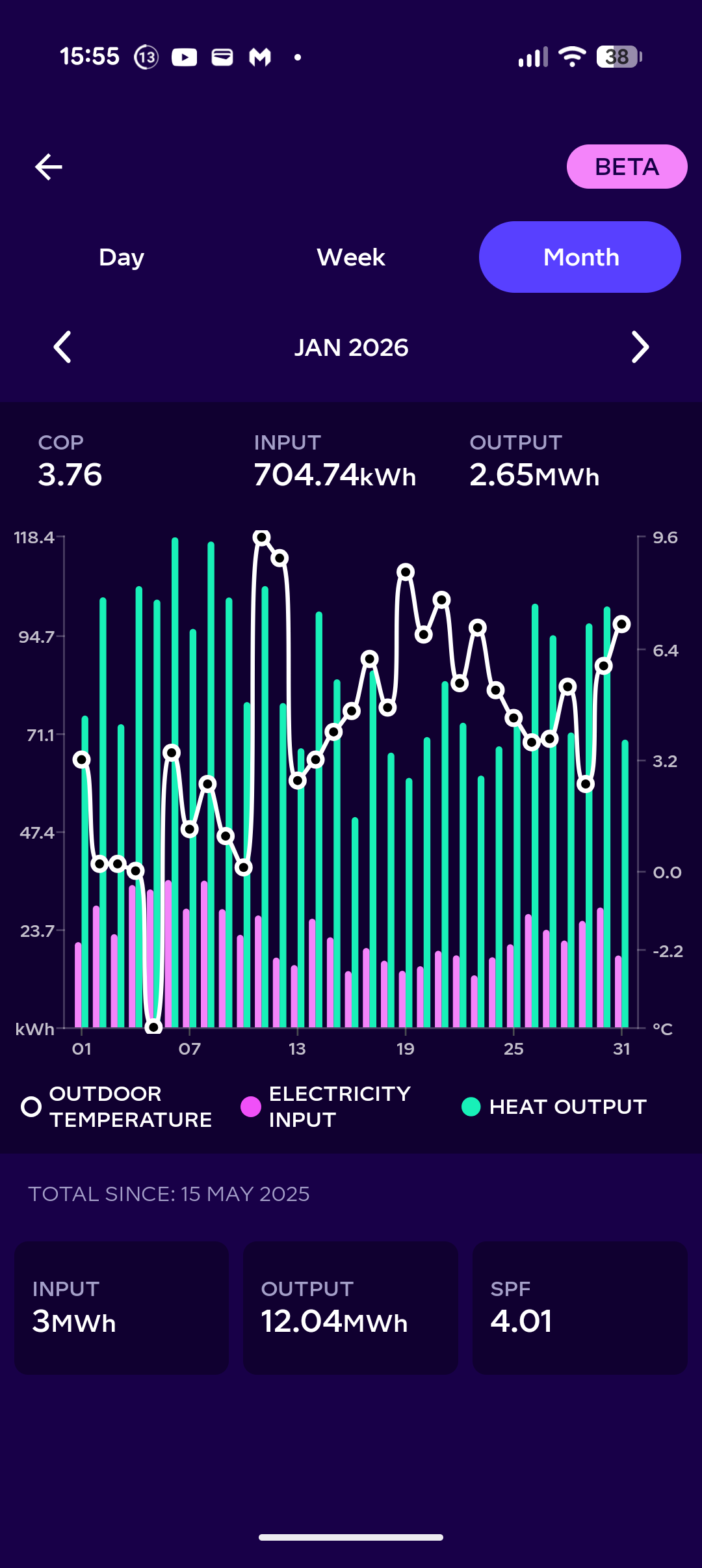

A few screenshots via the app would be great :+1:
What time base?
Week or month?, what’s the max?
Month!

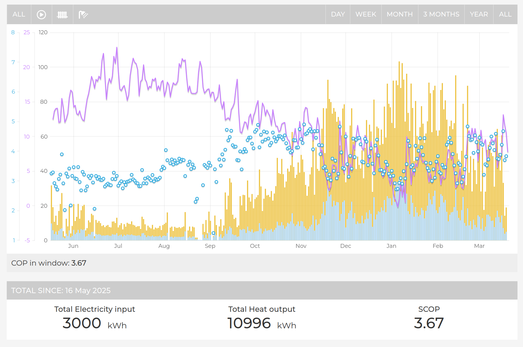

I didn’t include anything before August, since in August they released a firmware update that significantly increased hot water COP.
If you look at my system it’s very hard to get it into steady state, I think the 9 might be a little oversized for my house (my entire house is south facing and huge amounts of glazing), so if anything that is a glowing endorsement that even when it’s chucking it produces good COP.

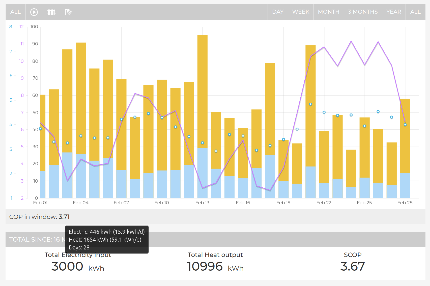

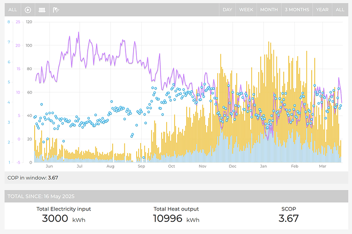

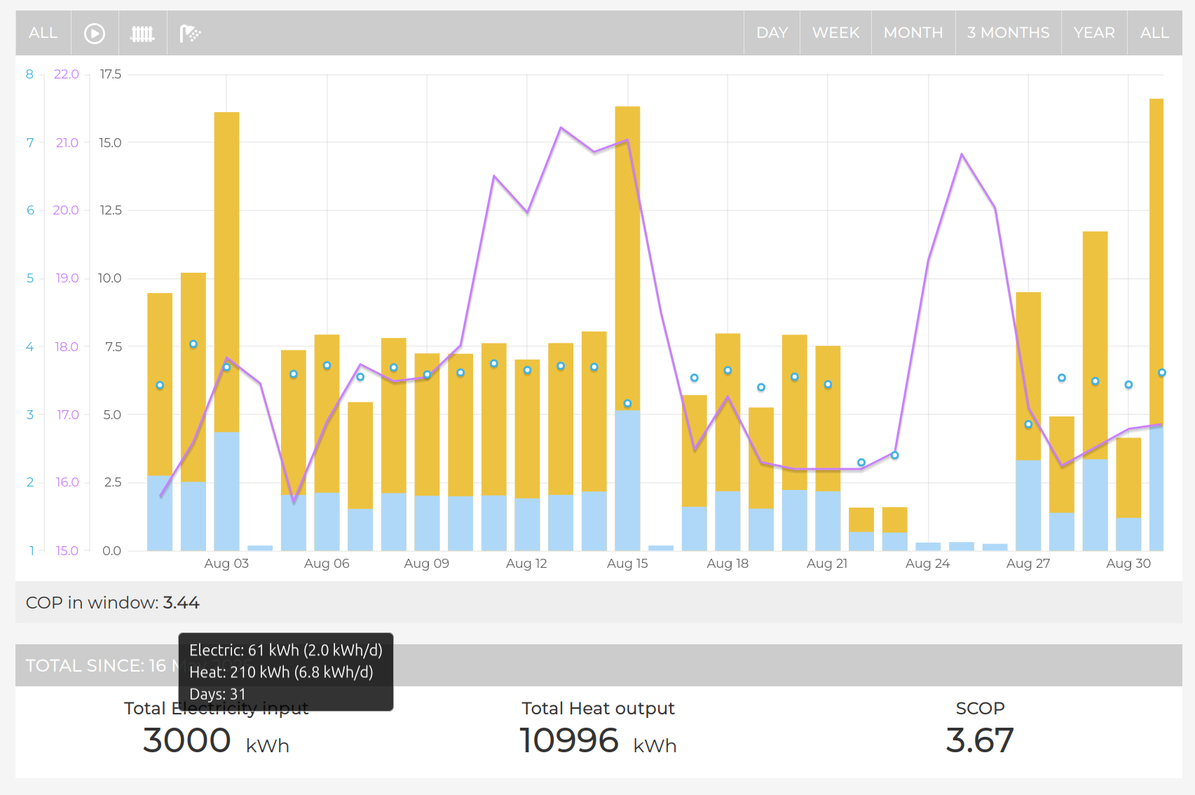

Thanks, interesting! so it looks like it does have a running total that has the same electrical consumption as your system is showing on HeatpumpMonitor, the SPF on heatpumpmonitor is a bit lower than on the app 3.67 vs 4.01 and it looks like the main difference is the heat meter, still a 10% difference is pretty good for internal monitoring!

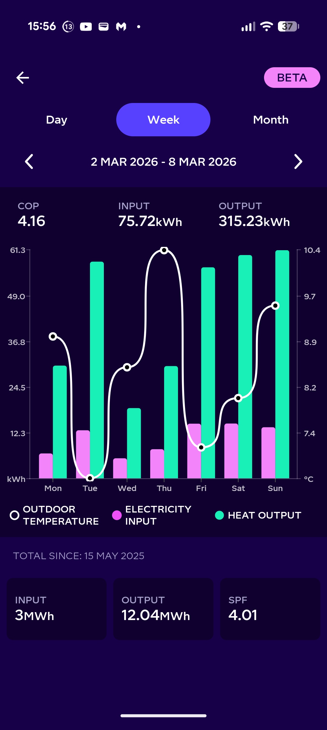

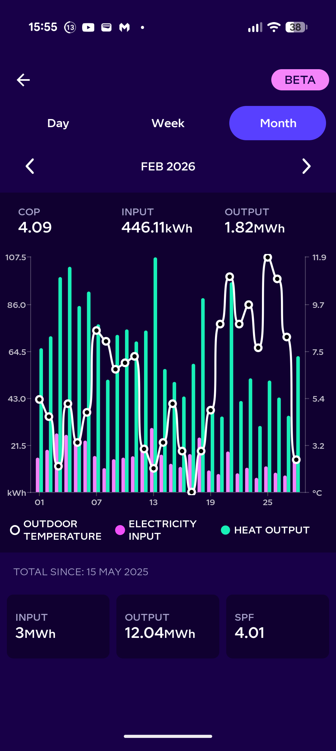

February, again pretty much the same difference:

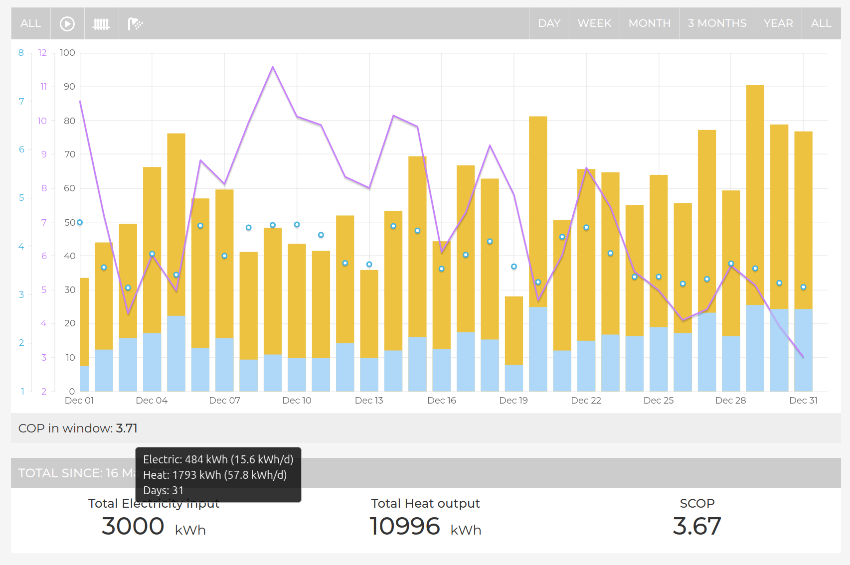

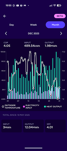

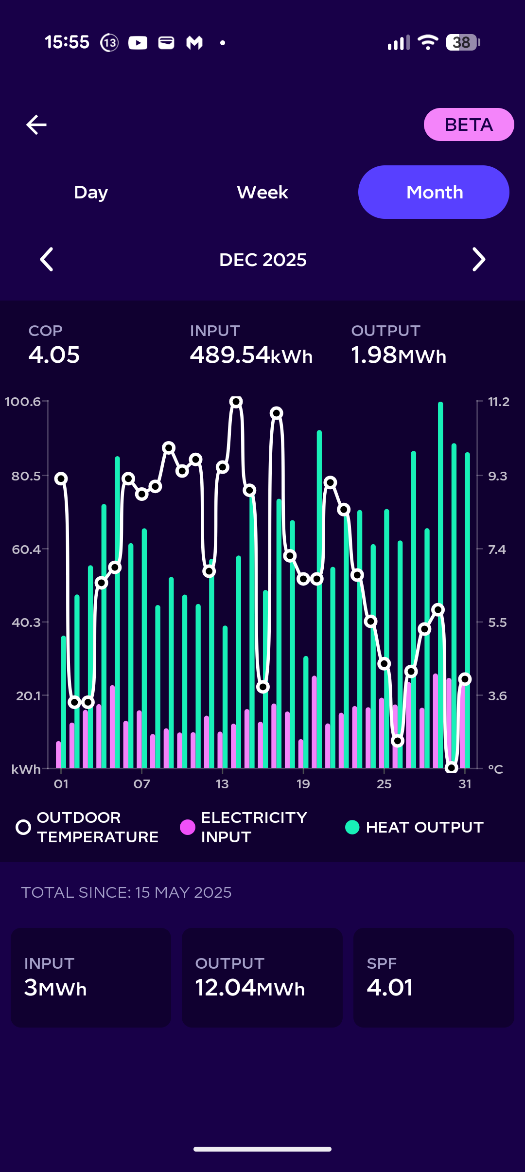

December, similar difference in COP

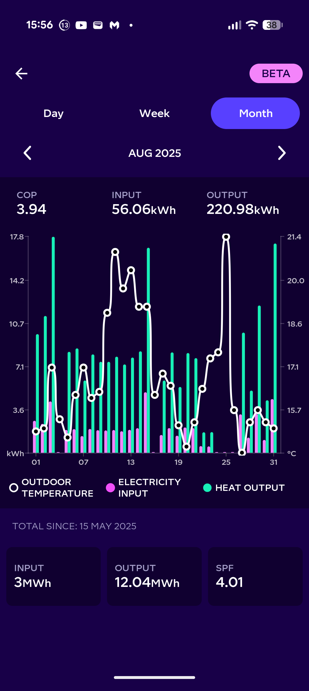

I’m expecting a big jump in SCOP once I get some new June to Aug data into that year, the August update really was very important for how it ramps hot water.
As far as I can tell it doesn’t have any summer mode either, where it knows it can run a hot water call over a longer duration to improve cop.
Also it does have at least two operating modes, as soon as flow goes above 55C I think it targets dT 10 instead of dT5.
Nice!

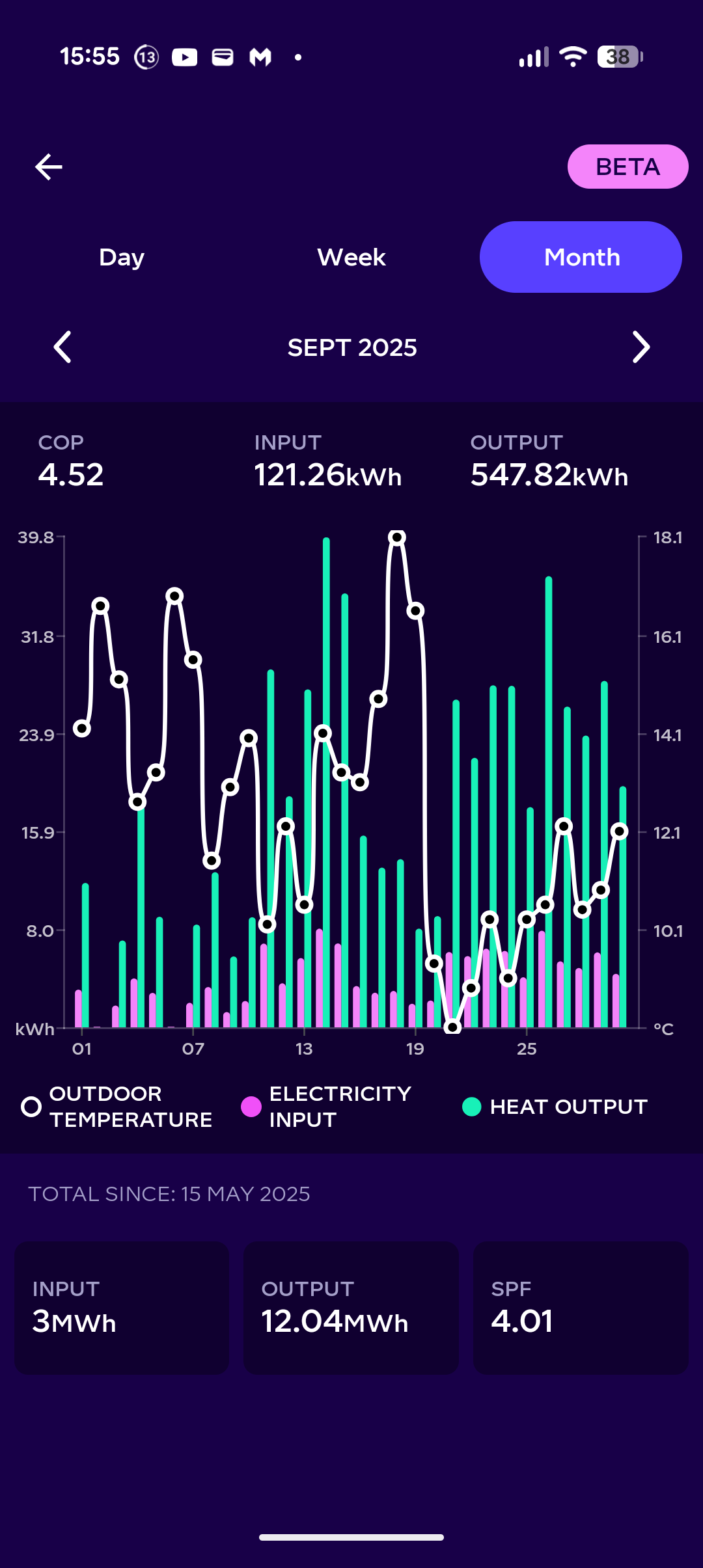

Comparing August figures, 3.44 vs 3.94, (56 => 61, 221 => 210)

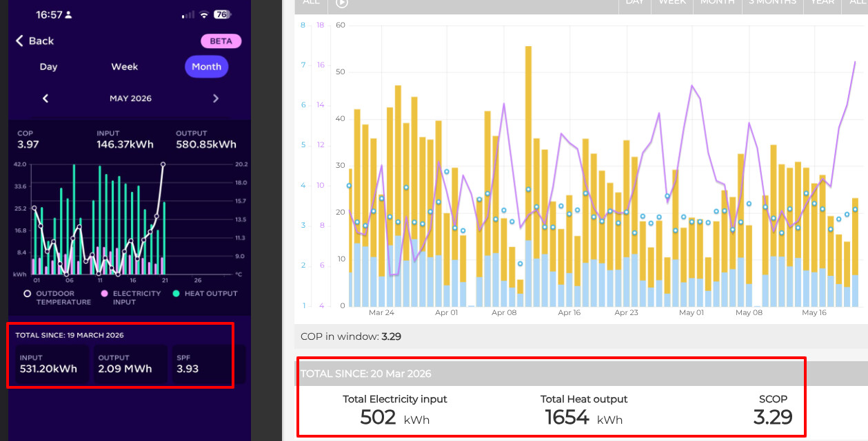

Here’s another data point from the Cosy in Rotherham that has MID meters installed: https://heatpumpmonitor.org/dashboard?id=1186
Over the past 7 days the onboard Octopus data reported a COP of 3.8
The MID meters reported a COP of 3.3
This is an over reporting of 15% error on the COP reading
It looks like the electric usage is correctly reported (87kWh), but the heat delivered is being significantly over reported 335kWh (onboard) vs 290kWh (MID)
How far is the heat meter from that heatpump?
A few meters I believe
At 10-50 watts/metre (more if the insulation is soaking wet) per pipe this can have a material impact.
Mines as close as it could possibly be, probably about 50cm.
Here’s another data point from this system: https://heatpumpmonitor.org/dashboard?id=1186
COP is being over reported by about 20%
