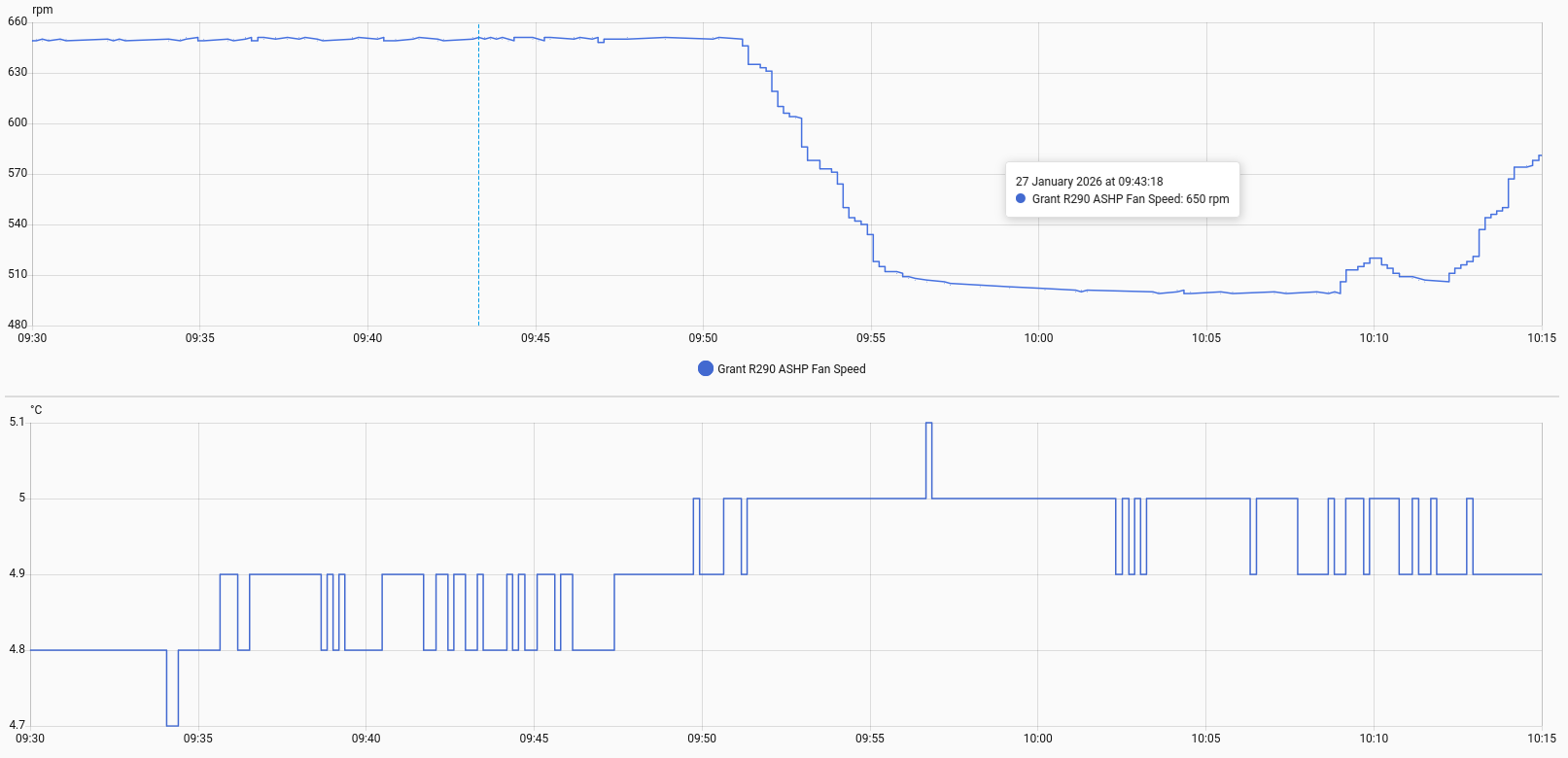

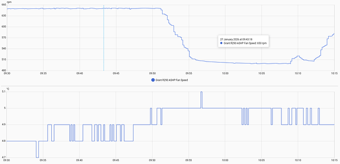

Thought I’d start this as I’m interested in understanding fan noise on my R290, hopefully I can reduce it when Grant release the fan speed control in econet24, for now just sortof using this as a place to document things.
First thing, I’m very certain now that the ASHP goes to 650rpm when the ambient sensor on the ASHP itself gets to 5c, I think there may be a delay or dwell time e.g. delay changing fan speed by a few mins, or ensure 5c or below has been present for a minute or do, but you can clearly see the behavior below

That interesting, I had assumed that it always ran at 650rpm, it does indeed seem to follow the ambient sensor rather than outside temp sensor.

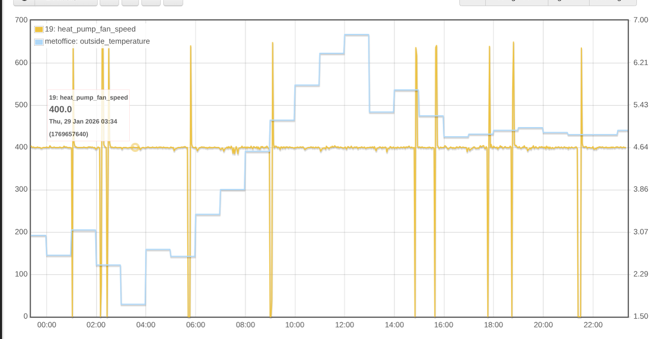

Interesting, My 9kW HP290 runs the fan at 400 rpm all the time apart from during defrost cycles. It’s totally inaudible inside the house, even during defrost:
I’m running latest FW
This is my system: https://heatpumpmonitor.org/dashboard?id=748
