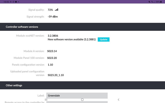

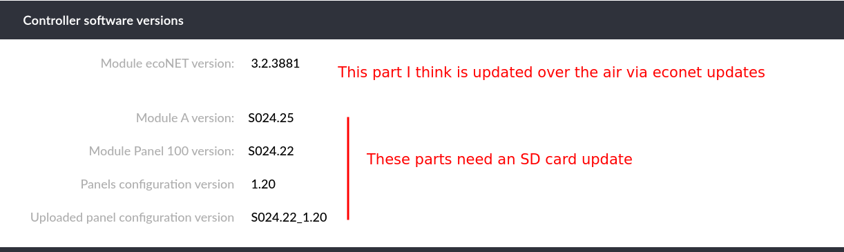

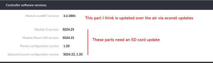

I’ve updated the Econet element before, as far as I’m aware that only updates the part on the tp-link device, and to update either the wiring centre or touchscreen controller you need the SD card update.
The update is in “Device Settings” in Econet.

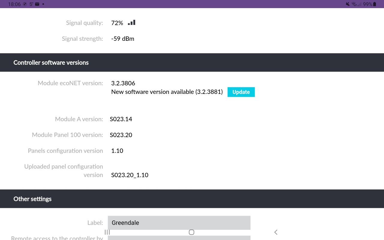

this is what I see under the last option of the econet ‘pizza’ menu .. I have resisted the temptation to click the update link button.

swmbo would not like me twiddling with critical bits in the heating season. the sd card slot also appears to be the cheapest money can buy (I had a look) so correctly Inserting a card might be exciting.
ah yes, I’ve seen that. I clicked update. As you mention, I think this only updates the TPlink. I’m running
Module ecoNET version: 3.2.3881
Module A version: S024.25
Module Panel 100 version: S024.22
Panels configuration version: 1.20
Uploaded panel configuration version: S024.22_1.20
Yes I managed to jam the sd card between the touchscreen body and the slot so be careful!
Oh by the way, the econet update you see won’t get you silent mode. I don’t recall it really doing much of anything. You need the sd card update for that
