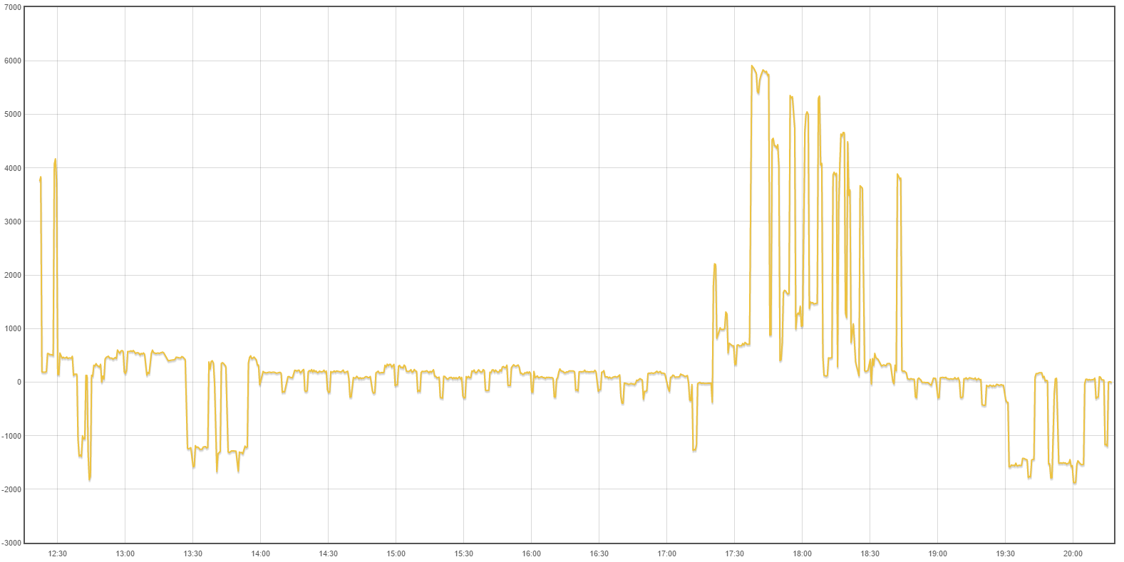

This is images of “log to feed” from today. Can you help me understand if it is working as it should and how I should configure emoncms (or point me to where I can read about it) to see actual instant usage (sum of the three phases?) and todays import/export ?
In emonCMS, on your Input page, after you have logged that input to a feed, you can do
+input [the second phase],
+input [the third phase],
log to feed [this is the total]
If you want kWh for each feed, then, after doing the Power to kWh on the first, you’ll need to reset to zero, then do +input [ the first phase again], then add the other two phases, then do Power to kWh on the total.
So I did this, hopefully as you recommended. My concern is that this sum seems to be negative a lot ot the time. I sure have a solar PV but it is not producing anything at night for example…
I need to verify this but I think the CT’s are hooked up on three phases going in to my house and not the actual cable that exits the house (and have the solar pv attached to it). What I mean is what I am measuring right nog would probably be positive all the time right ? Only import. I need to talk to an electrician to move the CT’s.
Anyhow it should me positive readings i guess ?
How can I start to look for errors, is one or more of the CT’s in the wrong direction ? Is the error from me using the same ground for all three CT’s ? Me not understanding emoncms ? Anything else ?
Obviously, I do not know exactly how your house is wired, nor how you have installed the CTs. All I can say to help you is that you must get the basic information for each phase correct as it comes from the emonTx, or at least understand how and where it is wrong, before you worry about emonCMS.
Your problem seems to be where you are measuring. Forget for a moment that you have three phases. There are 3 quantities that are closely related, Nett grid power, Used power and Generated power. Knowing two, you can calculate the third.
Nett grid = Used - Generated
But you must know, or assume, the direction of power flow to get the sign of the power correct, and that’s where the direction that the CT points comes in. We count Used and Generated as positive (so your inverter consumes 50 W, or ‘generates’ - 50 W, at night when it is dark), and imported Nett grid as positive.
Therefore, where you measure current tells you which of the three versions of that formula you need:
Used = Nett grid + Generated
Generated = Used - Nett grid
You should be able to deduce what each CT is measuring if you know, or you can reasonably assume, what it ought to measure given a particular set of conditions. You will probably need to turn appliances (and your PV) on and off while you make measurements, and record the results.
Note, you do not need to get an electrician to reverse the CT, you can put a minus sign in the sketch.
