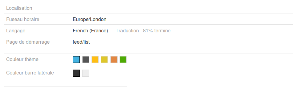

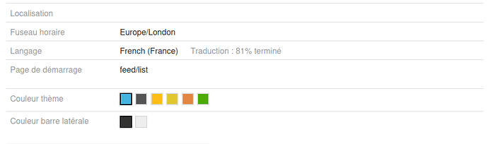

Translation System Enhancements: New JSON file based translation system, removal of Gettext dependency. This makes it quite a bit easier to use the different translations created for emoncms. Please see documentation here: emoncms/scripts/translation/readme.md at master · emoncms/emoncms · GitHub and issue here New JSON-based i18n system, Ongoing work · Issue #1931 · emoncms/emoncms · GitHub for more details. Thanks to @alexandrecuer for his work on the French translation.
See My Account > Language, to try this feature:

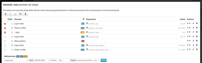

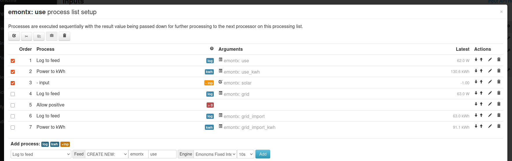

Process List Editor Enhancements: The process list editor has been refactored and improved, with a new Vue.js-based UI that supports group selection, copying, pasting of input processes. Thanks to @nchaveiro for the initial implementation which I then converted to Vue.js.
Support for input and feed processes with multiple arguments, e.g Power to kWh / custom minutes, which writes kWh per custom period such as half hourly. Thanks to @nchaveiro again for the initial work on this.

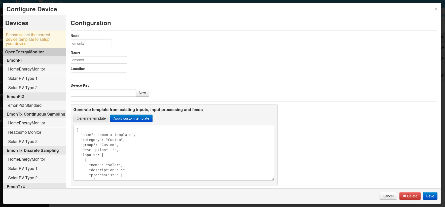

New feature to generate device templates from existing configurations and then import these custom templates to provision new devices:

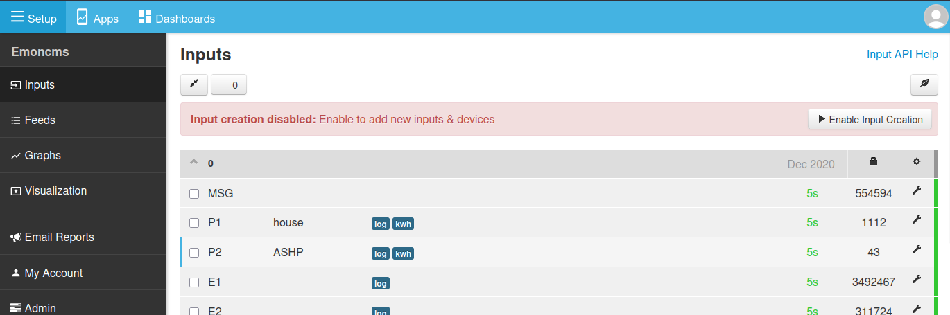

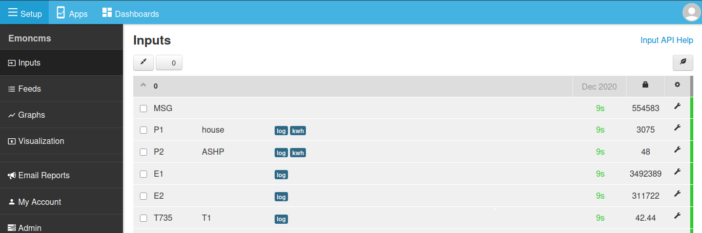

I’ve pushed a couple more features today to help with input management:
Simple button to clean inactive & un-configured inputs and devices: useful for clearing lots of spurious inputs, click on the leaf icon button on the top-right of the inputs page (this button only appears if there are inactive and un-configured inputs present):
Option to disable further input creation: Great for stopping continuous creation of spurious inputs and devices - if this issue is present. Button to disable further input creation can be found below the input list. Input creation can then be enabled easily by clicking on the ‘Enable Input Creation’ button.

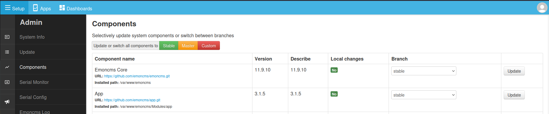

Hello @Bramco
What do you see on the Admin > Components page for Emoncms core and the Apps module? It should look like this:
I think it might be that it’s Emoncms core that has not updated on your system @Bramco
Can’t see anything - all I get is the error the fatal error as above
Fatal error: Uncaught Error: Call to undefined function tr() in /var/www/emoncms/Modules/app/app_menu.php:70 Stack trace: #0 /var/www/emoncms/core.php(284): require() #1 /var/www/emoncms/index.php(384): load_menu() #2 {main} thrown in /var/www/emoncms/Modules/app/app_menu.php on line 70
So can’t see any pages at all.
Simon
If so, what can I do to update just the core?
try via SSH:
cd /var/www/emoncms
git status
git pull origin stable
