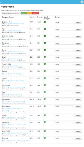

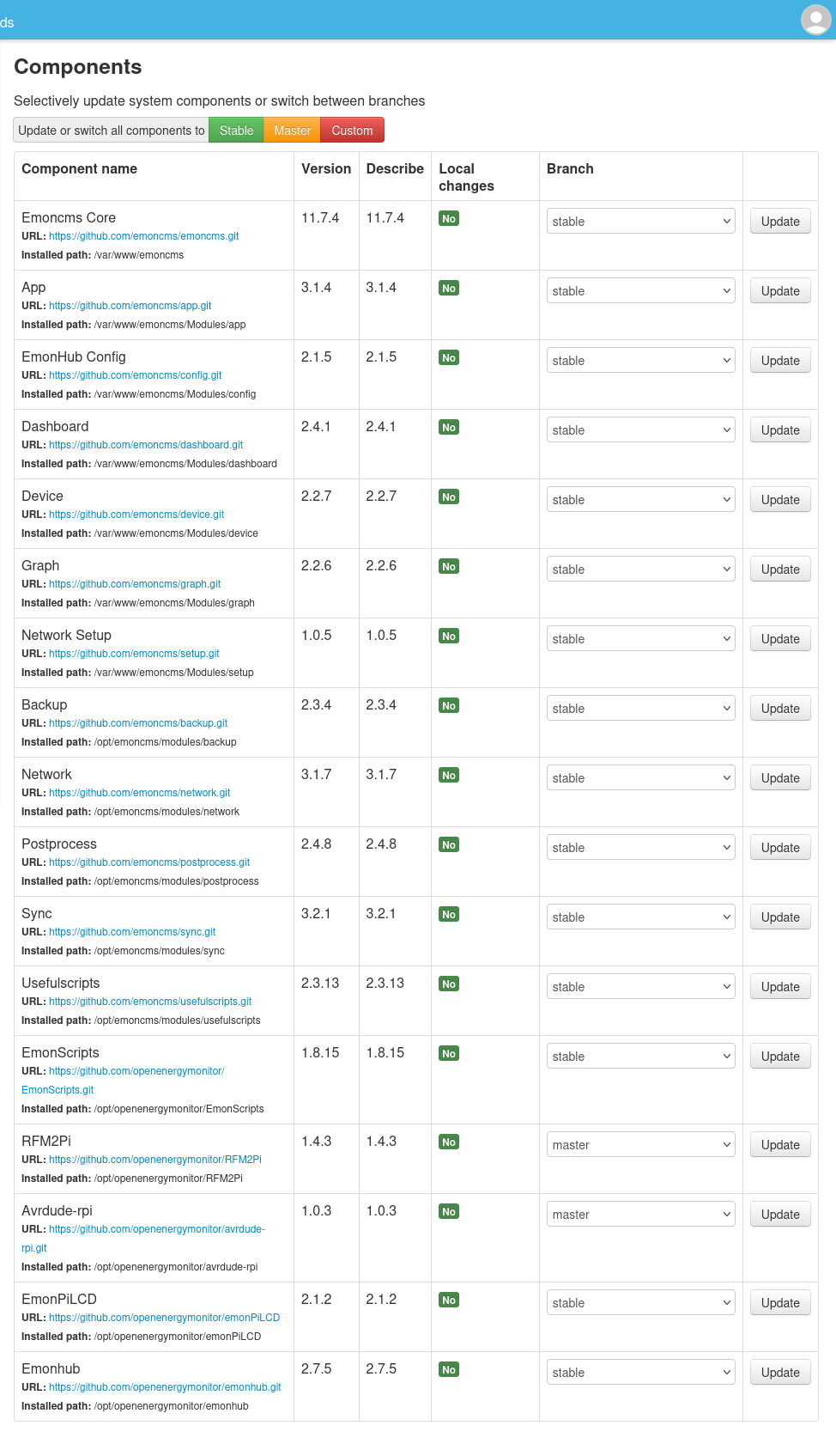

Emoncms component versions snapshot:

Did you mean this: 3.4.1 ? Methinks not.

Fixed thanks @Robert.Wall

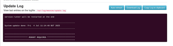

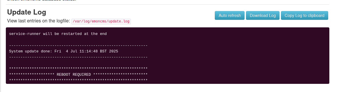

I’ve made the switch to the use of the rpi-lgpio library, preparing for the new emonSD image build.
Running update on existing systems will now install this library and associated modification to boot/config.txt SPI chip select. This requires a REBOOT for the RFM69 radio to continue working and so I’ve added a message that now appears at the end of the update process when this or other similar actions where reboots are required occur:
Further changes to the emonHub install script. It now only installs rpi-lgpio if rpi-lgpio is actually available. I had an older system error out on that and then fail as it had also removed the original rpi-gpio. It will now only install lgpio if it’s available in the package list for that distribution.
