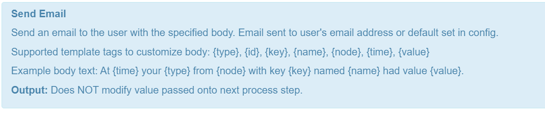

The only clue as to how to set up email is the pop-up that appears when you select email from the process list
So quite easy to see default, go looking for config and make the alteration where I did.
This needs a better instructions, especially as this has been changed completely in this latest version. I’ll raise a separate post on this.

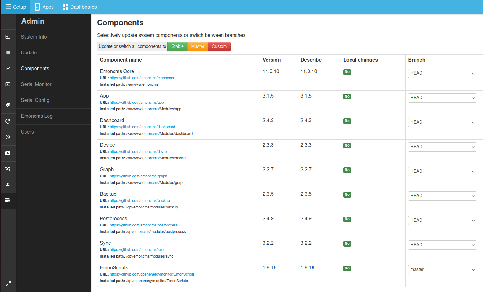

Also, to fix things, I had to copy the default-settings file from Git into the emoncms directory, then do the full ‘git pull origin stable’ to get things fully updated.

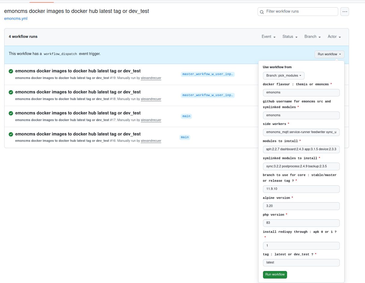

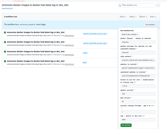

containerized version also updated
https://hub.docker.com/r/alexjunk/emoncms/tags
@TrystanLea the workflow to process the images has been revamped, so to better cope with the different tags. I was only using master and stable before, it was not enough robust.
latest tag also on the way and will fit with alpine3.20_emoncms11.9.10
everything is detached HEAD at a specific tag to keep consistency, except the emon scripts but in container mode, the emon scripts are not really used as the image has its own install process

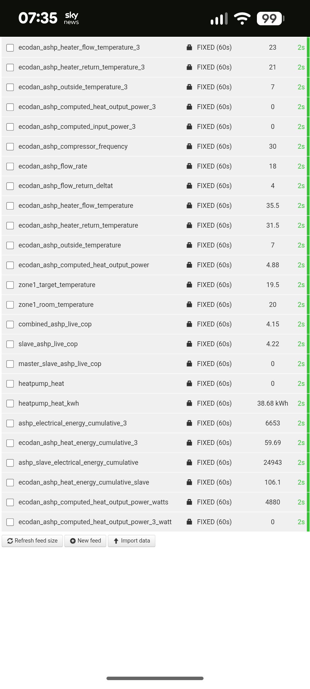

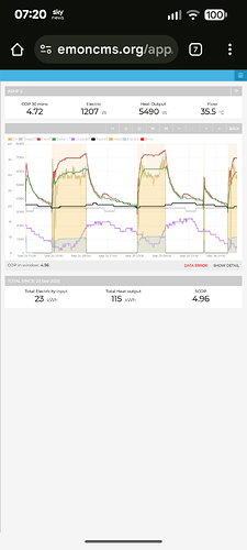

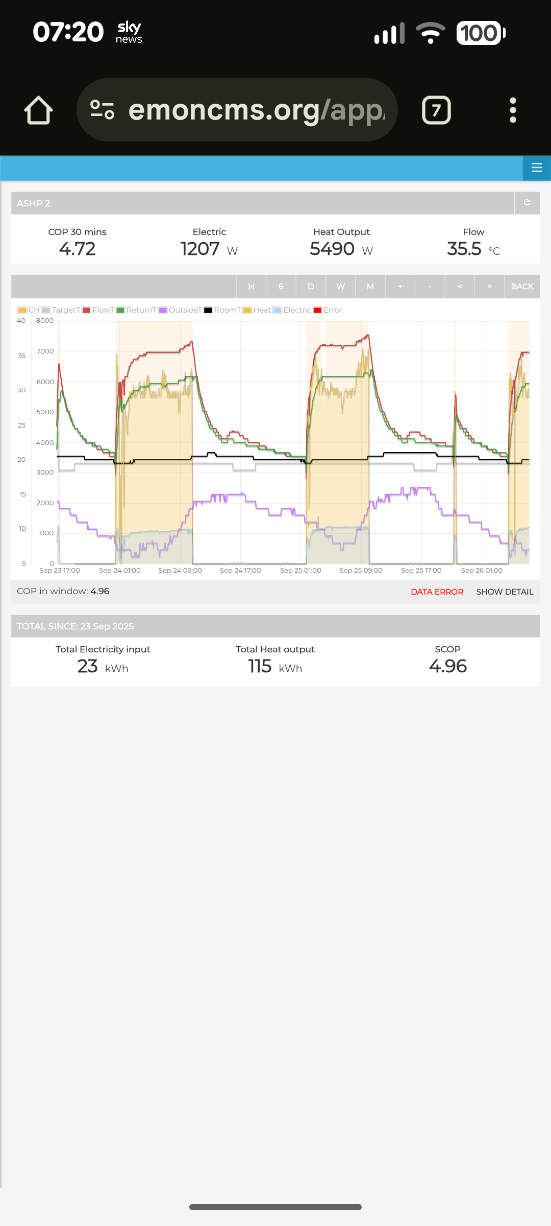

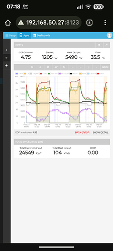

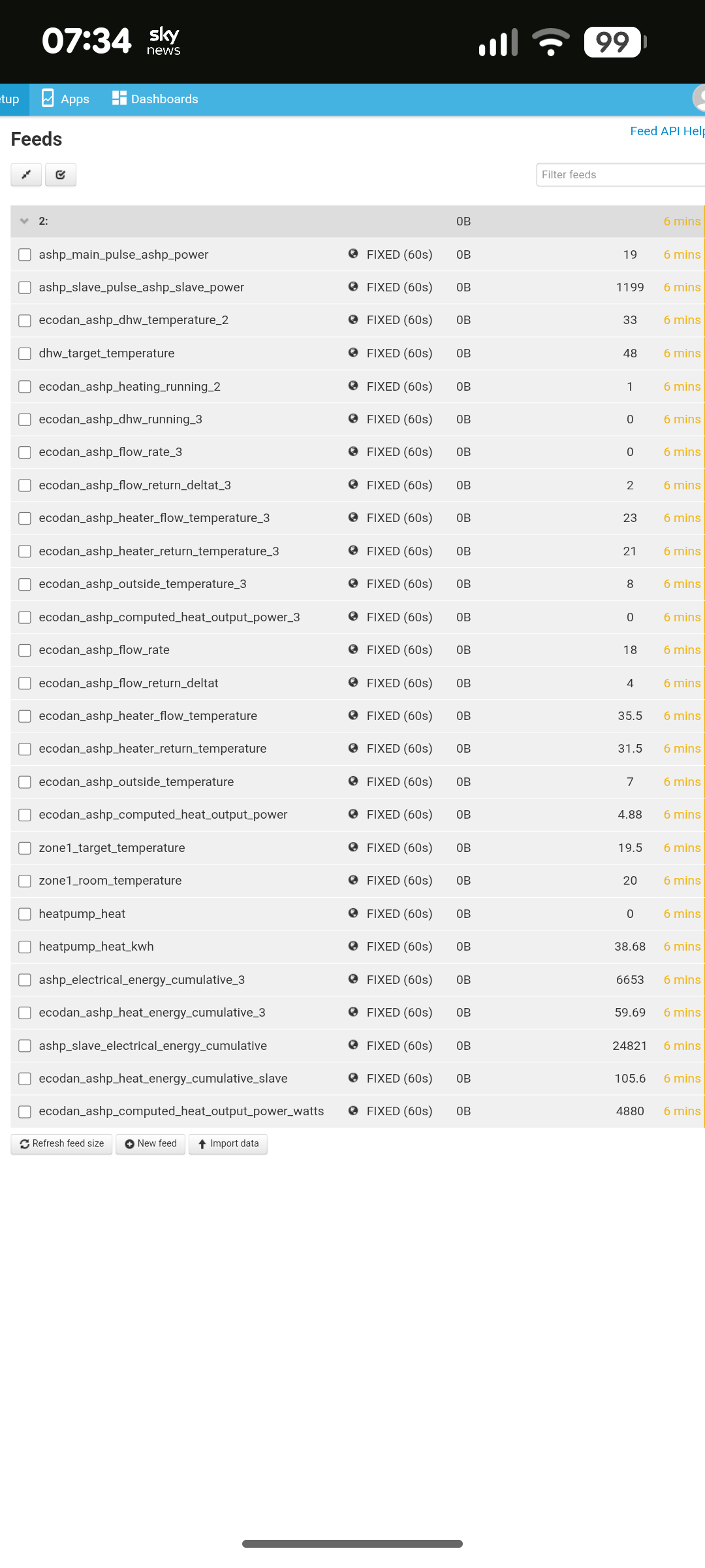

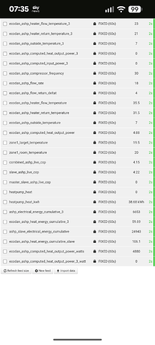

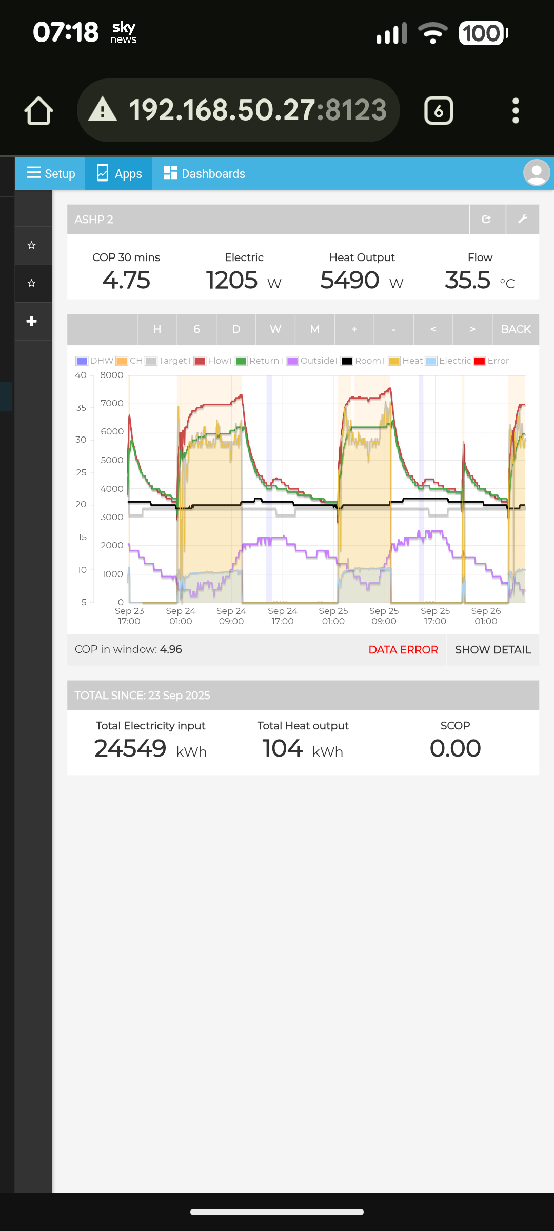

Thanks everyone for your work on HA. No issue adding my system to emoncms via HA. I’m getting my data from my first pi5 via MQTT.
I’m getting a unit error on my local installation of CMS but on the cloud it’s fine. Its the total electricity input is in the wrong units. Showing W’s not KWh. I’ve checked all the inputs and everything is matching up.
