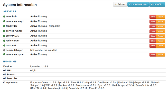

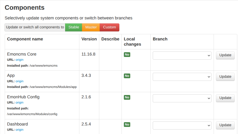

One last question,.. during updates,.. how do I tell which branch I am running with,.. none of the 3 buttons stable, master, custom are hi-lighted, to indicate which branch is currently active,.. or am I missing something, besides the obvious.. :slight_smile:

I think you might be – it is 3 lines up from the bottom of this screenshot, it’s just that this is not of the page you were looking at. :grinning_face:

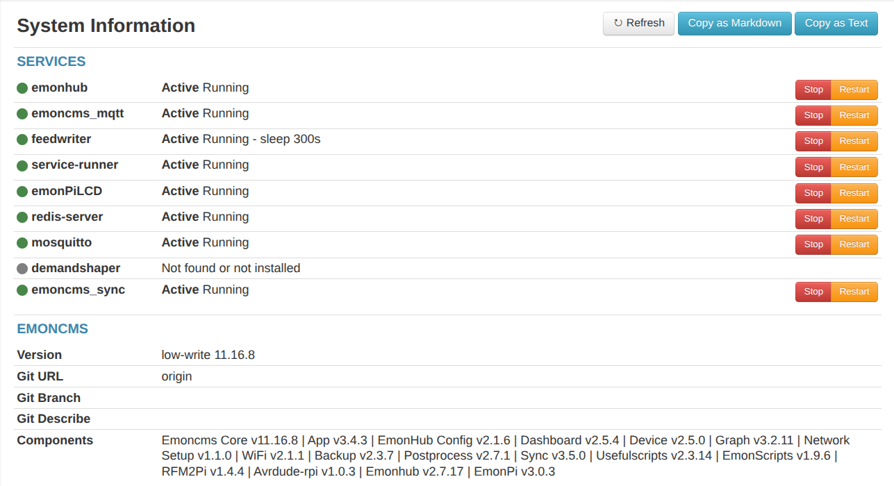

stable, master, custom,… In my defense, Ma’ Lord.. I see this:-
and this,..
I assume this is due to my install using a different ‘start of the week’,.. Any chance this might be included as a selectable standard feature??
On this point how do I remove this edit,.. and switch back to fully ‘stable’ as having an edited file seems to cause more problems than it is worth. ( without a full install :slightly_smiling_face: )

No info being shown for branch and describe there usually means that the emoncms application does not have permissions to run the relevant git commands. See this command in EmonScripts to enable this EmonScripts/install/main.sh at master · openenergymonitor/EmonScripts · GitHub

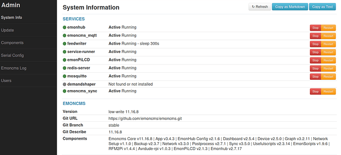

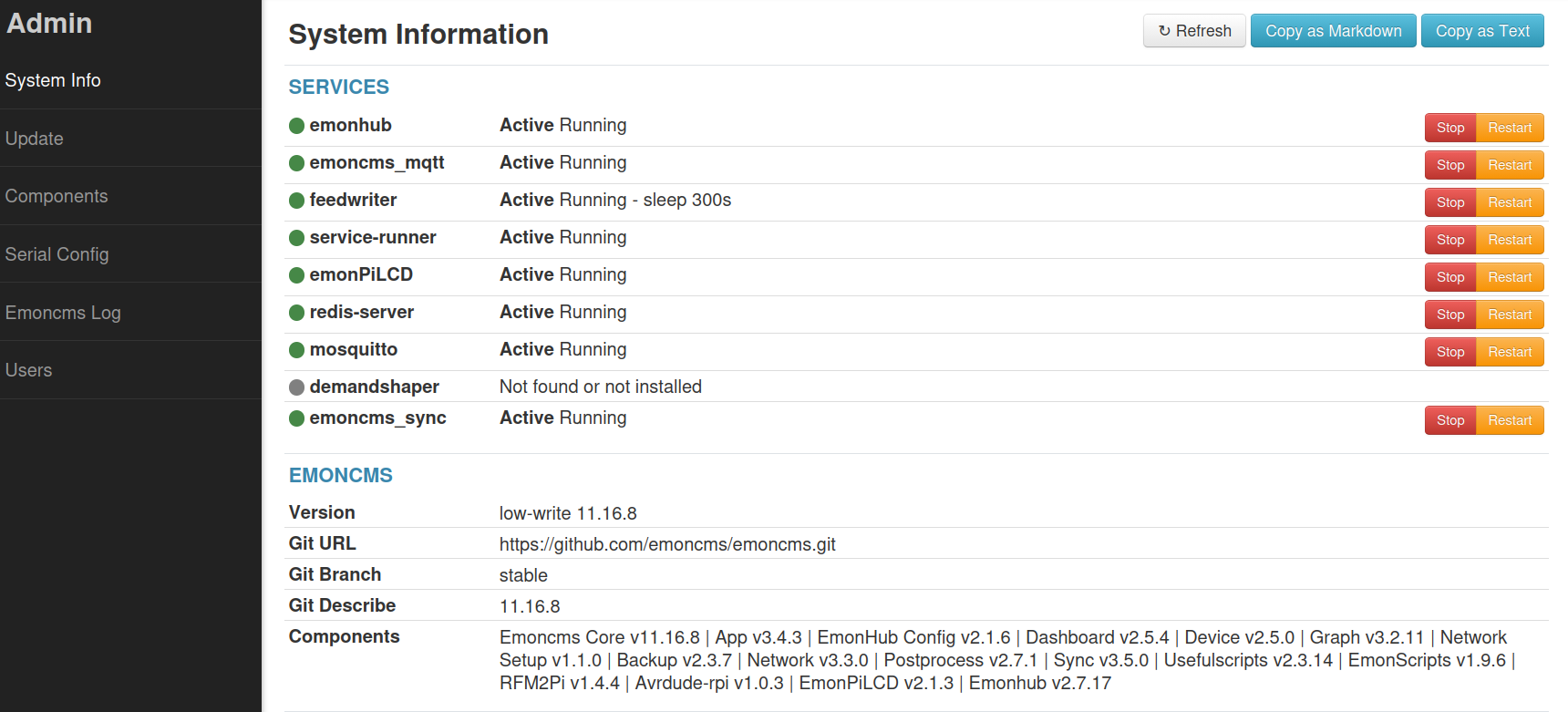

Tx Trystan,.. ran the file as you suggested,.. and I now have the ‘branch’ displayed in the relevant boxes.
FYI,.. the script returned the following error:-
/opt/openenergymonitor/EmonScripts/install/main.sh: line 125: /EmonScripts/install/non_emonsd.sh: No such file or directory
Hope that means something,..
