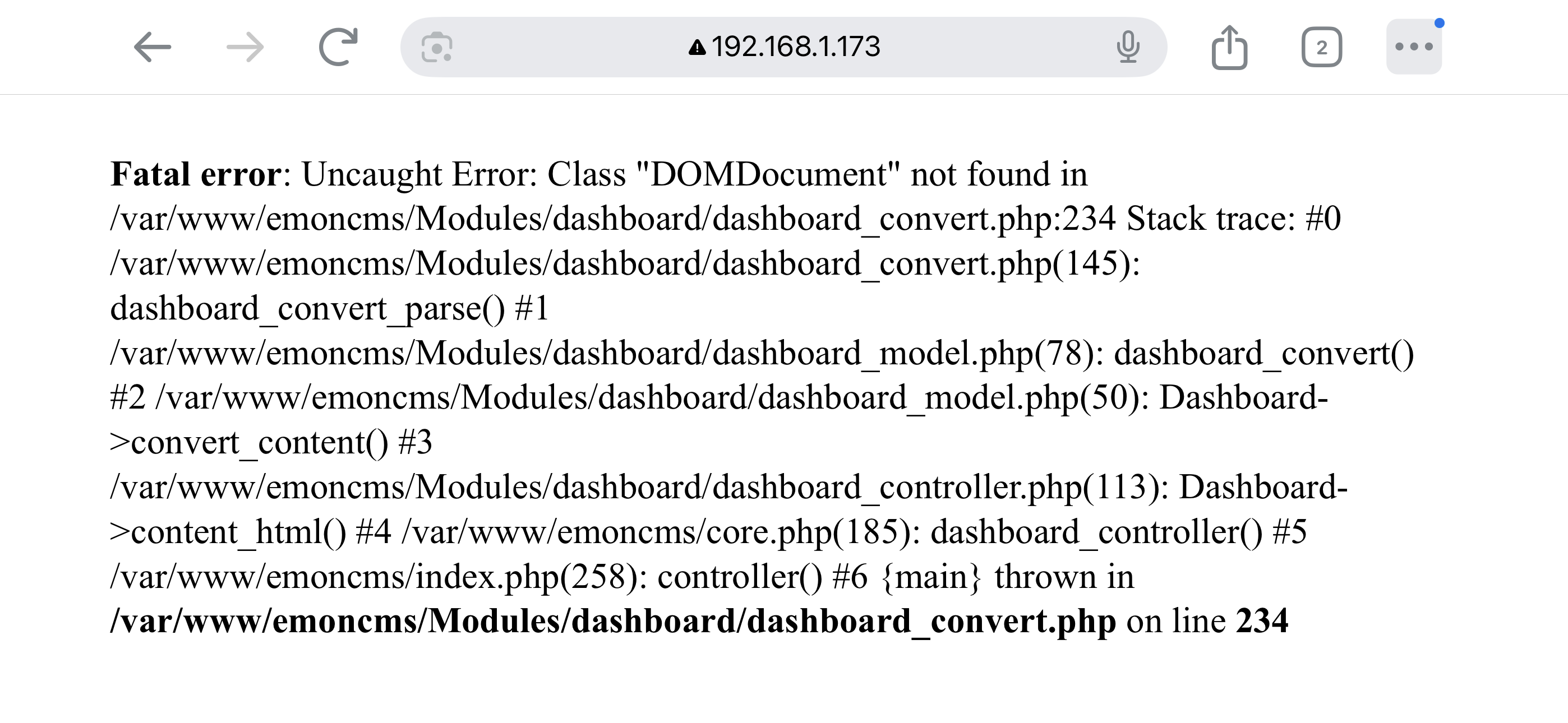

Hi - I just did a full update to get the security enhancements, but following the required re-boot my dashboard doesn’t work, either in the browser (Safari) or in the EmonCMS iOS application. Here’s a snapshot of the error message…. I’m a bit sad to have lost my monitoring :frowning:
Extra info… This morning I started trying to edit a new dashboard to see if I could recreate the old one and when I went to save the new one after adding a couple of widgets I couldn’t - got this message:
§EmonCMS Error
Message: Error: Could not save Dashboard. parsererror
Route: dashboard/edit?id=13
Line: 1014
Column: 69
Cheers
Richard
Hello @RichardinCancale can you check which emonSD version you have and the PHP version on the Admin > Info page?
It looks like your version is missing a couple of requirements, running this via SSH might solve it:
sudo apt install php-xml php-mbstring
sudo systemctl restart apache2
Would you be able to try this? If it works I will add this to the automated updated scripts.

Ah not there, you need to SSH into the PI to do this but dont worry, I’ve now updated the update process to pull these in. Can you run a full update again?
Thanks - I’d forgotten about SSH-ing!
However after doing another full update the dashboard is still dead in exactly the same way.
Hmm ok, can you copy the output of your admin > info page?
and do you see any local changes flagged on Admin > Components?

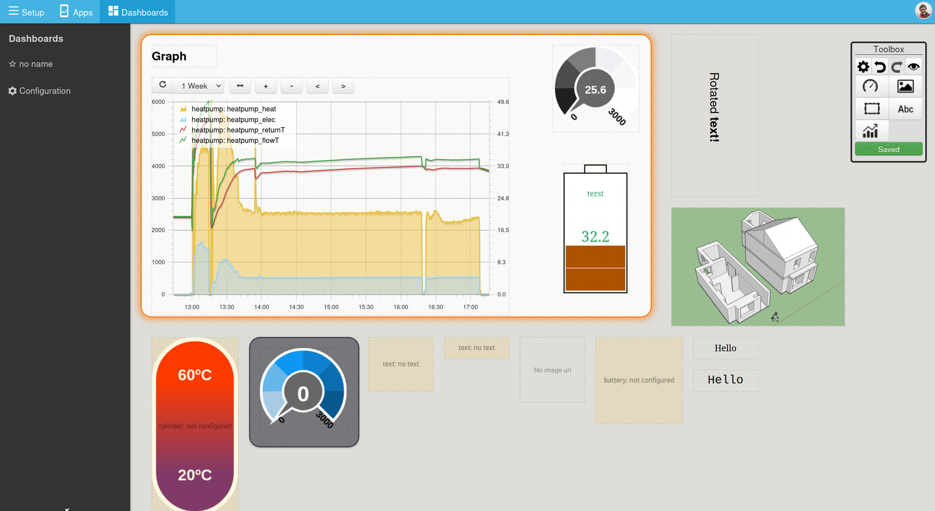

When you do get this working which Im sure we will solve shortly, there’s now some new dashboard module improvements in the latest version :slight_smile: (need to run update again to get these - v3.1.0).
  • There’s a more comprehensive widget for adding text that supports setting font size, family, decoration, color and text rotation (no need to enter HTML styles to do this now).
  • There a new image widget for more easily adding images, including automatic image sizing.
  • There’s a new panel/container widget that allows much more customisation, replacing the four presets.
  • The process of editing and moving widgets is easier, unconfigured widgets are highlighted, widgets show subtle boundaries in editor mode, it’s clearer when you clicked on a widget from the toolbox when placement is active.
