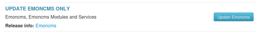

It applies to ALL emonCMS.
I certainly did not reflash the SD card, I’m reasonably sure all I did was Setup →Admin → Update and apply the Update EmonCMS only.
I’m using an original emonPi with 868 MHz radios so I have to be very careful what I update - ie, not the “emon” processor that does the energy measurement, because that also receives the radio transmissions. :slightly_smiling_face:
An update via the admin update tool as @Robert.Wall mentions is fine
Thanks guys. That worked a treat.
I also clicked update only database but it said it was already up to date.
