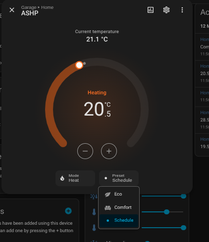

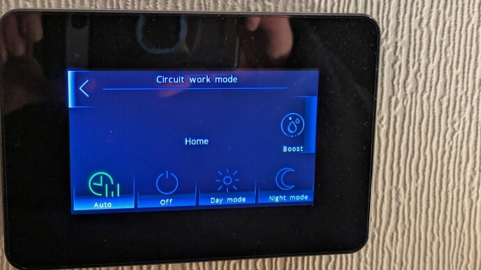

I can’t see to see an option in the HA integration to change the work mode of the Circuit e.g Day (comfort), Night (Eco), Auto or Boost. Do you think this is something that could be added? The ability to set the day/night schedule is already available via the HA schedule car.
I’ve also noticed a number of cooling options in the HA integration. I think I’m correct that the Grant HP290 heat pump doesn’t support cooling (yet?!). Or have you been able to get cooling to work?
I think the hardware supports it and it’s simply unable to be controlled by by the software!
The work mode is already available in the integration - it’s exposed as preset modes on the climate entity for each circuit:
Comfort = Day mode
Eco = Night mode
Schedule = Auto
Boost isn’t supported by the HA integration yet - I’ll add that in.

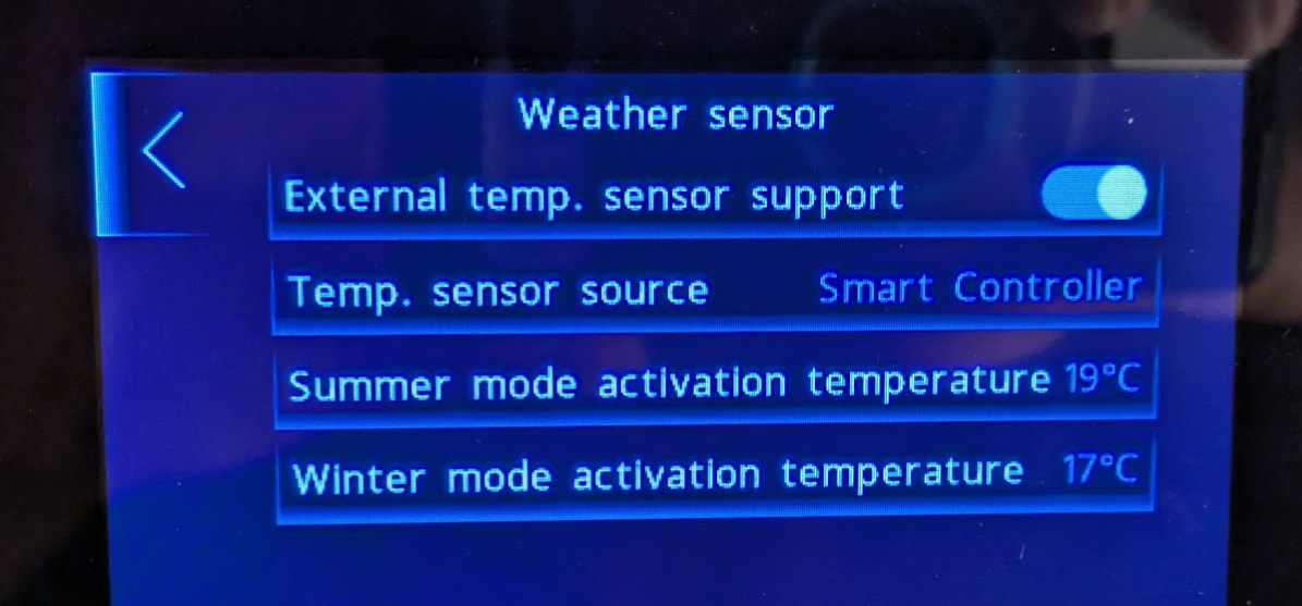

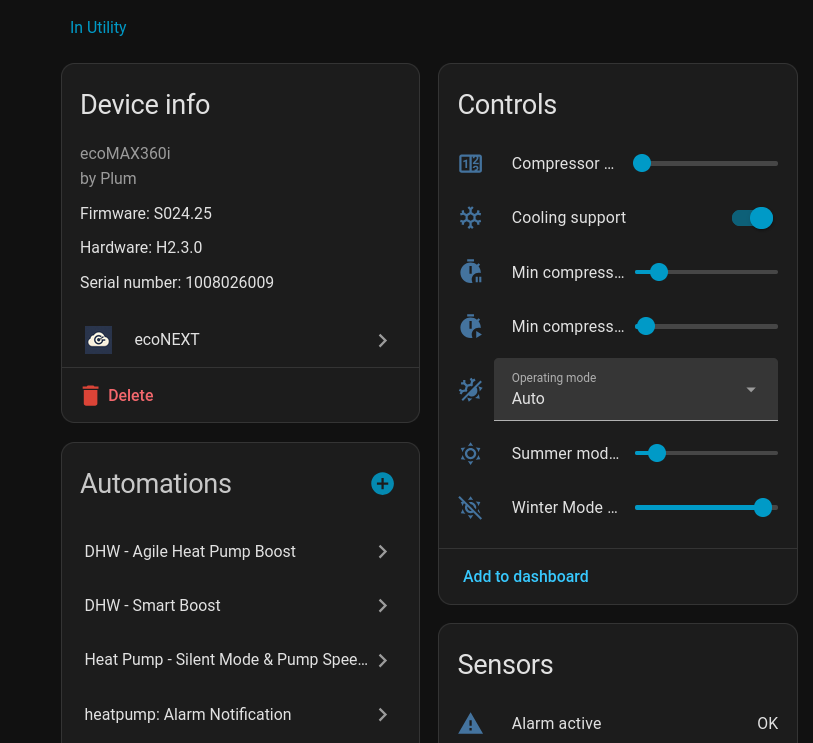

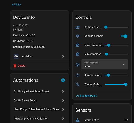

Do you know if it’s possible to adjust the Summer and Winter cut-off temperatures via Econext?
yes look for the “Summer mode threshold” and “Winter mode threshold” entities. They’re under the Controls section in the ecoMAX360i device
