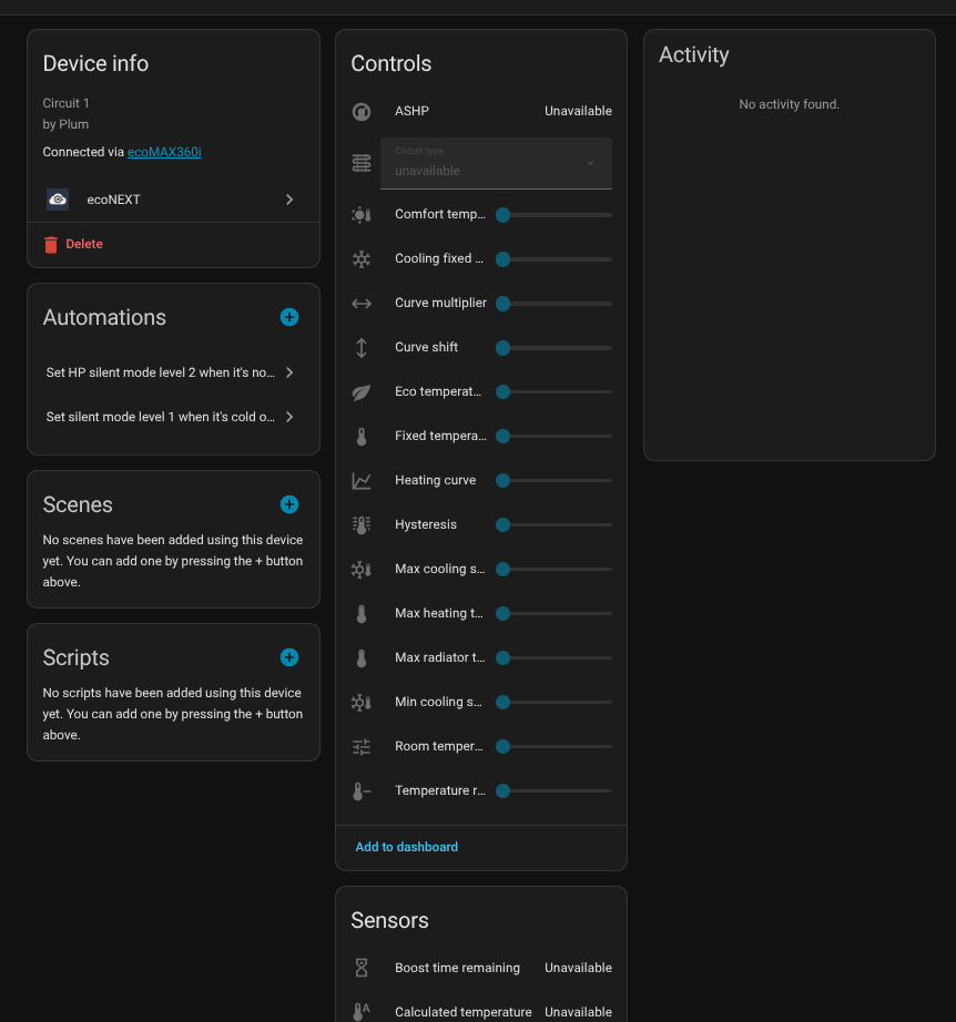

I’ve had a strange issue recently where the Circuit 1 data and controls are unavailable in HA. The heat pump itself is running fine, circuit 1 is active.
Data and controls for the main heat source and DHW are still working fine
Any ideas? As far as I can tell the econext server is running correctly, it’s reporting
{"name":"ecoNEXT Gateway","version":"0.1.0","status":"running"}
I’m running EcoNext HA integration Version 0.1.1
I’ve attached the output of http://<IP>:8000/api/parameters
pramaters.txt (200.0 KB)

thanks for the detailed report, I managed to figure out what the issue is. My logic detecting active circuits is flawed. Just need to test the fix before releasing an update.
@glyn.hudson in case you haven’t seen it, I released a hotfix v0.1.2 for the HA integration that should fix the problem :slight_smile:
Yes! That’s fixed it. Nice work :smiley:
